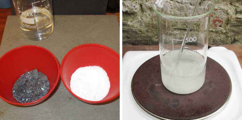

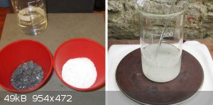

79g of sodium chlorate were dissolved in 250ml of warm water and 2ml of concentrated nitric acid added. The solution was heated to about 80°C and
100g of coarsely crystalline iodine added in one go.
The ingredients iodine and NaClO3 (L) Sodium chlorate dissolving (R)

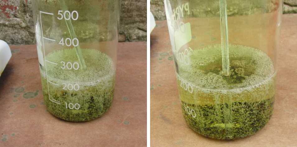

The reaction was slow to start with but eventually a vigorous reaction set it in and the solution boiled steadily, very little purple iodine vapour
was evident and then only at the beginning, before rapidly ceasing. The smell of chlorine could be detected but the amount released was very small.
The initial vigorous reaction (L) The reaction subsided- faint yellow vapour (R)
After an hour the vigorous reaction had subsided and heating was required to maintain 80-90°C and some iodine remained so a further 11g of sodium

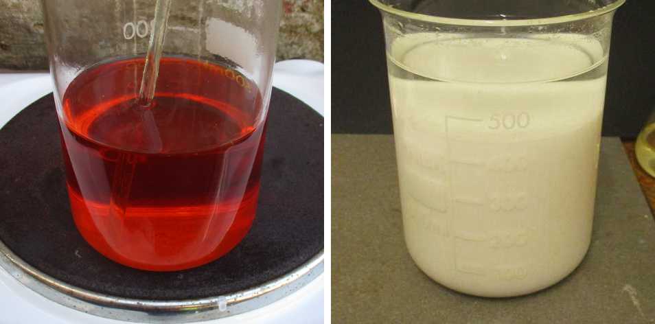

The final orange solution (L) The initial precipitate of NaIO3 on neutralisation (R)
Eventually after about 2.5 hours a white precipitate began to form. Believing this to be a sparingly soluble sodium hydrogen iodate more water was
added to bring the total volume to about 350ml but after reheated to 80°+ the ppt continued to increase in quantity so the solution was neutralised
rapidly with 50% sodium hydroxide solution. 55ml of this solution were measured out and 45ml taken and diluted to 100ml. The, now cloudy, orange
iodate solution was added to the 100ml of alkali with vigorous stirring.

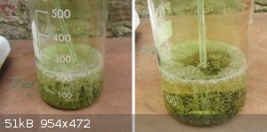

At first a clear solution resulted and then a white precipitate began to form then a transient dark colouration that rapidly disappeared to be
replaced by more white solid. As addition continued the time it took for the dark colour to disappear increased and eventually a grey transient solid
(almost certainly iodine) and purple vapour formed and the time they took to disappear increased. When all of the orange iodate solution had been
added then solution was brown with a mixture of white and dark grey solids in suspension. The rest of the sodium hydroxide was added slowly and
stirred in causing the brown colour to discharge rapidly and the grey solid to disappear more slowly but after about 30 minutes the entire suspension
was pure white.

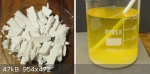

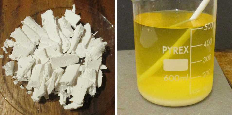

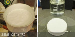

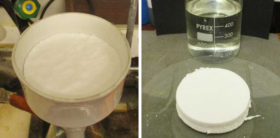

Sodium iodate H2O cake in the filter (L) Filter cake ready to dry and the clear filtrate (R)
When stirring was stopped the solid settled rapidly. The solution was cooled to room temperature (about 15°C) and filtered at the pump in a Buchner
funnel and washed with about 100ml of cold water. The solid cake was sucked as dry as possible and turned out onto a large watch glass to dry. The
dried white finely crystalline powder weighed 152.48g, which if pure sodium iodate monohydrate represents a yield of 89.7%.
