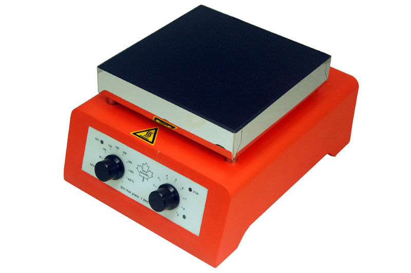

My absolute one bit of recommended kit is a hot plate/stirrer. Decent Corning PC-351's can be found on eBay for around $100US used. I bought a used
one three years ago, and it was really money well spent and a "turning point" in what I could accomplish.

I purchased a stirplate that is decently good for it's price and being non-lab grade.
It was well enough to boil over 1-liter reactions (urea, lye, water) and for acetone distillations, and the stirring is capable for ordinary work. The
magnet startup is a big jaggy and they aren't that strong when stirring bigger vessels. 4-liter unit with solids precipitating out can cause button to
destabilize once in a while. I used one 10-liter unit with coolant bath and the about 10mm extra space was enough to destabilize the stirring button.
I use overhead stirring for larger volumes nowadays anyways.
For heating larger amounts, I always use either propane burner or a recente acquisition of induction plate. The stirplates seldom have enough heating
power for larger batches, anyways, so there's that.
