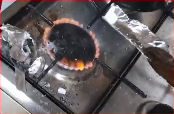

Below is a snip of a video one of our members made doing experiments next to their kitchen stove. The color of the flame of the gas burner indicates the air is contaminated by dust or an aerosol from his experiments which would also contaminate the kitchen and would have been inhaled if he had no protection.
sodiumdust.JPG - 39kB

[*] posted on 30-7-2020 at 03:16
I haven't seen the clip that you got that from, but what makes you conclude it is their kitchen?
Is it an air contaminant or something on the burner?
Does the video indicate the level of ventilation?
Did this experiment include lead?
Please note this is not an attack on your post wg48temp9. I am just a little confused how you drew your conclusions. I am clearly missing something.
The purpose of my post was to show what a gas flame looks like when its sucking in airborne particles that may not visible. It was in support of my original post.
Below is a pic of a gas flame that is not sucking in airborne particles or if it is they are spectroscopically not contaminated with sodium so the sodium yellow emission is not observed.
Its not important if it is a kitchen or not or what the level of ventilation was
or if the particles are contaminated with lead.
As described in my original post its a demonstration of how readily air can be contaminated by the regents used in an experiment, in particular when boiling liquids.
