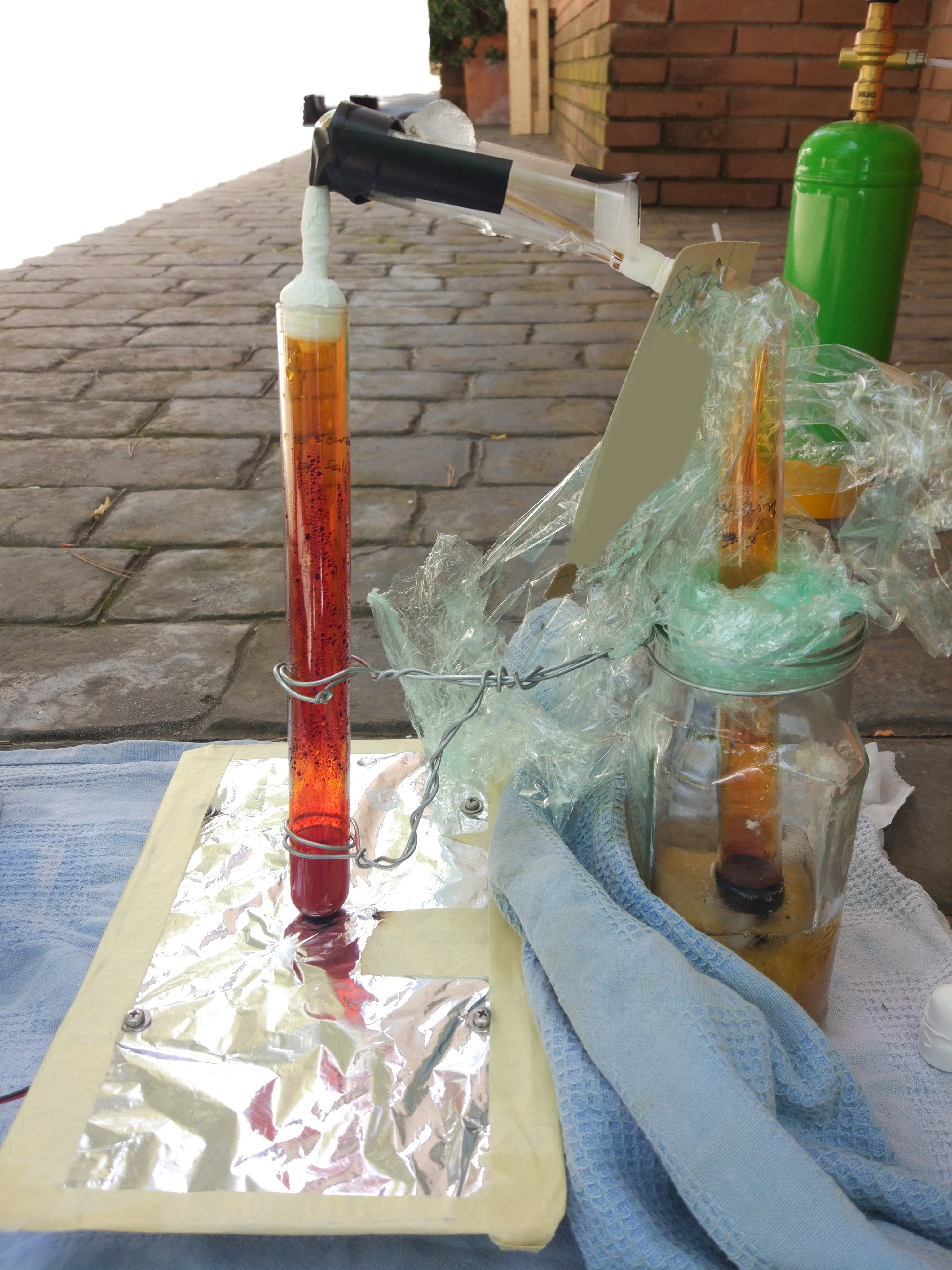

My first attempt was unsuccessful. I tried to distill it without using a stirring bar (The one I wasn't covered in PTFE so the bromine would have
destroyed it.) This led to horrible bumping which resulted in some concentrated sulfuric acid on the receiving test tube. I did seal the ampule but
it's pretty ugly, so I won't post images.
Second attempt has been successful though. At the peril of looking unprofessional this is the DIY condenser set-up I made. There's a DIY stirrer made
using a PC fan with a magnet attached. The plastic wrap is only to minimize fuming and set the position for the receiving test tube (I know highly
sophisticated stuff)
The condenser uses ice to lower the temperature and condense the bromine. It isn't very efficient but if I run it slowly it barely fumes. The test
tube and the condenser is joined with a PTFE pressure fit that did a decent job on containing the bromine fumes. Both test tubes were flushed with
argon (just because I had it, not because it was necessary). I performed the distillation on a windy day so there was barely any bromine odor.
