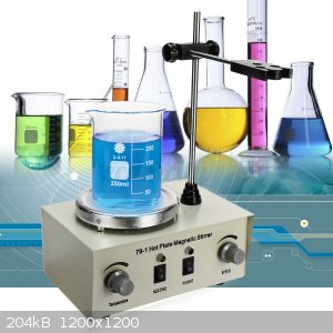

Hey all I am fairly new to purchasing actual chemistry equipment and just purchased the following hotplate.
https://www.amazon.com/Magnetic-Stirrer-100-1600RPM-Control-...
I have seen this exact same hotplate sold from 60-200 dollars. Im looking for tips and brands when purchasing equipment like this. Im sure most of
these are all just branded Chinese hotplate. Trying to avoid purchasing expensive equipment that is a knock off.

Avoid any Chinese hotplates, that one probably won't even boil a liter of water (160W). Get a reputable one, such as from Corning, Fishersci etc.

I own this or very similar. It will boil 1 L of water (on a hot day, wrapped in foil, with no breeze and maybe in direct sun ). The stirrer is not super powerful and neither is the hotplate, but it has lasted a
couple of years with decent use (and abuse). It has withstood some pretty traumatic foam overs (for both me and the hotplate).
Would I use it to distil sulfuric acid, well no, but it is suitable for a great number of things.
You really need to think about what you are going to do. If it is low temperature, smaller volumes then why not go with something cheap and cheerful?
The other thing to consider is maybe a decent heating mantle is where you should invest your money.
Just wanted to put it out there that hotplate stirrers do not have to be able to boil 2 L of sulfuric acid if that is something you never intend to
do.

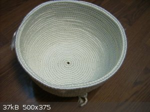

I'm making a PID controller for my coffee tin mantles with an immersion probe.

So far the hot plate has worked alright. The plate temp reaches the max temp of 350 C as advertised but can not hold it with any sort of load applied
(just doesn't have the power). As others have said this cheap one does work very well for my purposes but if i could go back and spend the extra 70
dollars on one that would work well for ALL purposes I definitely would. I appreciate all the help guys!
