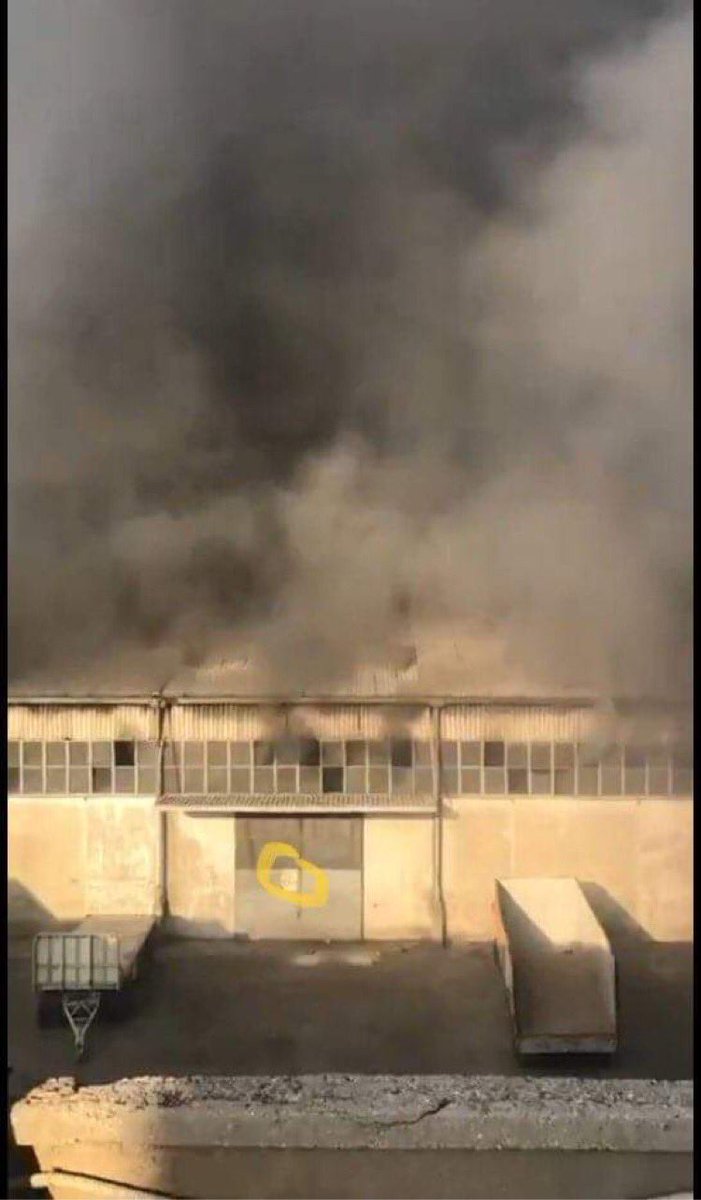

Well that's what the pile looked like.

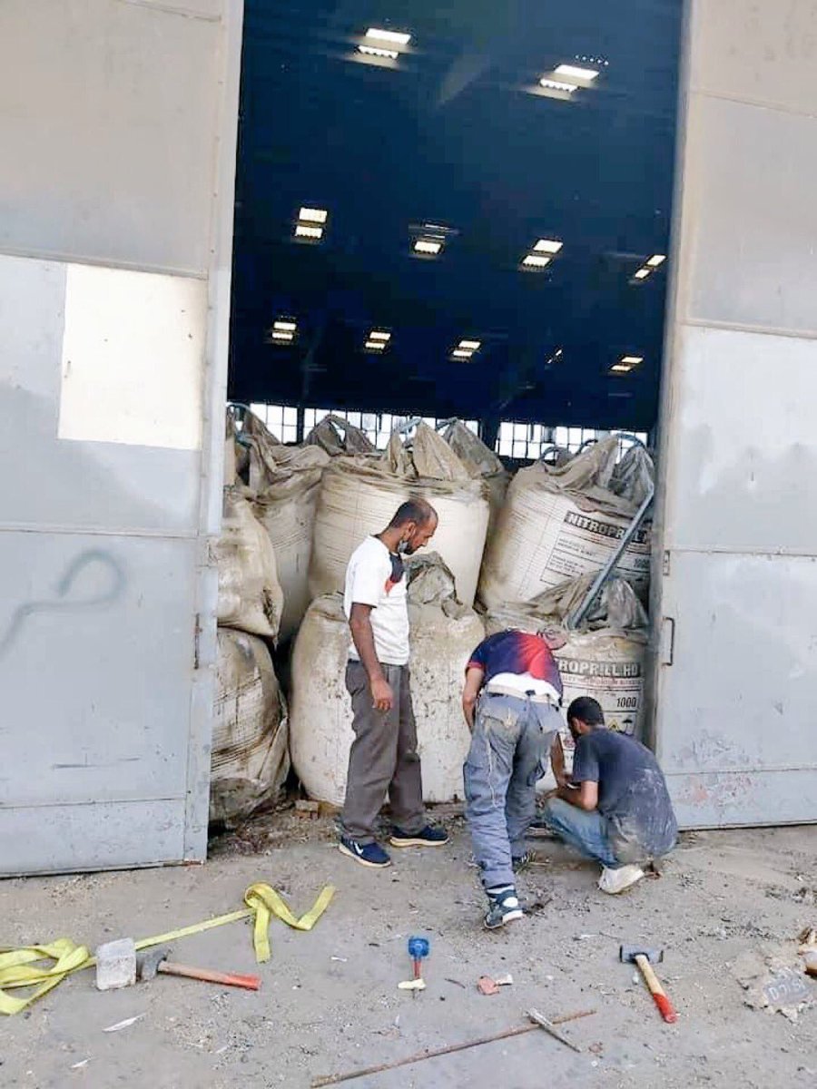

That picture at the door is consistent with what I read about the warehouse door being worked on earlier that day.
Whether or not the AN went off first this explosion was waiting to happen. Could there maybe have been another warehouse nearby with military
explosives (that the Lebanese govt might not be keen to publicise)?
The shock from the AN blast would presumably set of almost anything, whether it was stored well or not.

That first explosion did not look like a firework at all. They were the normal white flashes.
The first real explosion that ended the video from the room full of AN was white-yellow and was so fast. Burned clean . What the heck was that?
Maybe this should just be left alone. World be a better place if everyone believes it was accident.
Pyro_cat
Posts: 243
Registered: 30-4-2018
Played it back frame by frame, sliding the view thing across. That yellow flash seems to look like that smoke cloud igniting.
