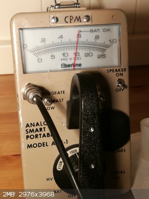

I have tried to make radium paint that glows like it used to for quite some time now with decent success. While it does generate some luminescence it
is too faint for my liking so I wonder, does anyone know a good method to make paint that glows quite well?
My method
1. Mixed new ZnS:Cu with acetone to remove any kind if adhesive that might cause it to glow less. (Seems to make it work a bit better even tho the
ZnS:Cu is brand new)
2. Dissolved around 0.5ug of RaBr2 and mixed it in with the ZnS:Cu
3. Mixed it around over and over again until all the water had dried.
I of course left it in a dark space for 24h before checking if there were any luminescence from the paint. (checked in total darkness during a span of
10min)
Left pic is a measurement of the paint. Detector used is an Eberline ASP-1 with a Ludlum 44-9 probe. Right pic is the paint.
[Edited on 13-8-2020 by RadiumQuetzal]

No sure if 10kBq of Ra is enough to glow... Maybe with some really good phosphor.

I thought so too but then I realized that some of the clocks with radium contains even less and still used to glow. One of those containing a total of
0.0259ug of Ra-226 and the paint should be ZnS:Cu due to it's age.
