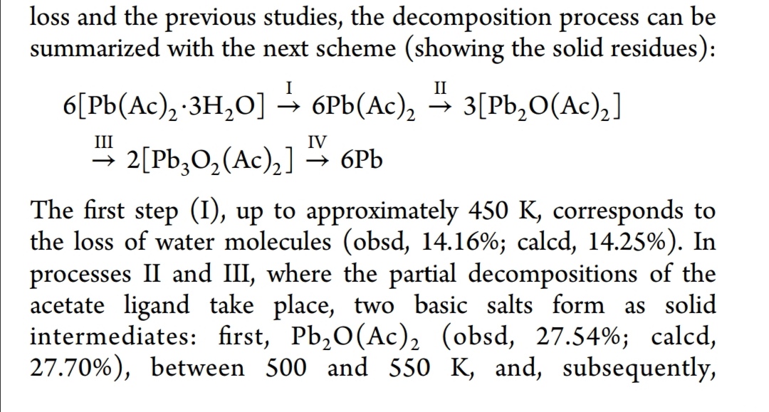

Pretty sure the net reaction goes something like that: PbO + 2AcOH --> Pb(OAc)2 + H2O. So there's probably no need for OH ions in order for the reaction to take place.
Also note that the reaction forms water as a byproduct, so you probably won't get anhydrous product even in anhydrous conditions. Luckily, Pb(OAc)2 is really easy to dry, just put it in the oven and wait(it won't decompose till ~176C)[1].
Lastly, as long as you use acetic acid, I don't think it's likely for any basic salts to be formed in the reacrion.
[1] - https://pubs.acs.org/doi/10.1021/acs.inorgchem.6b01116
