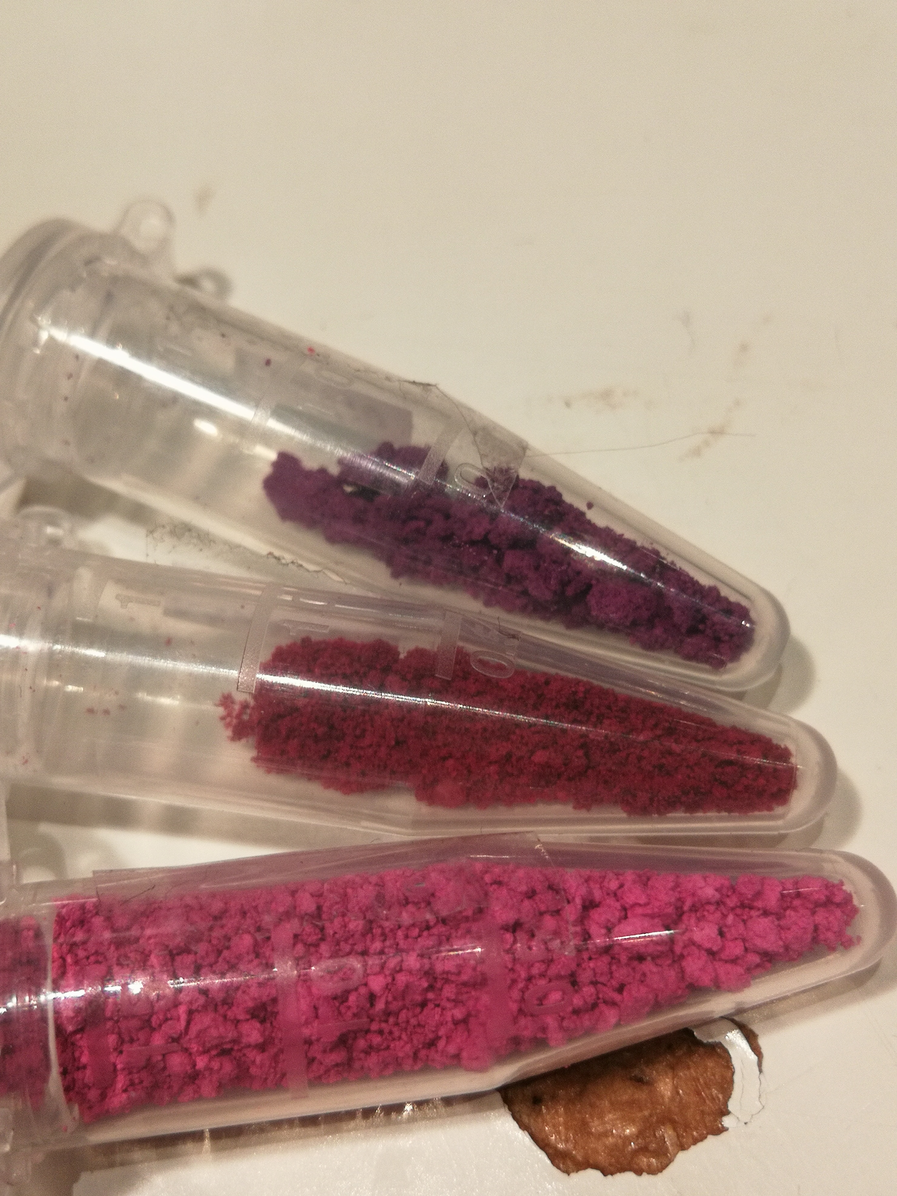

My favorites are these: Ethylene diamine, Mn and hexamine (bottom to top)

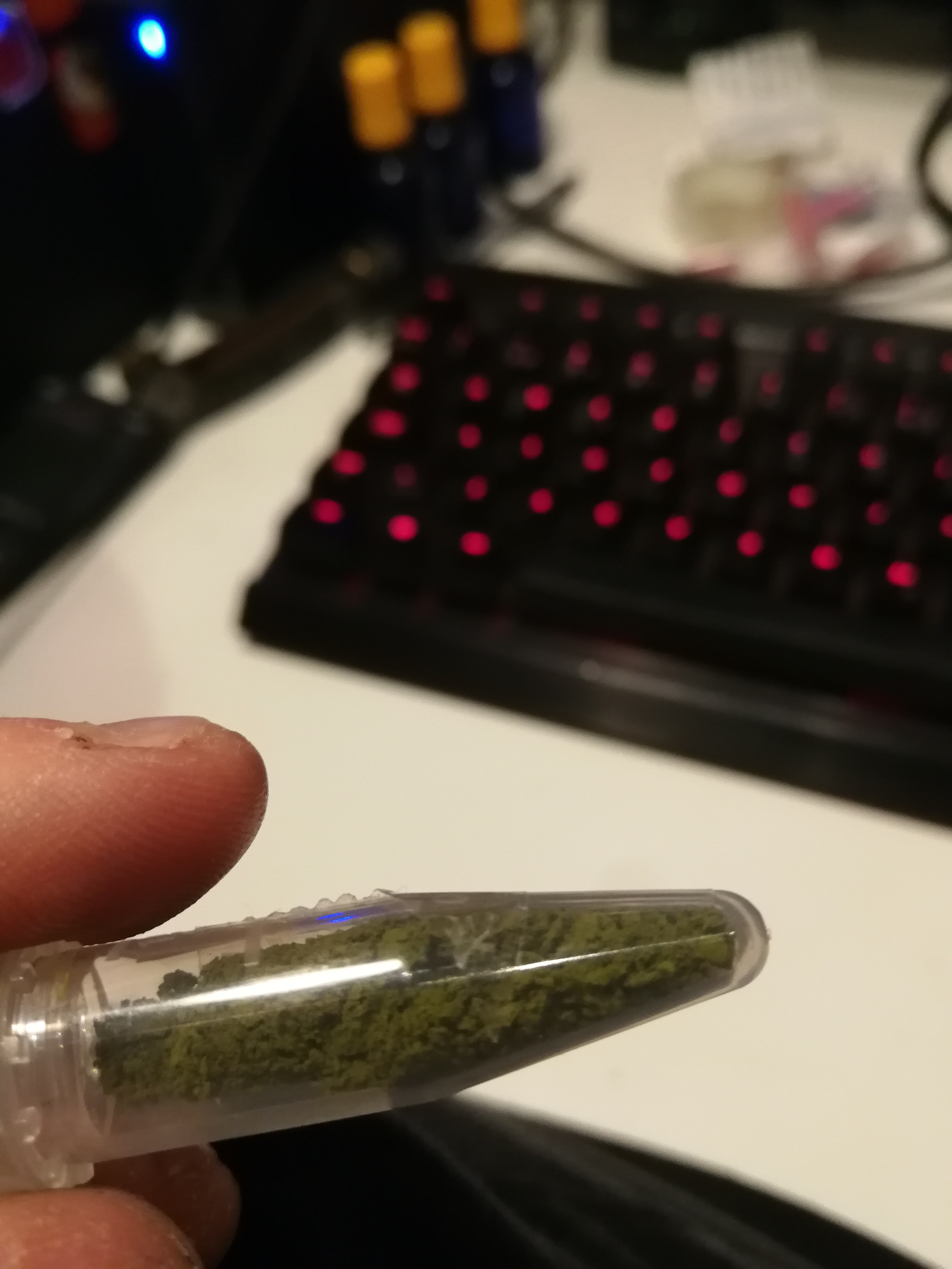

as well as the copper one.

ShotBored

Those colors are awesome, dude. Only iron compound I've ever seen blue like that is Prussian blue. I'd be interested in seeing Pb, Sr, or guanidine salts! Or anything further on this subject really. These colors are astounding.
