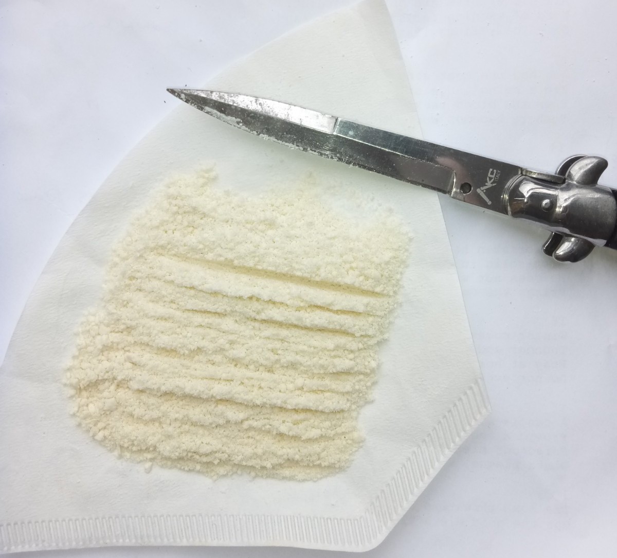

Pondering over the stability of pseudonitrosites, I remembered I still had a sample of isodillapiole in my collection, so I decided to do an experiment.
Preparation of isodillapiole pseudonitrosite
A solution of 20.7 g (0.3 mol) sodium nitrite in 35 ml distilled water was prepared and added to a 500 ml round-bottom flask with stirbar. A solution of 6.6 g (0.03 mol) isodillapiole [1] in 50 ml diethyl ether was added, the flask fitted with a Claisen adapter, an addition funnel, and an outlet to vent the noxious fumes outside. The flask was placed in an ice/water bath (with plenty of ice) on a magnetic stirrer. In the addition funnel was placed 75 g 20% sulfuric acid. The acid was added dropwise to the stirring two-phase mixture over a period of 3 hours. (using the principle "when you see brown NO2 fumes you're adding the acid too fast.")
At about 1/5th of the acid added, a cloudiness was observed. This then turned into a thick cream-coloured precipitate towards the end of the addition. It was left stirring in the ice/water bath an additional hour. Air was pumped in through the addition funnel using an aquarium air-pump to remove as much nitric oxide fumes as possible from the system before opening it.
The mixture was filtered using gravity filtration through 2 coffee-filters (obviously this should be done in a well-ventilated area). The obtained solids were washed with distilled water, 4x with methanol and finally with a good portion of diethyl ether. When gravity filtration is done, the filter is pressed by hand against the funnel as to remove as much solvent as possible. Then it was air dried for 1 hour. Tan coloured crystals of isodillapiole pseudonitrosite were obtained.
They weighed 15.3 grams after air drying for over an hour. My impression is that the solids seem to absorb some of the ether. It is not easy to get them to completely dry like this. I took a 0.3 gram sample of the pseudonitrosite in a capped sample contained to observe the decomposition rate. As I am typing this, the sample is still white and crystalline after 48 hours, no brown NO2 fumes can be seen, there are still no signs of decomposition.
The reason why I did this experiment was in the first case to observe the stability of pseudonitrosites at first hand. At least for isodillapiole, it is much more stable than often assumed.
[1] The isodillapiole used in this experiment was prepared about six months ago. It was obtained by refluxing dillapiole in 4M ethanolic KOH for 15 hours. The product was isolated following common procedure and recrystallised twice from petroleum ether. A yellowish-white crystalline product was obtained that darkened somewhat on standing. The dillapiole was obtained from fractionation of Indian dill seed oil (Anethum sowa), it is the main fraction after removal of carvone.

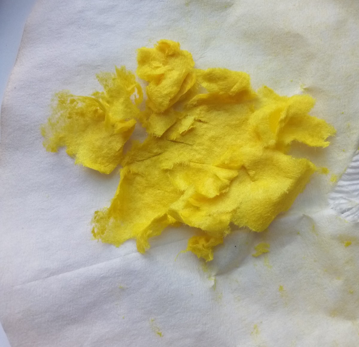

Preparation of beta-nitroisodillapiole
The above pseudonitrosite was added in small portions to a strongly stirred chilled solution of 50 ml 8% ethanolic KOH [2], placed in an ice/water bath. The temperature was 2-3°C during addition. Only minimal foaming was noted, after addition the mixture was stirred for an additional 30 minutes. It was then filtered, again using gravity filtration (through a single coffee-filter), and the solids washed with a portion of ethanol, added to the filtrate. [3]
The filtrate was poured on 30 grams of crushed ice, and the mixture was carefully acidified by adding 50 ml 5% aq. HCl in small portions with stirring, so that the temperature was never allowed to rise above 10°C. A fine, canary-yellow precipitate was obtained, which was isolated again by gravity filtration (through 2 coffee-filters). The precipitate was washed with ice-cold water, and the washing added to the filtrate which made it turn cloudy. After standing for 24 hours a (small) second crop is obtained from this as yellow needles. The first crop weighed 2.2 g and the second 0.4 g so the total yield of beta-nitroisodillapiole was 2.6 g (32% based on isodillapiole).
[2] The ethanol used was technical grade 95% denatured ethanol, sold as "bio alcohol fuel". The denaturant agent is unlisted, but on dissolving KOH the (initially clear) solution turned an orange colour.
[3] These beige coloured solids were suspended in boiling ethanol, filtered again, and dried and saved. As such 9.0 grams of potassium hyponitrite (K2N2O2) were obtained as a white solid. This is in itself an interesting compound, it can be used as reducing agent and the corresponding acid is a tautomer of nitramide.
In previous experiments (long ago I admit) I was never able to obtain the higher yields mentioned in the pseudonitrosite FAQ. Results were always in the range of the above using other substrates too.
addition of PN to alcoholic base.jpg - 216kB hyponitrite filtration.jpg - 208kB beta-nitro-isodillapiole first crop.jpg - 296kB beta-nitro-isodillapiole second crop.jpg - 230kB final result.jpg - 257kB

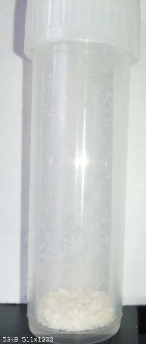

[*] posted on 13-5-2021 at 06:17
This is the sample of isodillapiole pseudonitrosite I kept in a capped container. It is now 2 days and 2 nights after the experiment and I still can't see any clear signs of decomposition.
PN sample 48h -1.jpg - 89kBPN sample 48h -2.jpg - 53kB
