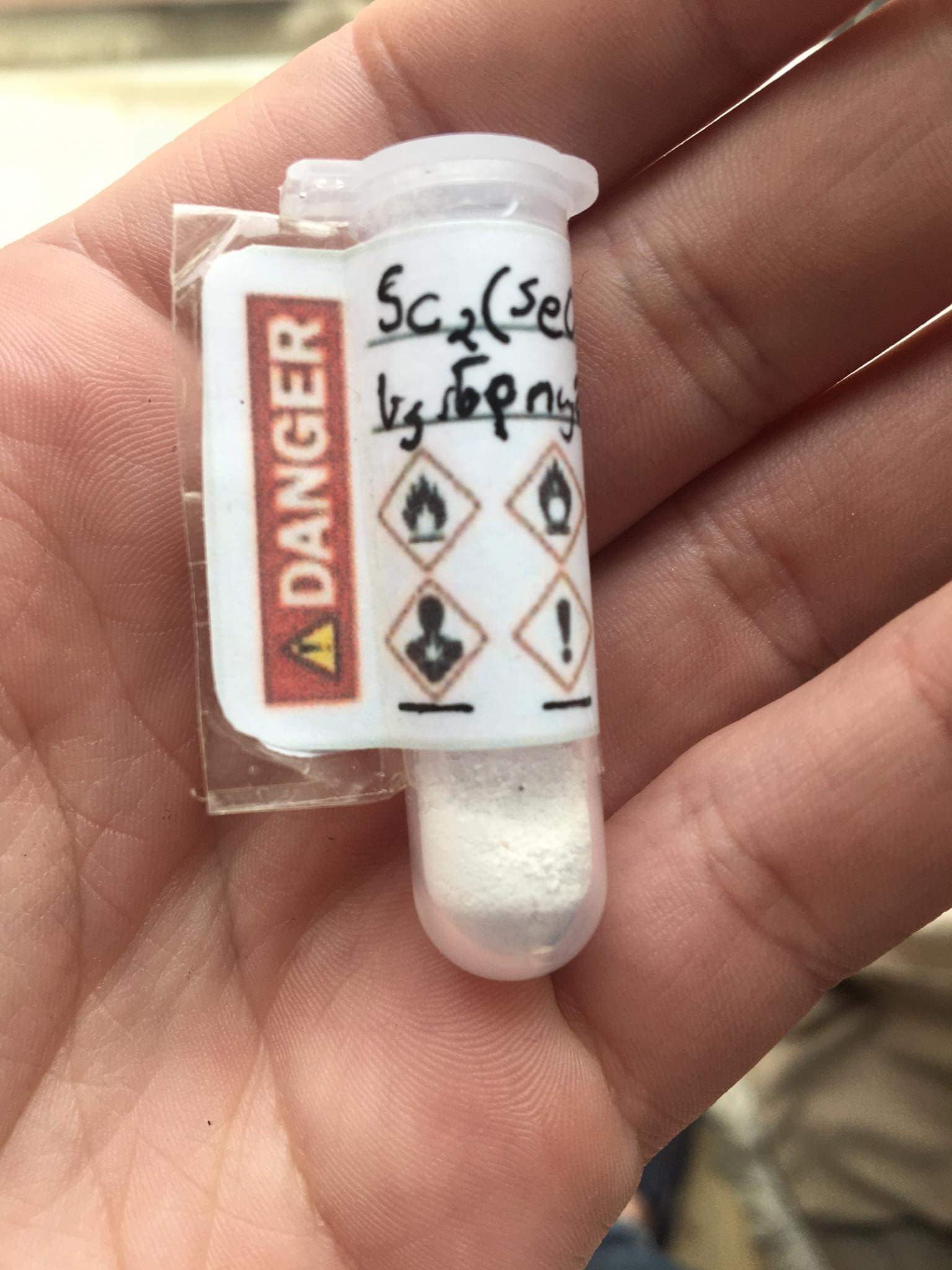

•Also i made indium selenite, its white, but its just for my selenites colection. Scandium salt is also white, but ot is a very rare compound and i dont care about colour.
received_979125346246562.jpeg - 197kBPicsArt_03-23-04.28.07.jpg - 297kB

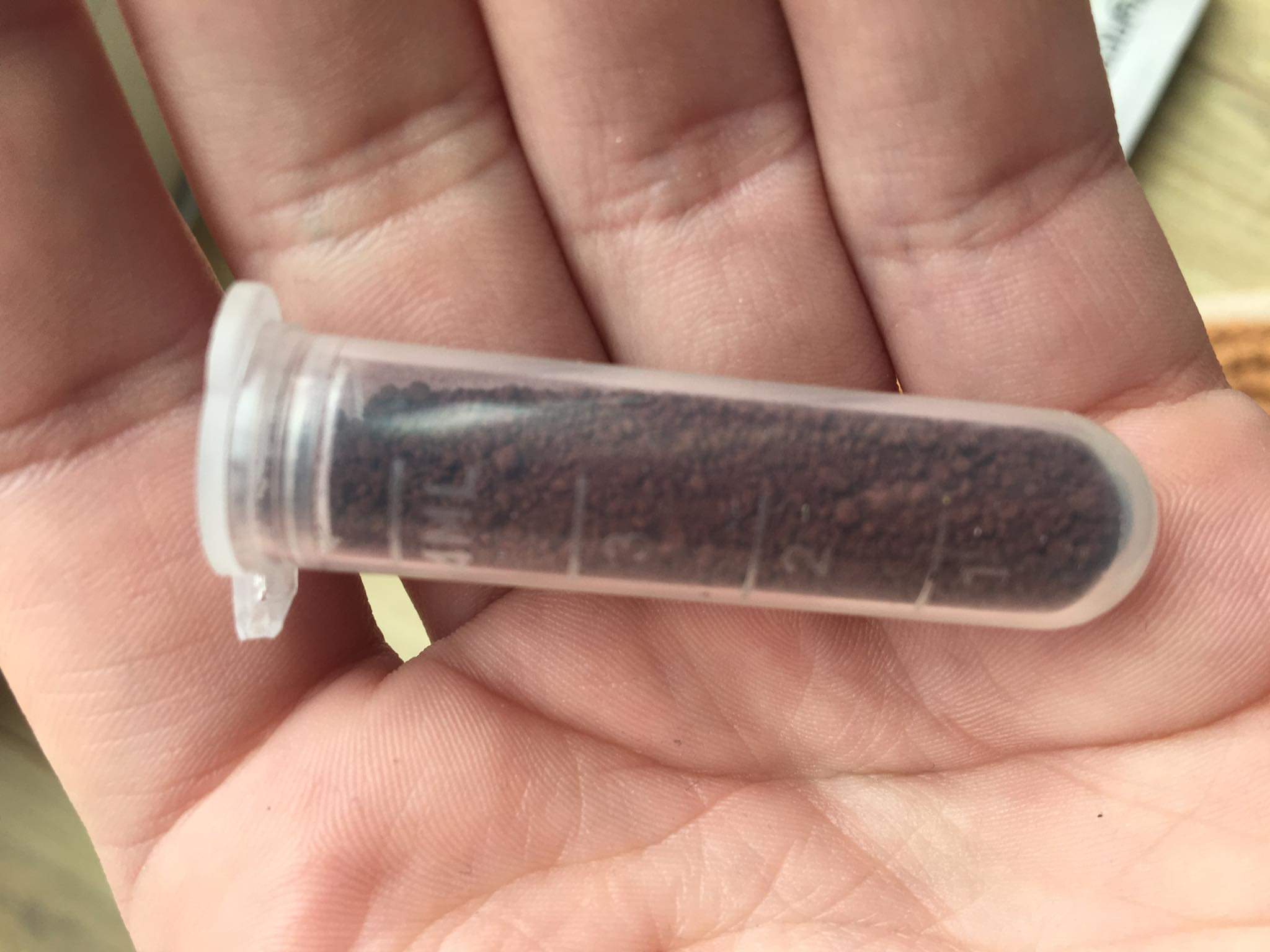

•I made small amount of red and black selenium, they aren't for reactions, because i always use granules. Red one i made from hydrolysis of green polysenenium cation. I dissolved granules in hot concentrated H2SO4. next i heat some red selenium and made black. Should be heated but should not be melted.
received_225498512693581.jpeg - 177kB

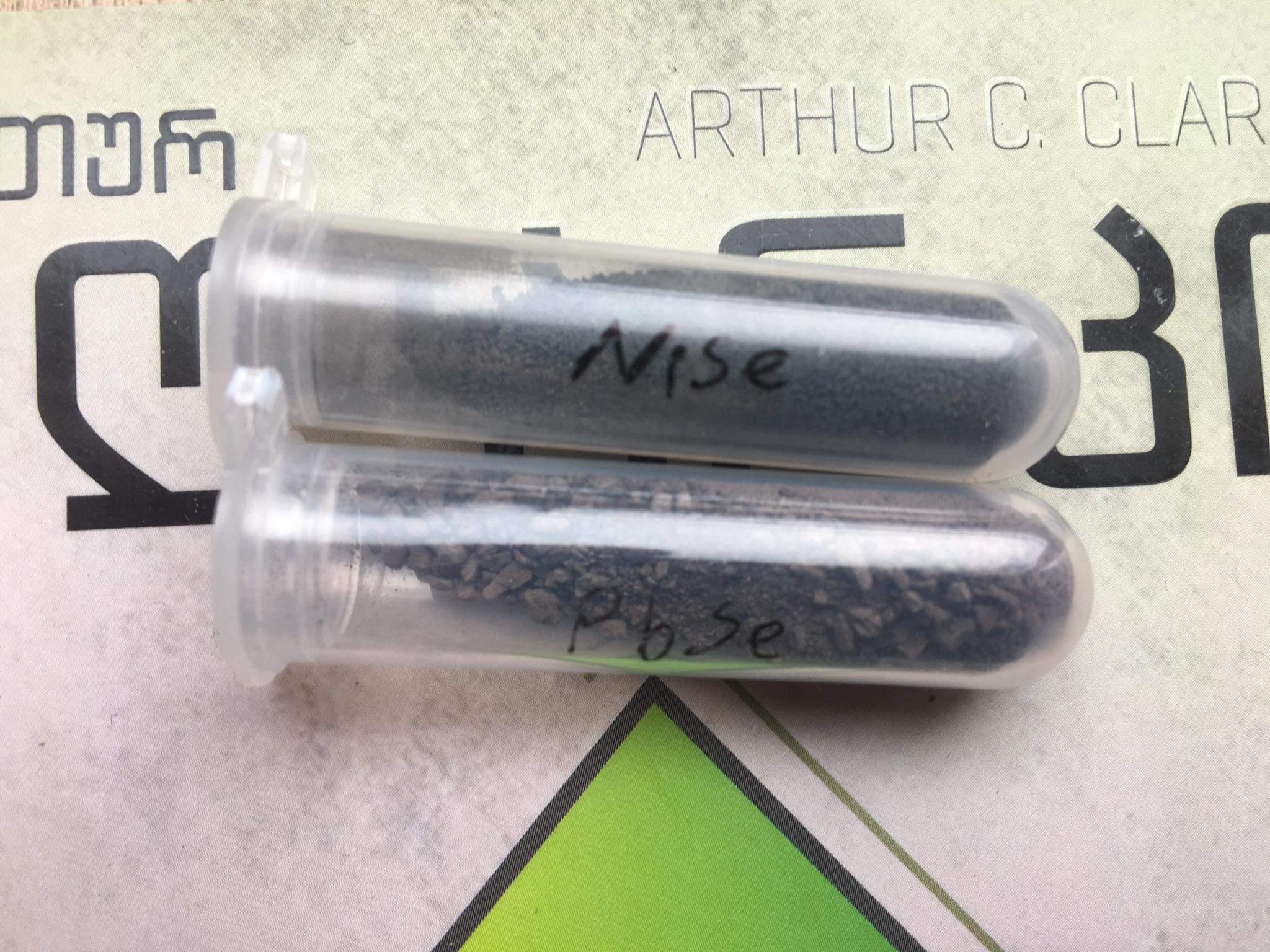

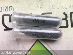

•And boring Pb and Ni Selenides.
received_153015860012516.jpeg - 327kB
This is part of the selenium compounds which I found this time.

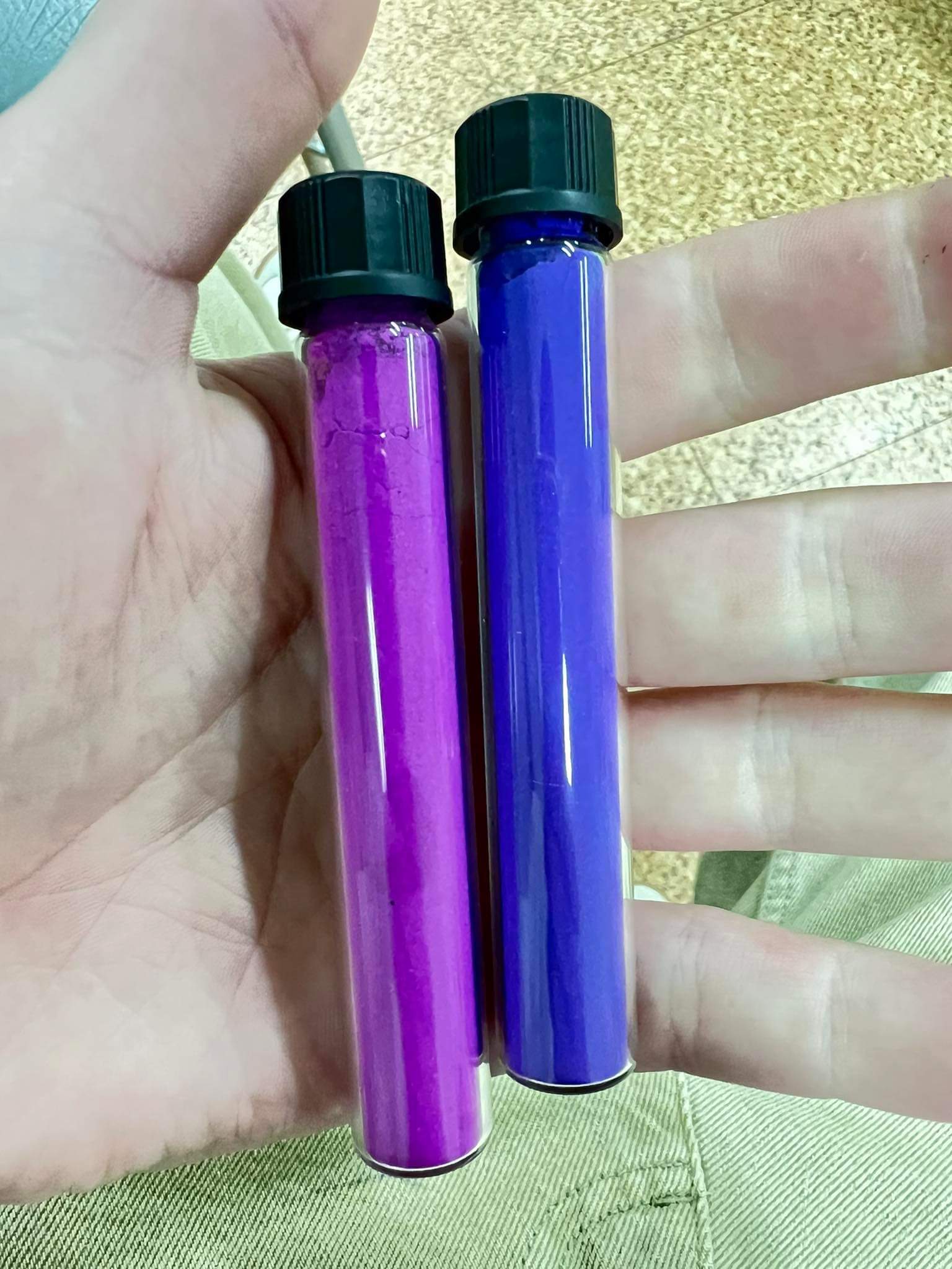

Hi. I made cobalt selenite again and also anhydrous selenite.
received_810980003638710.jpeg - 252kB
received_509556507414364.jpeg - 226kB
received_3249263298636231.jpeg - 170kB
Wow, the colours!
Is the difference in colour compared to your first synthesis due to different lighting conditions when you took the photos, or is the result of your second synthesis really much deeper in colour that the first?

1) I think it cause because of light. but also I think in my sodium selenite solution there was some carbonate impurity. I used to make sodium selenite from selenium. but now I have one jar of pure reagent.
also, cobalt selenite precipitation is a little bit hard than Cu and Ni selenites. I dissolved sodium selenite and cobalt chloride hydrates in hot water. then I mixed the solution but nothing precipitated, then I poured the mixture into another beaker and there was cold water. then it precipitated instantly. From my experience, you cant make the compound with a high yield just dissolve compounds in hot or cold water and mix them.
