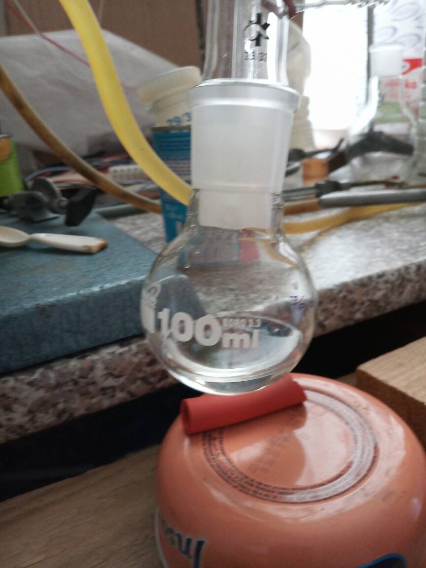

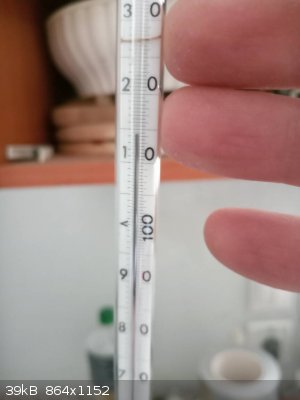

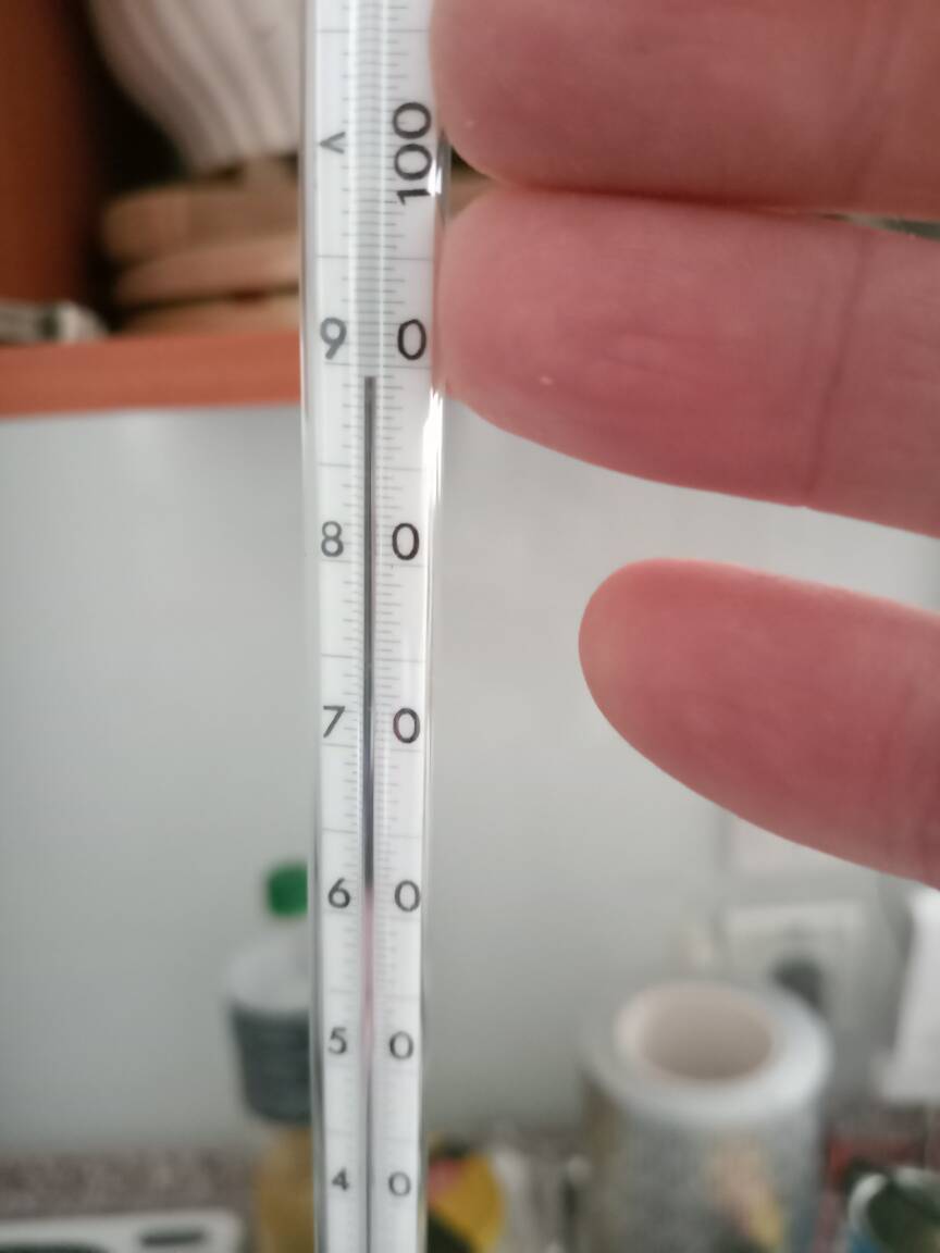

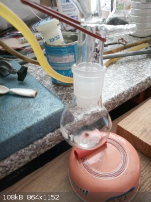

Slightly more than ~60 cm3 of the liquid (from few runs) was placed in 100 cm3 RBF and distilled under normal pressure. Most of unreacted acetone comes in 56 C - 90 C range, then distillation slowes down.
Heating is slightly increased, more distillate starts to collect starting from ~115 C. It is mainly chloroacetone (and possibly 1,1 dichloroacetone). Further, the boiling temperature practically stops at 120 C.More than 90% of distillate is collected in range 116C - 124 C (overheating in the RBF-head in the end of distillation). Unfortunately not everything is OK. When practically all acetone is removed and temperature inside RBF starts rising above 100 C, the color of liquid inside quickly changes from pale yellow, through brown to carbon black. It is commonly known as "black death" - indeed, very adequate name.

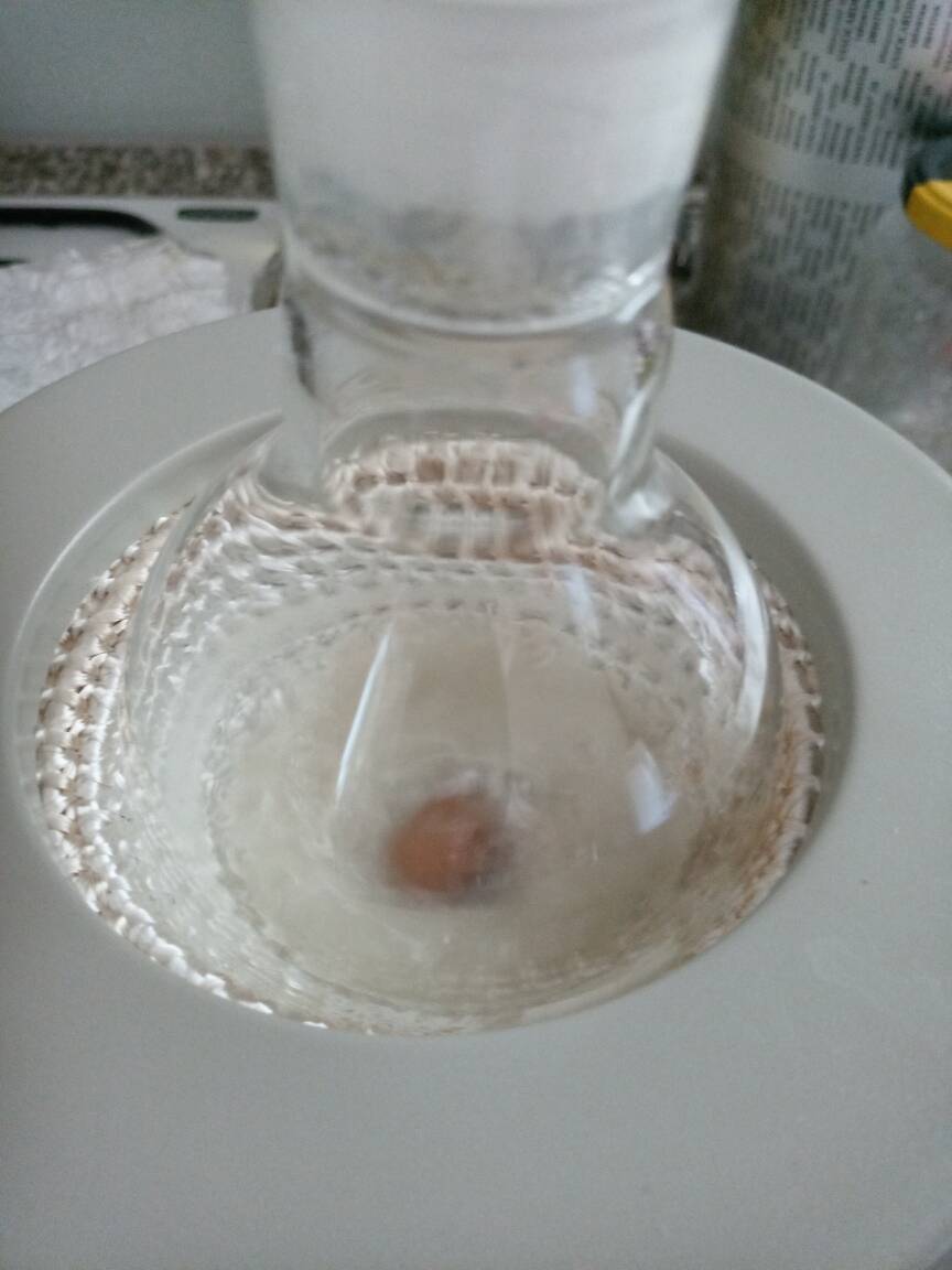

The amount of chloroacetone distillate corresponds to ~70 % of KMnO4 used. When cooled RBF was disjoined from the head, it turned out that all apparatus is filled with HCl fumes.
It is very probable that decomposition of chloroacetones into such carbonaceous material is autocatalytic process, with HCl acting as catalyst.
To the prepared distillate ~0,3 g of CaCO3 was added, botteled and set aside. In the meantime, additional synthesis was performed (with 20 g of acetone). Prepared liquid (treated with CaCO3/MgSO4) was mixed with that distillate, placed in 100 cm3 RBF, ~0,5 g of CaCO3 was added and set for distillation. Added carbonate made a little wonder during distillation- practically no "black death" is formed !
Small amount of carbon-like material was collecting on the walls of RBF above the liquid, but is the cause of not very proper heating (100 cm3 RBF in 250 cm3 mantle). Practically to the very end of distillation the suspension inside the flask was bright. When temperature in the head reached 135 C (larger overheating, very small amount of liquid left inside the RBF, about 1-2 cm3), the distillation was stopped. It looks much better than distillation without CaCO3, larger amount of chloroacetone is recovered and no HCl was detected.

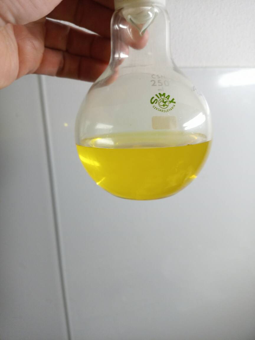

Also KClO3 was tested as oxidant and it indeed works. At high Cl(-) concentration, in acidic media, chlorate decomposes mainly to Cl2 and there are chlorination reactions based on chlorates, described in chemical literature.
Unfortunately, organic layer separating during the reaction has very suspiciously yellow color, I am almost sure that it is ClO2 extracted to organic layer. As potentially very dangerous mixture to distill, the idea was abandoned. I have found "chlorine generator" description, where Cl2+ClO2 mixture is generated from KClO3 and HCl(aq), ClO2 is then removed by Mn(II) salts solution (in separate vessel). Maybe small amount of Mn(II) would act as ClO2 remover ( ClO2+Mn(II) → Cl(-) [or Cl2] + MnO(OH)2 ) also in chlorinating solution, but it was not investigated. KClO3 methode is very convenient for preparing bromoderivatives, because Br(-) is much better reductor than Cl(-). One must be careful, because chloroacetone is onion-like toy comparing to, for example, bromoacetophenone.

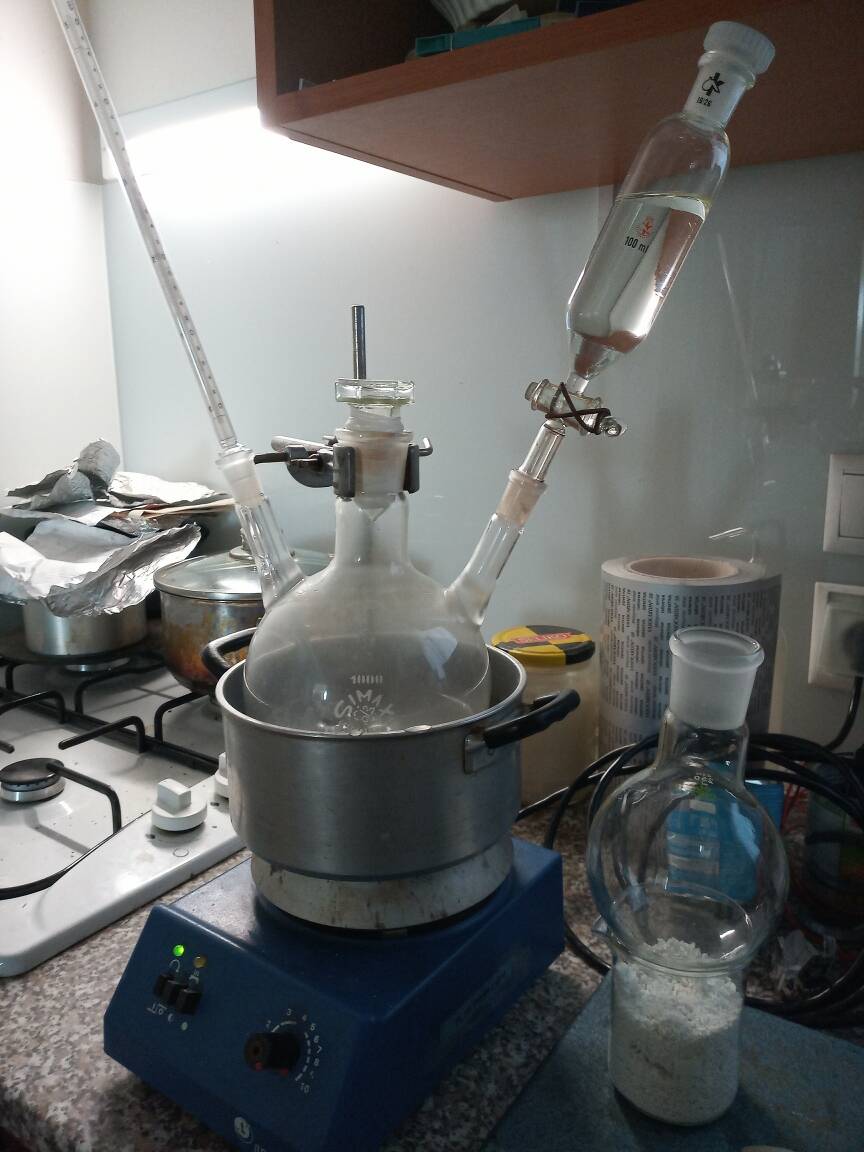

[*] posted on 4-2-2025 at 12:28

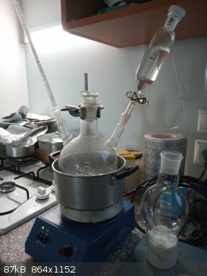

I tried commercial 70% calcium hypochlorite instead of KMnO4 and 35% HCl instead of mixture of NaCl + H2SO4
2 CH3-CO-CH3 + Ca(OCl)2 + 2 HCl -> 2 CH3-CO-CH2-Cl + CaCl2 + 2 H2O
1 mol acetone (M=58,1 g.mol-1) 58,1 g
0,5 mol Ca(OCl)2 (M=143 g.mol-1) 75,1 g, 70% = 107,3 g
1 mol HCl (M=36,46 g.mol-1) 36,46 g (35% = 104,2 g, density 1,18 g.cm-3 = 88,3 cm3)
2-fold excess of acetone
116,2 g (density 784 kg.m-3) = 148 cm3

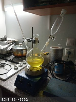

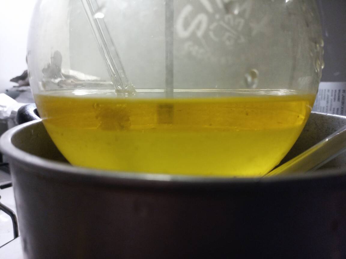

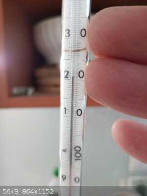

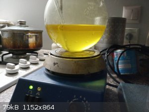

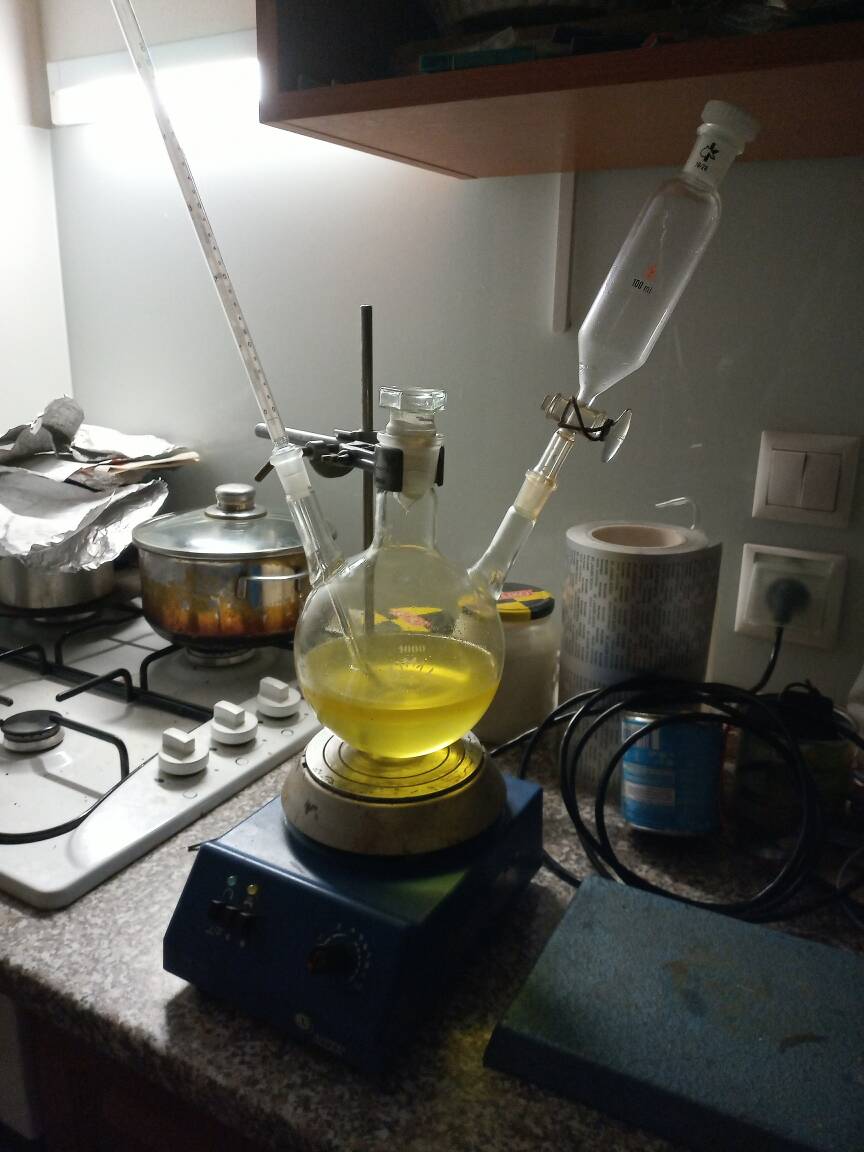

Into 15 C cold water bath was immersed 3 neck 1 liter round bottomed flask. A thermometer was inserted into 1 neck of the flask, 100 cm3 dropping funnel was mounted into second neck of the flask and a stir bar was added into the flask. 150 cm3 of acetone (2 fold excess) was added into the flask and 100 cm3 of tap water. 100 cm3 35% HCl (circa 10% excess) was put into dropping funnel.
During the reaction (which is slightly exothermic) the 15 C cold water bath was refreshed every time it reached 20 C by draining out all water and replacing with fresh 15 C tap water. Later was also tried draining part of the water and addition of snow to keep the bath temperature in range 15-20 C which also worked well.
Magnetic stirring was started and circa 1/4 of the HCl (25 cm3) was slowly dropped into the flask. Totally 107,3 g of 70% technical grade Ca(OCl)2 was added in circa 1 grams portions using small plastic spoon through the third widest neck of the flask (29/32 ground glass joint) and the neck loosely stoppered after every addition. The temperature of the reaction was kept in range 25-30 C by adjusting the rate of the Ca(OCl)2 addition. After about 20 g of Ca(OCl)2 was added, another 1/4 of the HCl was slowly dropped into the reaction, after totally 40 g of the hypochlorite another 1/4 of the HCl was dropped into the reaction and after totally 60 g of hypochlorite the rest of the HCl was dropped in. In such a way there is always excess of HCl and the reaction runs in strongly acidic environment (in alkaline it would react into chloroform). The addition of hypochlorite lasted totally 3 hours. Then the water bath was removed and the reaction was stirred at room temperature for another 30 minutes. There were 2 layers visible, bottom water layer and top organic layer.

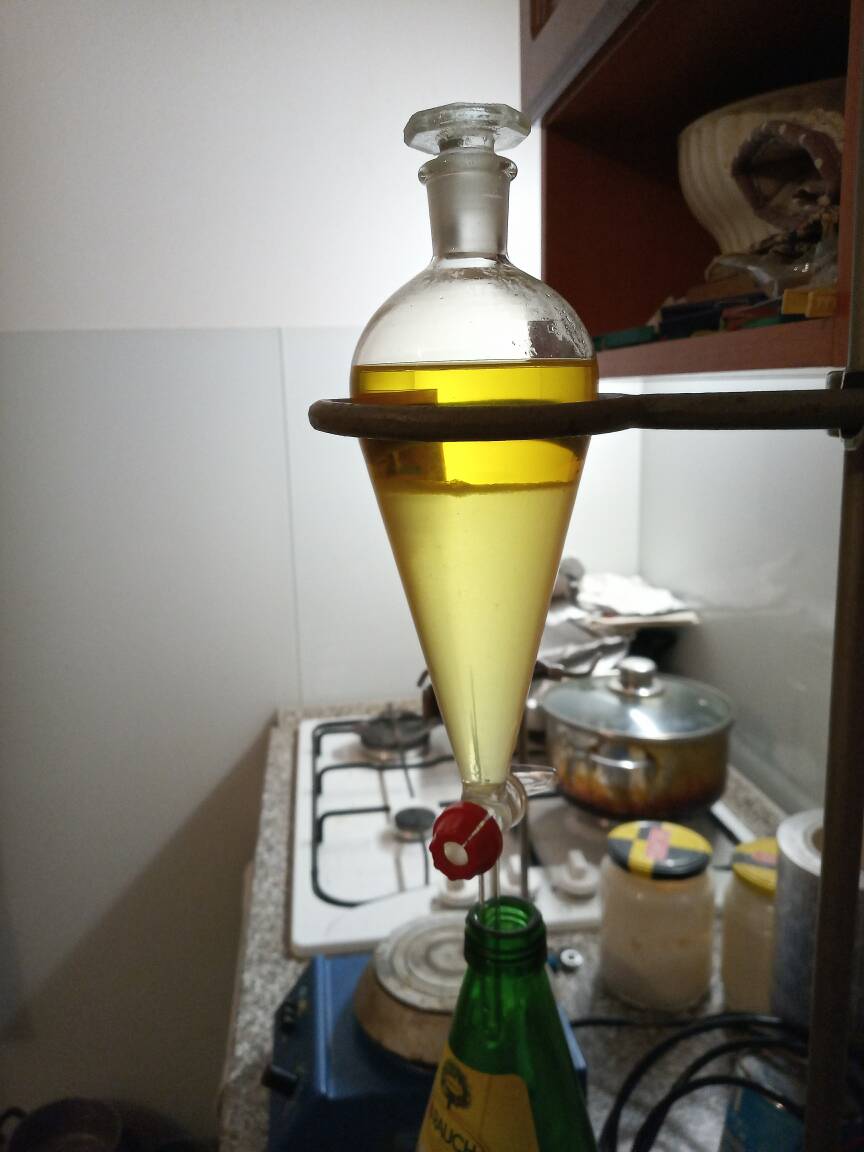

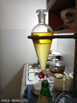

The mixture was transferred into separatory funnel, upper organic layer was separated and transferred into 250 cm3 flat bottom flask.
Weight 114,7 g. M = 92,52 g.mol-1. The crude product must contain some acetone because theoretical 100% yield is 92,5 g.
KMnO4 estimated acetone content about 20% which matches.
Also some aldol condensation products of the acetone like mesityl oxide or diacetone alcohol could be present.
1,5 g of CaCO3 was added, stirbar, flask was stoppered and magnetically stirred for 1 hour, then kept in fridge at +4 C.
Excess of acetone was not distilled out as it does not cause any problems in the following intended reactions. The distillation of the chloroacetone was not performed either.
The apparatus and the beginning of the reaction, after dropping 1/4 of HCl and before addition of the hypochlorite
IMG_20250204_154556_4.jpg - 87kB
near the end of the reaction, after addition of last 1 g of Ca(OCl)2
IMG_20250204_181936_9.jpg - 46kB IMG_20250204_181948_8.jpg - 92kB

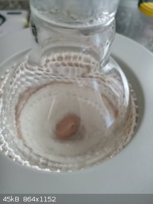

all hypochlorite added and after removing water bath, still continuing magnetic stirring
IMG_20250204_183017_6.jpg - 79kB

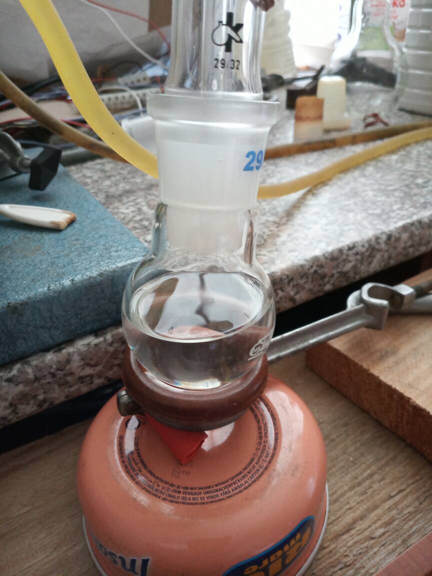

the reaction was completed and stirring stopped
IMG_20250204_194023_8.jpg - 82kB

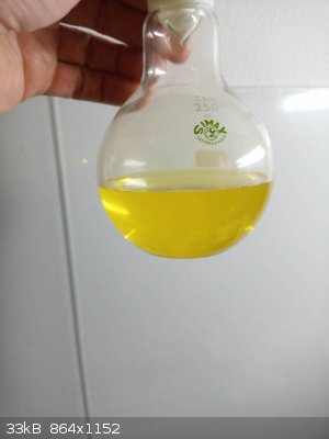

separating upper organic layer
IMG_20250204_200418_6.jpg - 64kB
crude chloroacetone product
IMG_20250204_202148_7.jpg - 33kB
[Edited on 5-2-2025 by Fery]

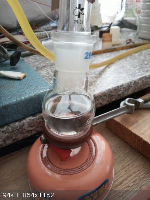

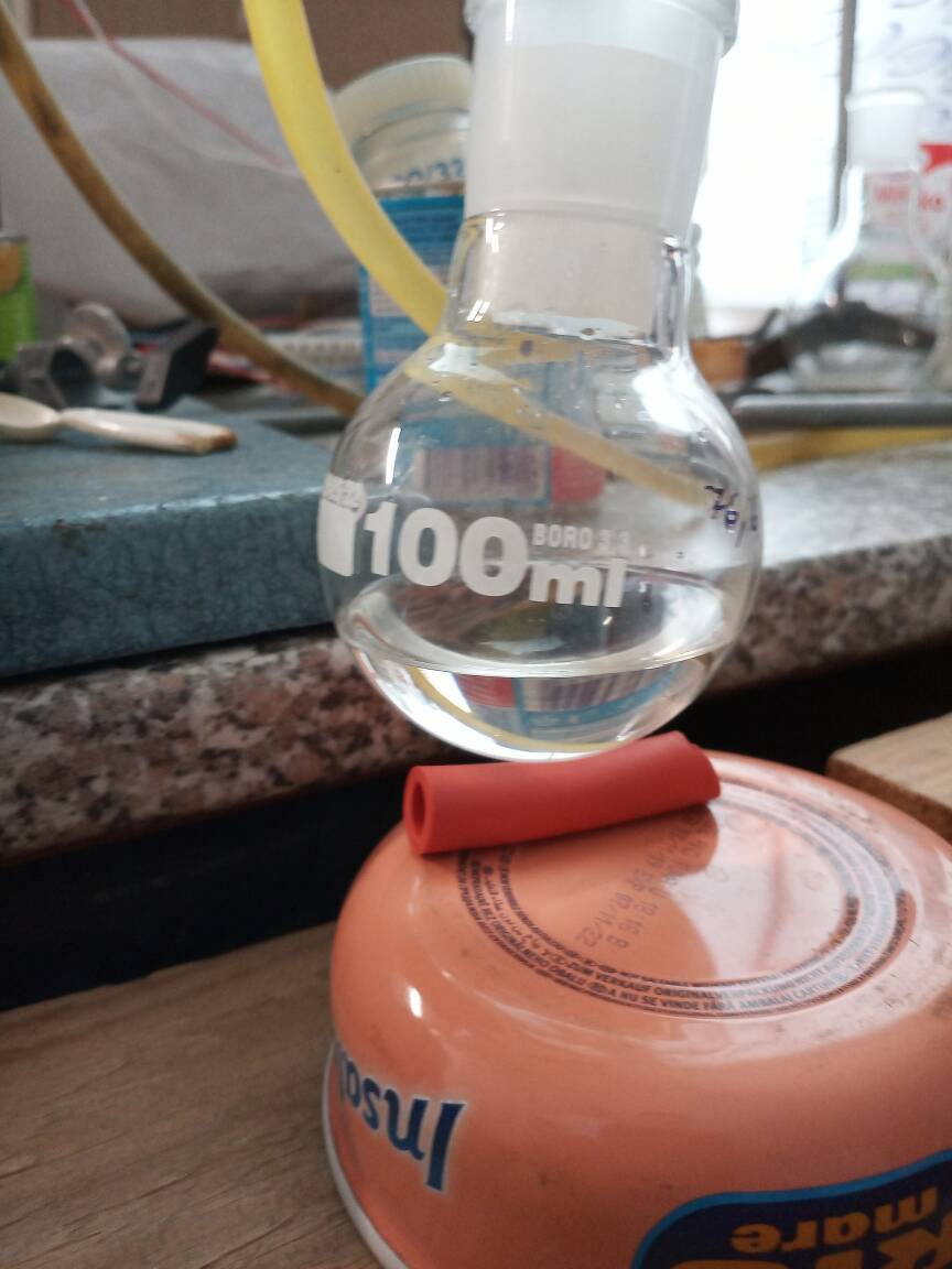

[*] posted on 9-3-2025 at 09:58

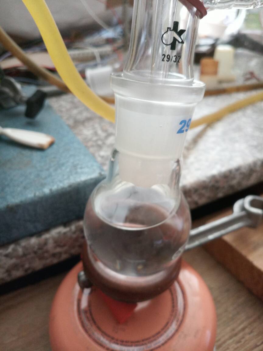

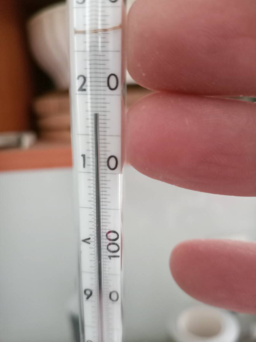

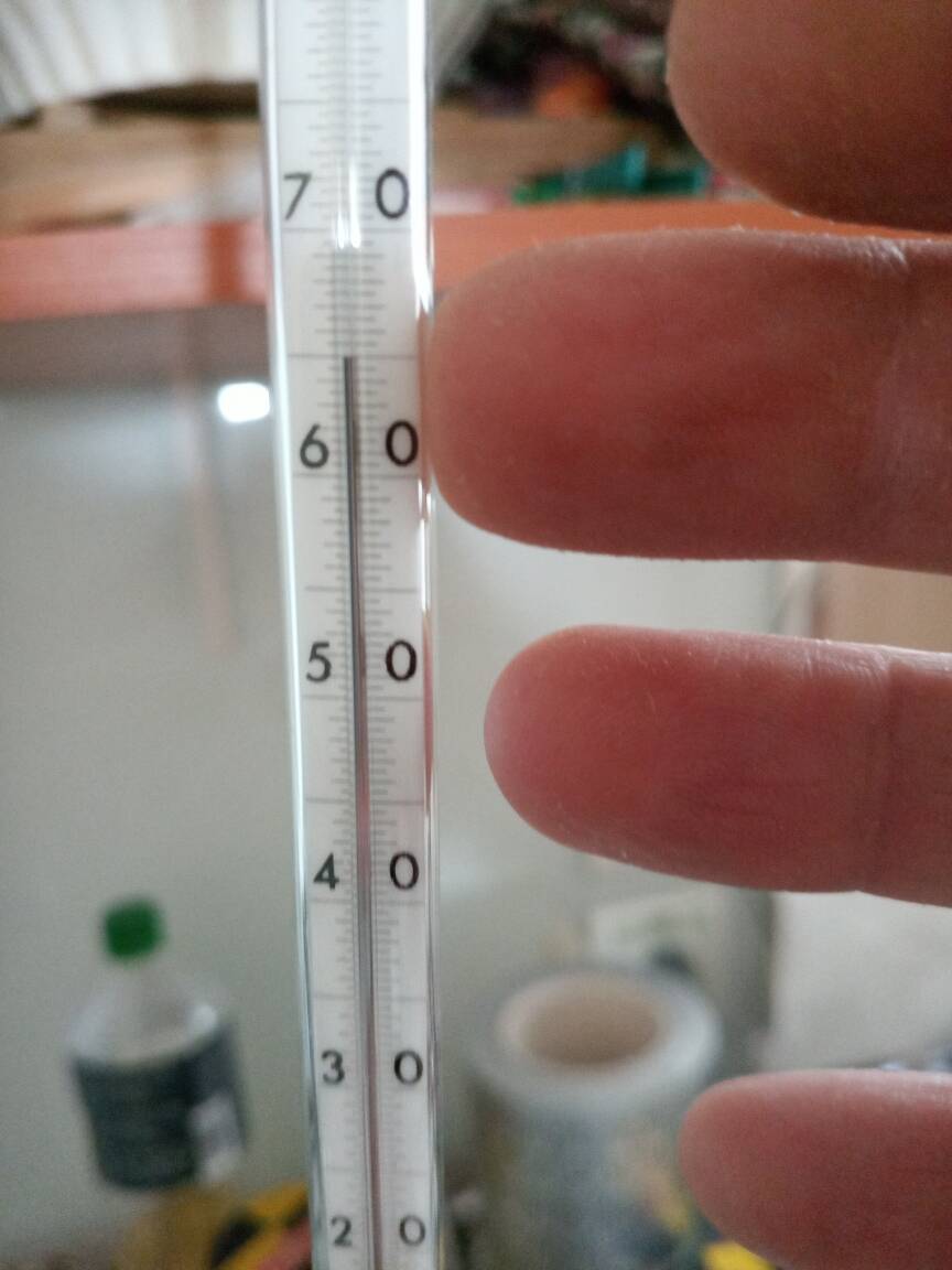

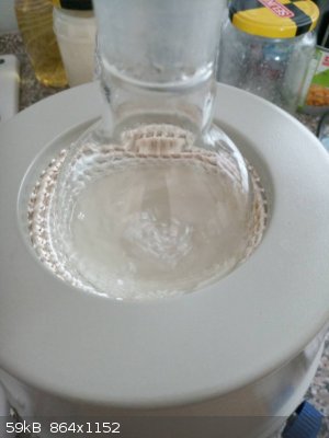

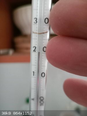

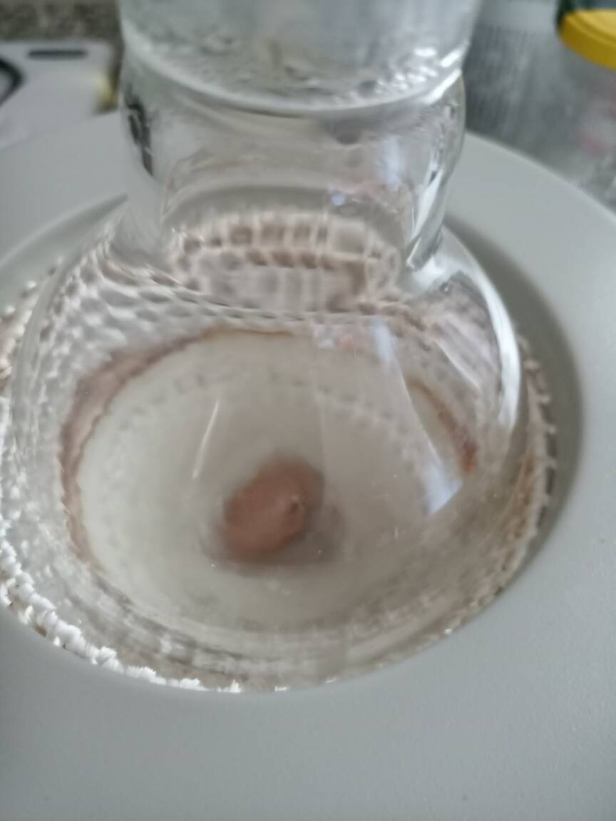

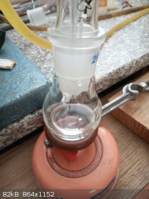

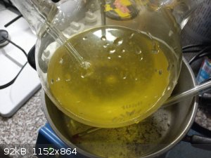

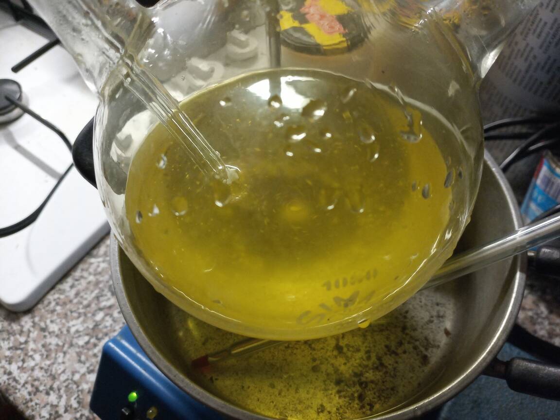

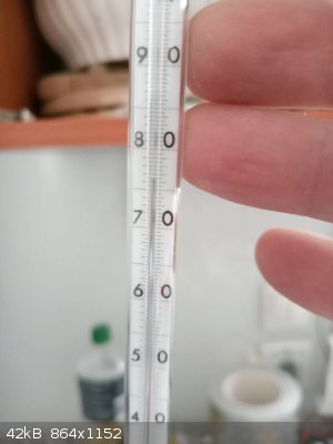

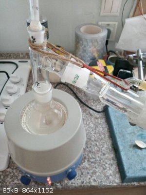

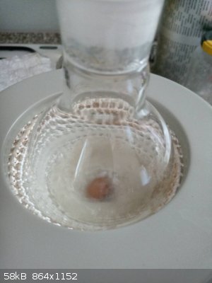

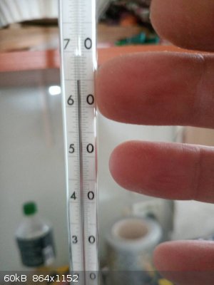

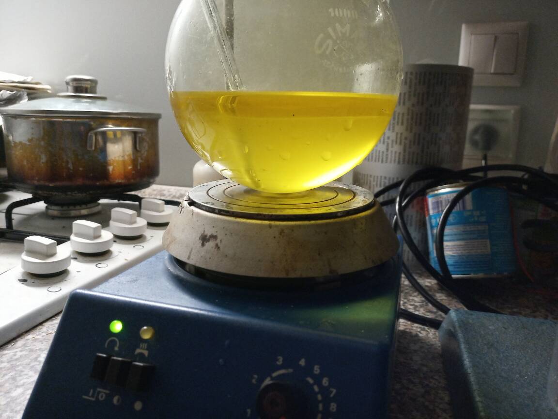

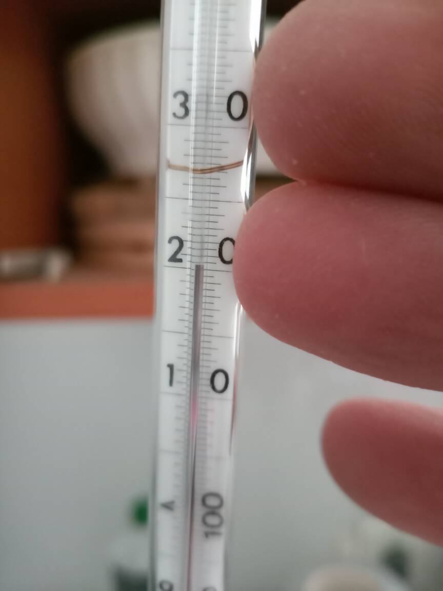

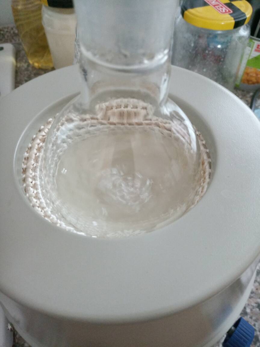

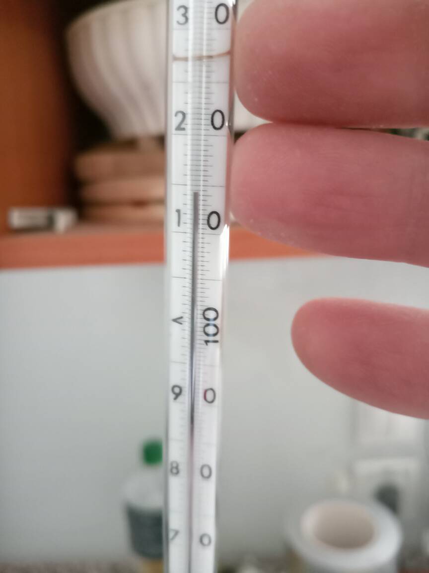

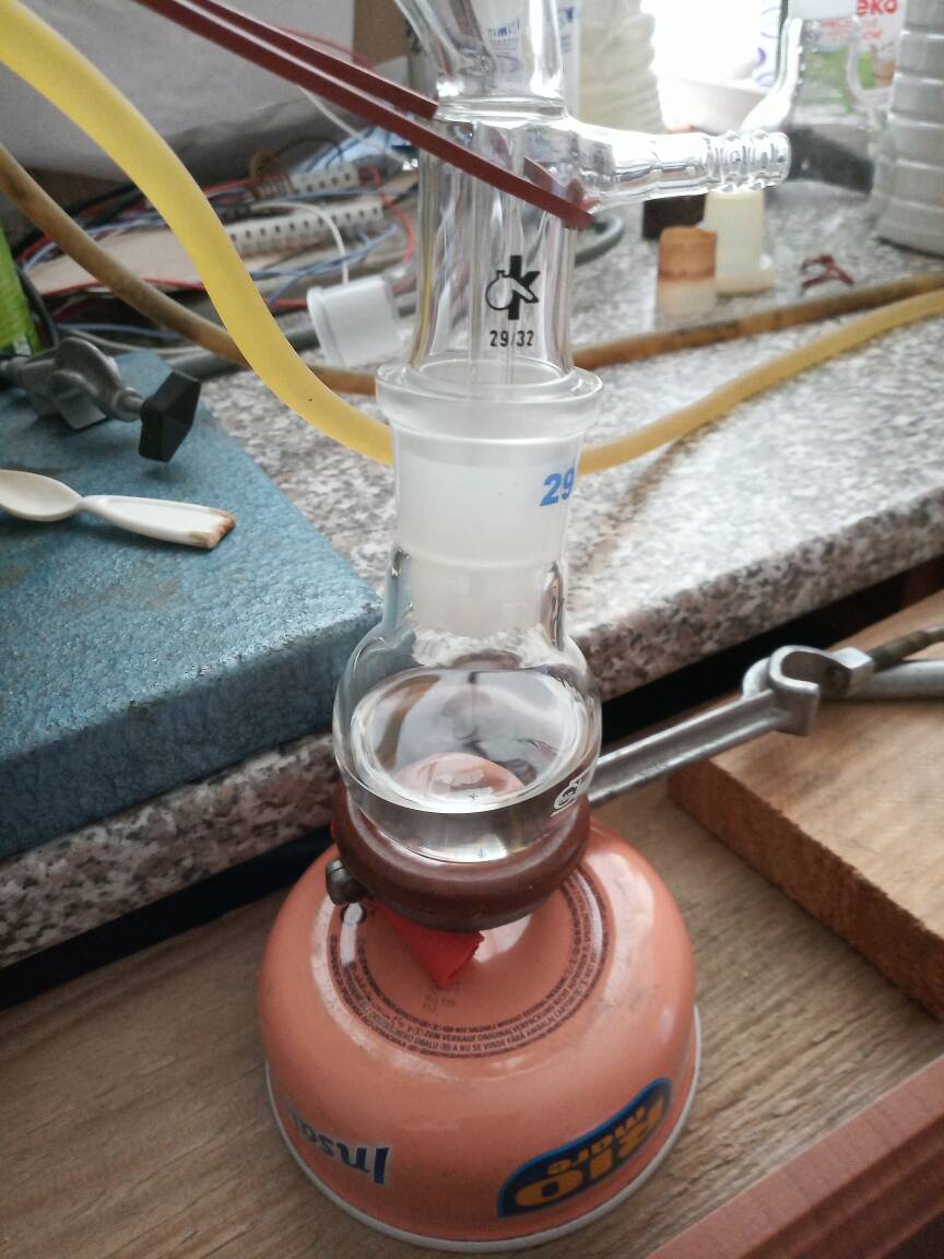

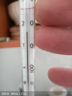

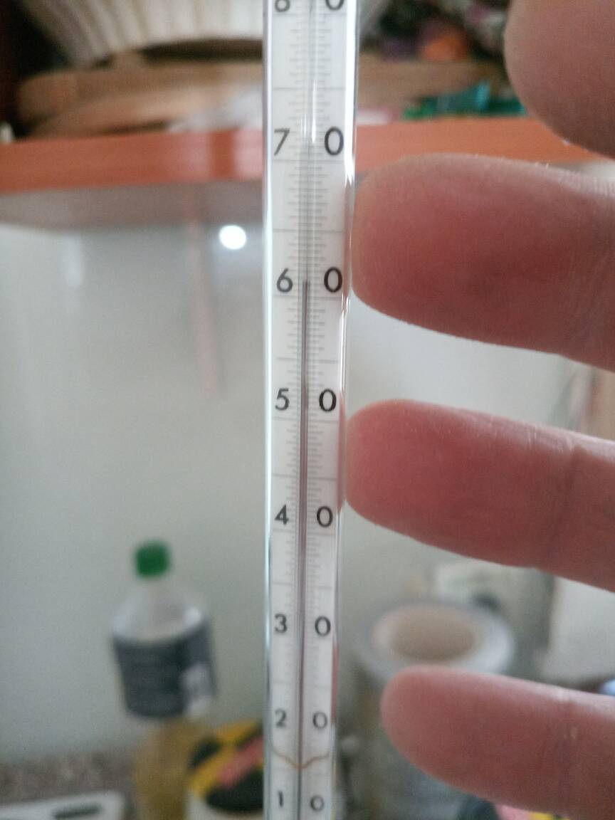

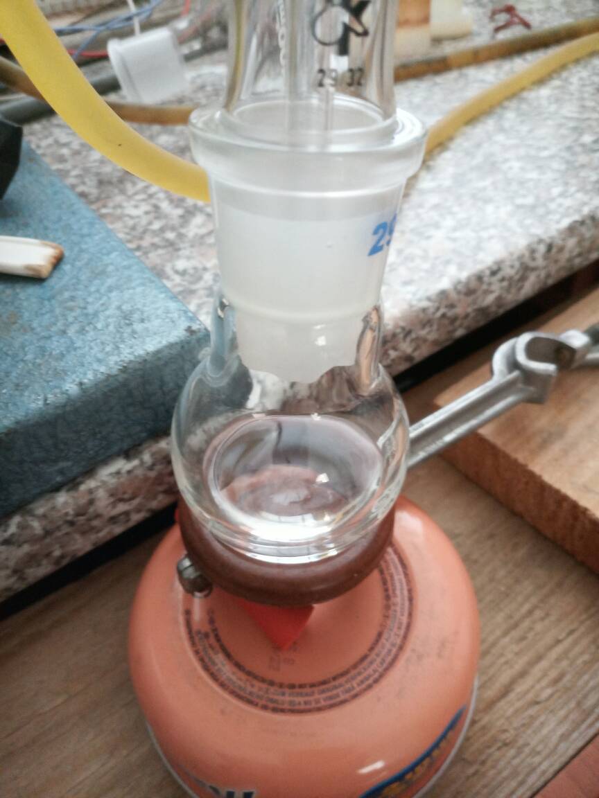

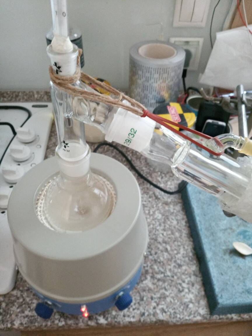

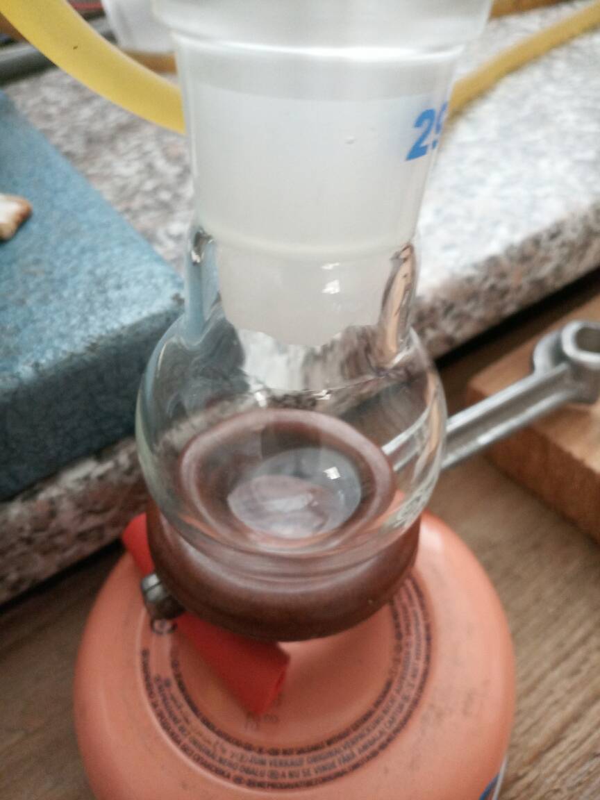

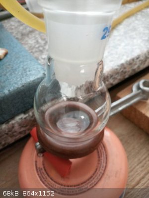

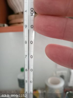

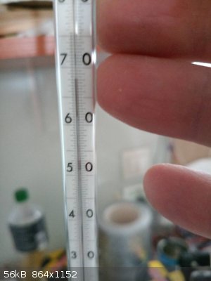

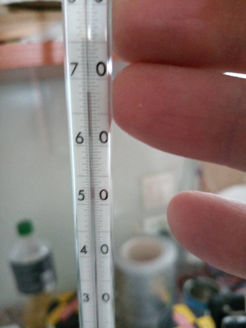

I repeated the same experiment using the same amounts of acetone, water, 35% HCl, 70% Ca(OCl2) and tried to keep temperature as low as possible. Under 10 C (I even reached 2 C using water/snow bath - it was just an attempt to reduce dichlorination and to produce only monochloroacetone) the reaction was too slow and Cl2 gas build up in pressure (I tried to tightly stopper the flask and while trying to drop HCl the gas from the reaction flask escaped backwards through the stopcock into the dropping funnel, there was terrible scent of Cl2 present, also 35% HCl changed color from colorless to yellowish).
I had to keep the temperature not so much low, so I returned into 20-25 C range. The yield of crude product was 5 g less due to some escaped Cl2 in the beginning when I tried the reaction at too low T.
Then I let the crude product to sit over CaCO3 for 1 month and its color changed from yellow into colorless. I decanted it into clean 250 ml RBF, added a little of CaCO3 and performed simple distillation.
fraction 61,0 - 117,5 C containing acetone and chloroacetone 63,1 g
fraction 118,0 - 122,0 C containing chloroacetone 35,9 g

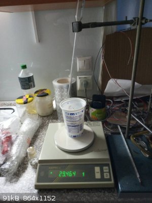

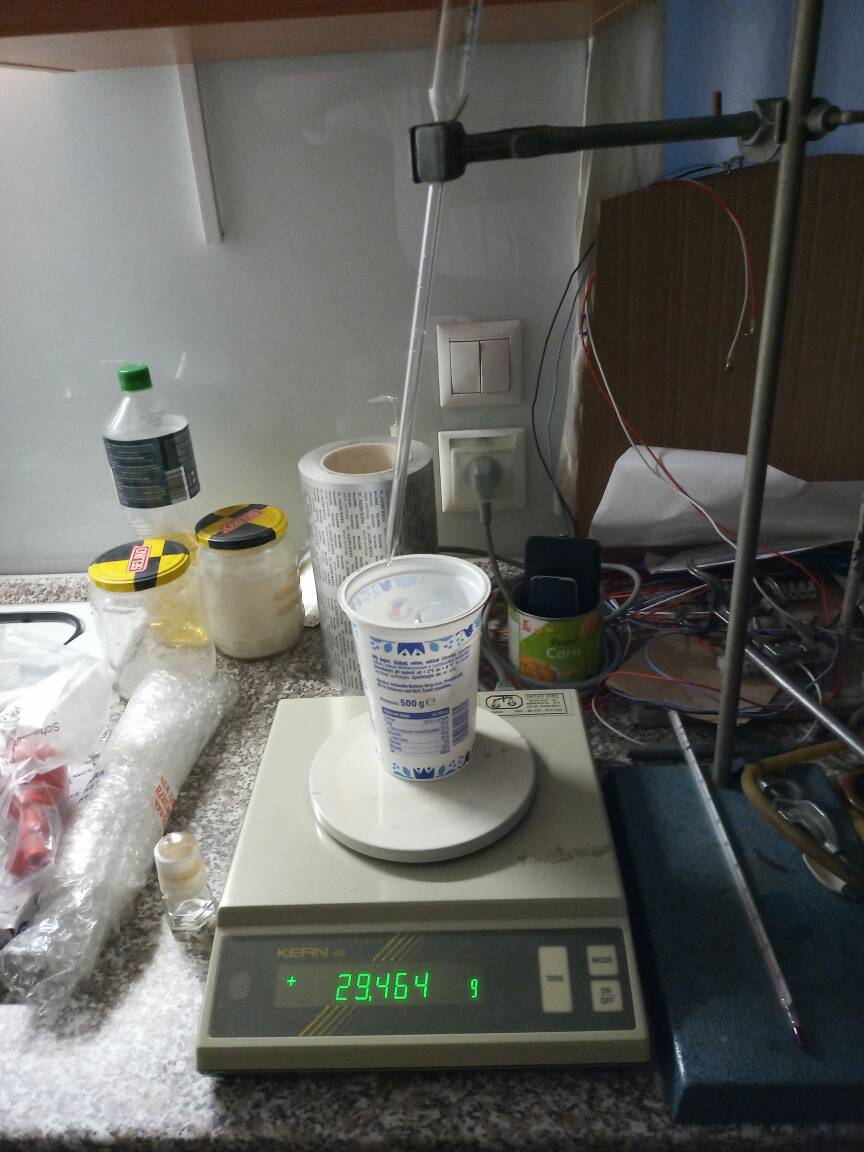

I measured the density of the 35,9 g fraction in a lazy way just from a pipette (I did not want to breathe it when drying excess of the lachrymator from a pycnometer)
weight 29,464 g for volume 25,0 cm3 at 18,0 C
density 1,179 g.cm-3 which nicely matches monochloroacetone, density 1.162 g/mL at 25 °C (lit.)
There seems not to be significant amount of dichloroacetone present, density 1.327 g/mL at 25 °C (lit.)
Seems 2-fold molar ratio of acetone in excess and keeping T in range 20-25 C is enough to produce only monochloroacetone and prevent dichlorination. It is impossible to separate monochloroacetone and dichloroacetone by simple distillation (b.p. difference between 1,1-dichloroacetone and monochloroacetone is only 2-3 C).

IMG_20250309_125846_0.jpg - 85kB IMG_20250309_130124_8.jpg - 56kB IMG_20250309_130217_6.jpg - 68kB IMG_20250309_130239_8.jpg - 60kB IMG_20250309_130934_5.jpg - 82kB IMG_20250309_130943_3.jpg - 56kB IMG_20250309_131158_6.jpg - 59kB IMG_20250309_132030_8.jpg - 106kB IMG_20250309_132045_1.jpg - 42kB IMG_20250309_132612_6.jpg - 94kB IMG_20250309_132626_2.jpg - 40kB IMG_20250309_133345_4.jpg - 70kB IMG_20250309_133357_5.jpg - 39kB IMG_20250309_133727_5.jpg - 108kB IMG_20250309_133739_3.jpg - 38kB IMG_20250309_133746_6.jpg - 58kB IMG_20250309_134127_0.jpg - 73kB IMG_20250309_134155_3.jpg - 38kB IMG_20250309_134206_0.jpg - 45kB IMG_20250309_134514_7.jpg - 56kB
