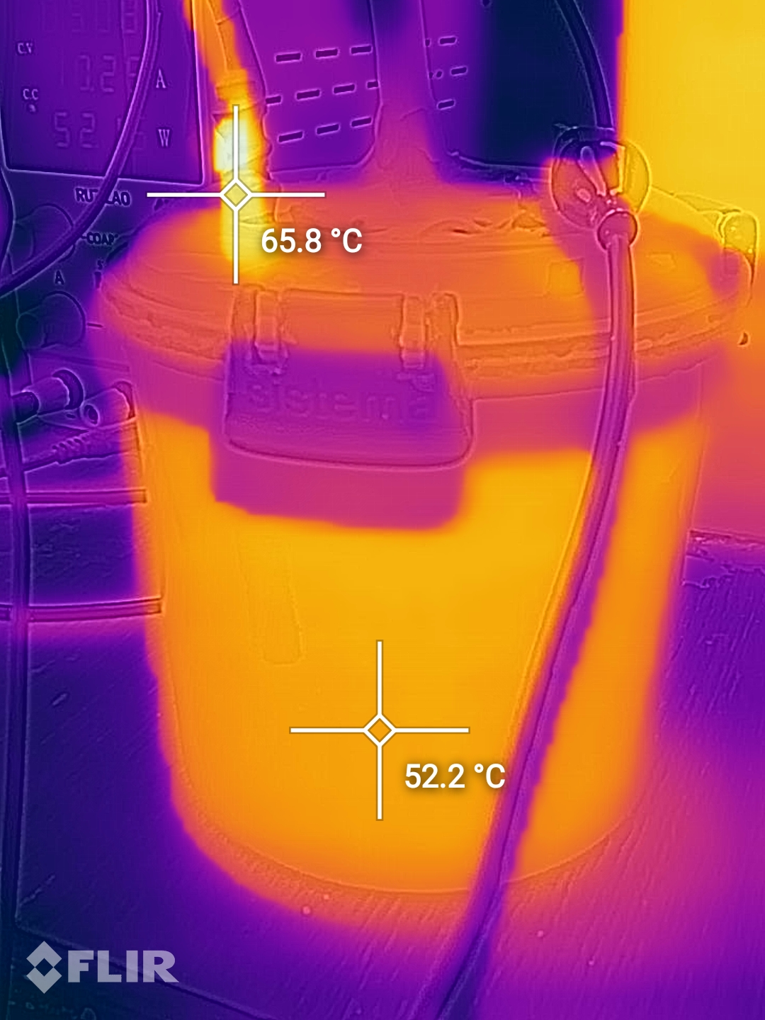

5.8v @ 5amps
You can see the temperature is holding at 52 deg C.
ps. My phone has a Flir thermal imaging camera which is really useful.
