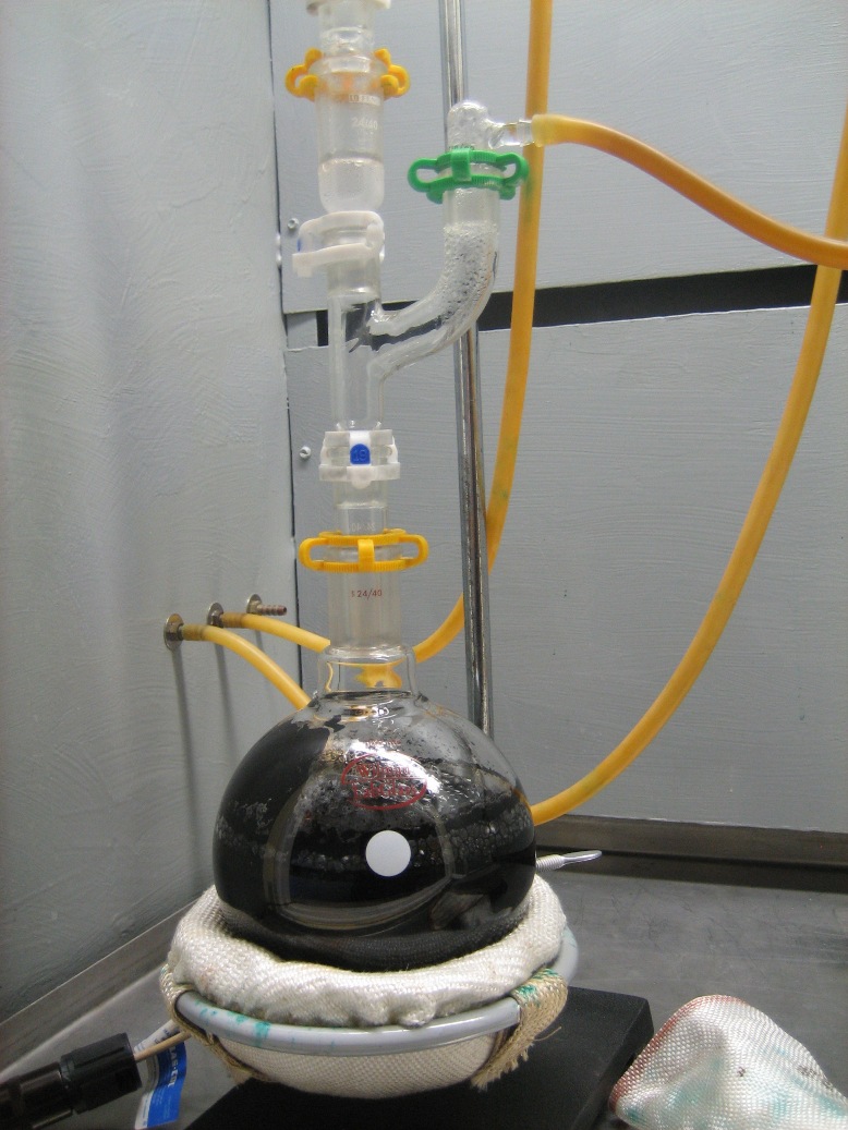

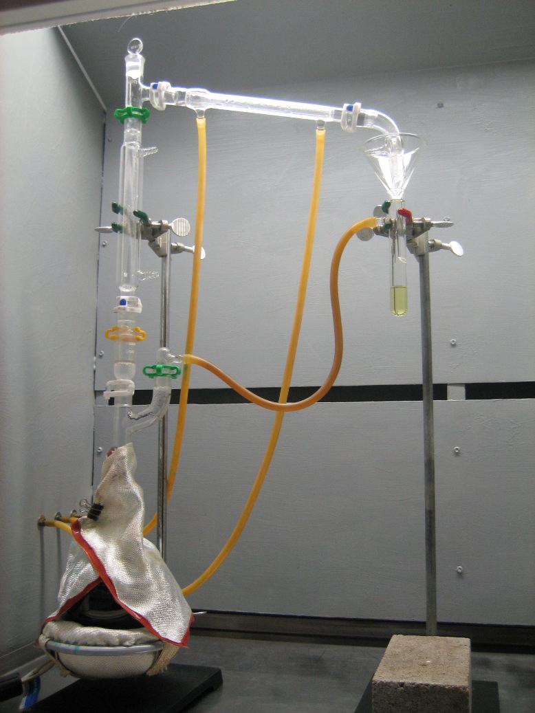

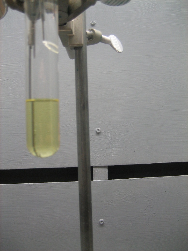

[*] posted on 25-4-2011 at 19:13
Disappointed with the yields of my previous experiments in making furfural, I tried again, this time with fairly good success.
I used a 1/10th scale version of the Org Syn procedure, substituting d-ribose for corn cobs. My pot was a 1000mL RBF with a Hempel column and whatever else I could find to build a long vertical tube. The receiver is a 25mL side-arm test tube. A picture of the assembly is shown below. It uses a Dean Stark mechanism to separate the furfural from the aqueous phase. Density of furfural is 1.159 @13C so it separates nicely from the water. Solubility in water is 9.1g/100, so it is advantageous to use as small a receiver vessel as possible.
I charged the pot with 500mL of 2.17N H2SO4, 200g NaCl, and 32g of food grade d-ribose. This was then set to boiling for 3 hours. As usual the pot contents turned black once boiling temperature was reached. So, all that carbon has to be considered a loss in yield. 8mL, or ~9.3g, of crude furfural was recovered as a translucent yellow liquid. This is a yield of 45.3% based on the d-ribose charged.
Questions, comments, and discussion are welcomed.

I think you might do a little better if you added some salt to the collection vessel. The solubility of organic chemicals in water is affected by the presence of other disssolved materials.
Also extraction with ether would probably get some more of the furfural out of product.

The small amount of water in the reciver (<20mL) becomes saturated with furfural early in the distillation. From then on the furfural just drops out and settles on the bottom of the test tube. The water in the tube is continually being dribbled back to the pot and refreshed with incoming distillate. I agree that at the end of the distillation I should be able to drive the 8% or so of dissolved furfural out of the water by adding salt.
Yes, ether would be a good solvent but then there is the mess and stink of handling it. On this small scale I don't see it being worth the effort.
As you say, a little black goo goes a long way. I just emptied this flask. Because of the remaining salt it is a little hard to quanitfy the amount of carbon. Several grams is about all I can say.
In August when Mrs Magpie cooks "sweet corn," ie, "corn-on-the-cob," I may give corncobs a try.
