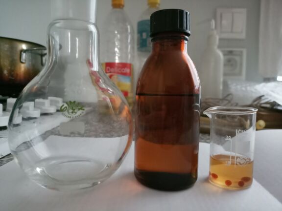

isohexanes fraction + circa 60 drops of forerun (left, 250 ml FBF), main fraction (middle, amber flask, capped), remainder from the distillation flask (right, circa 10 ml, transferred into 20 ml beaker, there are also glass balls used as a boiling stones)
