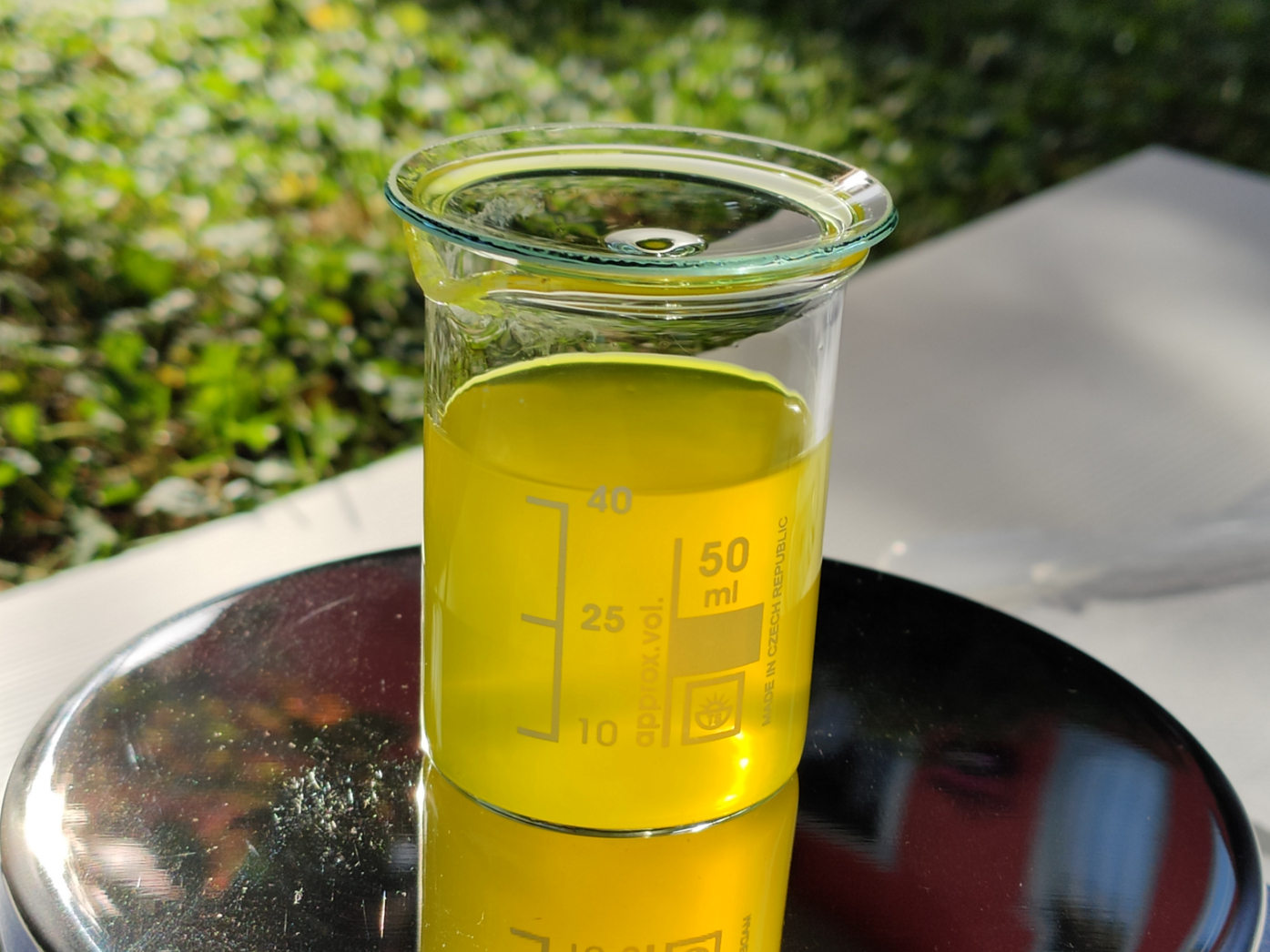

I prepared a water solution of ammonia and acetylacetone, with a 50% excess of acetylacetone. I started adding 4.25 mL of acetylacetone in a beaker and then added about 2.8 mL of 23% ammonia. This mixture solidified and this could be, in my opinion, the main cause of the low yield. I then added water, and the solid dissolved (with the help of low heating). I should have added water before adding ammonia. Total volume was 25 mL with a slightly yellow color.
When I was ready, I dumped the solution of acetylacetone and ammonia in the lanthanum(III) chloride, with stirring. The reaction I would expect is:
LaCl3 + 3 Hacac + 3 NH3 --> La(acac)3 + 3 NH4Cl
The solution turned a bright yellow after few seconds and after less than a minute, a precipitate started to form.

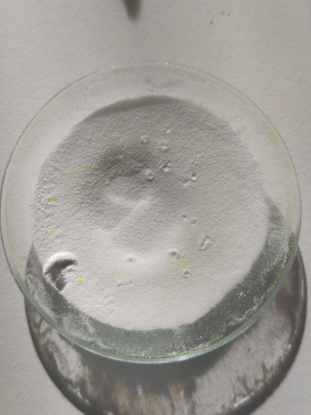

The next day I vacuum-filtered the solid and put in a desiccator over NaOH.
IMG_20211112_205559.jpg - 838kB

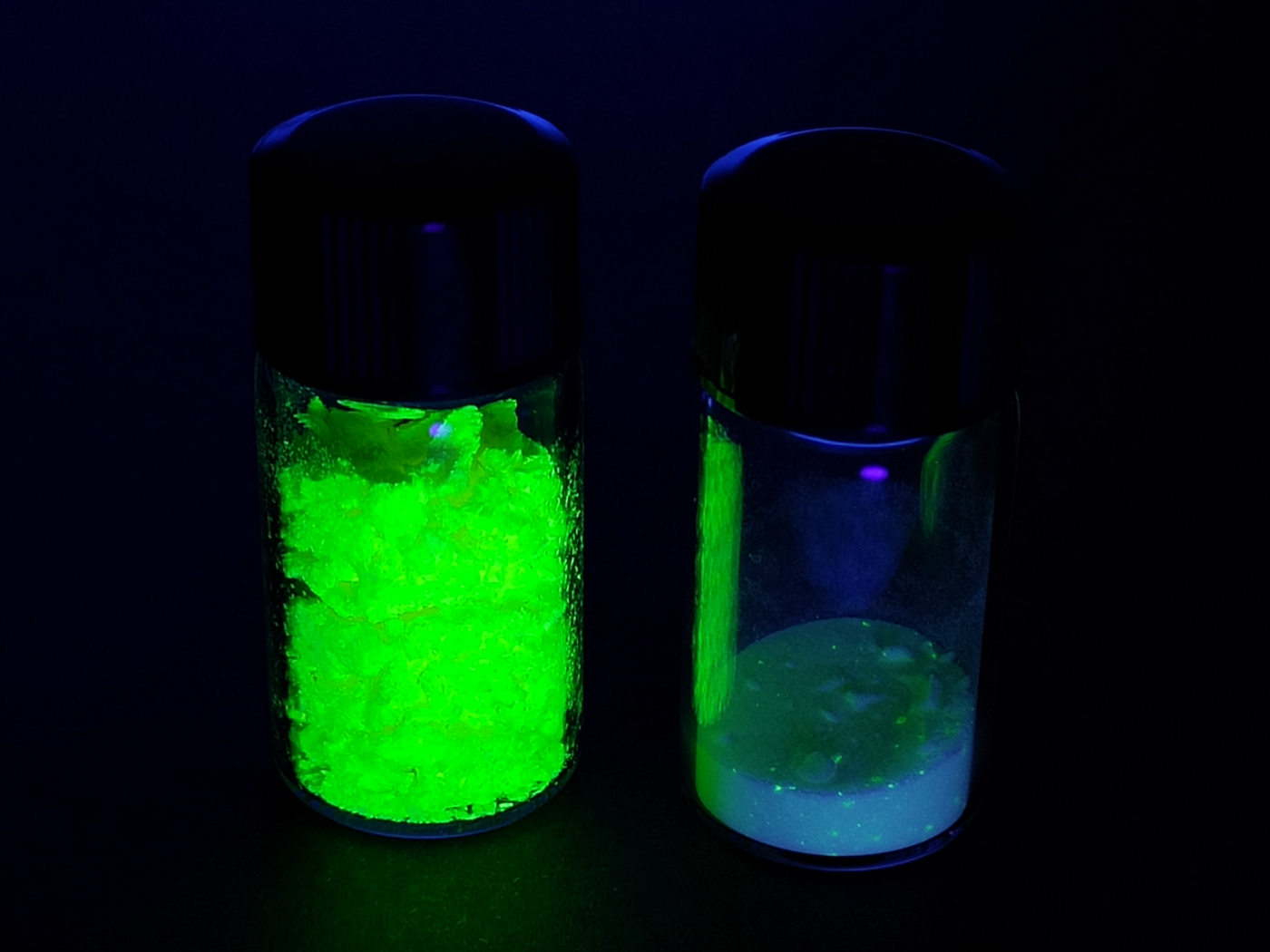

The dry solid weighed 3.04 g. It was bright yellow in color, and under long-wave UV light it was strongly fluorescent (green). It was very similar to the mineral autunite in both color and fluorescence.

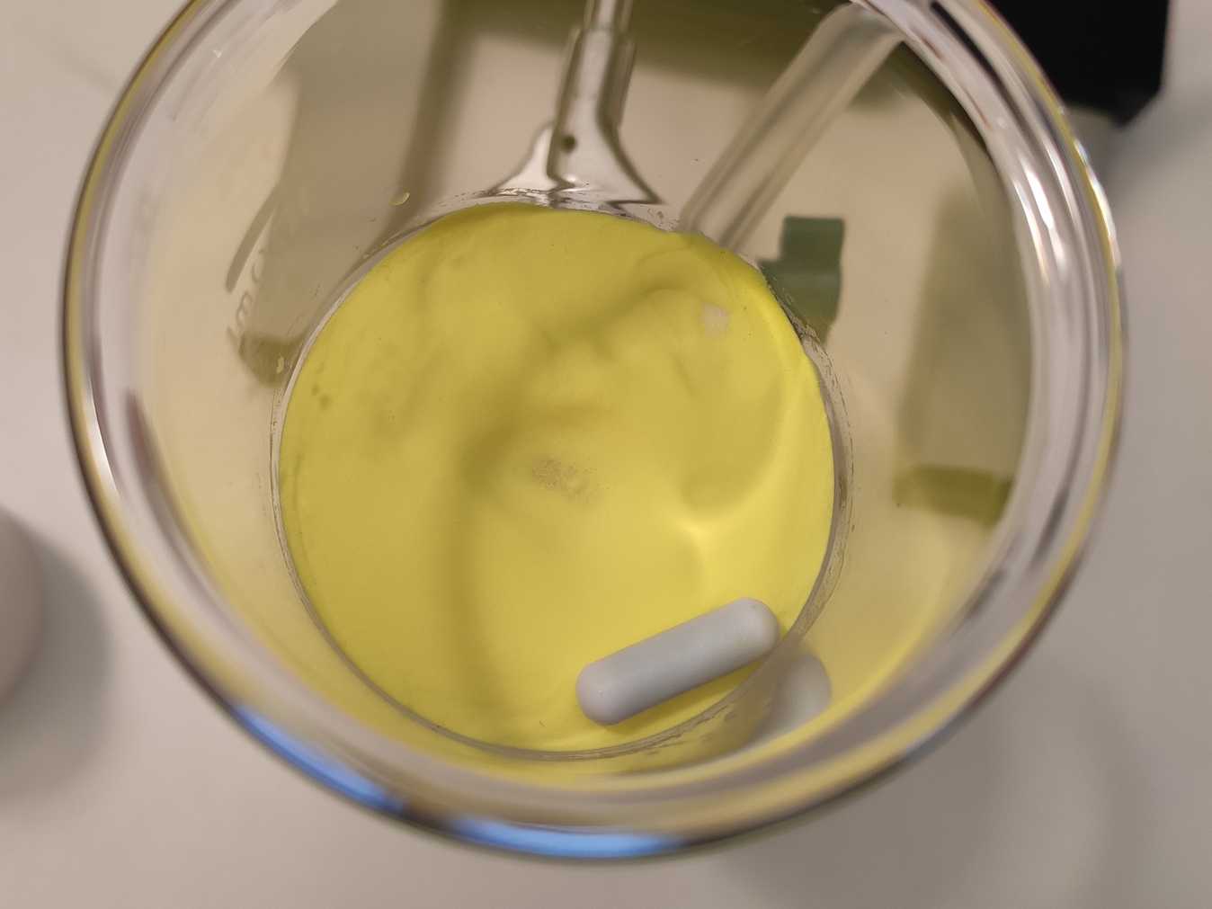

Some weeks later, I decided to try recrystallizing the compound. I dissolved all of the solid in about 40 mL of hot (almost boiling) 99% ethanol with a few drops of acetone. The solution was slightly turbid.
IMG_20211112_205731.jpg - 1.1MB
On cooling, a fine crystalline precipitate formed.
IMG_20211112_205747.jpg - 1020kB
The mixture was then placed in an ice bath. A lot of needle-shaped yellow crystals formed.

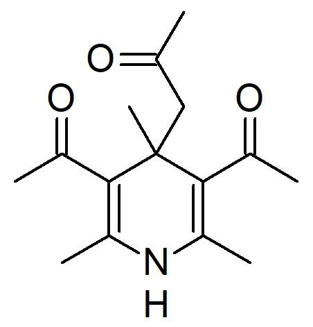

So probably a Hantzsch dihydropyridine synthesis occurred between three molecules of acetylacetone and ammonia? I also tried writing a mechanism and it could work. This would be the product:

I don't think my acetylacetone would be so much contaminated to obtain such a high amount of the compound. It is from ChemCraft and on the label it says >99.5%.

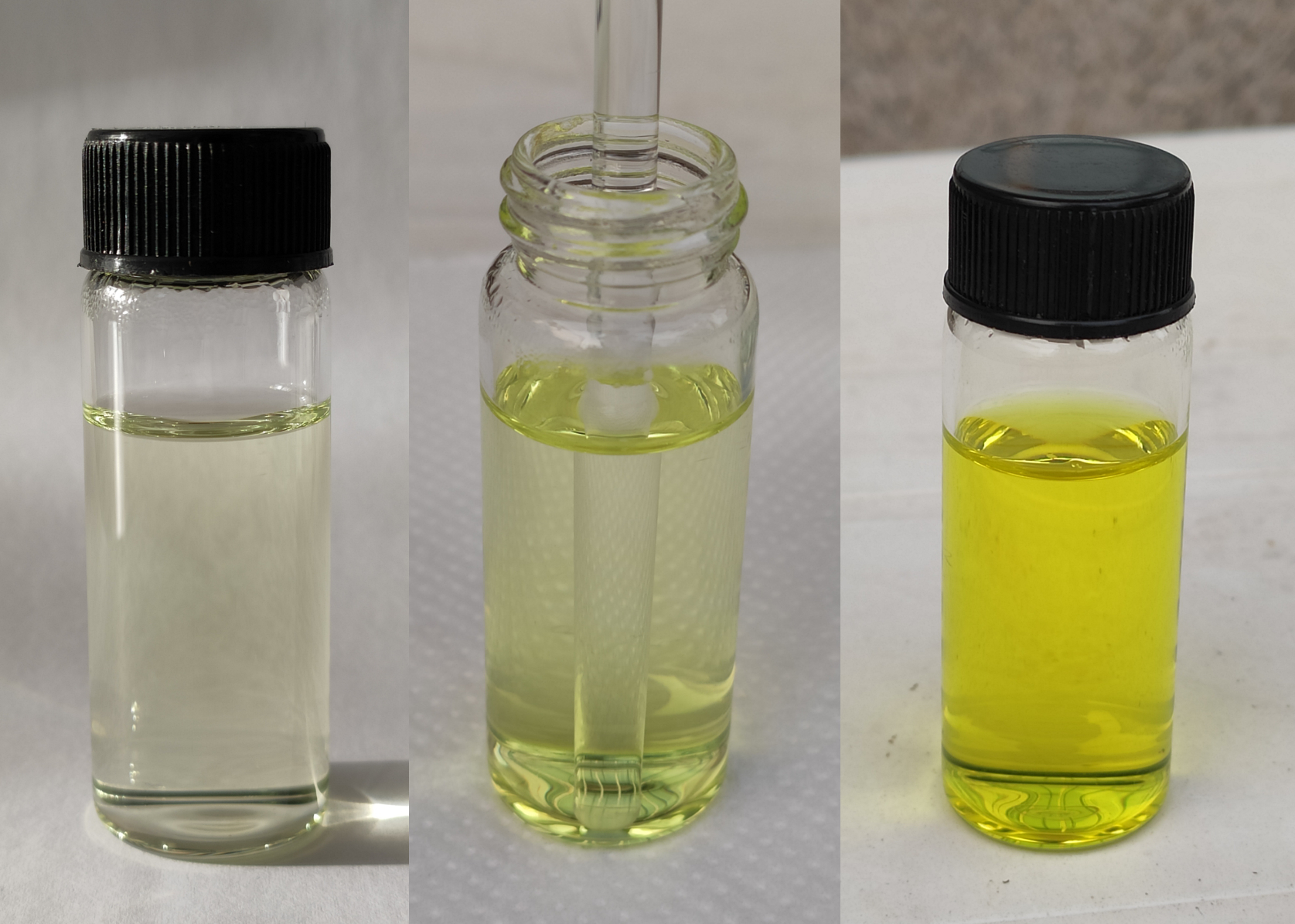

I've just finished trying the reaction of acetylacetone and ammonia.
I poured 1 mL of acetylacetone in a glass vial and added 0.3 mL of 23% ammonia. This is a 3:1 molar ratio between acetylacetone and ammonia. A whitish solid is formed immediately, and the mixture warms up a bit.
Depending on the light conditions and on the background, the material looks more whitish or more yellowish. It is soft.
IMG_20211117_155843.jpg - 1.5MB IMG_20211117_155917.jpg - 1.5MB

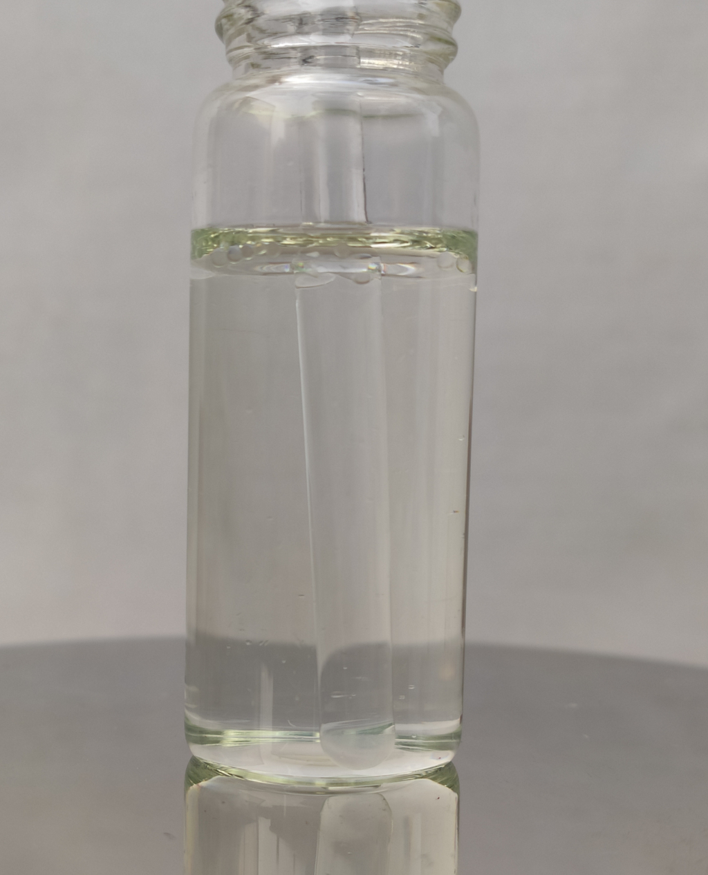

Next, I added some water (more than 10 mLs), and while stirring with a glass rod I heated the vial on the hot plate (low power).
The solid started dissolving forming an oil which was floating. After some minutes it all dissolved, producing a slightly yellow solution. The temperature was about 40 °C.
IMG_20211117_160158.jpg - 577kB
In this picture you can see some drops of the oil just under the surface of the liquid.
After few minutes I added again about 0.3 mL of ammonia, but nothing seemed to happen.
Now it's been about an hour and the solution looks the same.

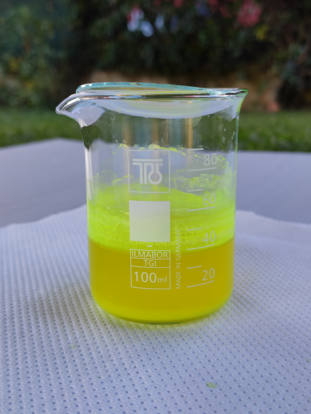

Ok, it's been about a day and the test solution is slightly more yellow, with a faint fluorescence under UV light.
When I made La(acac)3, the solution was kept at a pH of about 5, to prevent basic lanthanum products forming.
So I added to the test some drops of hydrochloric acid and mixed until the pH was about 5. The color changed to a vivid yellow, with green fluorescence under UV light. This must be the same yellow compound I obtained with La(acac)3.
IMG_20211118_151221.jpg - 1.1MB
No precipitation until now. Maybe the solution is too diluted.
