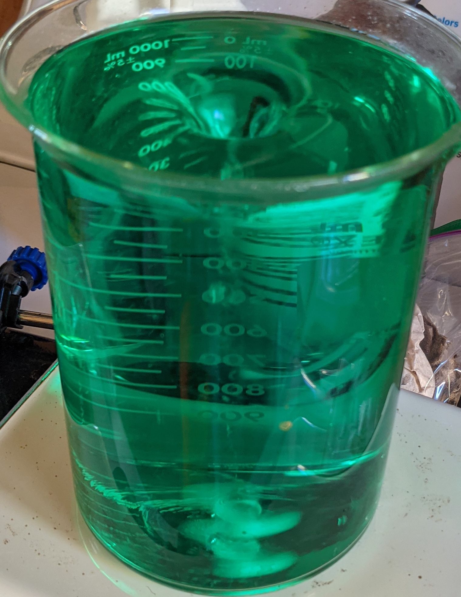

I have about 1500mL of liquid, so to reduce the volume I filled a 1L beaker and left it on a stir plate with heating. As the liquid warmed up, I
noticed a distinct color change from blue to green, with the evolution of HCl vapors(surely in excess and driven off by heat). I mixed 25mL of the
solution with 25mL of 10% janitorial ammonia and noted a deep purple color change suggesting metal complexes with the ammonia. I also noted white
mist forming when the beaker containing the mixture was placed near the heated beaker, indicating the formation of ammonium chloride vapors. After
some time, a white precipitate formed in the ammonia/chloride mixture(probably ammonium chloride).

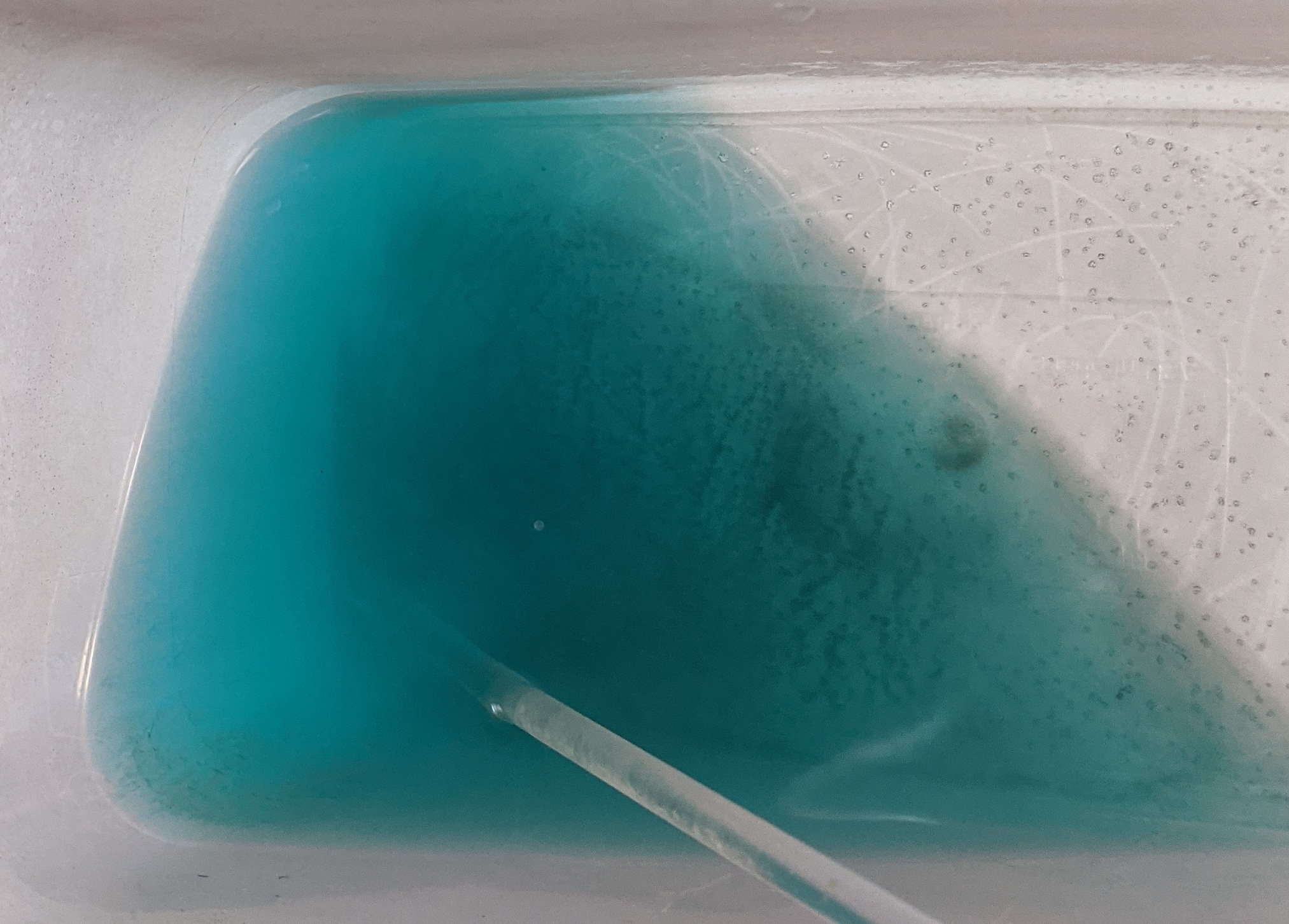

The most interesting thing to me, apart from the absolutely spectacular color of the ammonium mixture, is the color change upon heating of the
chloride mixture. I also noticed that as the mixture cooled down the pale blue color mostly returned, although there was still a slight difference
between the 500mL of unheated chloride solution.
Does anyone have a clue as to what is happening here? Am I driving off gasses and shifting the pH of the solution and causing a color change, or is
the heat shifting the equilibrium and driving the formation of larger chloride complexes?
I suspect I'm dealing with >90% copper chloride. Do solutions of pure copper chloride exhibit behavior like this? I'd test it out myself, but
right now I'm out of glassware until I can reduce the volume of the chloride solution.

Pictures of the solutions attached.
inanium
Posts: 13
Registered: 1-12-2020
Apparently the color change is just due to heat shifting the balance of the various complexes formed while in solution with free Cl ions: https://www.chemedx.org/blog/effect-temperature-chemical-equ...
