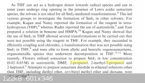

Thanks- I might have to try that (I've also found a prep for SmI2 using iodine and THF, but I don't have the latter ether- just diethyl. I may be
getting some glyme later on, but not sure if that will work).

I think that glyme should work. Book which I mentioned above mention SmI2 complexes with diglyme and diethyleneglycol. It also mention preparation in
different solvents than THF, including such a common solvents like acetonitrile, isopropyl alcohol or tert-butyl alcohol.
[Edited on 4-12-2021 by Bedlasky]
