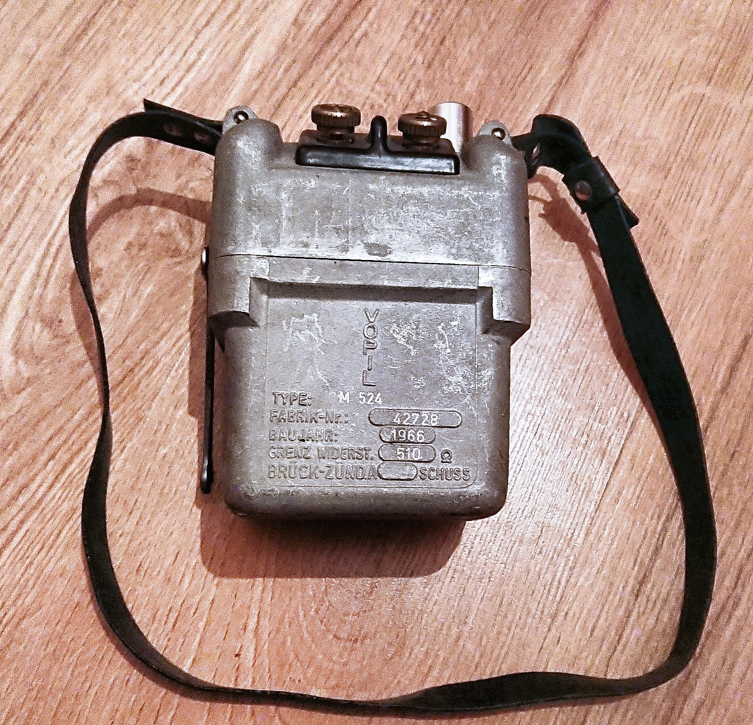

New toy VOPIL M524
2022-02-03-17-47-24-862.jpg - 1.3MB2022-02-03-17-48-42-216.jpg - 1.4MB

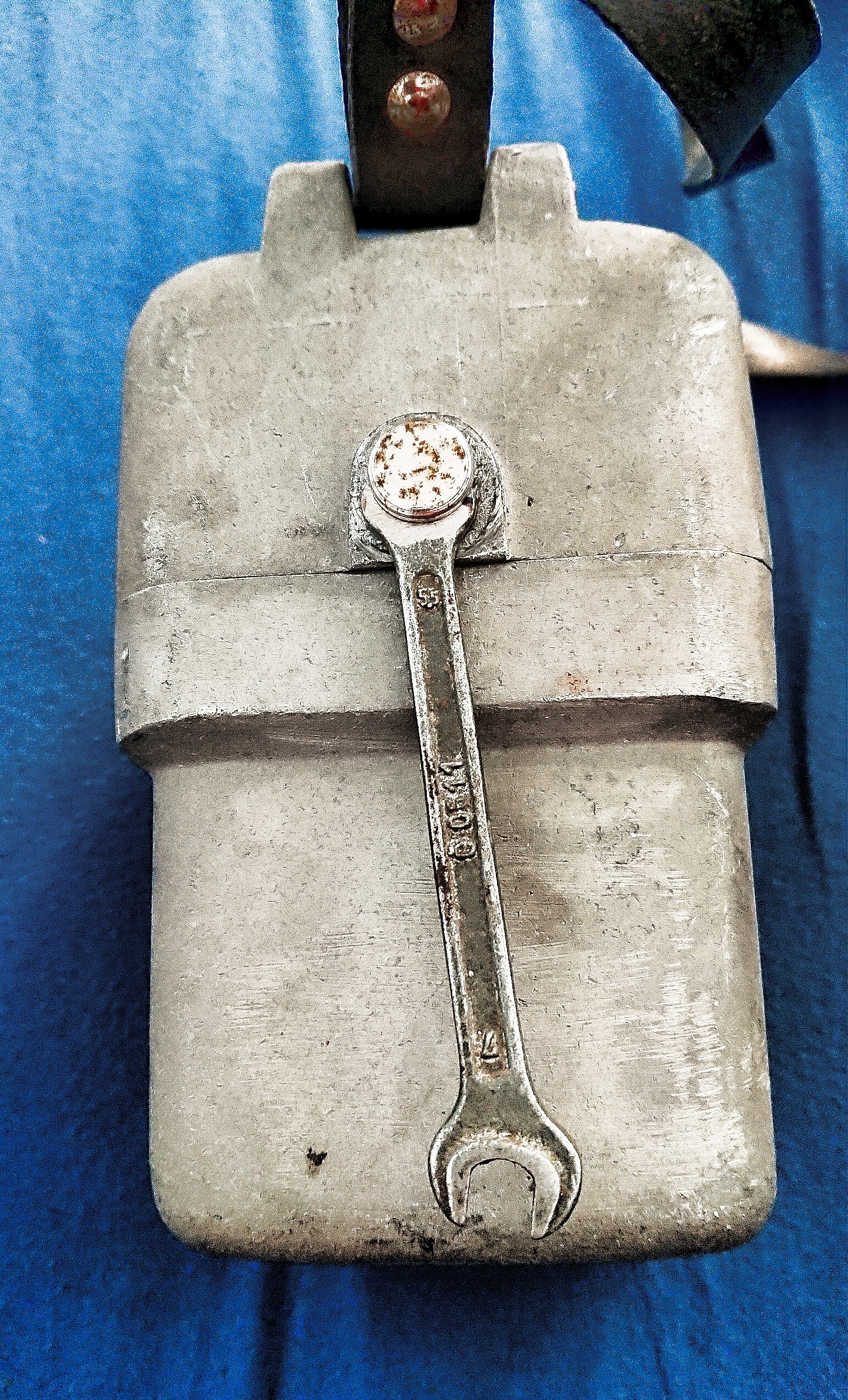

Upgrade
2022-02-06-18-44-17-963.jpg - 2.3MB2022-02-06-18-42-38-132.jpg - 2.5MB
