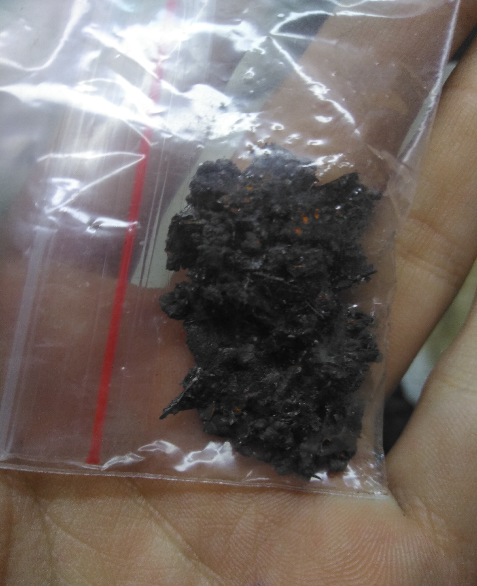

I just made pyrophoric iron again.
Steps of round 3 then dried under vacuum for 2 hours @ 100c. As soon as i started bleeding pressure back into the system, it started glowing. So i
stopped. I submerge the flask in a bath of co2 (vinegar + baking soda) then opened the flask and added mineral oil.
Id say on air, fine iron is more reactive than liquid sodium.

Final proposed procedure.
30g KHSO4
400 ml water
1 glass tubes (8mm id)
2 iron electrodes
5 amps
24 hours
1 50ml beaker
1 1000ml beaker
Okay, so a long sewing niddle for the cathode was causing partical size problems. I was pushing 5 amps on a surface area of about < 3mm. After
switching to a larger cathode, 3/16 rod, the flammable of the dry product is much less.
I'm thinking the stream on H2 was helping to reduce the partical size
By srouding the cathode in a glass tube, and suspending the electrode a few cm from the end of the tube, any orange non-magnetic floading stuff was
contained, then eventually reduced back to black non-magnetic floating powder, which after a few hours converted into black sinking magnetic
stuff.(product)
By placing the cathode and tube into a beaker, which was itself submerged inside the electrolyte, i was able to keep the product from being
contaminated by the powders falling off the anode.
As well as preventing dendrites from shorting out the leads.
As well as make collection of the product much easier.
By using a stirbar on the slowest setting i could manage, i was able to further prevent dendrites from shorting the leads
With the larger partical size, vacuum drying was no longer needed to prevent combustion of the finished product. I was able to dry the powder on the
hotplate on a watchglass with minimal red iron forming. The product dried in a vacuum contained no visual red iron.
Now, I need to figure out how to calculate yields and impurities.
