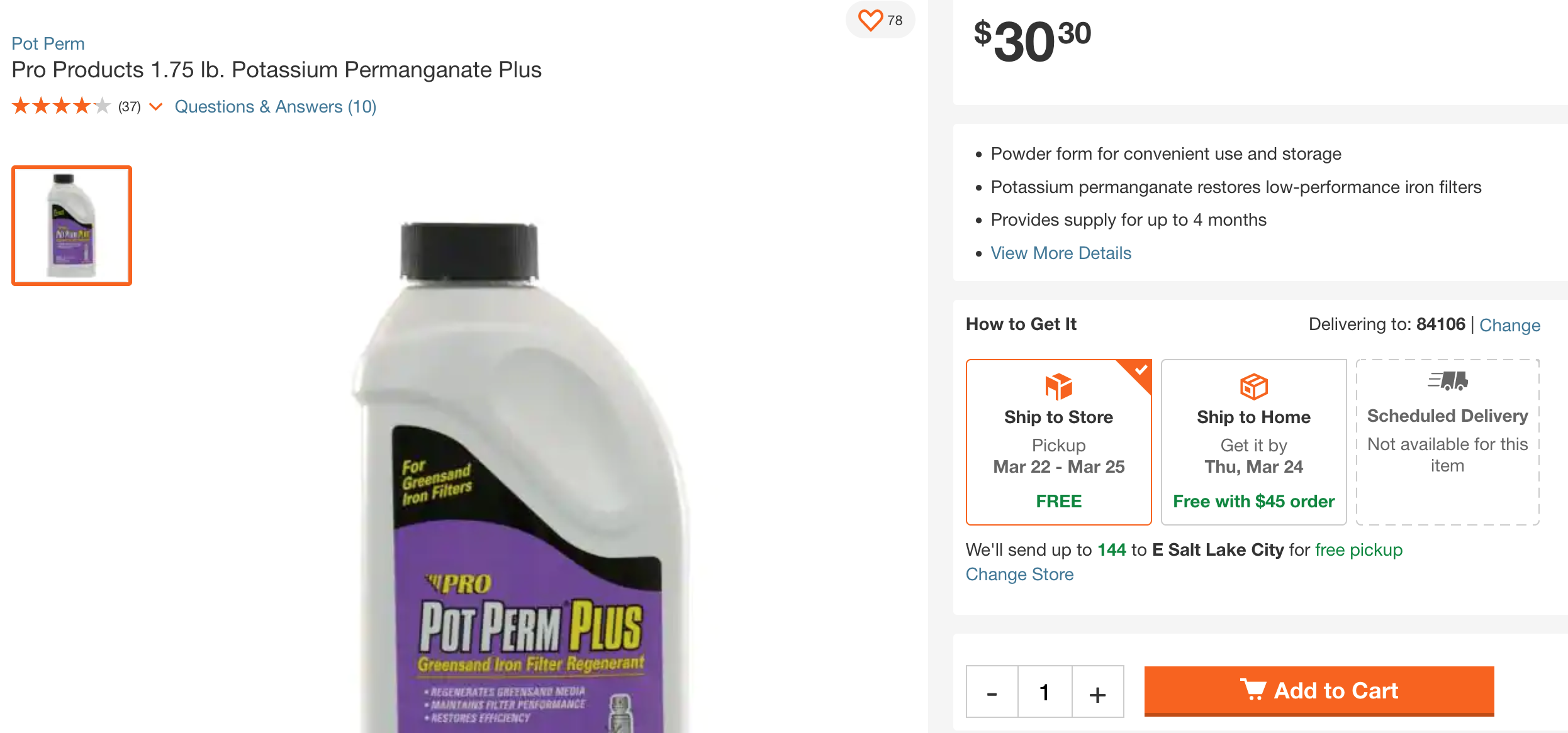

Reaction of potassium permanganate with HCl:
2 KMnO4 + 16 HCl —> 2 KCl + 2 MnCl2 + 5 Cl2
2.5 moles of Cl2 per mole of KMnO4. Permanganate is not regularly sold in any hardware store I've been to. The product "Pot Perm Plus" is generally only obtainable by special order. If I wanted to get it from my local Home Depot, I would have to order it to the store to pick up. Other stores don't offer it at all. It was the same case where I lived in Texas. Maybe other locales have it OTC. So that's 794 grams for $30.30, or about $6 per mole, giving us a theoretical yield of $2.41 per mole of chlorine gas. With the caveat that permanganate isn't actually OTC.
Screen Shot 2022-03-12 at 11.14.08 AM.png - 710kB
Now let's take a look at TCCA:
C3N3O3Cl3 + 3 HCl —> C3N3(OH)3 + 3 Cl2
3 moles of Cl2 per mole of TCCA. I could buy this at my local Lowe's in the store today if I wanted to:
Screen Shot 2022-03-12 at 11.15.03 AM.png - 630kB
While it's much more expensive upfront, that's for 11.34 kg of 94% TCCA, or 10.66 kg of pure TCCA. This comes out to about $3.25 per mole, giving us a theoretical yield of $1.08 per mole of chlorine gas.
While researching this, I was rather surprised to find that pool chemicals seem to be less available now than in years past when I bought them for my lab. I couldn't find NaDCC on any sites, for instance, while I know that I had bought some from Lowe's or Home Depot in-person in 2015 in an affordable 5 lb container of granules. Otherwise I would have included that in the price comparison too. It's always worth keeping in mind that availability of OTC chemicals is constantly shifting, and some things that we take for granted may be phased out for unclear reasons.
My calculations were based on my (half perhaps, I'd have to actually go check) cost, not your needlessly expensive figure (the $20 at amazon is still not the lowest that comes up with a search...their 5# @ $40.34 was used for the 93.6% TCCA)
On topic, I suspect that distillation with a high enough vacuum could concentrate dilute bleaches to a point where a hydrate could be crystallized out by cooling.
Posts: 4748
[*] posted on 12-3-2022 at 16:25
My “needlessly expensive figure” was based on what is available at hardware stores, which I used because you seemed to find it important to point out that permanganate is easier to find OTC than TCCA (maybe it is in Cornworld, but here it’s certainly not). The price I quoted is for Home Depots across the US. Maybe you have some special hardware store in Cornworld that sells it for half the price of the competition. Lucky you, if that’s the case.
The best price I can find online for permanganate is this: https://www.fleetfarm.com/detail/filter-mate-potassium-perma... which with the $8 shipping they offer does come out to about half the price of the Home Depot stuff. Still, that only puts it roughly even with TCCA.
Overall, I still think TCCA is a better choice unless you have local access to much cheaper permanganate. TCCA has the advantage of not leaving you with manganese waste to dispose of too.
