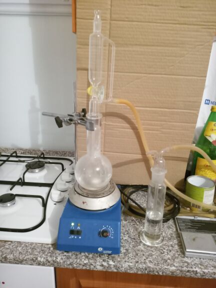

To a 125 ml washing bottle were added these 2 liquids by weight:
0,25 mol 38% formaldehyde CH2O 20,0 g
51 g 35% HCl (should be 43 cm3)
H2S generator was constructed this way:
60 g 35% HCl + 40 g H2O were poured into 500 ml long neck FBF, magnetic stirbar added.

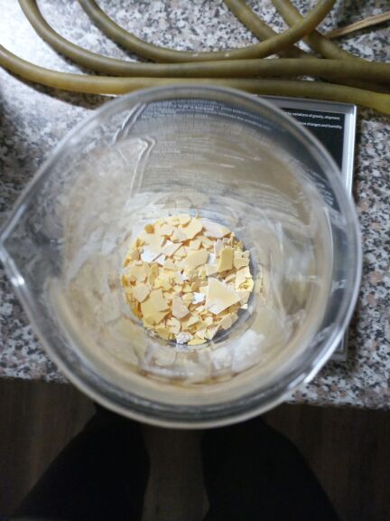

0,50 mol Na2S = 39 g, assuming technical 60% Na2S (approx trihydrate) it is 0,30 mol was dissolved in 300 ml of water and charged into dropping funnel.
The apparatus was transferred outside of lab. The temperature outside was 0 C (winter time).
The H2S generator was put on magnetic stirrer and connected with a hose with the washing bottle.

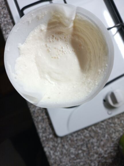

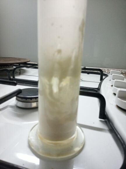

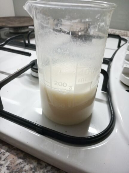

Magnetic stirring of HCl was commenced and the solution of Na2S was slowly dropped into diluted HCl. Evolved H2S gas was bubbled into the washing bottle which lasted 3 hours. At the end the content in washing bottle was semisolid paste (due this I expect the bubbling of H2S was very inefficient at the end).

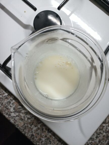

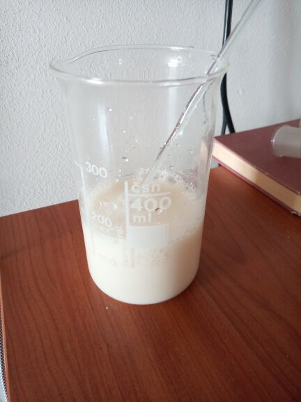

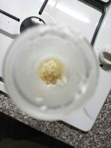

Content from washing bottle was washed out with water, gravity filtered, solid product twice suspended in 200 ml H2O and filtered out, final filtrate only little acidic (univesal pH paper approx pH 3).
Air dried for 1 week close to wood stove at temperatures around 50 C.

technical Na2S, yellow because of oxidation to polysulfides

content in washing bottle after transferring it from outside into the lab
IMG_20220307_221706_2.jpg - 25kB IMG_20220307_221714_8.jpg - 22kB
very thick content from washing bottle transferred into a beaker by washing it with water
IMG_20220307_222727_0.jpg - 29kB IMG_20220307_222730_4.jpg - 30kB
gravity filtered on filter paper

Hi SplendidAcylation, orgsyn bubbled H2S for 12-24 hours, me for only 3 hours, that could be the reason. But after 3 hours the content was almost solid, seems to be some polythioformadehyde polymer with copious volume trapping all the liquid? In orgsyn they filtered it few times and continued bubbling into the filtrate (that would require sintered glass as cellulose filter paper would not survive concentrated HCl). Moreover during my experiment there was 0 C outside which is not desirable for formaldehyde (it should be stored above 6 C) - maybe it also polymerized at some degree? Worth to try during warmer period. On the other side solubility of H2S in H2O is higher at lower temperature... Most of H2S did not react, maybe it would be worth using much taller and narrower cylinder or connect few cylinders in parallel?

Another notes: use the oldest glass you have and the oldest glass tube (I used inner diameter 4 mm which was OK and it did not clog). It is very hard to clean the glass. I approximate solubility of trithiane in boiling benzene approximately 1 g of trithiane in 100 ml and this is perhaps the best solvent? Perhaps the higher polymers are even worse to clean from glass? Perhaps I produced also some polyformaldehyde due to very low temperature? Avoid messing sintered glass if you can as I can't imagine how to clean it mechanically. Even if you clean with piranha solution you won't see whether it is really clear as the color of trithiane is white.
For cleaning I used acetone at room temperature and mechanical force (bottle brush and pipette brush). Very hard to clean. Maybe using wet sand shaking the glass would be the way to go?

In the orgsyn epilogue there is a synthesis where they drop solution of sulfide instead of bubbling H2S gas. But my Na2S was technical quality, old and a lot of S2- oxidized into polysulfides so I discarded that idea of dropping into formaldehyde thus introducing contamination with elementary S. There was a lot of elementary sulfur in the generator at the end as polysulfides react with HCl into H2S and elementary S. Maybe preparing fresh solution by bubbling H2S into solution of NaOH and then delivering this solution very slowly to the bottom of formaldehyd+HCl using long tube submerged just over the bottom of the reacting flask? In my experiment most of H2S was just gone and did not dissolve / react. Bubbling into NaOH would bind most of it and no such high loses of H2S. But then the problem of delivering the fresh Na2S or even NaHS to the bottom of reactor (dripping to the top of reactor = most of H2S would escape...).
