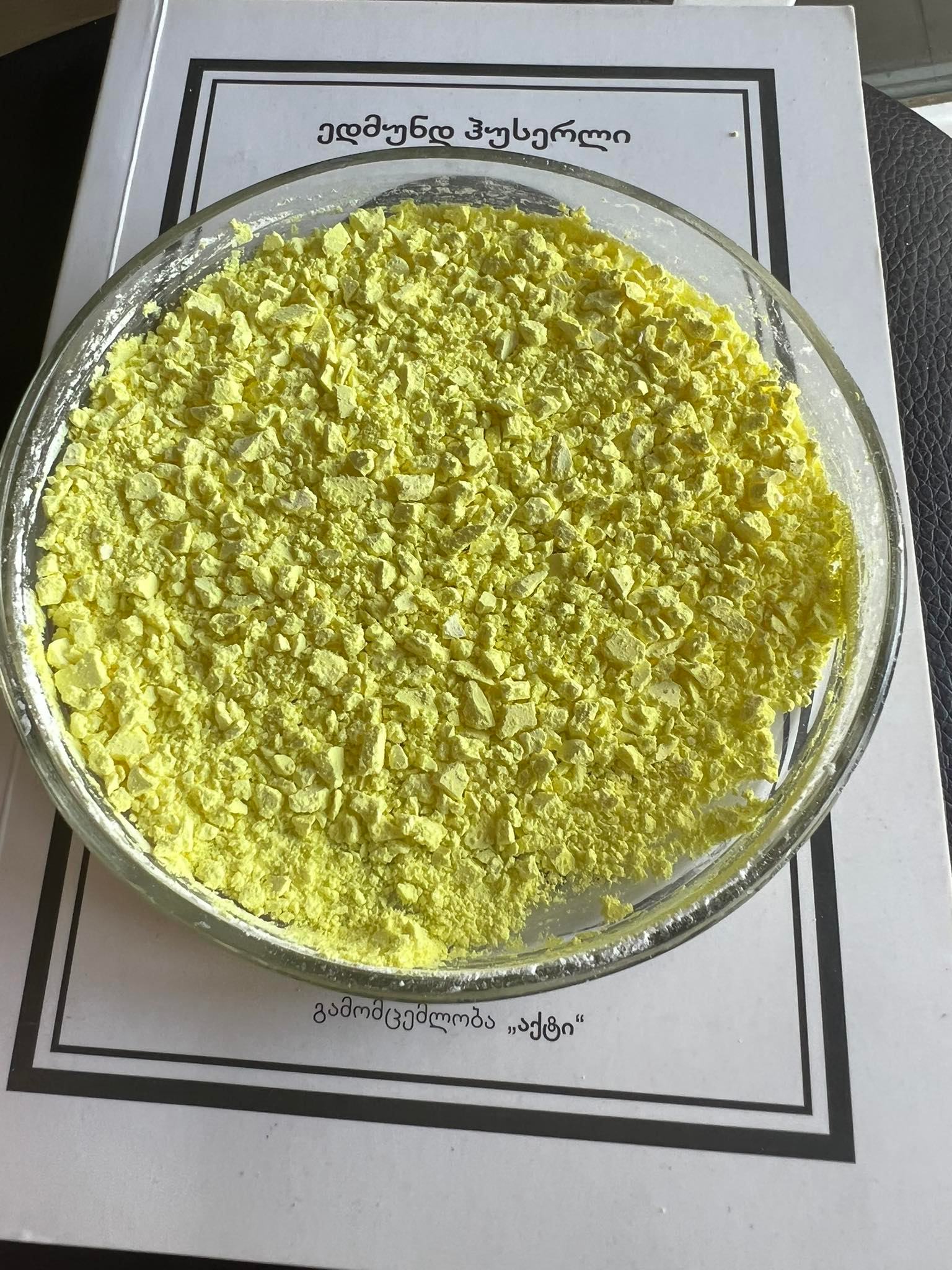

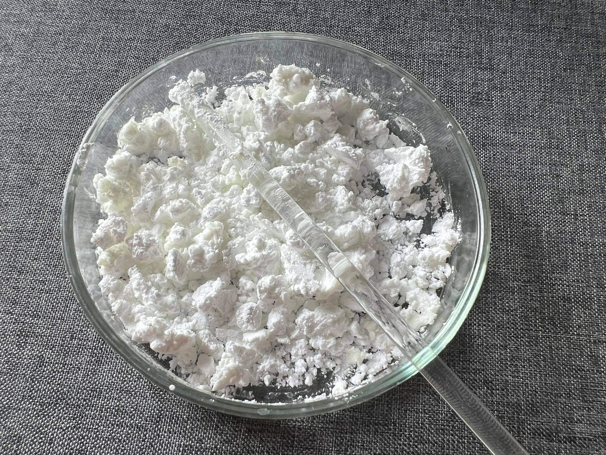

Hello! I started making different Heteropolymetalates.
Today I made ammonium 12-molybdatecerate(IV) - (NH4)8CeMo12O42*8H2O. According to the methodology it is prepared as follows. However I did three times as much.
Add 7g of Ceric ammonium nitrate in 140ml water. add 30g of ammonium heptamolybdate tetrahydrate in 100ml watar. stirring is required. When the solution is mixed, a yellow precipitate is released.

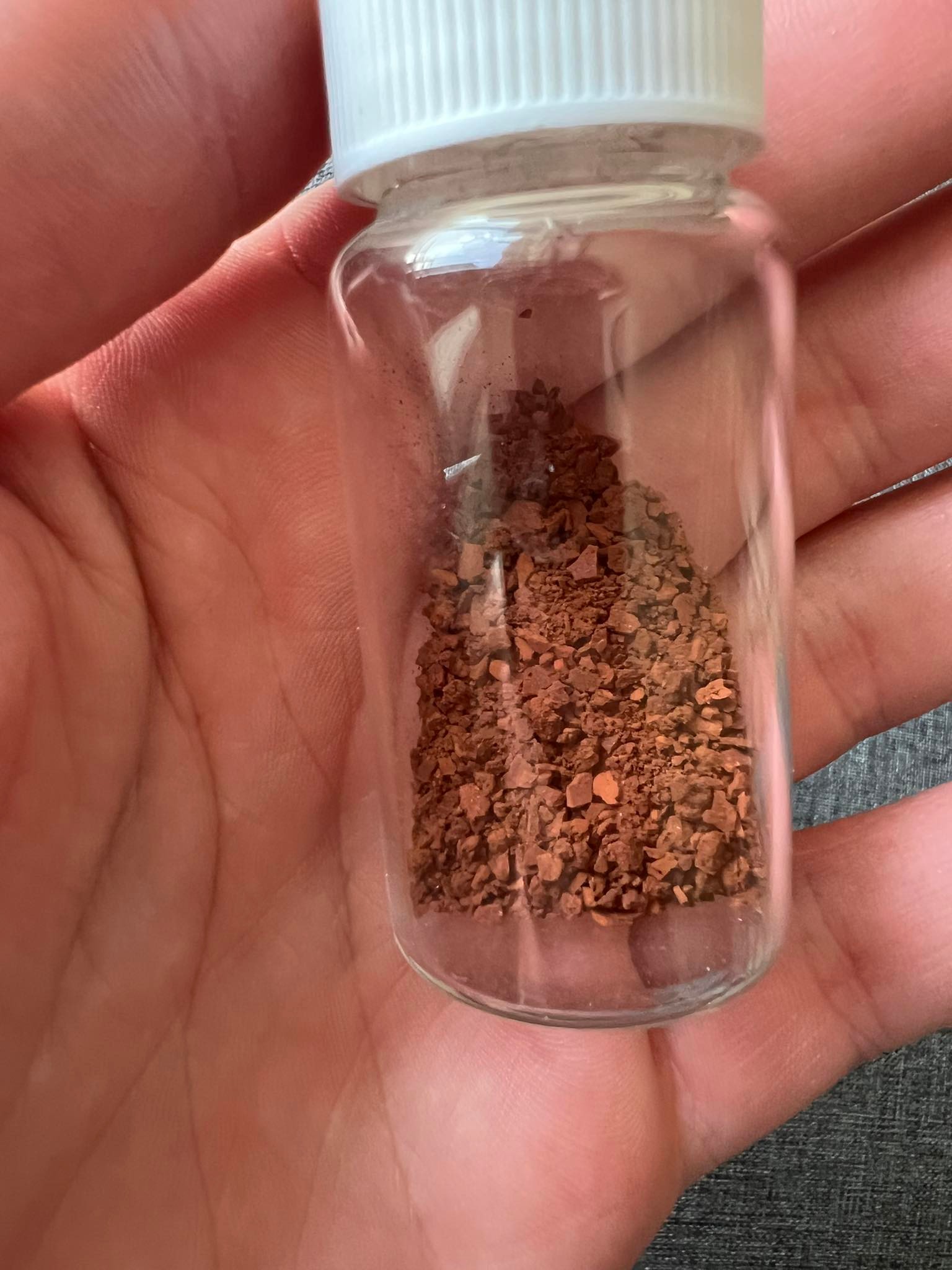

Ammonium 6-molybdochromate(III) - (NH4)3[CrMo6O24H6] •nH2O. n= 4-7.
Dissolve 12 g of NH4Cr(SO4)2 •12H2O in 50ml H2O. Add 30 g ammonium heptamolybdate tetrahydrate in 110ml water. The solution will have a green color. It is necessary to add sulfuric acid until pH=4.5. A precipitate will then form which will have a purple color

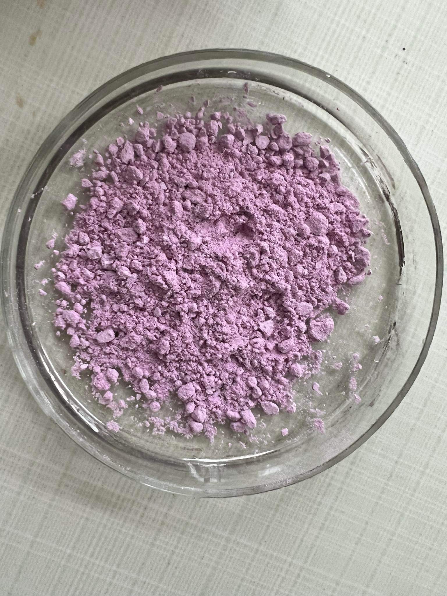

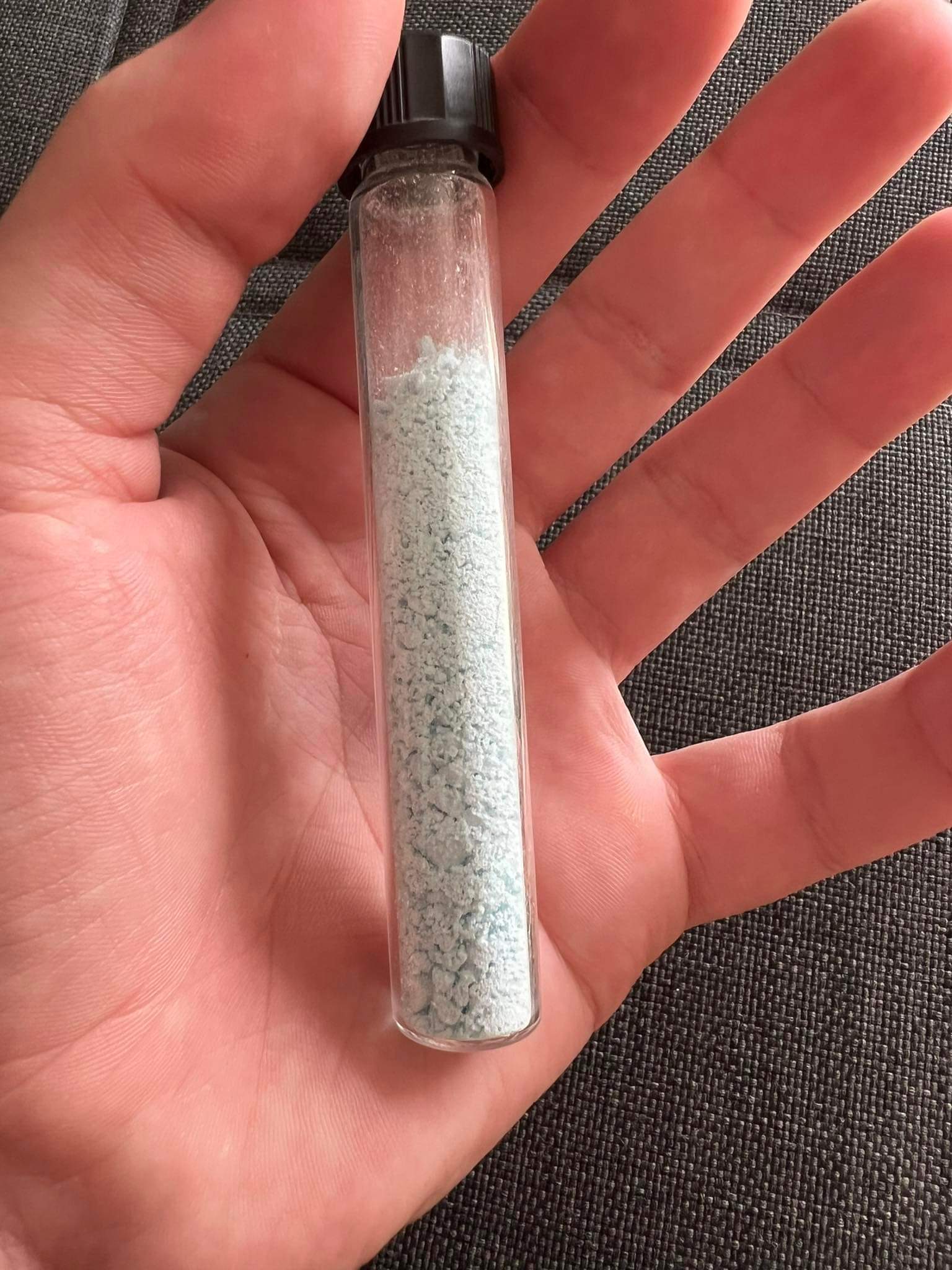

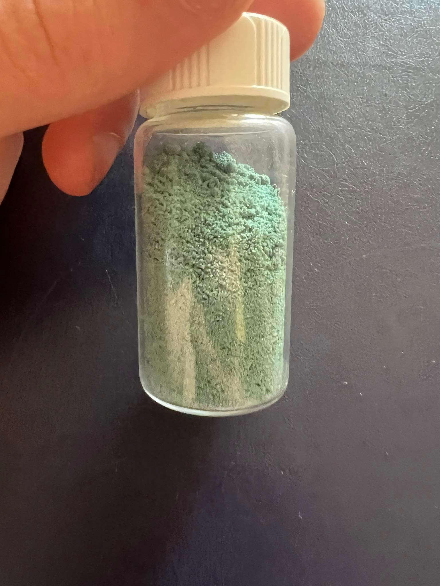

Ammonium 6-molybdonickelate(II) - (NH4)4[NiMo6O24H6]•5H2O
Dissolve 22g of ammonium heptamolybdate tetrahydrate in 200 ml water and 2.6 g of nickel sulfate hexahydrate in 150 ml water. Mix the solutions and boil for 10 minutes.
received_599924564686928.jpeg - 293kB
received_1598903000490942.jpeg - 407kB

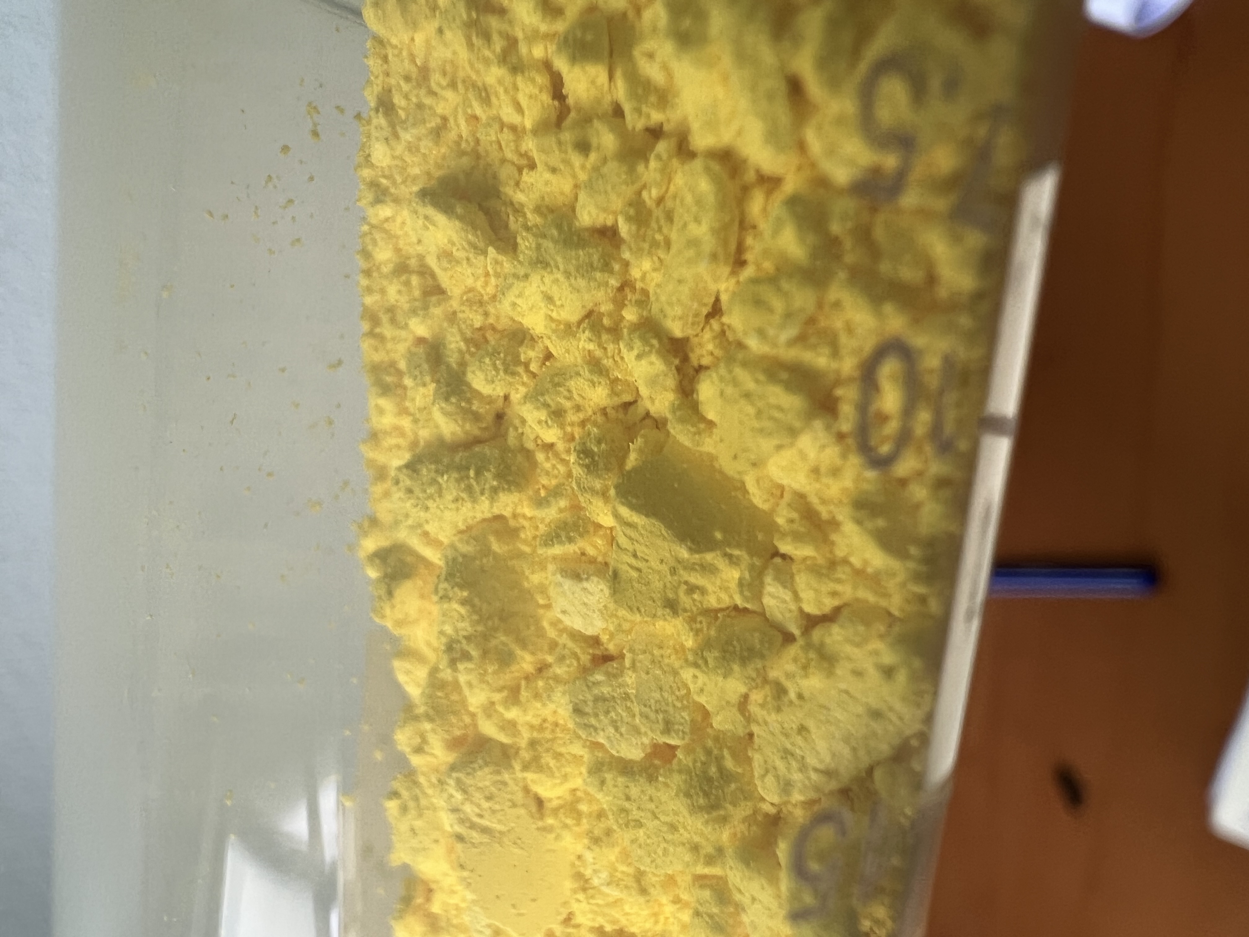

[*] posted on 21-6-2022 at 01:06

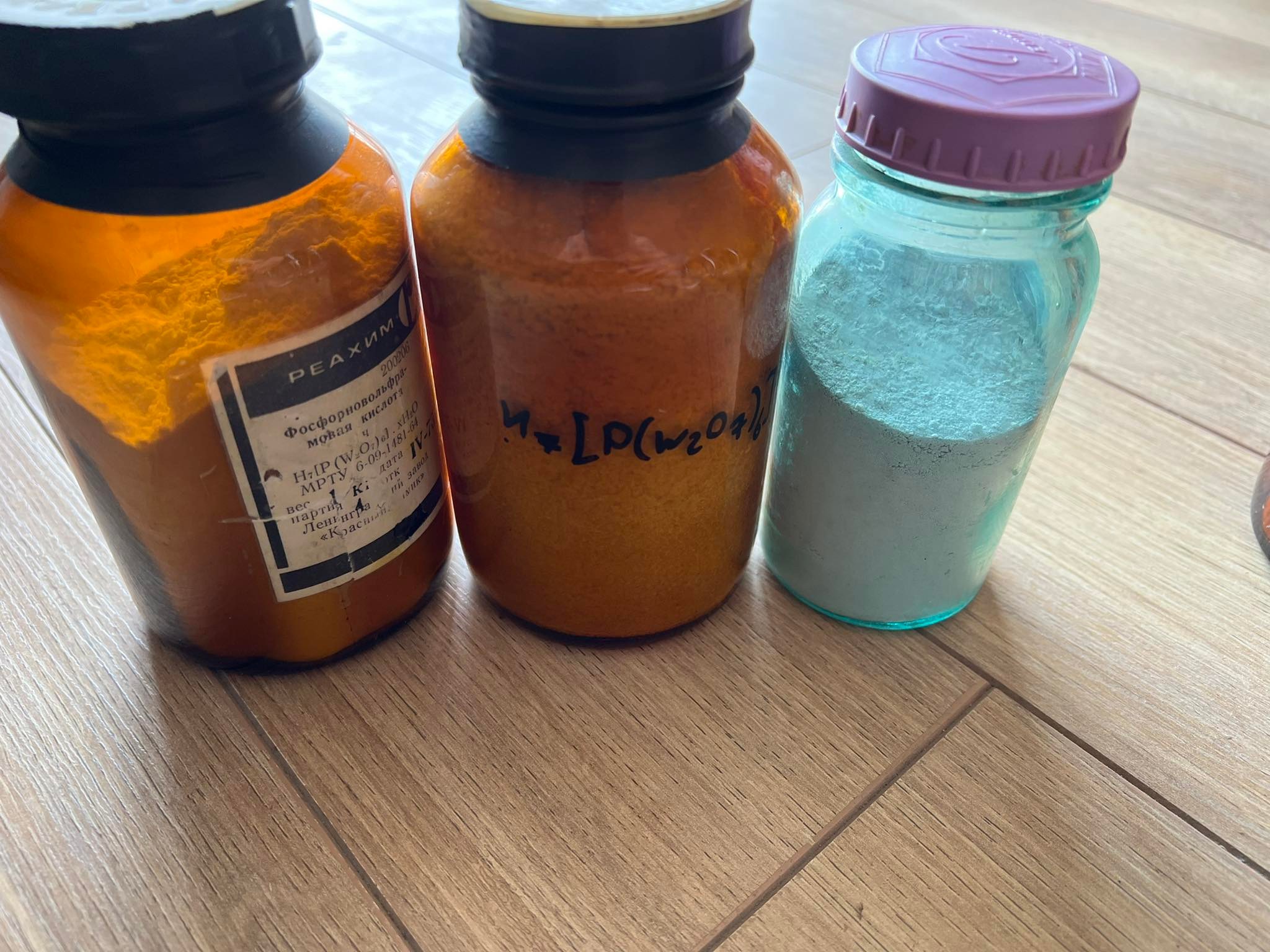

three jars of phosphotungstic acid.
287313659_710989460195266_3858836210957485054_n.jpg - 420kB

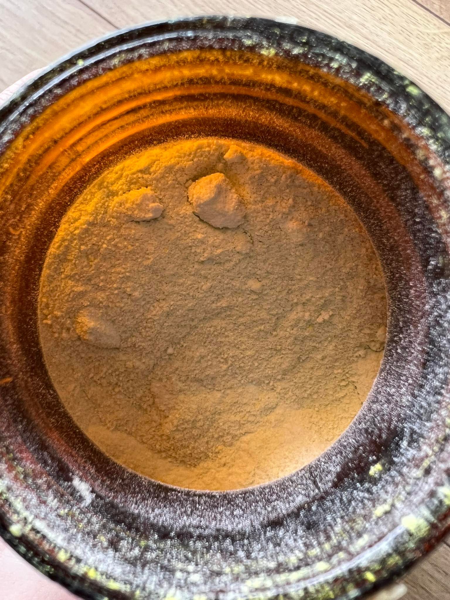

1L jar of phosphomolybdic acid.
287749860_526849902512331_1274553159076686319_n.jpg - 533kB
Bedlasky
Posts: 1252
Registered: 15-4-2019
Location: Period 5, group 6
Mood: Volatile
[*] posted on 21-6-2022 at 03:46
Hi Vano!
Hexamolybdatonickelate is labile at temperatures higher than 60 °C. Let it precipitate at room temperature, you will get light blue solid.
Solubility of heteropolymolybdates is much higher in hot water, it is better to cool down solution in the fridge. More precipitate will crush out.

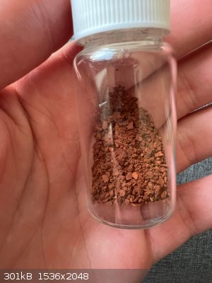

[*] posted on 28-6-2022 at 02:27
silver 12-vanadophosphate Ag7(PV12O36)•nH2O f
288528282_439600207710288_430183686370274811_n.jpg - 301kB 289036884_813754186259846_7437827010735913754_n.jpg - 693kB

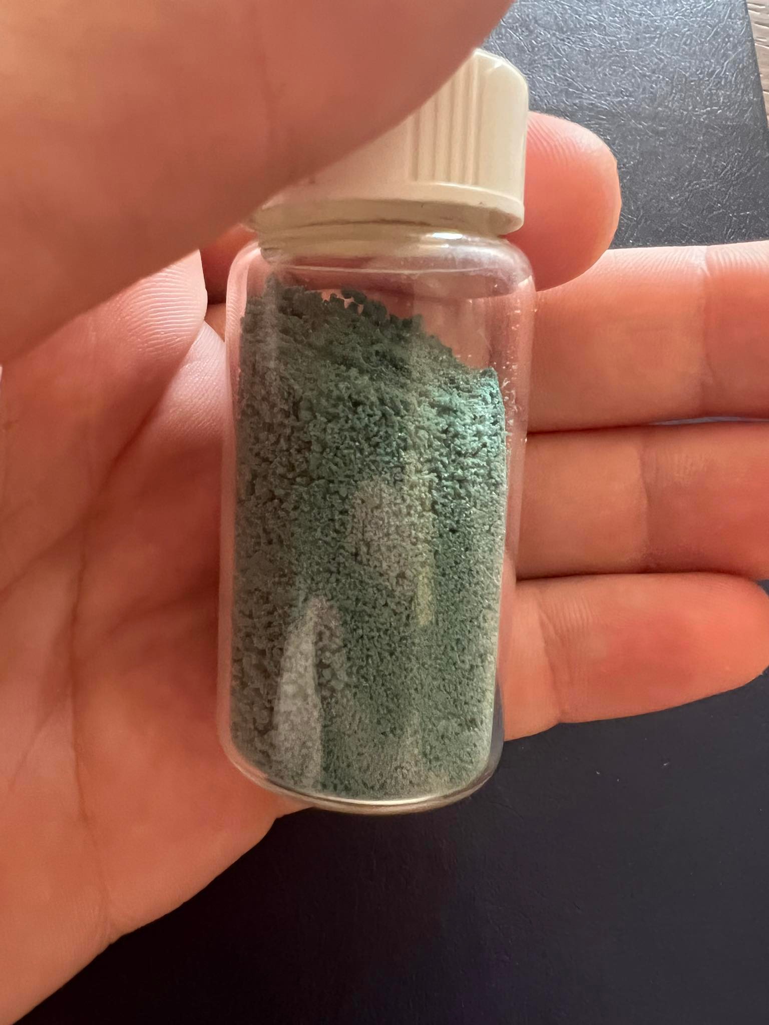

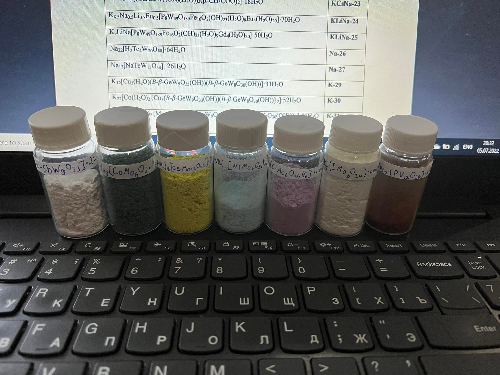

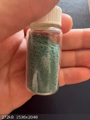

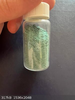

[*] posted on 5-7-2022 at 00:25
Sodium 6-molybdocobaltate(III) - Na3(Mo6O24H6)*8H2O
290697578_417394350336447_6362229316556600263_n.jpg - 317kB
291001683_627837428252778_4182576376802180482_n.jpg - 272kB

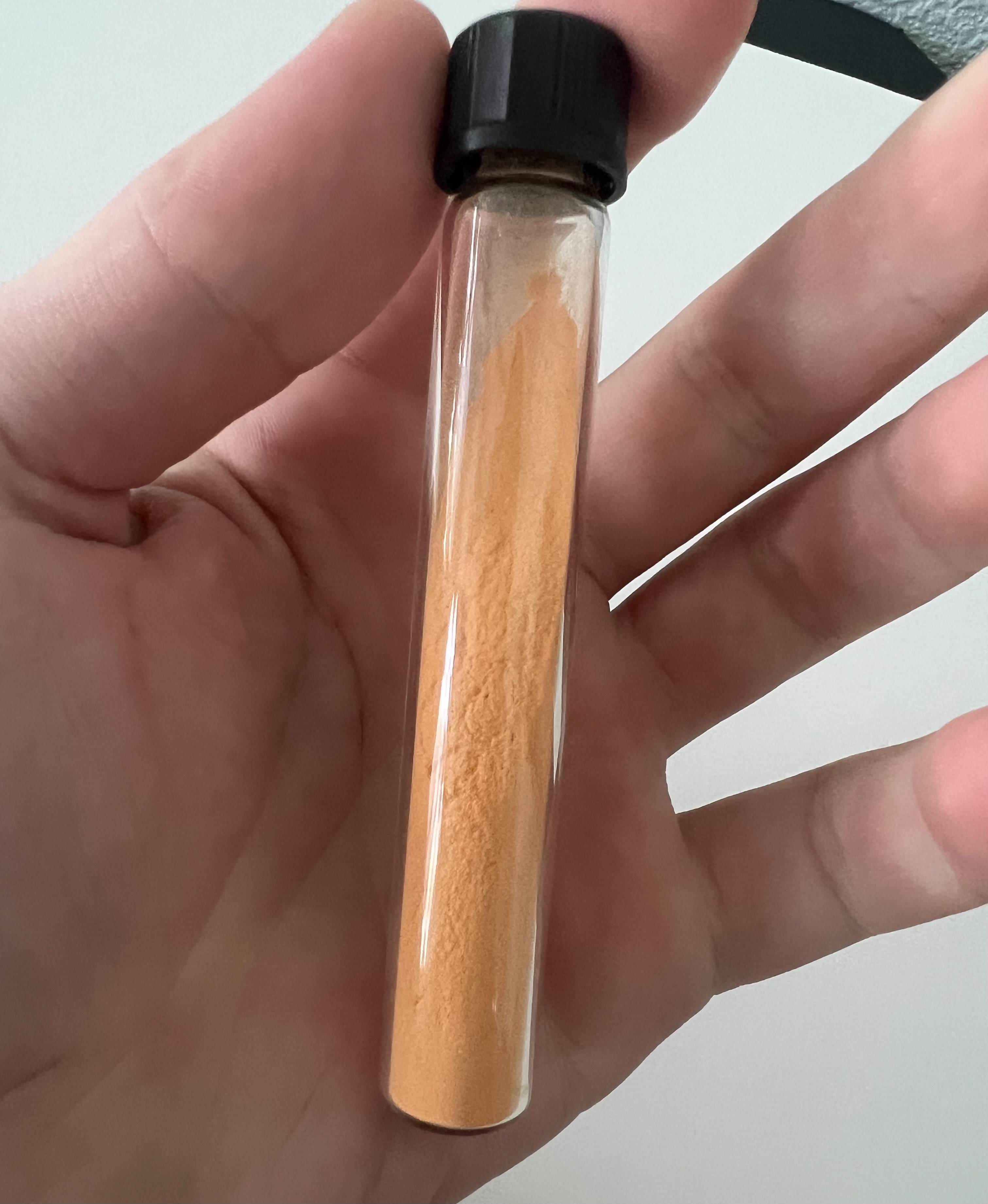

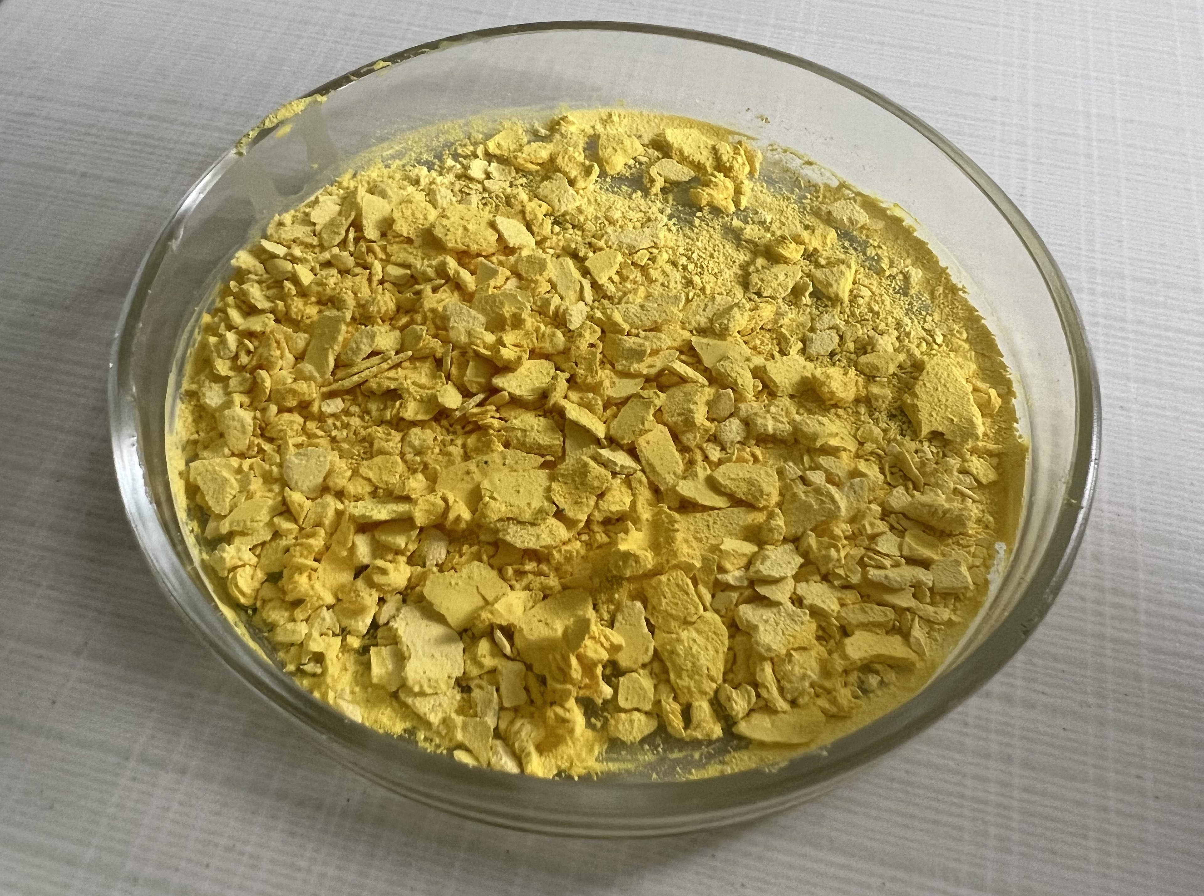

[*] posted on 5-7-2022 at 08:29
Ammonium 12-molybdophosphate - (NH4)3[PMo12O40] *nH2O.
290777898_564228008676864_7144083088687137029_n.jpg - 764kB
Posts: 4725
[*] posted on 5-7-2022 at 08:49
Beautiful! I especially like the Co(III) one. I haven't seen a green cobalt compound before as far as I can remember. Do you have any further experiments in mind for these products, or are you just making them all for your collection?

[*] posted on 5-7-2022 at 09:29
I haven't read anything specifically about the use of this compound, but if I see any information and am interested, I will try it. This time I just made it for my collection, I think when I make many other heteropolymetalates I will start to study their properties.

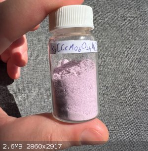

[*] posted on 14-8-2022 at 06:48
Potassium 6-molybdochromate(III) - K3[CrMo6O24H6] • nH2O

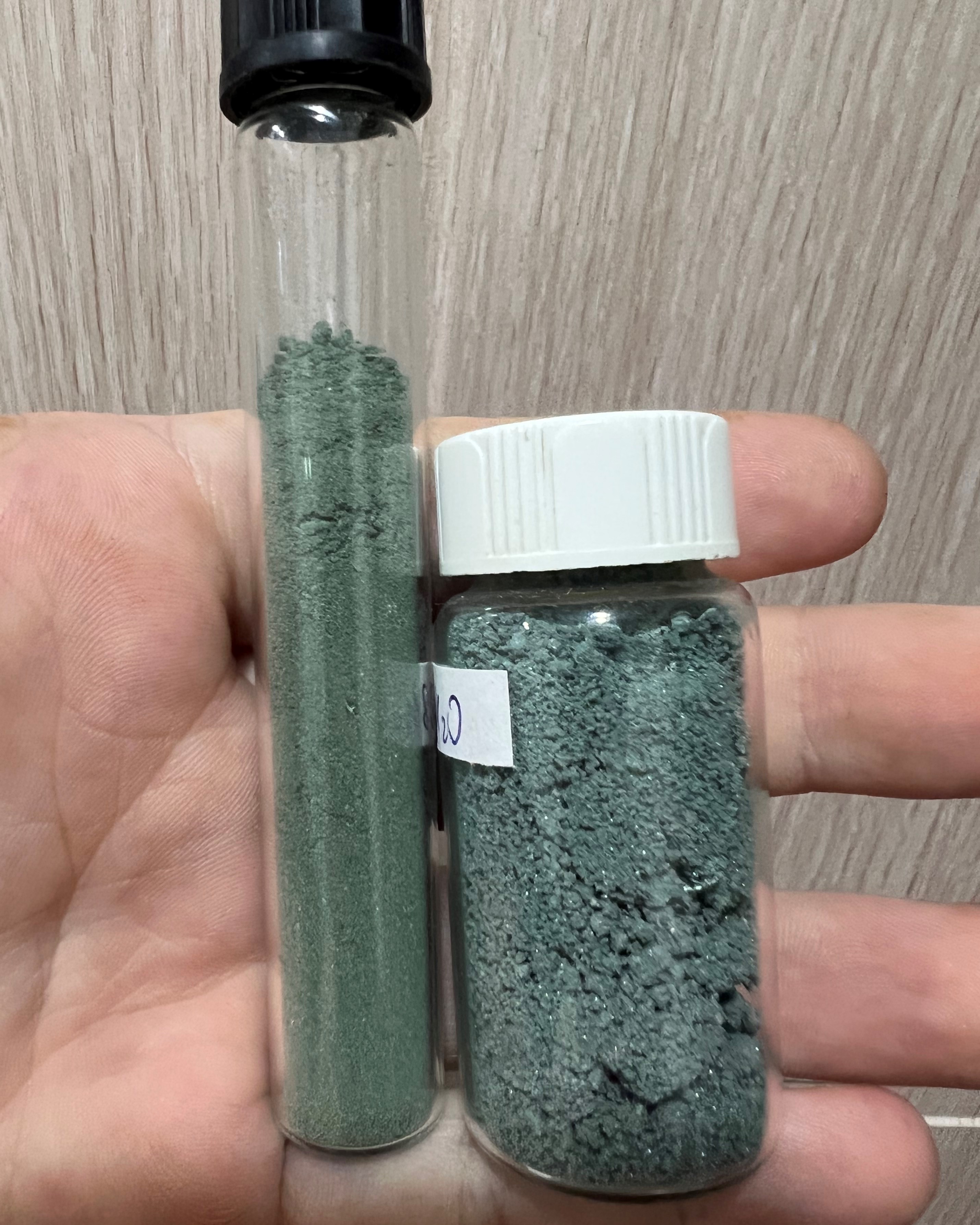

[*] posted on 8-9-2022 at 08:05
Ammonium 10-molybdodicobaltate(III) - (NH4)6(Co2Mo10O30)*10H2O
IMG-2262.jpg - 1.2MB
color isn't very different from Na3(CoMo6O24H6)*8H2O.

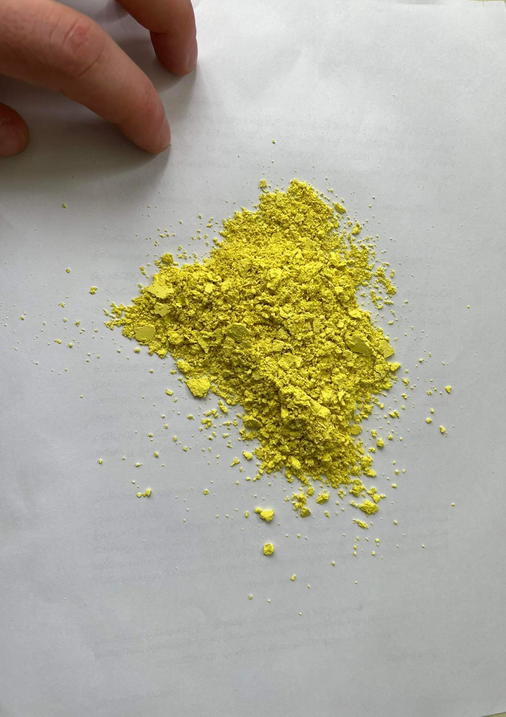

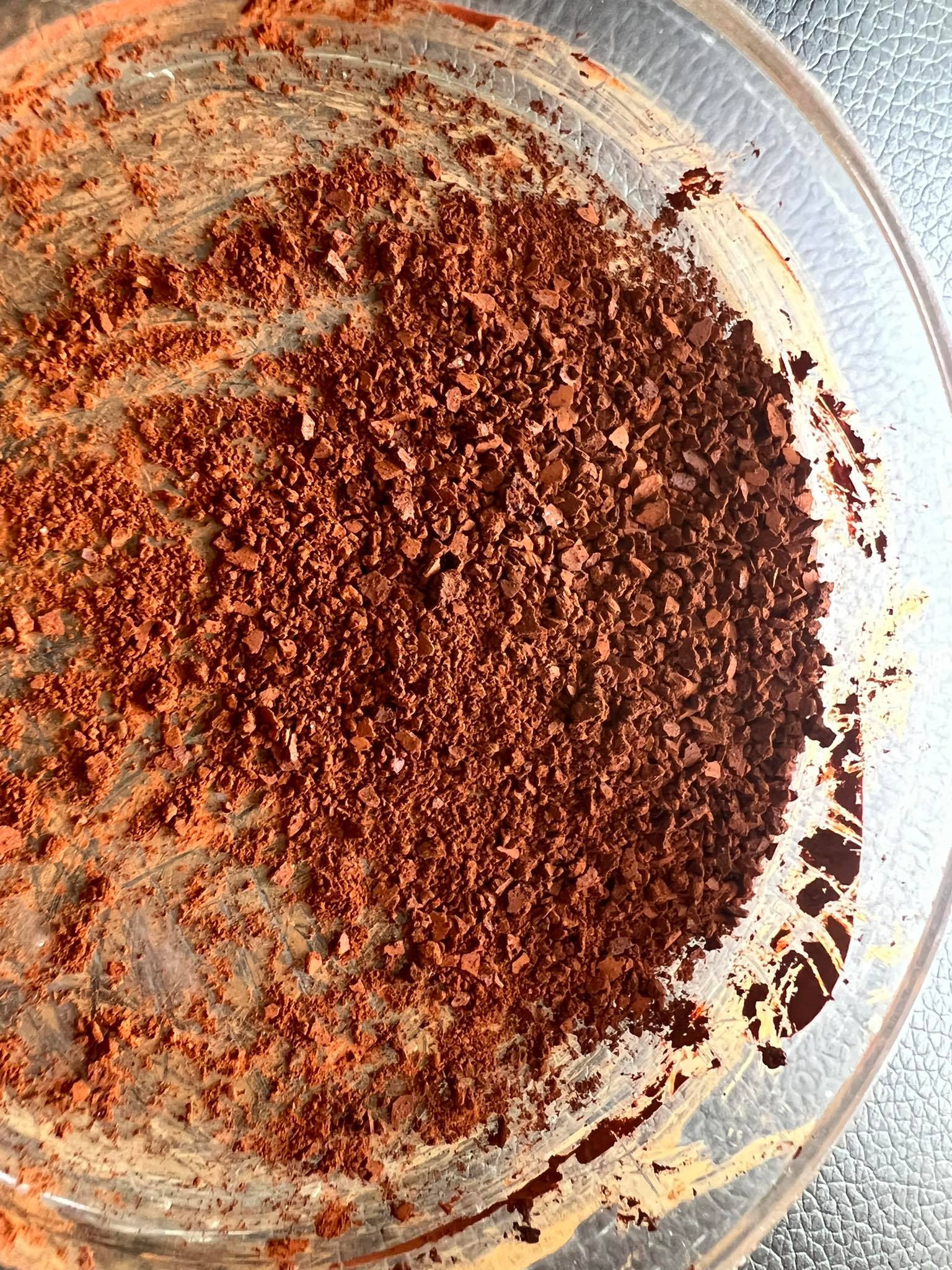

[*] posted on 10-10-2022 at 09:03
12-Molybdic Acid-1-Arsenate - H3[AsO4(Mo3O9)4] *nH2O
(Brauer - p. 1734)
IMG-2564.jpg - 2.3MB
IMG-2568.jpg - 1.7MB
