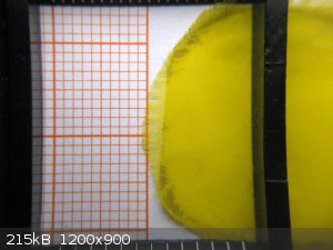

Today it is available as tracing paper for technical drawings. [Photo 1] Not to be confused with transparent glassine, which is preferably used for
handicrafts.
Genuine parchment paper is permanently waterproof and resistant to alkalis and acids. In my test, it even survived 24 hours in chlorine cleaner with
2.45% hypochlorite.
Compared to a clay diaphragm, it allows much less water to diffuse and has significantly lower electrical resistance.

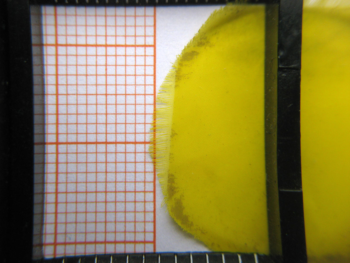

Parchment paper swells in liquid. It becomes about 2% longer but an astonishing 11% wider, which must be taken into account when designing seals.
If the dry paper is rigidly fixed and then immersed in electrolyte, it warps and wrinkles along the attachment point. The weakened parchment paper
tears under even the slightest stress. [Photo 2].
I looked for a way to glue the paper to my cell. However, since it detaches from most waterproof adhesives, even silicone, when it swells, it took
some experimenting until I found this solution:
I apply a continuous line of superglue to my cell and then press it onto wet, already swollen parchment paper.
This must be carefully prepared, as the cyanoacrylate hardens instantly upon contact with the wet parchment paper - corrections are no longer
possible.
The swollen diaphragm has to be stored wet - it must not be allowed to dry out.
Photo 1: Sheet of Parchment Paper
Photo 2: Wet and Wrinkled

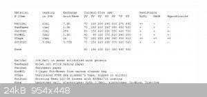

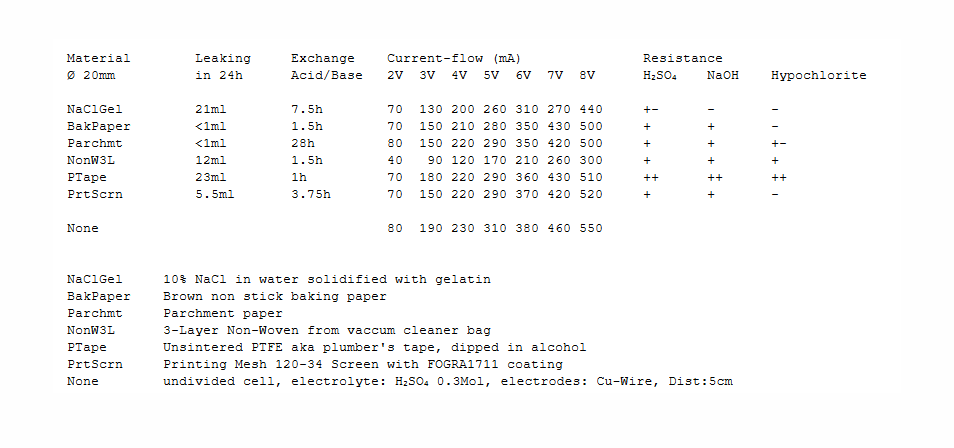

I discovered that some screen printing stencils have coatings based on cross linked Polyvinylalkohol.
Crosslinked Polyvinylalkohol (PVOH) is a suitable material to make dividers for electro-chemical cells.
mysteriusbychoice has given some instructions and very detailed instructions with additional info can be found here
I got a screen printing stencil that had already been used for printing. As coating photoemulsion "FOTECOAT 1711" has been used. The fabric "120-34"
is made from polyester monofilament fibers (120 per cm , 30% open area).
I cut out the fabric and tested coated parts of it using my test cell and conditions as described in my post from dec 14th 2024
The Stencil has good sealing properties and a very low electrical resistance, but significantly slows down ion migration. It can be used in acidic or
basic electrolytes, but is not resistant to chlorine.
In addition to these properties, a screen printing stencil offers further advantages:
It is very thin, flexible, yet surprisingly stable. It practically does not swell and can be easily sealed, glued, stapled, and even sewn.
If the coating is removed from the fabric, for example with chlorine cleaner, it can be welded with a simple foil sealer.
The stencil is therefore ideally suited for constructing a divided cell or electrode chamber.
You can even coat and expose one yourself, but not all photoemulsions are suitable.
Emulsions for waterbased inks are 100% waterproof and therefore will not work.
The stencil I tested was coated with "FOTECOAT 1711", a two-component emulsion for solvent-based inks, PVOH- based and UV-sensitized with a "DIAZO"
component. Unfortunately, I don't know the exact composition, but according to manufacturers' technical specifications, "Saati Grafic DS" and "Akzocol
PolyPlus S" are comparable.
There are other emulsions, likewise for solvent-based inks that also come with a "DIAZO" component, but are based on polyurethane-acrylic copolymer. I
don't know whether these are also suitable.
F.l.t.r: used coated fabric, after 24 in H2So4 15%, after 24h in NaOH10%, after 24h in Chlorine cleaner with 2,5% Hypochloride
Magnified decoated fabric
