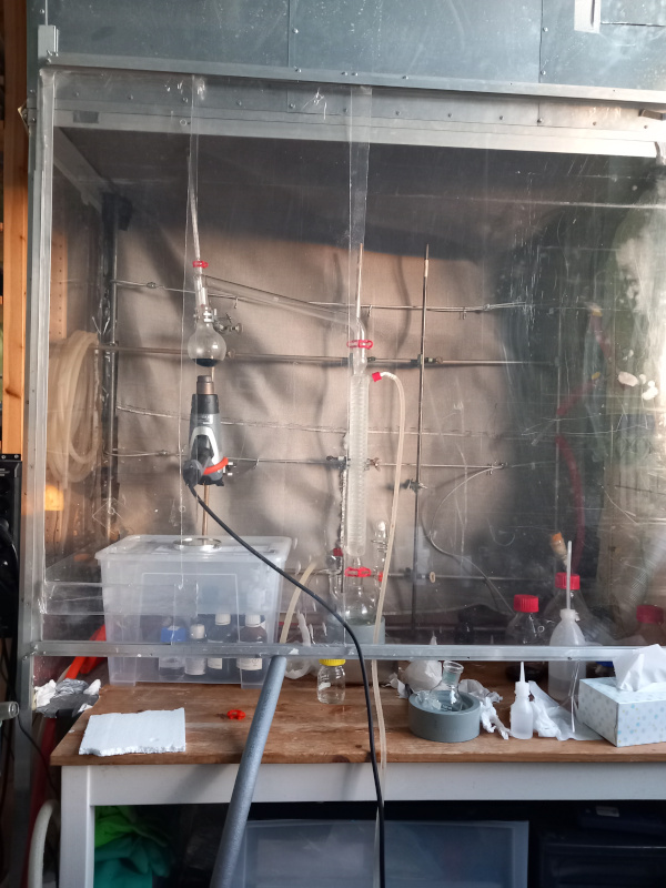

I have prepared n-amyl and iso-amyl salicylates. I didn't find those articles at that moment so I used my own procedures:
1. For n-amyl salicylate
35.4g salicylic acid (S3 chemicals, 99.5 - 100.5%, Ph. Eur., USP)
22ml n-amyl alcohol (S3 chemicals, 99%)
50ml purified toluene
0.2g p-toluenesulfonic acid dihydrate
Dean-Stark method (with the toluene as a water carrier)
My trap has a fixed volume of 20.3 ml.
Salicylic acid is completely dissolved during warming.
It looks like either p-toluenesulfonic acid is not a good catalyst or the temperature is low, the water collection in the Dean-Stark trap is very slow and the yield is poor. The progress of water collection is (the volume @ the time)
0 @ 9:23 pm (start)
0.5ml @ 0:16 am
1.3ml @ 4:43 am
2ml @ 12:14 am
at this time 6ml of H2O was added to push toluene (mixed with alcohol, so it keeps some quantity of the alcohol out of synthesis) from the Dean-Stark
The process was stopped at 4:44 pm
200ml of H2O was added to the flask. With cooling the salicylic acid excess was crystallized, so 12g of NaHCO3 was added and stirred. The sodium salt was completely dissolved (it is important to remove the acid because it is prone to thermal decomposition on later stages forming quite smelly products).
The bottom layer was separated and washed twice with 100ml of water.
The toluene from dean-stark was saturated with NaCl and the top layer was added to the product.
30ml of toluene was distilled off using a widmer column. During this process the temperature in the source flask reaches 200C.
The water was added to the product in the source flask (attention: cool it first, otherwise you will get the "champagne effect", I've got it so I lost some product at this stage).
So, 150ml of water was added, separated, and washed 1 time with H2O, NaHCO3 (but it wasn't required), and 3 times with water.
I didn't distill the product because it was too little.
2. iso-amyl salicylate
iso-amyl alcohol (chemship1978) was dried for 1 day on K2CO3 and distilled through a widmer column, the middle fraction was collected. chemship1978 has very good quality alcohol, most of it passes 131-131.5C. Probably it has a synthetic origin. My previous experience with iso-amyl alcohol from Restauro Online was quite different, 5 fractions were collected and 3 middle fractions were in the 130 - 131C range every of which had a quite different smell. I think Restauro Online alcohol is not synthetic one but the result of fermentation.
17.2g salicylic acid (S3, as before)
36ml 131-131.5C iso-amyl alcohol
5ml conc. H2SO4 (attention: slowly poor (from a beaker, not from a pipette!) in the alcohol cooled in ice with a good stirring; failing to do so creates some irregularities as the result of the alcohol caramelization which change the way of synthesis because they accumulate the heat)
3hr of reflux with the temperature control - it should never go over 134C (otherwise the preparation will be spoiled - it creates some awful-smelling byproduct)! Also, the reflux should be stopped either when the color of the mixture becomes yellow-brown or the smell of unsaturated hydrocarbon on the top of the cooler becomes too apparent.
400ml of filtered water was added to the result. It often forms emulsion which requires the usage of some solvent to break. I used CCl4 but diethyl ether could be used also.
The result of separation was washed 1 time with an equal volume of water, 1 time with saturated NaHCO3 (it showed no bubbling, probably the pH of filtered water was enough to neutralize the rest of the acids), 2 times with water, dried 1 night over MgSO4. CCl4 was distilled over through a Widmer column and the rest was subjected to vacuum distillation. iso-amyl sallicilates passes 147C (probably 149C, the thermometer is not calibrated at this range yet) @ 24mmHg. The yield is ~20ml.

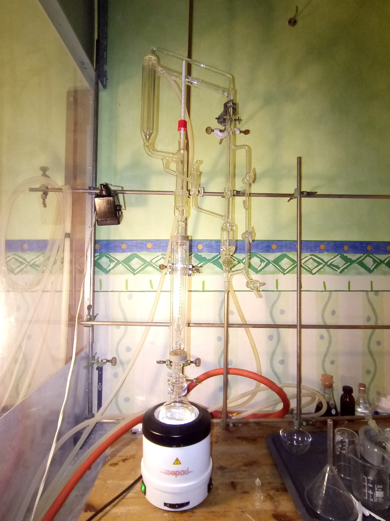

Thanks, my experience with Dean-Stark is also quite good for making various esters. But in this case, the process is really slow and far from completion and I think the reason is p-TsOH doesn't work as a catalyst here.
I personally would not use ordinary xylene isomers mix to make esters. I spent a lot of hours (with this distillation rig, by the way :)

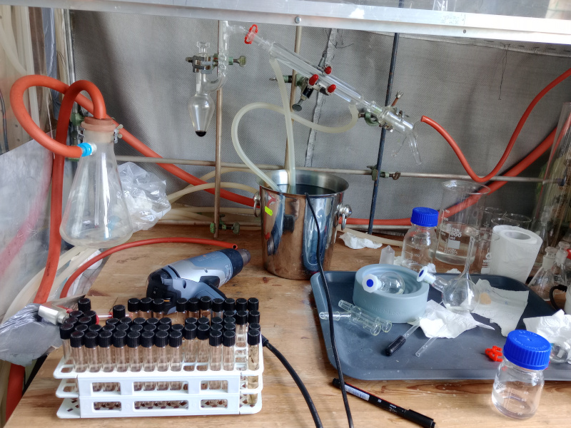

xylene.jpg - 309kB
studying my xylene composition. I've separated several fractions and the last one has a smell of cow dung. Typical toluene also has some sulfur compounds but they could be removed quite well with a help of sulfuric acid. But for xylene, it doesn't work because of the easiness of sulfonation of xylene itself. For the same reason, I wouldn't use either xylene or toluene with H2SO4 as a catalyst. I think benzene or hexane would be much better because it is much more inert to sulfonation.

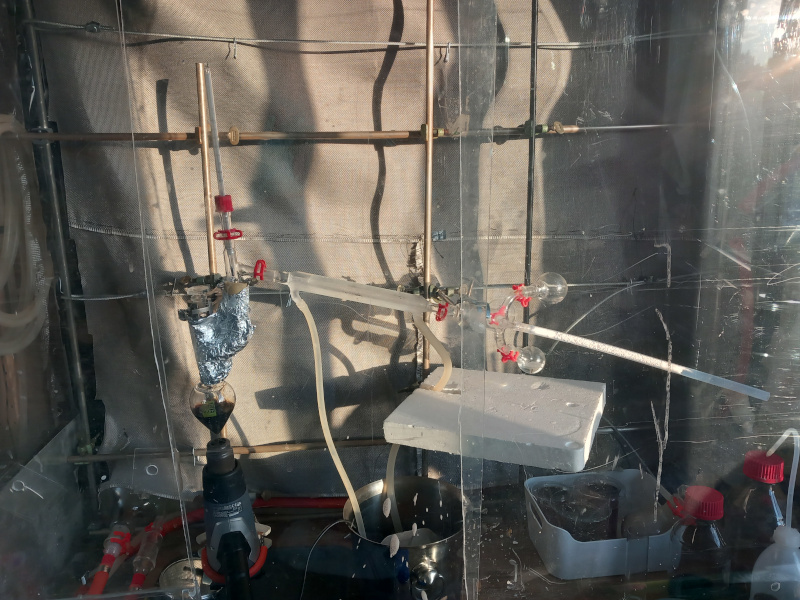

Yesterday I tried to make salicyloyl chloride by SOCl2 method but it went wrong. After initial (several hours) dissolution of salicylic acid the result begin to solidify with continous bubbling and instead of getting liquid melting 18C I've got a white powder. There is still some chloride (I was able to detect the smell of ester after addition of the alcohol) but it's evident the SOCl2 method is unable to produce the pure product. I think the reason is that OH group interfere here. My (stupid) guess is that after forming "unstable nucleofillic compound" with SOCl+ it doesn't go as expected, so it doesn't form leaving group but makes a ring closure over S atom... of course it is just stupid guess. So, I'd like to protect OH group somehow to see how it can interfere with the reaction path. From what I read it should go smooth with acetilsalicylic acid.
Also, as McMaster & Ahmann said (J. Am. Chem. Soc, 1928 (50) p. 148) "we were able to obtain by using the free acid only a very small yield of the acid chloride of salicylic acid but a 36% yield was obtained by using the sodium salt of the acid .... No yield of the acid chloride could be obtained with m-hydroxybenzoic acid nor with o-and m-cresotinic acid...".
So, I am thinking now why the reaction with SOCl2 is so dependent on -OH group position and also why it goes better with Na salt of the salicylic acid. There are no answers so far.

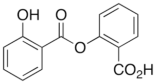

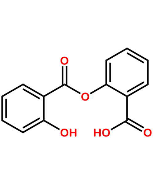

I think I solved the mistery of salicyloyl chloride solidification. In the presence of SOCl2 the reaction is not stopped on forming salicyloyl chloride but goes further when two molecules of the chloride reacts to form the depside
images.png - 3kB
(diplosal or salicyloylsalicylic acid) m.p. 148C (Rodd's chemistry of carbon compounds, vol. IIId, also it is exactly what Fery said in regard to side esterification reaction). So I have to check the melting point after this side-product purification. Also, it's now clear that the synthesis of salicyloyl chloride should be stopped just after all salicylic acid is dissolved.
Hm, this form looks "chelating"
ANT-ASR-05.png - 38kB
[Edited on 27-7-2023 by teodor]

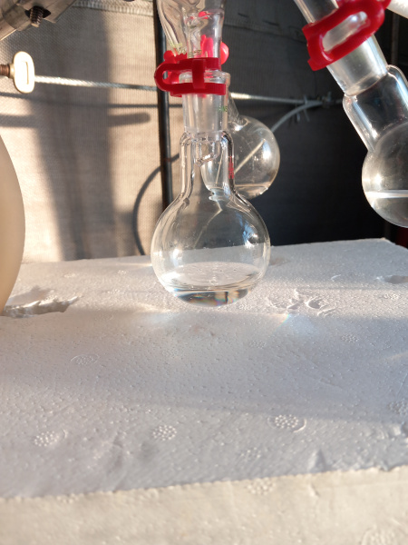

[*] posted on 28-7-2023 at 05:05
@Fery
20230728_150407.jpg - 3.4MB 20230728_150416.jpg - 3MB
[Edited on 28-7-2023 by teodor]
20230728_150810.jpg - 2.9MB
20230728_151250.jpg - 3.3MB

The method disclosed in that patent of 1955 (57 years after inventing
of Darzens method) is excelent in several points:
1. It uses a slight excess of salicylic acid over SOCl2 which is
unusual but eliminates the need of distilling-off the excess of the
reagent which according to my observation can shift the reaction into
the side of forming depside.

I didn't have hexane, so I used n-heptane having intention to use the chloride in the same heptane solution for esters preparations.
1 week before I started SOCl2 purification by classical method - distilling from quinoline to eliminate acids and after that from linseed oil to remove yellow-colored sulfur compounds.
SOCL2_1.jpg - 188kB SOCL2_2.jpg - 231kB
After this treatment I've got colorless clear liquid not much fuming on air (low dissolved HCl cotents after quinoline treatment).
SOCL2_3.jpg - 115kB
Salicylic acid USP grade (S3 Chemicals) was kept several weeks in a dessicator over conc. H2SO4 and had a form of dry white powder.
In 100 ml flask I poured 50ml of n-heptane 99%+ (laboratoriumdiscounter.nl, "n-Heptaan").
Then I've put a magnetic stir bar followed by 6.362g of "Salicylsäure".
Then I've dropped ~0.035ml of pyridine and started stirring.
To this mixture 3.45ml of purified SOCl2 was added.
chloride_start.jpg - 129kB
The water bath temperature was kept in the range 27 - 42C by changing
water. In several hours stirring at 1500rpm mostly all salicylic acid
disapearred. The liquid was filtered and put in freezer <-12C. In 1-2
hours many small needle-like crystalls where formed but it was still
small amount of them, either they are soluble or I should wait a bit
longer.
chloride_finish.jpg - 100kB
