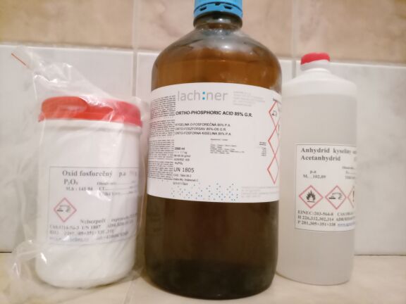

Polyphosphoric acid Preparative Methods: by mixing x mL of Phosphoric Acid (85%, d 1.7 gmL−1) with 2.2 x g of Phosphorus(V) Oxide (P2O5) followed by heating to 200 °C for 30 min.

15,0 g H3PO4 85% (lit. density 1.6845 g/cm3 but so much viscous liquid is better to weigh than to measure its volume) was pipetted into 250 ml flat bottomed flask and then 35,0 g of P2O5 added in small portions (at least 33,0 g should be used according the above method). The addition was accompanied by evil hissing but nothing splashed / spattered, then the neck was loosely covered with a piece of plastic sheet of high melting point secured with rubber circle to reduce H2O absorption from the air. The flask was heated on free flame for 30 minutes until P2O5 dissolved (only a little of it didn't), the T was checked by an infrared thermometer and the T was 200-210 C.
Then cooled below 60 C at which it became more viscous than honey.
5,0 g of acetic anhydride added by weight (it should be circa 4,6 ml by volume) which immediately produced dark side-products by carbonization (the acetic anhydride used was analytical grade, also P2O5 analytical grade, also 85% H3PO4 analytical grade G.R.).

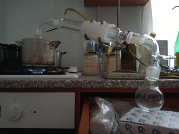

Bottom organic phase distilled on boiling water bath (boiling stones were not used due to impurities the solvent boiled smoothly without bumping), collected 100 ml of chloroform which was used to reextract the upper water phase repeatedly again and again. The water content (150 ml of bottom organic phase minus 100 ml of chloroform used for initial extraction = 50 ml of water + H3PO4 in the bottom organic phase) caused the chloroform to boil as a mixture with steam and water was collected in the collection flask on top of chloroform.

The last time the chloroform was not distilled out, but 1 g of active charcoal added and 1,0 g of anhydrous MgSO4 and after 15 minutes it was gravity filtered through filter paper into a 150 ml beaker.
Solvent was evaporated out at room temperature.

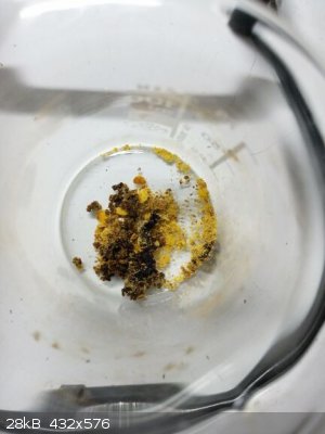

The dark product was vacuum sublimed. Unfortunately it spattered and splashed in the vacuum sublimation apparatus (due to impurities and thus low m.p. ??? it first melted thus distilled and spattered instead of direct sublimation from solid phase into gas phase due to not strong enough vacuum of the cheap chines 2-stage oil rotary vacuum pump ??? - it vacuum grade was able to lower b.p. of 2-nitrotoluene from 220 C to 70 C, pump in good condition, new oil in it). Splashing and spattering contaminated the product on condenser part of the apparatus so the sublimation had to be repeated 5 times (yes, five times, its not typo in the number).
Yield 0,7 g (damn too low, literature claims 1,67-1,97 g) of yellow product (damn literature claims white needles), m.p. 107-115 (lit. 132 C) - damn, too impure.

reactants:

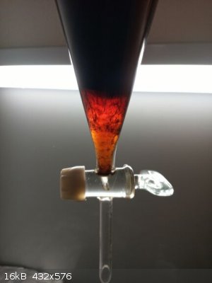

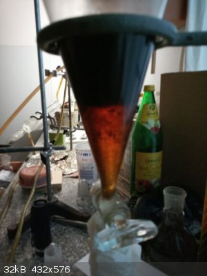

first extraction cycle - 4 repeated extraction totally
first extraction with 100 ml of chloroform - just after shaking, waiting for a separation to occur
IMG_20220808_134329_5.jpg - 35kB
both phases too dark and impossible to identify the border, but LED handlamp helped in the identification of the border, bottom chloroform phase, upper water phase
IMG_20220808_171029_1.jpg - 31kB
unfortunately, from 100 ml of chloroform used for the first extraction circa 150 ml of bottom organic phase resulted (with a lot of water and which is worse phosphoric acid contamination, what else could cause the volume increase) - the bottom phase was real chloroform phase and not water phase as addition of water did not mix with the organic chloroform bottom phase and stayed floating on top of it

chloroform recovered by distillation on boiling water bath to be reused for subsequent reextractions, product collected incrementally as a remainder in distillation flask, the collected chloroform contained a lot of water on top of it (well visible on the photo) due to volume expansion of the separated organic layer = massive water content in the organic phase layer

second extraction = good separation, good visual identification of layers, no water contamination of bottom chloroform organic layer
IMG_20220808_183826_8.jpg - 33kB IMG_20220808_184948_0.jpg - 38kB

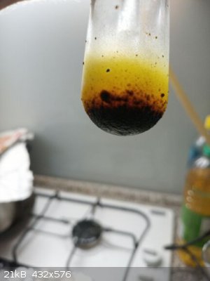

crude product to be vacuum sublimed, it shows some crystalline structure
IMG_20220817_150421_3.jpg - 29kB IMG_20220817_150459_8.jpg - 29kB

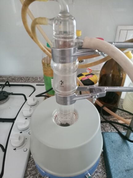

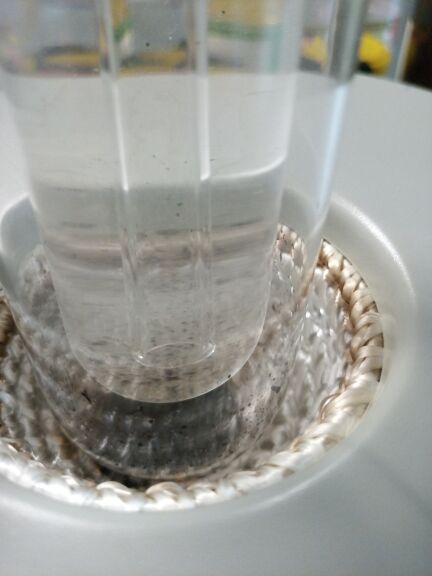

1st vacuum sublimation
IMG_20220817_181920_2.jpg - 32kB IMG_20220817_181933_3.jpg - 20kB IMG_20220817_182106_3.jpg - 26kB IMG_20220817_182745_2.jpg - 27kB IMG_20220817_183357_0.jpg - 21kB IMG_20220817_183845_5.jpg - 21kB IMG_20220817_183851_4.jpg - 21kB IMG_20220817_183916_4.jpg - 21kB IMG_20220817_185604_8.jpg - 16kB IMG_20220817_201303_7.jpg - 28kB
2nd vacuum sublimation
IMG_20220817_203412_0.jpg - 25kB IMG_20220817_221233_1.jpg - 25kB IMG_20220817_221244_9.jpg - 26kB
3rd vacuum sublimation
IMG_20220818_144234_8.jpg - 17kB IMG_20220818_150344_1.jpg - 26kB IMG_20220818_150853_9.jpg - 21kB IMG_20220818_150858_3.jpg - 24kB IMG_20220818_152752_1.jpg - 21kB IMG_20220818_152759_9.jpg - 17kB
4th vacuum sublimation
IMG_20220818_153727_5.jpg - 22kB IMG_20220818_155208_3.jpg - 21kB
the result of 5th vacuum sublimation
IMG_20220818_185822_5.jpg - 23kB

Hi Bedlasky, yes I got something. But the m.p. does not match, the color does not match. The experiment and workup lasted 11 days with some interruptions and resting days... At least I got much more skilled in vacuum sublimation :D
A lot of tar / black / carbon / sideproducts - well visible in the picture where I removed the condenser part of the vacuum sublimation apparatus and cleaned the remainders in the apparatus - the part with 45/40 size naked male joint and black something inside.
