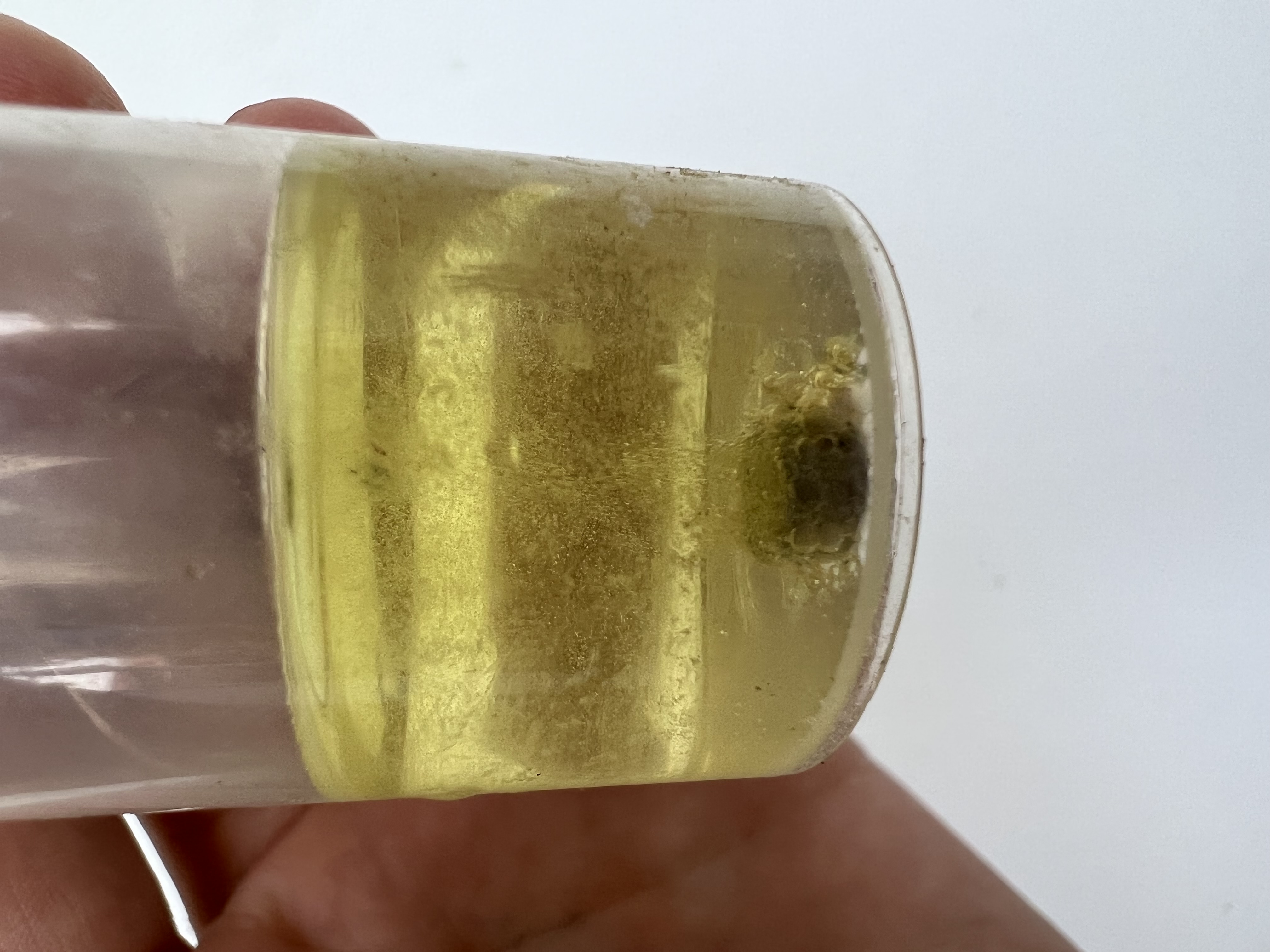

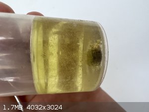

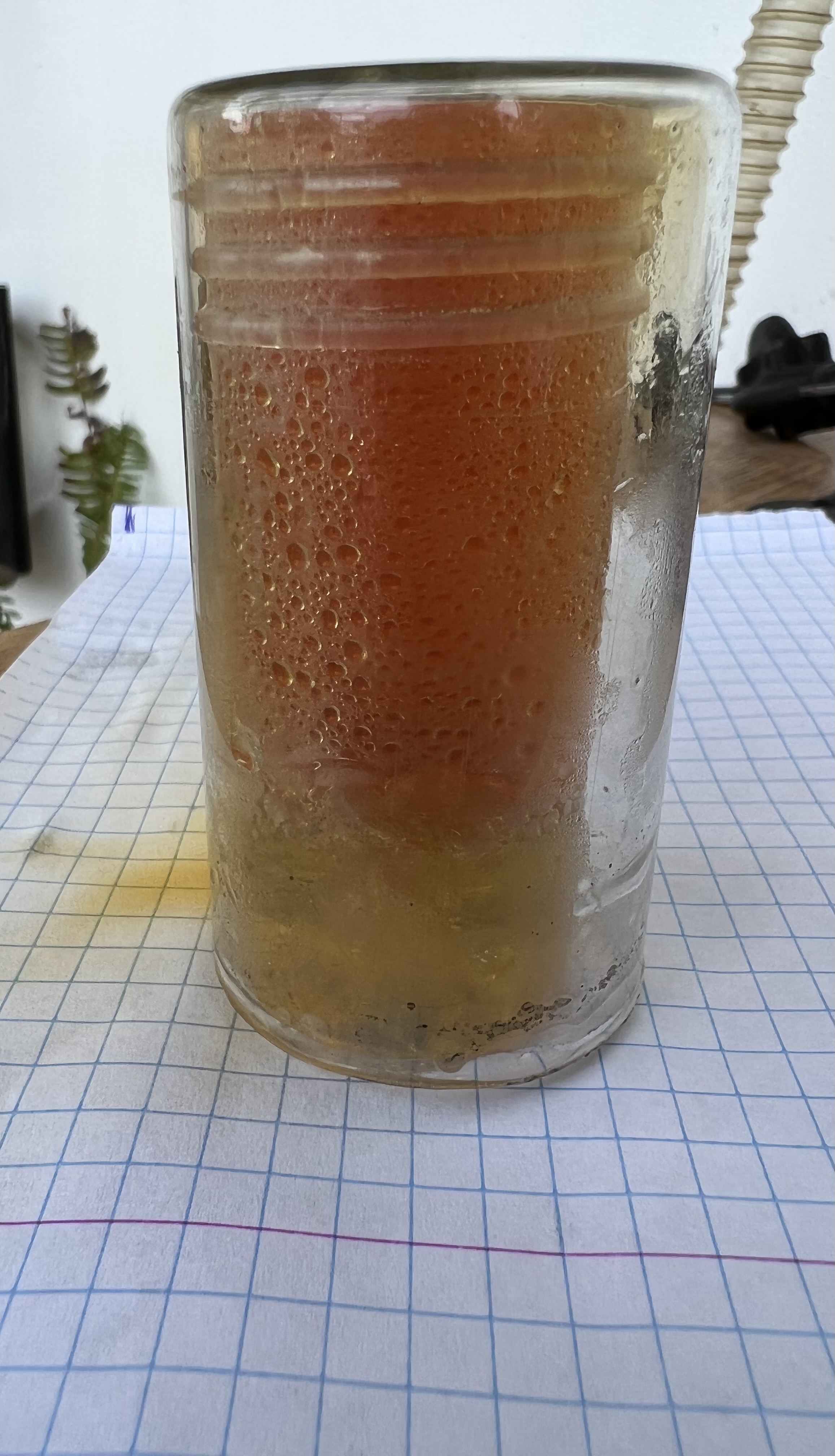

Hello! today I dissolved some niobium in conc. HNO3 and HF mixture. I have previously dissolved tantalum in an acids mixture, and have done the same now. Although the reaction was quite vigorous, I thought it would take more time, but in a few minutes, the metal was completely dissolved.
Of course, the reaction released heat, but not enough to melt the plastic. As you can see, I made the reaction in a small plastic box.

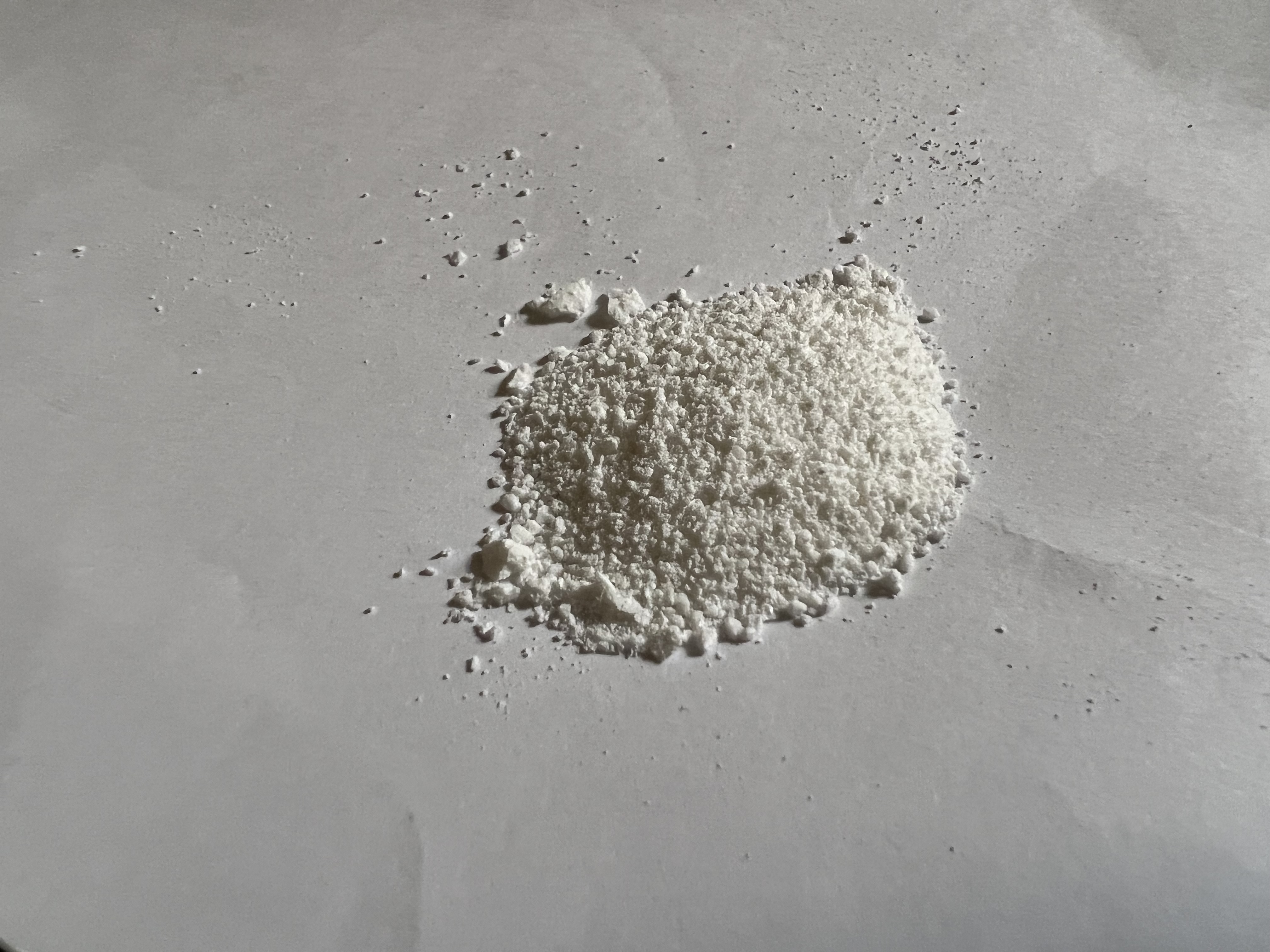

I neutralized the solution with carbonate and precipitated the less soluble Na2[NbF7], washed with cold water, some hydrolyzed, now I have a mixture of Na2[NbF7] and Na2[NbOF5], It doesn't matter, I'm going to add sulfuric acid and make the oxide.
IMG-1509.jpg - 1.7MB
IMG-1511.jpg - 1.5MB

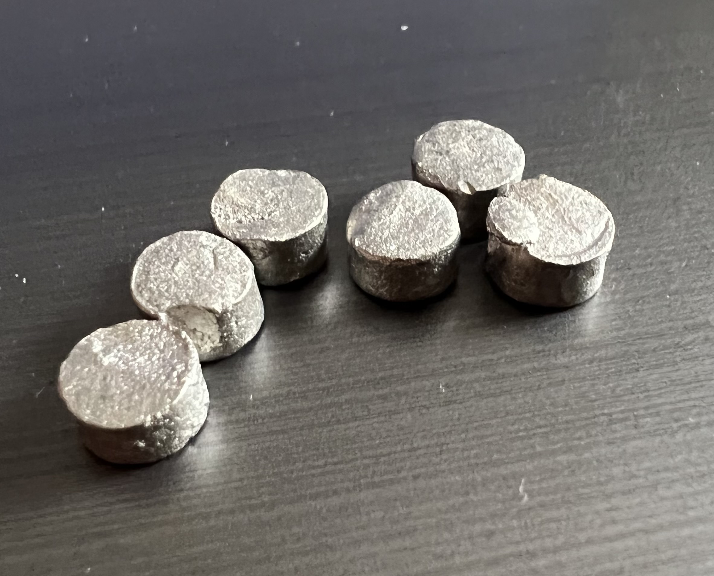

Niobium metal.
IMG-1495.jpg - 741kB

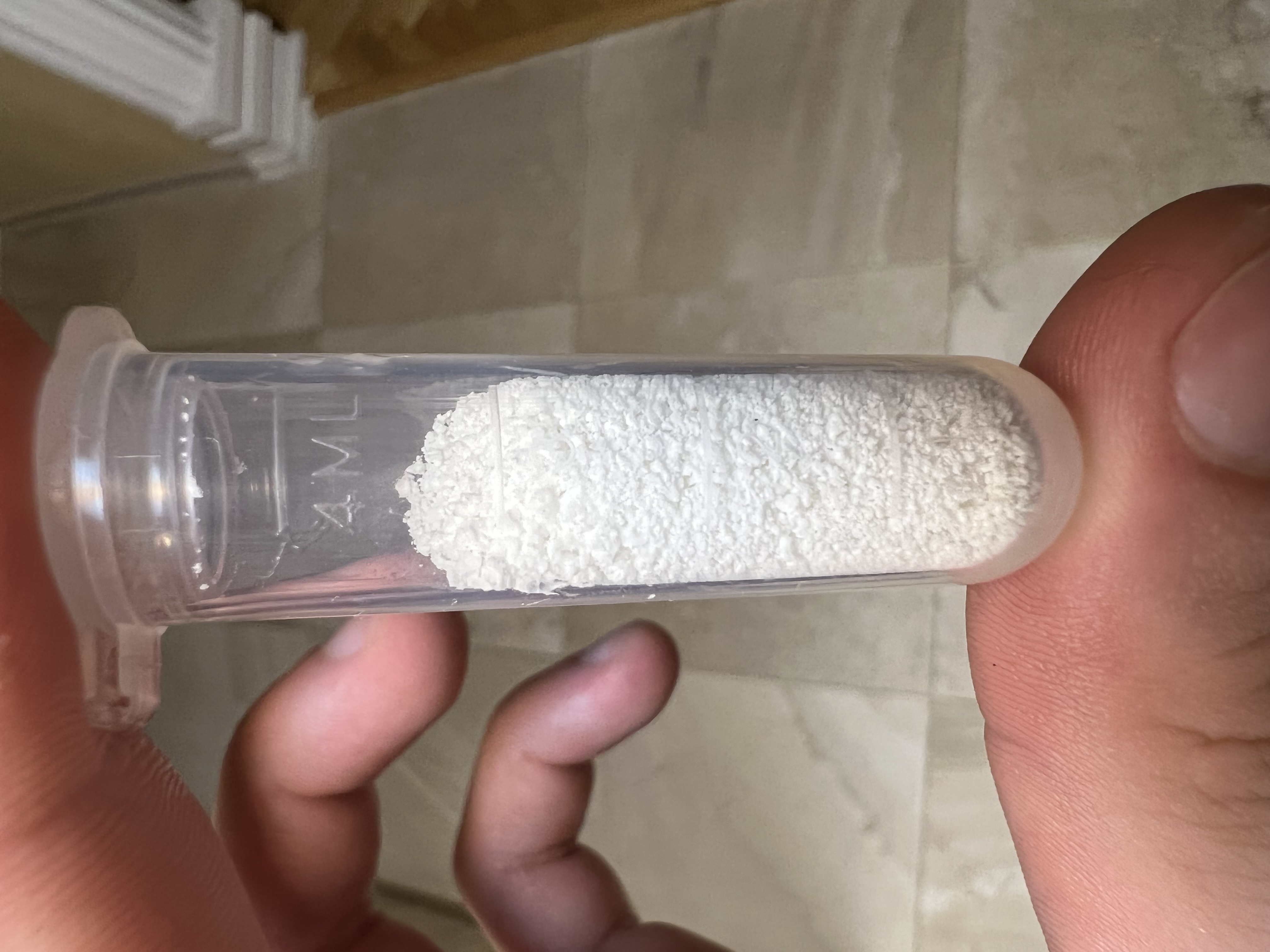

samarium14
Posts: 661
Registered: 22-3-2019
Location: Georgia
[*] posted on 19-8-2022 at 08:47

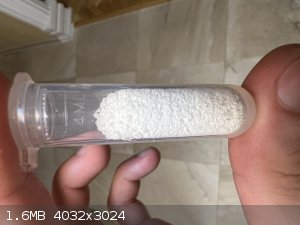

Na2[NbF7]
IMG-1515.jpg - 2.1MB IMG-1516.jpg - 1.6MB
