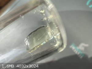

Hello! now I have a few ampoules of OsO4. I searched here but osmium chemistry is rare. I think what can I do with the oxide? I want something interesting and I will take any advice.

Leave it ampuled. It's named after the way it stinks for a reason.

If you do open it, be very careful. It’s surprisingly volatile and extremely toxic. It really should only be handled in a fume hood. You can inhale a deadly dose at concentrations lower than you can smell.
Not sure about inorganic osmium chemistry, but the oxide itself is used extensively in organic chemistry as a catalytic oxidant. It’s usually used with a stoichiometric amount of a re-oxidant like NMO, hydrogen peroxide, or ferricyanide, due to its high cost and toxicity. Most commonly this is used to convert alkenes into cis-diols, and it can be extended to convert alkenes to two aldehydes, similar to ozonolysis, by addition of periodate. See here: https://en.m.wikipedia.org/wiki/Lemieux–Johnson_oxidation

thank you! I will not work with it at home, of course in the laboratory. the best way is to crack it, put the broken ampoule in a solvent , and close the bottle.

From my recollection the big issue is damage to the eye tissues due to exposure to the tetroxide. Just be aware, as others have mentioned it's surprisingly volatile.

If I had that I would try those sequences of preparations ("->" means that the left is the starting material for the right):
- OsO4 -> KOsO3N -> K2OsCl5N
- OsO4 -> (NH4)2[OsCl6] (or (NH4)2[OsBr6]) -> [Os(NH3)5(N2)]I2 -> [Os(NH3)5I]I2
- (NH4)2[OsCl6] (or (NH4)2[OsBr6]) -> [Os(NH3)6]I3 -> [Os(NH3)5(NO)]I3 -> [Os(OH)(NH3)4(NO)]I2 -> [OsI(NH3)4(NO)]I2 ("I" could be substituted with Cl or Br)
All those preparations were published in "Inorganic syntheses" (vol. 5, 6, 16). Except for the issues with the toxicity (of the starting compound) all those syntheses are relatively easy and they don't require any exotic equipment/techniques/chemicals.
The interesting part is that to get any compound from the right you must perform all intermediate syntheses which can be a long-term project.

OsO4 can instantly blind you if it or it's vapor contacts your eyes. Your corneas will turn irreversibly black due to reduction to metallic osmium within the tissues. Osmium chemistry is one of my huge nopes.

yes of course. but I want to work with tetravalent osmium. I will reduce it with thionyl chloride and then remove all air with a vacuum. I will make this reaction in the lab and it will be safe.

Osmium tetroxide sole usage (in organic chemistry) is to transform a double bond into a gem-diol.
But this can be done also with potassium permanganate, which is orders of magnitude less toxic and dangerous for your eyes than OsO₄.

I don't want to work with aqueous solutions, I want anhydrous tetrachloride to make organometallics in an organic solvent. also thyonyl chloride reaction is something new and funny for me, i want to try it.

Then I suggest that you first try experimenting with thionyl chloride and other chemicals than OsO4. Reactions with thionyl chloride can be quite violent and can produce lots of fumes/gases. The produced fumes/gases usually are of the SO2/HCl kind and can be dealt with by the more experienced home chemist, but if there are osmium-containing vapors in it as well, then that could lead to very nasty surprises.

Maybe you don't get OsCl4 vapors, but what if some unreacted OsO4-vapors escape? Can you be sure that this does not happen, or that you can contain the Os completely. I know from experience that with experiments with SOCl2 it is almost impossible to contain all of the huge amounts of HCl-fumes and SO2-gas, which can be produced. Breathing a whiff of SO2 or HCl, or getting stinging eyes of SO2 or HCl is unpleasant, but not fatal. But getting fumes of OsO4 in your eyes may be very serious for the rest of your life.
I once did an experiment with RuO2, and took a little pinch of that (maybe a few mg) and left this in an erlenmeyer with bleach in it. This gave a nice deep red solution. I put this away, without a cap. Several days later, I came back and saw that the liquid had become colorless, and there was a big stain on the workbench around the erlenmeyer. When I removed the erlenmeyer, the surface under it was still clean, the rest is considerably darker. This happened a year ago or so. The stain still is there, I cannot remove it from the workbench. I tell this as a demonstration of how extremely easily stains are obtained from minute quantities. And this was with RuO4. OsO4 is worse!

it is necessary to use exec thionyl chloride I think, it is an osmium oxide hydrate, so ill remove water also. I think the reaction will go at room temperature, then I use a vacuum. I know that the water-thionyl chloride reaction produces HCl, which can form chloroosmic acid, but it must be small contamination, but I can remove it with heating and a vacuum. It's good also that tetrachloride has 323C as the decomposition temperature.
there are some issues also, mostly theoretical for example SO2 as a bridging ligand, but I'm not thinking of such theoretical things, just low possibility. the final step of synthesis must leave only tetrachloride.

OsO4 is actually rather nasty, much worse in comparison to even RuO4.
The first thing one notices is a halo around the lights when working with it and the vapors are escaping.
