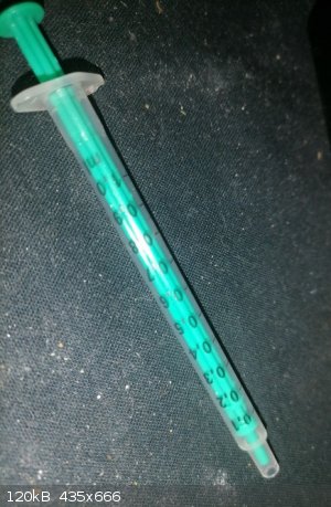

A 1ml syringe made from PE?
syringe.jpg - 120kB
Irgendwas is ja immer
