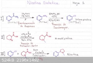

On The Synthesis of Nicotine
Greetings !!
So i'm working on the Synthesis of Nicotine, the idea is to make it so that it's reasonably economic compared to the extraction of nicotine from tobacco, considering the tobacco accessible is less than 3% Nicotine Content.
My pathway is the next:
NICOTINA SINTETICA  [Esquema].jpg - 524kB
I think is reasonable, what do you Think ? :).
NOTE: The idea is to make it from bought 3-Cl-Pyridine and N-Methyl Proline
Some Report: Yield for Hoffman Reaction is: 45.4% and for Sandmeyer 21,27% for First try. The Eschweiler-Clarke reaction on Proline does not seems to want to work.

[*] posted on 5-10-2022 at 18:33
Steps I and II seem ok in terms of potential success. I do not accept step III as a highly probable reaction sequence. Can you provide additional detail and references which you believe support the reaction as proposed? Even if step III succeeded as written, the nicotine would be racemic whereas natural nicotine is chiral.

The idea was that Nicotine seems really similar to a Pyridine and a proline, just bonded :) So ... i thought of the pathway presented above
The Final Decarboxylative coupling is a reaction i didn't know about. Here is a paper with examples. "Decarboxylative coupling reactions: a modern strategy for C–C-bond
formationw" DOI: 10.1039/c1cs15093f

[*] posted on 6-10-2022 at 05:14
Pretty sure that the reaction of proline and formaldehyde is giving 2,3,4,5-tetrahydropyrrolo[1,2-c]oxazol-6-one, i.e. ring closure to an inert hemiaminal. You may need to esterify proline first.

Yes, i did bisify when steam distilling the nicotine, and even try Acid-Base extraction, there was just not much nicotine in it, and a lot of junk.
In regards to the proline step, i think i will try the methylation with methyl iodide at some point, and esterifing it seams possible. I will report back :)

[*] posted on 6-10-2022 at 15:20
Chem Science -
Thanks for the reference helping justify your step III. Have fun with the synthesis attempt. I look forward to a report.

[*] posted on 7-10-2022 at 08:16
With methyl iodide it's very possible to over-methylate it, and end up with a quaternary ammonium salt.
It may be worthwhile making that step a reductive amination instead, with sodium cyanoborohydride as the reducing agent.

[*] posted on 7-10-2022 at 09:23
Hi Lionel.
cyanoborohydride are far from possible for me. And yes it's true it can over methylate, but generally Tertiary amines are done there way with reasonable yields.

[*] posted on 13-10-2022 at 13:54
Kinda wonder if you could do it with a 1,3-dipolar cycloaddition of methyl acrylate or a similar C2-synthon onto the azomethine ylide formed by decarboxylative addition of sarcosine to nicotinaldehyde followed by decarboxylation
