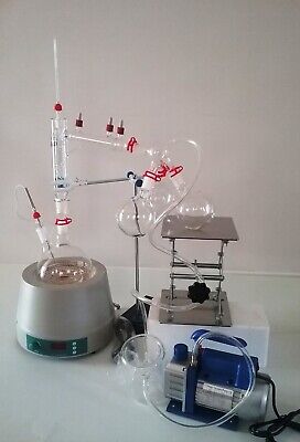

In the picture is that a air bleed tube going into the distillation flask?

And is vacuum distillation done by cranking up the heat on the hotplate and then watching for spikes/plateaus on the thermometer, before turning the cow?
Did someone previously state that the vacuum levels cannot be adjusted?
Would I even need a cow?? Couldn't everything that boils off below the desired temperature simply be discarded?

I guess one could not discard the stuff that comes over first without breaking the vacuum.
So the cow is likely essential.

Cow is not essential. One method is to break the vacuum between fractions. This likely means you change the temp/pressure conditions between fractions as well, which might be advantageous.
However, big changes to P/T conditions in the middle or a process are something to generally be avoided. In a normal setup, P is kept constant and the temperature at the still head informs you as to what is happening in the system. You lose this information if you break the vacuum.
There is much to learn about simple distillation procedures before adding the complexity of a vacuum. Unless there is a particular need, I would be sticking with atmospheric pressure for most situations.

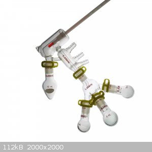

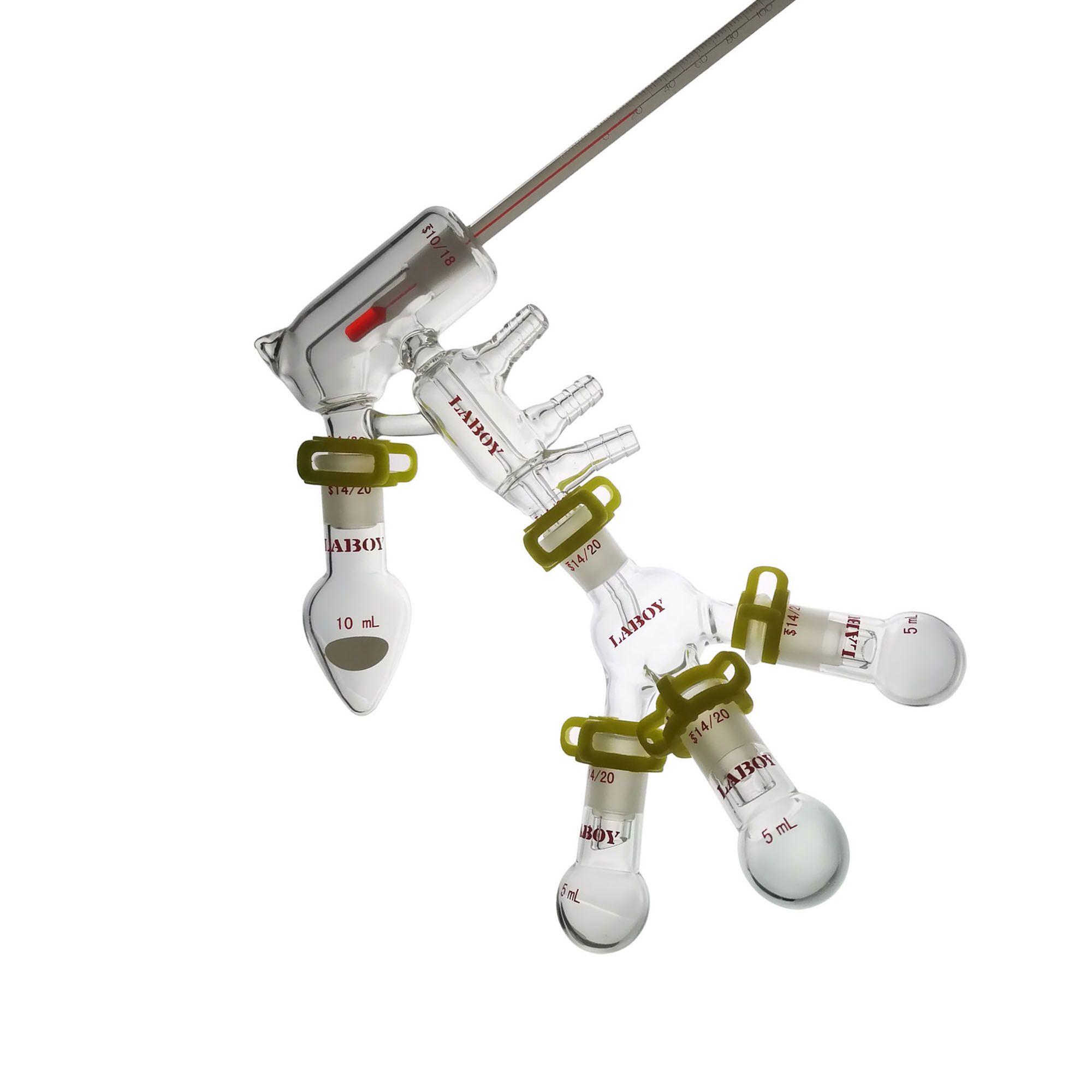

Wouldn't the pear shape flask prevent magnetic stirring?
Both devices are considered short path distillation.
In which instance is the micro short path distillation apparatus used?
lbspda14.jpg - 112kB
[Edited on 11/3/2022 by Yttrium2]
