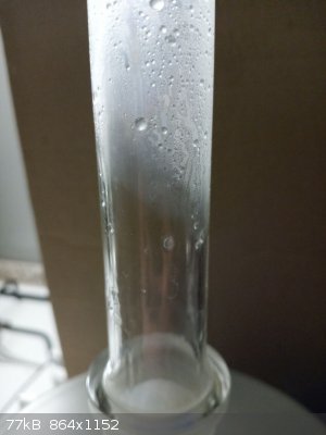

Refluxed for 9 hours (maybe 2-4 hours could be enough but my catalyst was from sales and certainly older than fresher and produced for unknown purpose for uknown lab / industrial usage). From the beginning nice small bubbles (H2 ?) but soon bumping started and went progressively worse in time. Luckily 50 ml RBF with less than 20 ml content was used and wide tube air back condenser. I can only speculate what caused the bumping but it was very likely H2O by oxidation of H2 ? There were 2 immiscible liquids visible in air condenser, suspected H2O on top part, but some drops flowed down, maybe moisture from not absolutely dry 1,2,3,4 tetrahydrocarbazole?, Pd/C used in this experiment was recovered from 4-phenyl-butan-2-one experiment and air dried. Or maybe cumene hydroperoxide formed? Luckily I at least distilled it before the experiment. Cumene hydroperoxide could help in dehydrogenation reaction as would quickly remove H2 from Pd.

The bumping itself was not the worse fact, the worse fact was that water presence reduced dramatically boiling point and thus reflux temperature and thus reaction rate.

some very likely water (oxidation of H2 with O2 from air?) above condensed cumene - whole condenser on photo
IMG_20221220_075533_3.jpg - 78kB
top, middle and bottom part of air condenser with suspected water present

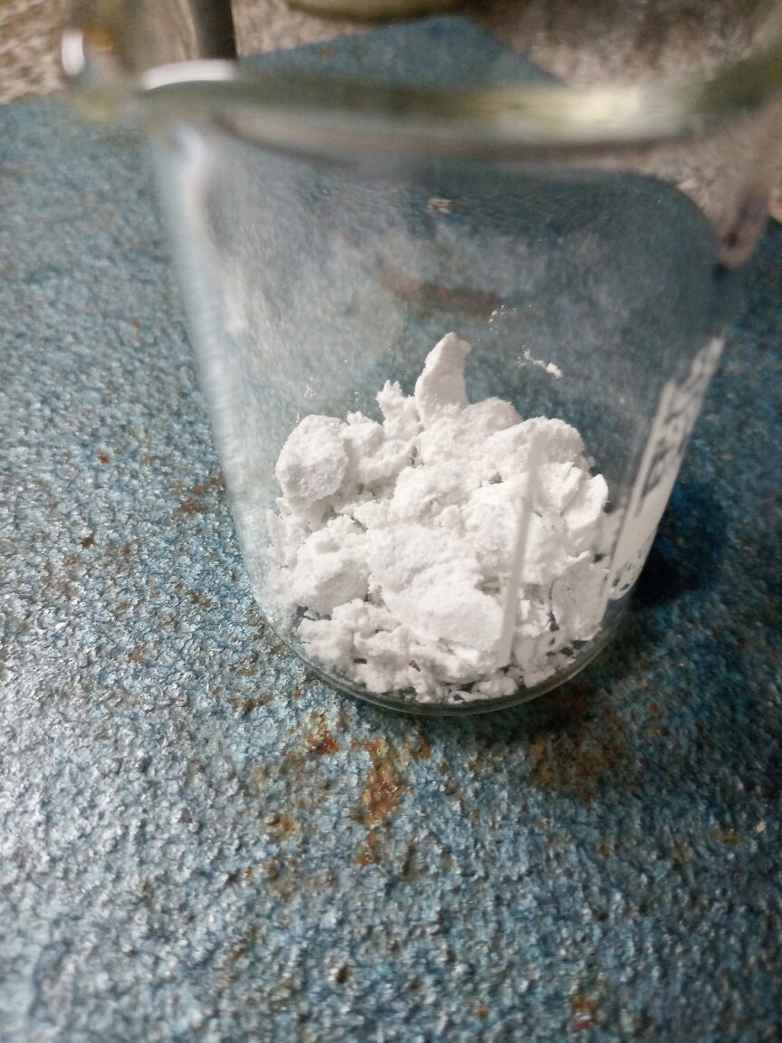

after drying overnight 1,3 g of crude product obtained which was magnetically stirred for 1 hour with 25 ml of 85%vol methanol
IMG_20221221_053409_7.jpg - 112kB
product vacuum filtered on sinter
IMG_20221221_064932_0.jpg - 40kB
and transferred into a beaker for air drying
IMG_20221221_070943_7.jpg - 169kB
