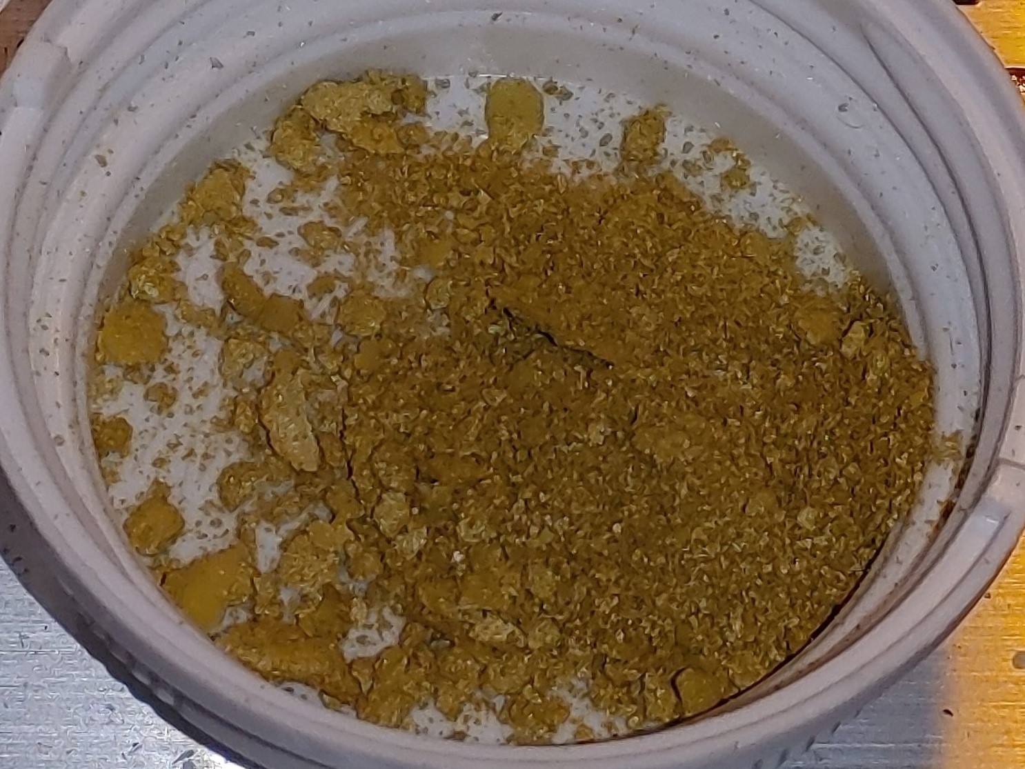

My steps towards synthesizing this compound were as follows:
  1. I weighed out 500mg of tetraamminecopper(ii) sulfate and added it to about 5mL of lukewarm water, then swirled to dissolve.
  2. I then shot in about 0.5mL of ~10% ammonia solution with a pipette and swirled again to mix.
  3. In a separate beaker, I added 500mg of ammonium picrate crystals to about 25mL of warm water. I used magnetic stirring and a small amount of heat to dissolve everything.
  4. I then added the tetraamminecopper(ii) sulfate solution to the stirring ammonium picrate solution. Immediately, a gold precipitate formed.
  5. I let it stir for a minute more, then filtered off the precipitate using a coffee filter. The filtrate remained a deep blue due to the significant excess of tetramminecopper(ii) sulfate used.
  6. I washed the product and filter with a small amount of cold water, then dried—first using a paper towel to remove free water, then a fan to completely dry it.
  7. After it was dry, it weighed 572mg, which is a yield of 94.3% (theo. 597mg).
Wet product (left) and dry product (right):
ProductWet.jpg - 1.3MB ProductDry.jpg - 475kB
The only compound I can think of this to be is tetramminecopper(ii) picrate, as the ammonium concentration was too high to allow for copper(ii) picrate to form, and even the filtrate remained the characteristic tetramminecopper(ii) color. As well as that, the color of the product is markedly different than copper(ii) picrate, which is a lime green and not a gold. Exposure to flames gives results of both a copper compound (green-ish tint to the flame) and a picrate (rapid, sooty decomposition). As a result, I'm fairly confident that the compound I've isolated is, in fact, tetramminecopper(ii) picrate.
