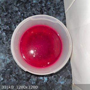

I was interested see if this magenta color would result in a similarly colored dry solid. So I placed some in a shallow dish:
4 Purplered liquid.jpg - 331kB
It dried slowly, and now after a month I do indeed have a magenta solid, still very slightly sticky. And with mold growing on it. Quite a pleasant smell.
5 Dried.jpg - 159kB
I would love to know what the magenta compound is. And maybe this is a safe demo for school students to show a color change?

Perilla contains a pigment called anthocyanin. Anthocyanin is also contained in many other plants such as hydrangeas, red cabbages and pansies.
And yes, they are great materials for teaching. Here is a video that Japanese TV station made for education. https://www2.nhk.or.jp/school/movie/clip.cgi?das_id=D0005400... It’s Japanese but I think you can understand the pictures.
I haven’t done this experiment with perilla before, but I have with red cabbages. Keep in mind that they are unstable and not suitable for storage.

https://en.m.wikipedia.org/wiki/Anthocyanin
anthocyanins
Very nice color, the change was a result of acidity, add a base and it will turn blue

Lion850, use sodium carbonate as a base. From my experience NaOH destroy anthocyanins rather quickly, they turn brown and lose their ability to change colour with pH.
