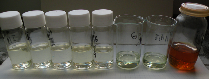

And the last one: a gallery of samples and a residue.
They were collected with more or less equal amounts of water (5 x ~50 ml and 2 x ~25 ml, from left), to check if it is uniform product (by density measurements). The first sample (not shown - no color and appearance difference with the others), gave slightly less density (the most possibly MO traces) than next 6 ones, with practically constant density. The last sample has again sligtly less density, because of XYL content. The orange-red liquid is mentioned earlier post-distillation residue. It has not very pleasant odor, not IPH like.
03.PNG - 409kB

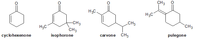

my results
enone_catalysts.png - 4kB
Reading up on isophorone it appears to be choice catalyst material in the decarboxylation of α-amino acids, as a cyclohexenone derivative that is unsubstituted in the ortho-positions so from a steric point of view unhindered (compared to natural occurring derivatives like carvone and pulegone commonly used for that purpose by amateur experimenters). For this a crude product of technical purity should suffice, so this makes kmno4's procedure quite attractive. Here is what I made of it:

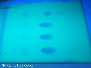

TLC
TLC solvent was methylene chloride
1, 2, 3, 4 stands for the first 10 ml collected, second, third and last 10 ml fraction from above experiment
It is surprisingly hard to find TLC data on acetone condensation products.
IMG_20240411_124346.jpg - 50kB IMG_20240411_124240.jpg - 44kB
I suspect the most prominent streaks to be isophorone isomers and the spot above it to be mesityl oxide? There's an additional unknown spot present in the first and last samples.
sic transit gloria mundi

I noticed rather low yield of your IPH, taking into account amount of used AC.
Unfortunately, reaction AC with KOH is controlled by too many parameters: purity of reagents, AC:KOH ratio, temperature and time of reaction. Also speed of stirring is important and it should be high (to avoid accumulation of products on KOH surface).
Elevated temperature is generaly harmful for IPH yield, just too many isoXYL and resin are formed. At lower temperatures (around 0 C), MO formation is predominant. Separation of MO and IPH is easier than separation of isoXYL and IPH. Besides, MO can be reused, isoXYL and resin are useless. Interesting is also slight change in color (but easily seen) and small sediment formation when post-condensation organic liquid is treated with H3PO4 (or similar, not very strong acid). This step is very important, traces of any alkali must be removed from the mixure before distillation. In another case, large amount of polymeric, tarry material is obtained, the yield of IPH is reduced.
H3PO4 is too weak acid to cause some larger condensation, even during distillation of the mixture.
Prepared IPH is surely better than 90%, at least I think so, but it does not freeze even far below 0 C. Most possibly, depression in m.p. caused by impurities is large. Overcooling is rather ruled out, but who knows.... Removing of beta-IPH, always formed by-product in small amount, is practically impossible, using such simple methods as above.
The only examples of TLC of similar mixtures I have seen, were performed with DNP derivatives and n-hexane-ether solvent system (80/20 v/v).
