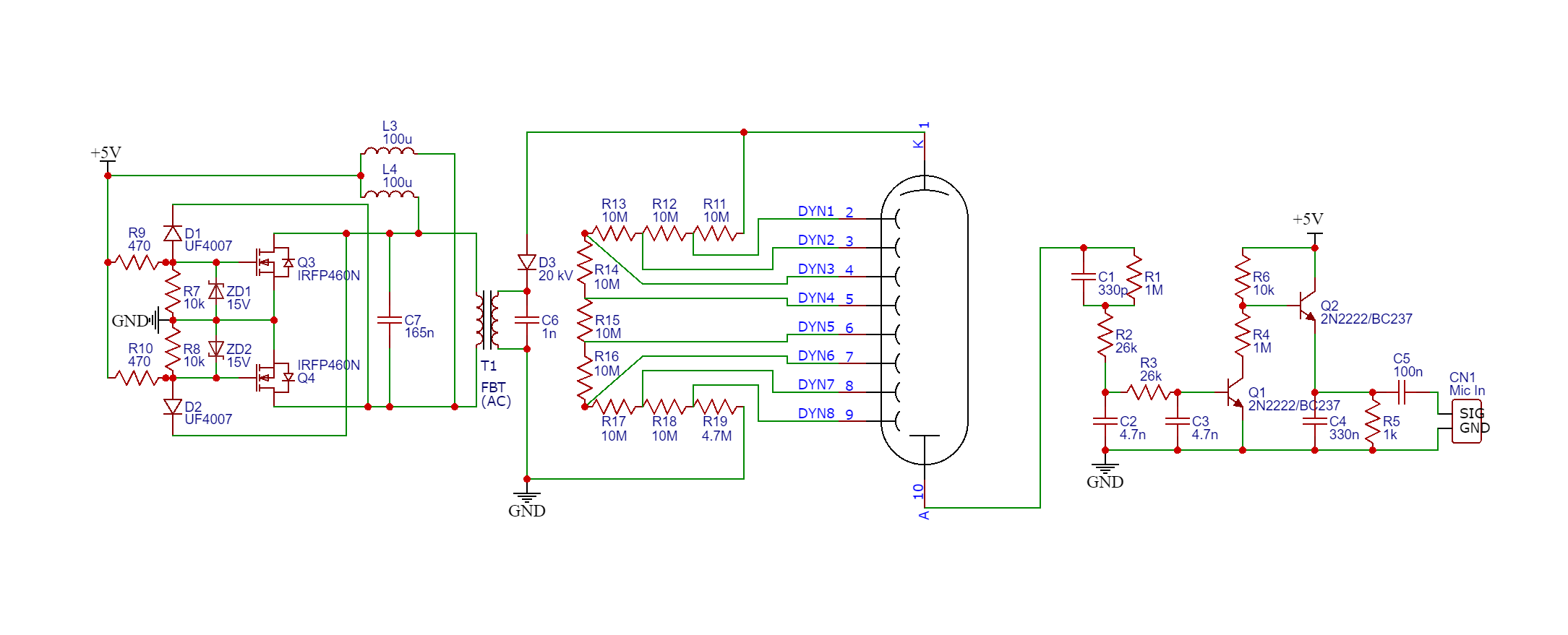

I have been working on a homemade gamma spectrometer and have tried to make it as low-cost and easy to build as possible. I know others have been working on their own designs but I am trying to make this an "entry-level" spectrometer, so some things like spectral quality are sacrificed. I'm aware that there are other threads on here similar to this one but my goals and outcome are different than the existing threads (what about merging these into a combined DIY gamma spectroscopy thread?)
This project is ongoing, and its goals are as follows:
  • All parts must be easy to source. The most difficult part to find is the AC flyback transformer, which can be extracted from a plasma globe toy or certain CRT TVs.
  • The output must be processed through a PC sound card without any multichannel analyzer circuitry.
  • The circuitry must be simple enough to be troubleshot or modified by someone with modest to intermediate levels of electronics experience. This means as few parts as possible and no integrated circuits.
My design is based on the Hamamatsu R7400U photomultiplier tube coupled with a CsI(Tl) scintillator crystal. The tube and crystal can be bought for $25 on EBay. The high voltage power supply uses a zero-voltage switching (ZVS) driver which drives a small AC flyback transformer. I want to give credit to Theremino because the signal conditioning circuitry is based heavily on the design used in the Theremino PMT Adapter as it is very simple and easy to service. It features a low-pass filter followed by an amplifier stage, a second transistor which lowers impedance, then a second low-pass filter. The full circuit schematic is shown below:
gammafreak4.png - 108kB
Important notes: diodes 1 and 2 MUST be ultrafast. UF4007 (NOT 1N4007) will suffice. The MOSFETs (Q3 and Q4) can be any N-channel FET with a gate-source voltage >10 V. This driver was designed for much higher power outputs than the spectrometer requires so the IRFP460N is kind of overkill, I'd recommend something smaller like IRFZ44N. The 20kV diode can be replaced by any diode with >2 kV reverse breakdown voltage, such as those found in microwave ovens. Finally, voltages in the 1000V range are generated in this design and although it is unlikely to injure you, the shock certainly hurts. Touching the negative terminal of the HV diode WILL shock you regardless of grounding as it is still AC at that point.
The output of this circuit is plugged directly into a PC soundcard. Spectra can be produced using either Theremino MCA or PRA, both of which are freeware. Theremino is easy to use and produces "prettier" spectra due to its use of an IIR filter but is not very tunable and completely lacks any calibration functionality aside from a couple completely useless sliders. PRA is harder to use and somewhat finicky but is far more customizable and uses a much more sensible calibration method.

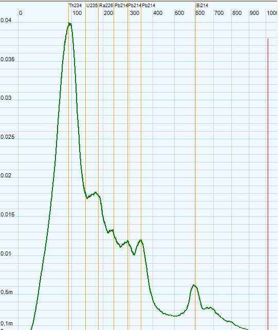

uraninite_edited.png - 13kB
Gamma spectrum of uraninite mined in NH
The spectrometer is also able to produce the expected spectra for americium-241 although I apparently did not save the spectra for those samples. Once I get my hands on some Cs-137 I'll post the spectra for that as well. The spectral quality rivals that of the Radiacode 101, the cheapest pre-built gamma spectrometer on the market which costs a good $150 more than this cost to build.

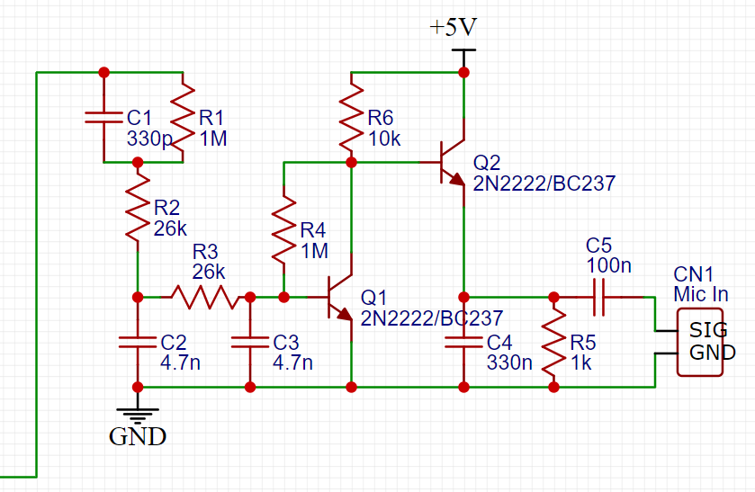

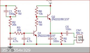

The output amp looks like it will not work as Q2 will be permanently on. Perhaps the bias divider of Q2 consisting of 10k(R6) and 1M(R4) have been accidentally swapped with each other. In addition there is no bias for Q1.
duffamp.JPG - 35kB

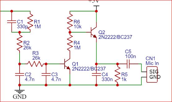

You're 100% right, I screwed up the schematic. R4 should be here instead:
gammafreak_edited.PNG - 95kB
This works in LTSpice btw

With my tired eyes, you're HV section looks reminiscent of the mazila(sp?) ZVS driver for big TV flybacks, but I only remembered winding one toroid for that thing. And I couldn't get it to work, possibly cheap ebay IRFP540's?
This is indeed a modified version of the Mazzilli ZVS driver. The two-choke configuration eliminates the need for a center tap on the primary. And feel free to use a different HV supply design for this, all that matters is that you have a stable *negative* HV source in the 800-1000V range.

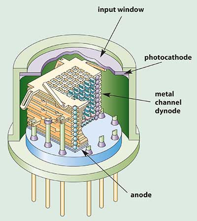

Yeah, this is confusing... I've been reading stuff from Hamamatsu, PHOTOMULTIPLIER TUBES Basics and Applications FOURTH EDITION, to get a general idea. After getting stumped on the datasheet.
Because the spec sheet for the part from eBay, namely R7400U, shows two configurations for pinout on Accessory parts sockets(sold separately), depending on cable ( Type E5780) or PC-Board connections(Type E5770). One method, cable, showing a negative voltage (-HV) required on the cathode, and the other, PCB, showing a grounded or -HV cathode and a +HV or ground anode, respectively.
Perhaps a normal HV source would do. It looks like that may be necessary because of the shielded signal wire, in the case of -HV only cable hook up.
Next I found myself wondering why there would be dynodes on a Si based PMT, and if they were structurally by strata in the wafer... But chased my tail for a while to realize it has a stacked metal channel dynodes structure (on the spec sheet, duh!) and initial phosphor like ordinary PMT's. This picture helped a lot!.
Photomultipliers_Hamamatsu_Figure1.jpg - 26kB
Time consuming to leaf through such technical and unfortunately alien information. There were a number of helpful papers that are available if you want to read up, some of which were thesis type literature, covering background information, so you can see other things this tech is used for. None of which contributed anything memorable given it's dang near 1am and I'm half asleep.

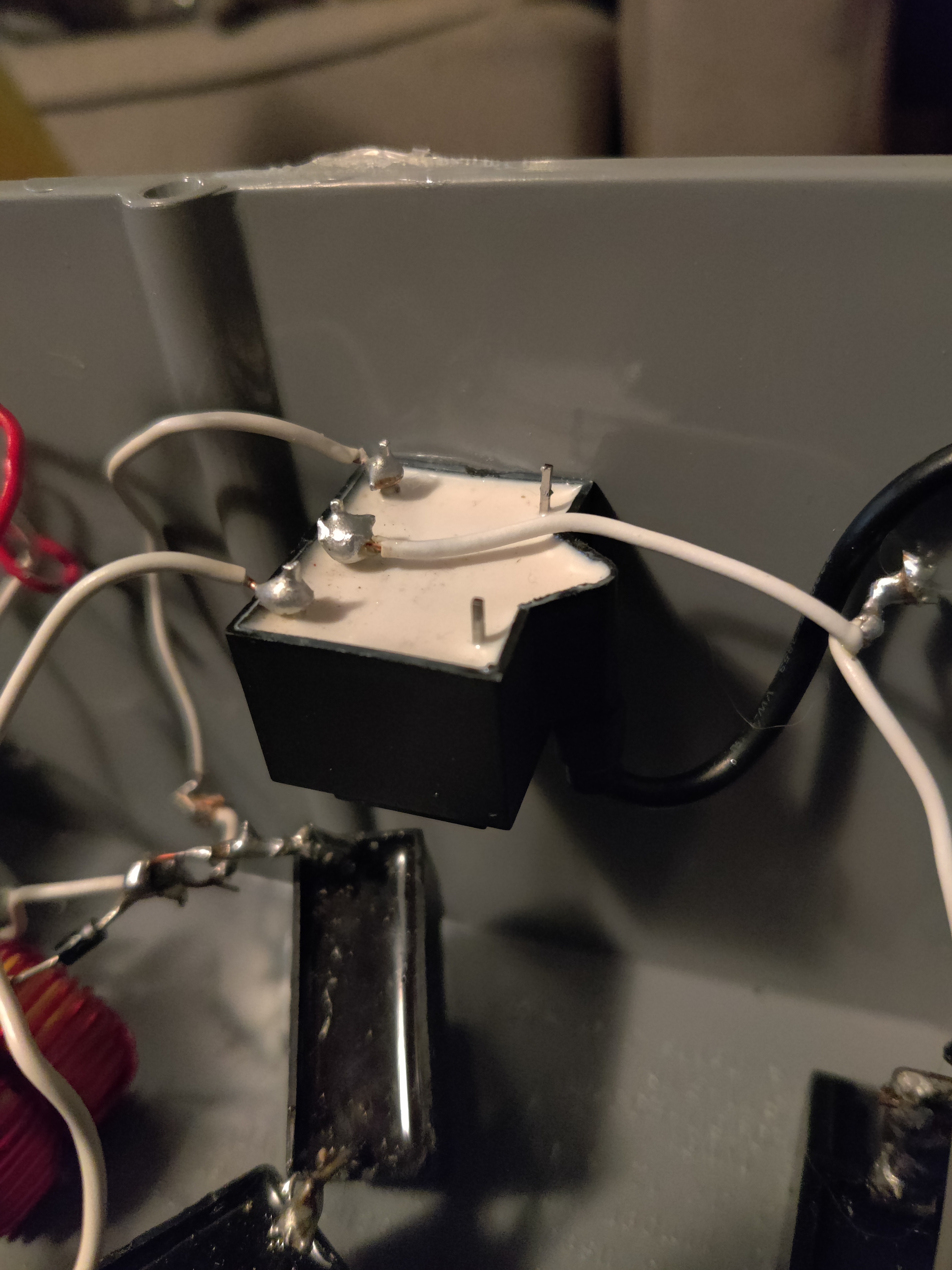

I still wouldn't mind a pic of the transformer you used, or a link to something approximate, that could give me a clue as to what I'd want to look for on E-scrap I've around here.

The gentlemen at GQ ( https://www.gqelectronicsllc.com/ ), whom make several enjoyable Geiger Müller tube based logging counters like my GMC320+/320S, were interested in this since I mentioned the cut rate sensors a few months back. Though their recent ebay purchase gave no love when electrified. I'm not sure if it was DOA or what. I gave a link to this thread and suggested -HV.
I have to say, I'm a little starstruck. My first ever Geiger counter was a GMC-300. If they were trying the same Hamamatsu R7400U tube, let them know that my first one was also DOA and I had to buy a second one (which worked immediately).
Any transformer that can step up to voltages in the 1000 volt range (such as those found in electric flyswatters) should in theory be suitable. Winding your own might even be easier than finding one in the wild though. Here's a photo of mine (it's mounted upside-down):
IMG_20230308_215210.jpg - 2.3MB

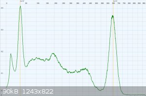

Got my hands on a cesium-137-containing spark gap tube, so I was able to get the following Cs137 spectrum using my spectrometer. I also fixed the issue with nonlinearity at higher energies; I found the PMT drive voltage was out of its linear range so I added a buck converter to the design to lower VCC from 5 volts to 4.7 volts.
cs137_clean.PNG - 90kB
Cs137 gamma spectrum showing the Ba137m decay photopeak at 662 kEV, barium L and K XRF lines at the far left, and a clear Compton scattering continuum in the middle of the spectrum.

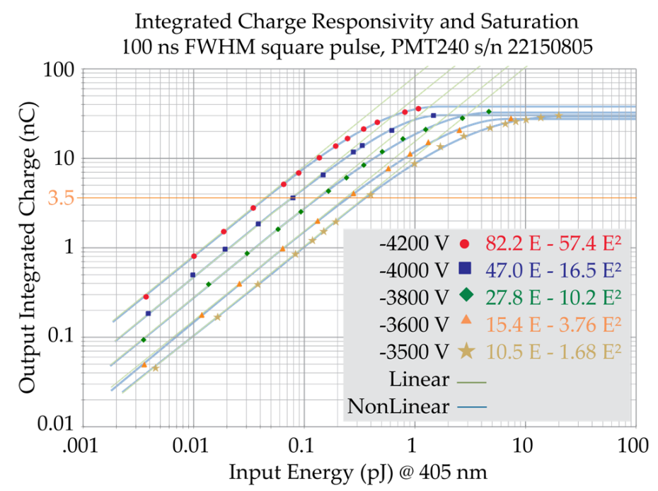

So it needed more overhead from the supply rail than a hard 5v pull from 5v supply? Did the amperage draw in a stronger radiation flux, sagg the V to add to the distortion?
The current draw wasn't the issue (although I have yet to measure it, it's probably much less than 1 amp), it's more of just the way photomultiplier tubes are. Typically you want the output current for a given scintillator "flash" to be directly proportional to the number of photons produced by the scintillator (I = a*Φ). Fluxes above a certain threshold will produce an output current with a nonlinear relationship to flux. The higher the drive voltage, the lower the flux at which this nonlinearity kicks in. This is due to space charge becoming non-negligible within the tube at high gain, leading to deviation of electrons from the typical multiplication path.
PMTLinearity.png - 255kB
This figure which I lifted from "Superlinearity, Saturation, and the PMT-Tailoring and Calibration Methodology for Prompt Radiation Detectors" shows how the linear input range becomes narrower at higher drive voltages. When collecting spectra, this results in the high-energy end of the spectrum being compressed down to lower energies than what it should be at.

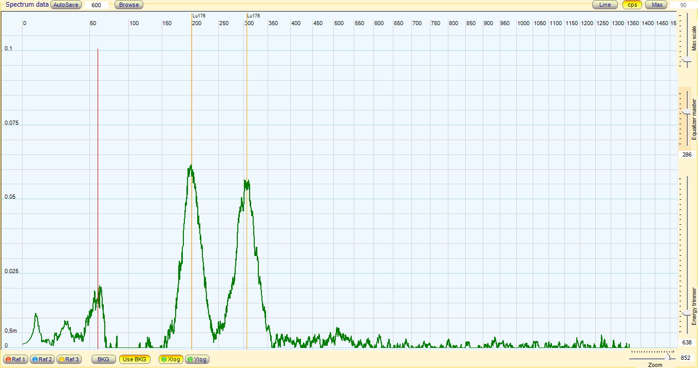

PROJECT UPDATE:
I am currently working on improving the energy resolution of the spectrometer below 50 keV so that it can be used for XRF analysis. XRF peaks in this range are visible, however they currently are too broad to be resolved to most individual elements. Relatively pure elements with large Ka and Kb energies (ie the lanthanides and heavier elements) can be resolved, but only under higher excitation energies and in the absence of any other nearby XRF lines.
I also have found that this spectrometer, which I am endearingly naming the GammaFreak, will respond to incredibly low-intensity gamma ray input. It can produce a spectrum of lutetium-176 from a ~1 cm^3 crystal of LYSO (lutetium yttrium oxyorthosilicate). Given the 38 billion year half life of Lu176 and its 2.6% natural abundance, only about 300 atoms decay per second in this crystal, which is tiny. My geiger counter shows no change from background for this sample, yet the GammaFreak was able to pick up the Lu176 decays and produce the following spectrum over 15 minutes:
LYSO2.png - 61kB
The peaks at 202 and 307 keV are from gamma decay of Lu176, and the peak(s) at ~55 keV are most likely the Ka and Kb XRF lines of lutetium. The natural radiation background was subtracted from this spectrum.

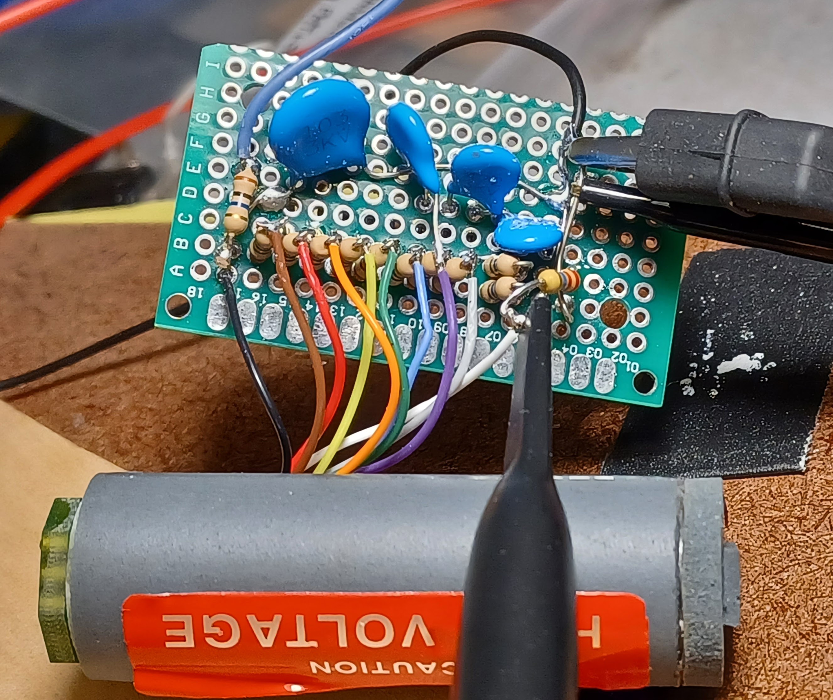

my start with this PMT project
Just wanted to thank you for posting this, and your YT video that motivated me to get started on this project myself. As the surplus Hamamatsu R7400U PMT + scintillator assy is currently going for $30 on eBay, maybe example projects like this have made it more valuable!
I was in a hurry to get something working, so I just bought a 1 kV capable supply instead of building it from parts. You can get "DC-DC Input 3V-5V Boost Converter Step-up High Voltage output 1000V Power Module" all assembled and ready to go from China for about $6, or the same thing from a guy in US for about $16 (except out of stock at the moment). If you give it 5Vdc input at 20 mA or so (depending on load) the output is approximately 1000 V DC (with some ripple at 14 kHz.) The output is isolated by the transformer so you can use it as a negative supply, as needed with this PMT. I will add a few stages of RC filtering to reduce ripple. This module output is not regulated; with lower input voltage you get lower output voltage. So I adjusted the output to 800 V by using about 4.6 V input, but again it's load-dependent. I might make a feedback setup to stabilize the voltage. The datasheet shows the PMT gain is proportional to the applied voltage, so stable HV is needed for good energy resolution. If there is voltage drift over time, that would smear out any peaks especially on longer accumulation times.
I'd never played with PMT devices before, so I was surprised by the output level. With a 10x scope probe on the anode, I saw lots of individual pulse amplitudes around 1 or 2 volts with some higher; one pulse reached 40 volts! Of course the peak voltage would be lower with some lower load resistance than the 10 Mohm to ground that my scope probe presented to the anode terminal.
At least on my R7400U module, the ten wires coming from the PCB were helpfully color-coded the same way as the standard resistor color code, if you take photocathode as 0 (black) and anode as 9 (white). The wire colors brown, red, orange, yellow, green, blue, violet, grey connect to PMT dynodes 1..8 in that order.
20240104_PMT-wiring.jpg - 771kB
