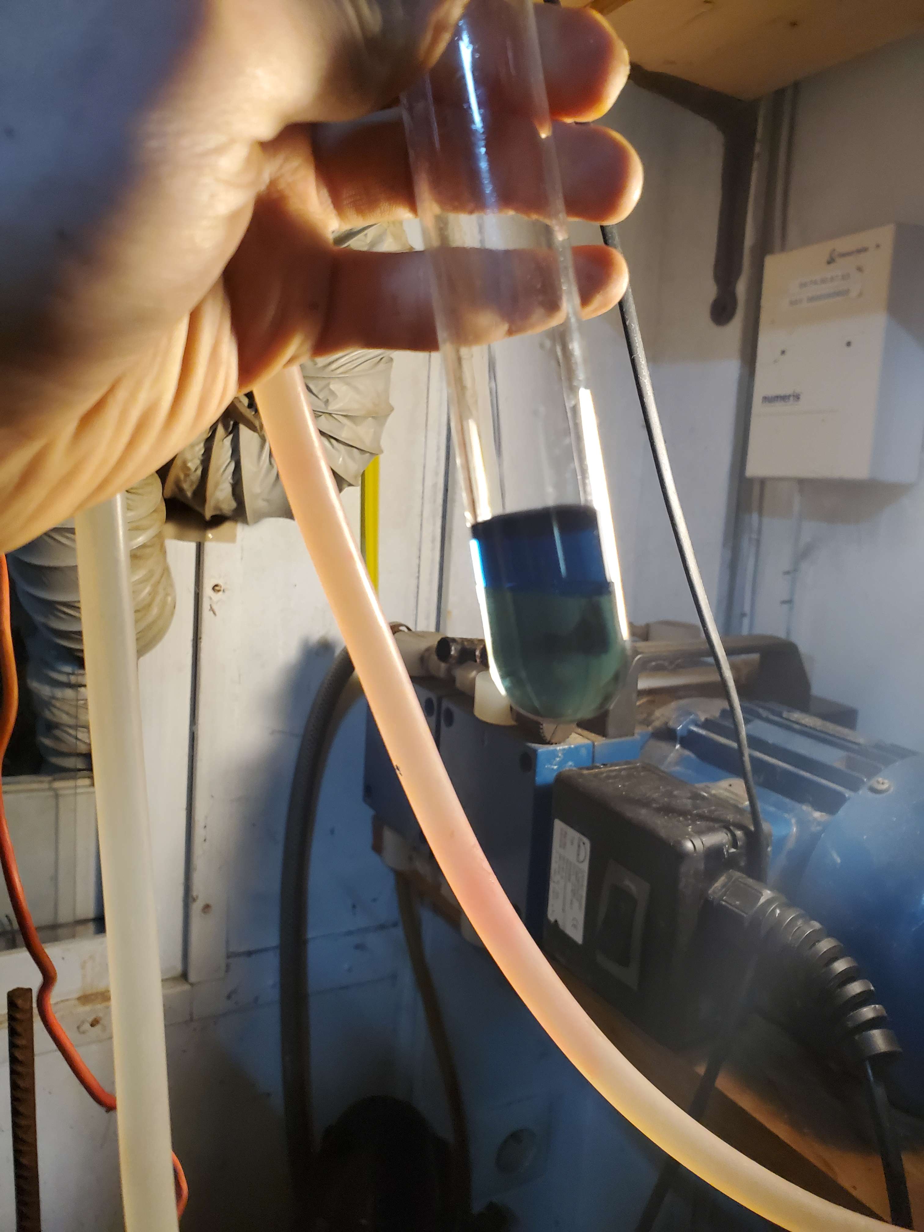

First i measured 1,2g of chamomile oil and added it in a test tube, i then added 5ml of methanol, and over it 10ml of heptane.
The mix is shaked in order to extract the chamazulene into the heptane layer.
After a few minutes the heptane layer become dark blue while the methanol one stay dark green
The top layer is removed and this operation is repeated until no more blue color is observed.

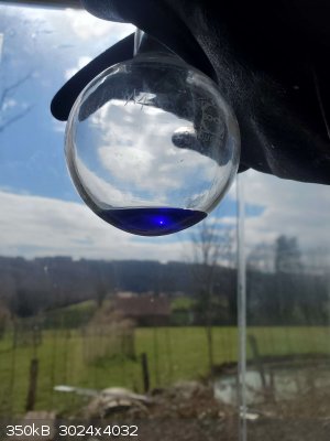

This fraction is then evaporated with my rotavap , transfering it to a smaller vial onces it's possible
In the end i obtained 110mg of a very dark blue oil wich correspond to a little less of 10% yeild, i believe i still have impurities into it as it smell slightly like chamomile
