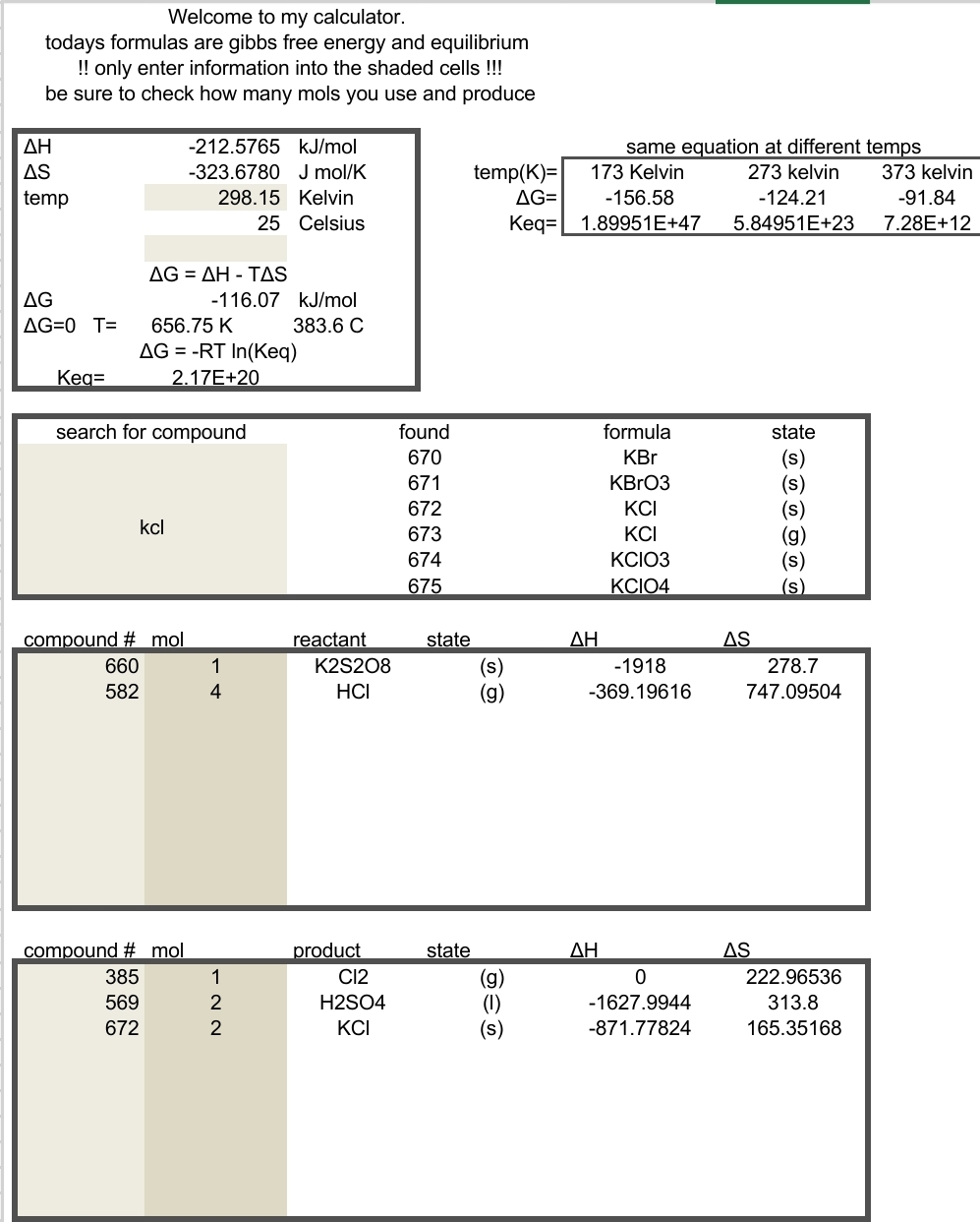

Just did some guess work, have not found anything to back this up
But K2S2O8 could react with hcl solution.
Thermodynamics backs this reaction
$$K_2S_2O_8 + 4HCl \rightarrow Cl_2 + 2H_2SO_4 + 2KCl$$
$$KCl + H_2SO_4 \rightarrow HCl + KHSO_4$$
