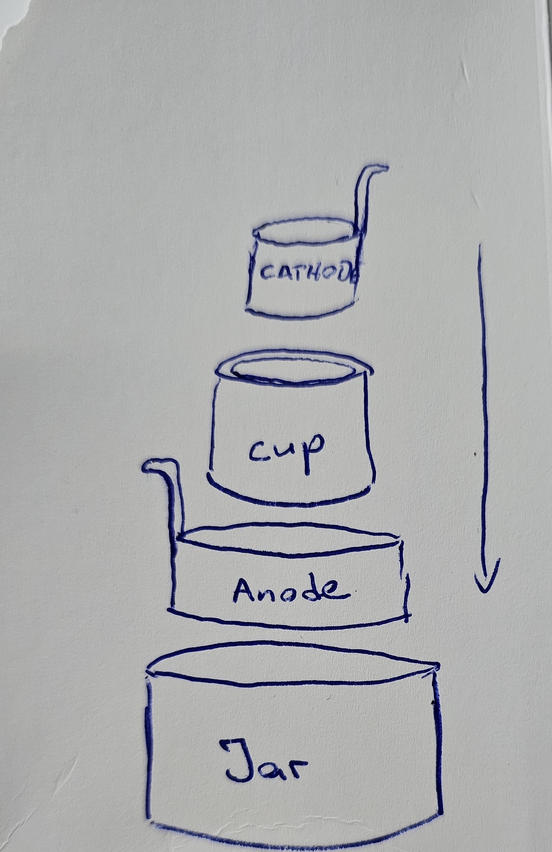

Hello friends,
i am building a divided electrolysis cell, with a ceramic pot as divider, placed in a glass jar.
check the attached sketch.
Jar is anolyte compartment.
Inside the jar a cylindrical sheet metal anode
Inside of this the ceramic pot
Inside of the ceramic pot a cylindrical sheet metal cathode
The pot holds ca. 100ml catolyte solution.
i checked the dimensions of the sheet metal needed to form a cylinder thats fits in the pot.
The dimension for the cathode is: 17cm length and the height is 4,7cm
For the anode: 24,5 lenth and 4,7cm height
I want to run this at 0,1 A/cm² cathode surface.
that would be 17 x 4,7 = 79,9 cm²
79,9 cm² x 0,1 A = 7,99 A
but if i count the inside as well it would be 159,8 cm²
159,8cm² x 0,1 A = 15,98 A
16 Amps in such a tiny cell would boil that thing in no time.
Sure i can make the electrode surface smaller.
But my main question is, when it comes to calculation:
should i count both sides of the cathode surface, (inside and outside of the cylinder) or just the outside (the side facing to the anode)
What is right?

Posts: 3937
[*] posted on 28-11-2023 at 07:09
Use just the surface area of one side for calculations,
Negligible current will flow via the other side.
Be sure to allow plenty of time for the electrolyte(s) to soak through the pot.
How long?.... Depends upon the pot.

[*] posted on 28-11-2023 at 07:33
That makes sense. But when i shrink the height of the cathode, for less surface are to run on lower Amps, the electrons can flow over the top of the cathode i guess.
In this case i should count both sides?
Yes, you are absolutley correct. I did a few tests in the past. soaking the pot overnight in sulfuric acid reduces the resistance extremly.
Or just run the cell 3 times or so. On the first run, resistance is high and gets lower with every run.
Posts: 3937
[*] posted on 28-11-2023 at 07:41
Within the volume enclosed by the cathode there will be negligible electric field to move ions.
If you use a shorter cathode, use less electrolyte ;)
P. S. If you keep the very top of your electrodes above the electrolyte,
the tabs will last much longer.
[Edited on 28-11-2023 by Sulaiman]

[*] posted on 28-11-2023 at 08:00
Ok, so in this case perforationg the cathode, or cutting slots in it won't work either? :)
I summarize: Just counting the surface directed to the anode in this kind of setup right?
I used lead electrodes before. never had any issues with corrosion. Maybe i will make 2 or 3 tabs on the electrodes and attach to a lid.
When my cell is ready i can show the results here. And than i will try the reduction of Nitrobenzene to Aniline first. But It can be used for all sorts of electrochemical synthesis.
Next step is to build in a reference electrode for running the reduction on a fix overpotential. This is something i have no idea at all. Hope you guys can help me then.
Posts: 3937
[*] posted on 28-11-2023 at 12:50
Just guessing now as not tried....
I imagine that some ions would be attracted from the inside,
very near to any slots or holes.
The larger the hole size the farther the electric field gradient will spread on the inside.
An extreme case would be a very 'open' wire mesh where the active area would be near to the total exposed area of wire...I guess.
