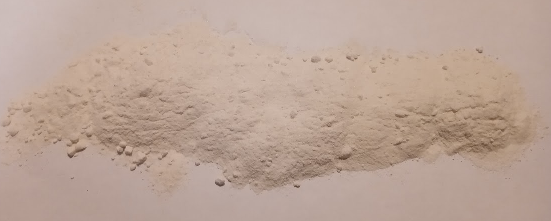

my results
Experiment 1
In a 500 ml screw-top glass jar were placed 25 g PET[1],[2], 25 g KOH (anhydrous flakes) and 30 ml distilled water, and the mixture was heated on a boiling water bath for several hours. After standing overnight, 10 g NaOH and 10 ml water was added and the mixture again heated on a boiling water bath for 5 hours by which most of the PET was consumed and a white precipitate was noted. 250 ml near-boiling water was added and the mixture filtrated twice through 2 coffee-filters.
The clear filtrate smelled of glycol. It was then slowly acidified with azeotropic aqueous HCl. First a white precipitate was noted, which redissolved upon stirring, the pH was checked with indicator paper and the mixture was still alkaline. Upon further addition of aq. HCl a thick white solid precipitated, pH was slightly acidic (~3-4 vs indicator paper). The mixture was briefly heated to boiling in the microwave oven[3] and filtrated through 3 coffee-filters. The solids were washed twice with 100 ml near-boiling distilled water, allowed to cool and stand overnight, absorbed water was removed by gentle squeezing the filter, and the solids were dried in an oven under an air flow at gentle heat (70°C).
Yield : 22.27 g crude terephthalic acid as off-white solid
It was noted that the hydrolysis proceeded more swiftly at the moment NaOH was added, confirming that a mixture of KOH and NaOH increased the rate of hydrolysis compared to KOH or NaOH alone.
terephthalic_acid_crude_wet.png - 536kBterephthalic_acid_crude.png - 1.1MB

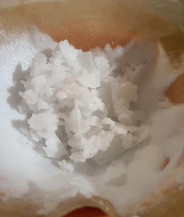

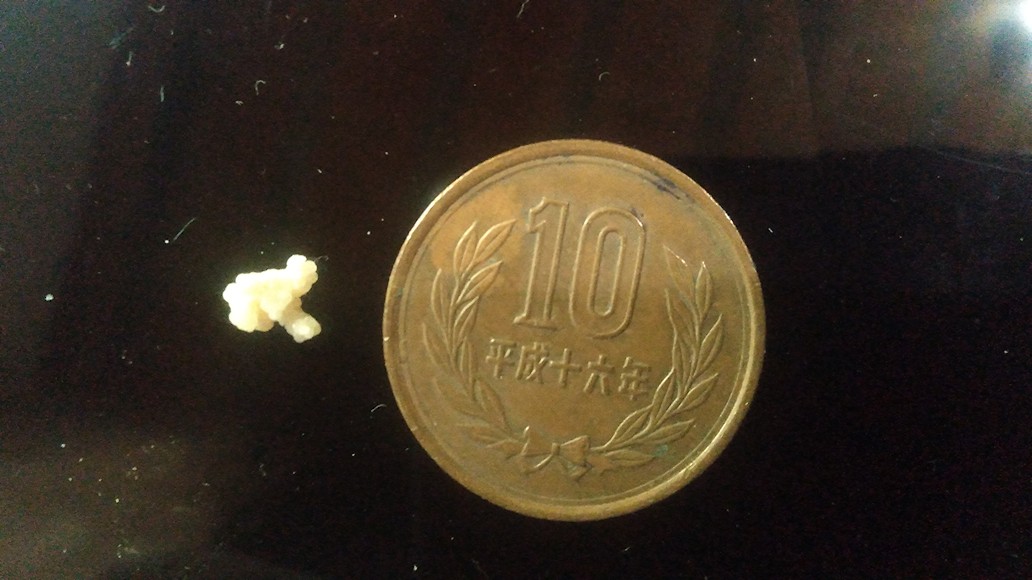

Experiment 2
In a 500 ml screw-top glass jar were placed 23.40 g PET[1], 8.60 g KOH, 8.20 g NaOH and 17 ml demineralised water. The contents were heated on a boiling water bath for 1 hour, after which another 8.00 g NaOH and 17 ml water were added, and heating continued for several hours until nearly all PET went into solution. Subsequently, 250 ml boiling water was added, mixed well, and filtrated through 2 coffee-filters. The dried undissolved fraction weighed 2.23 g.
After gentle acidification portionwise with azeotropic aqueous HCl, white solids precipitated, which were filtrated off and washed 2x with 100 ml boiling water, and dried in the oven in a stream of air at gentle heat (70°C).
Yield : 12.70 g crude terephthalic acid as off-white solid
Recrystallisation according to US patent 3465035
In a 1 liter beaker, 41.02 g (0.5 mol) anhydrous sodium acetate was dissolved in 100 ml demineralised water with gentle heating and stirring. Next, 9.53 g 80% acetic acid was added, followed by demineralised water up to the 500 ml mark. This solution was brought to a boil and, with good magnetic stirring, 15.49 g crude terephthalic acid was added in small portions. The resulting solution was allowed to cool slowly with gentle stirring on the hotplate to room temperature. On cooling needle-shaped crystals precipitated. These were filtrated, the filtrate saved[4], the solids washed 2x with 100 ml boiling water and left to air-dry.
yield : 7.05 g terephthalic acid as free flowing crystals
The patent did at one point mention a preference for pre-saturating the buffered recrystallisation solvent with terephthalic acid. A second experiment, using the filtrate of the first recrystallisation, yielded a better result: 10.45 g free flowing terephthalic acid from 15.50 g crude.
Acidification of the filtrate after this yielded another 3.42 g terephthalic acid, but of lower quality.
terephthalic_acid_recrystallised.png - 414kB

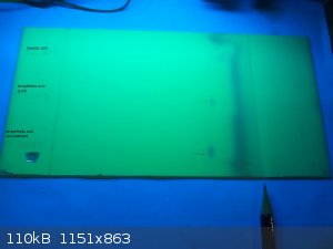

[*] posted on 27-3-2024 at 10:56
Quote: Originally posted by palico
Dear dicyanin, thanks for your experiment, but how have you checked the identity and purity of your products ?
Both the crude and recrystallised terephthalic acid, despite difference in appearance, showed a clean single spot on TLC.
Attached are 2 chromatograms, crude and recrystallised TPA compared to oxalic acid and benzoic acid. The latter two showed streaking as the concentration of the sample must have been too high, but still their Rf values are widely different compared to TPA. Apparently terephthalic acid's "slightly soluble in ethanol" is just the right concentration for a perfect TLC spot.
PET_hydrolysis_TLC_oxalic.png - 395kB PET_hydrolysis_TLC_benzoic.png - 484kB

[*] posted on 28-3-2024 at 00:45
Thanks for your kind words palico. You are quite right about the quality of the pictures, my only excuse is that it wasn't easy fiddling about in total darkness with the only light source coming from 2x 5W UV-C tubes, trying to take pictures with a potato tier phone whilst wearing dark-tinted eye protection :D.
However, practice makes perfect, this morning I tried again and took these pics. To my shame I must admit yesterday I mistook a wire shadow for a benzoic acid streak yesterday, the actual spot is near the solvent front (shown by the pencil tip).
oxalic_TLC.jpg - 156kB benzoic_TLC.jpg - 110kB
I also calculated the following Rf values :
terephtalic acid : 0.75
benzoic acid : 0.83
oxalic acid : 0.10
Attached paper (Kolesinska et al. 1966) using the same solvent system (EtOH 96%/NH3 25%/H2O 5:2:2) found following Rf values :
benzoic acid : 0.80
oxalic acid : 0.36
Only the oxalic acid was off compared to my results. However, using different proportions (EtOH 96%/NH3 25%/H2O 5.3:4:0.7) they found :
benzoic acid : 0.75
oxalic acid : 0.05
so it seems that altering the ammonia:water ratio affects the oxalic acid Rf but not so much the benzoic acid Rf. As my source of ammonia is of a technical grade rather than an analytical one, I suspect that may be the reason for the deviation.

Alkaline hydrolysis of clear PET from a water bottle
And the latest developments of my ongoing experiment with alkaline hydrolysis (using the recipe presented in [1]) are quite interesting too. The reaction has sped up about 3 days ago. The pieces of PET that were slowly dissolving some weeks ago are for the most part gone, and the remaining few look like thin shredded plastic film. There's a deposit of disodium terephthalate at the bottom of the polypropilene vial.
I took some pictures and, despite the quality being too low, I'll share them as promised about a month ago. They were taken today. The coin is a 10 yen coin (23.5 mm in diameter). The engravings in its reverse help to focus the bloody camera Samsung has been using in some of their smartphones.
The first and second pictures, taken about one month apart, show the deposit of salt (presumably disodium terephthalate) at the bottom of the saturated solution. Notice the existence of two layers with different colors. The upper layer's yellowish tint is due to a speck of crap that fell into the vial when I was filling it and dissolved right away before I could curse or remove it. The lower layer, as white as boric acid, appeared after the rate of hydrolysis increased. The solution smells funny, quite like glycerol.
20240306_101241.jpg - 45kB 20240409_205351.jpg - 65kB
The third picture shows a crystaline mass that had formed in a corner of one of the PET pieces. I reported its formation about a month ago. It has grown to the size shown since then.
20240409_093526.jpg - 124kB
The fourth picture shows the crystaline mass after maceration in ethanol azeotrope. The alcohol was heated almost to boiling and tiny crystals, not discernible in the picture thanks (again) to the guys at Samsung, have precipitated on cooling. The inset on the upper right corner can give a rough idea.
20240409_205635.jpg - 67kB

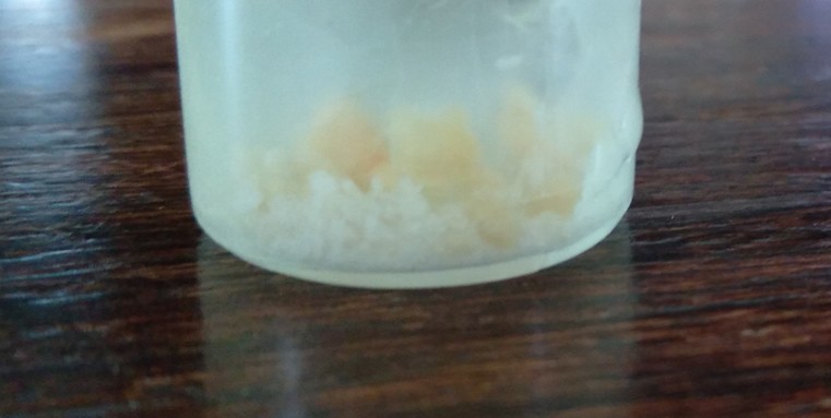

The fifth picture shows a badly attacked piece of PET floating in water. The surface is finely grooved and some regions were torn apart or shredded by the solution. I removed it as a sample after seeing it was the first one to "give up", about one month ago. The fourth picture shows the same piece of polymer in a darker background.
20240409_211442.jpg - 84kB 20240409_211703.jpg - 100kB
Laziness and a splitting headache prevent me (for now) from going further and precipitating terephthalic acid from an aqueous solution of the salt. A previous test with a small sample (10 mg or so of salt) showed the formation of a milky emulsion, with particles so small that the time they took too to settle down was beyond my boredom limits. I'll try to rig a centrifuge tomorrow or the next day and do it.
