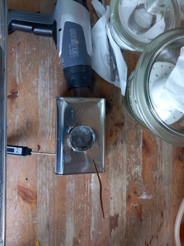

This is molten NH4F inside my DIY home fume hood.
And I am still alive. So, the answer: it depends ...
When I did planning to start playing with F I've selected boron trifluoride and BF4 anion as an entry level but still very interesting F compound.
qqq.jpg - 200kB
