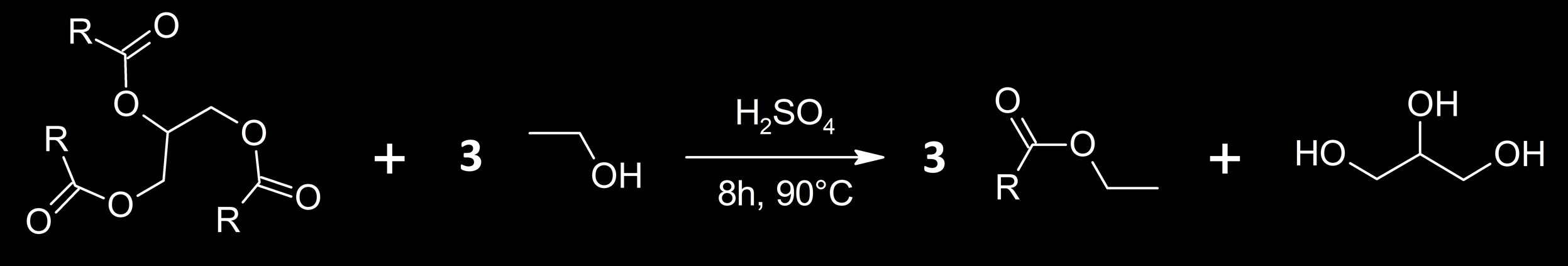

The reaction involved is the transesterification of oil with ethanol using sulfuric acid as catalyst.
reaction_cutted.jpg - 79kB
This experiment present different point of novelty compared to common biodiesel production method. First, it use waste cooking oil as substrate, and so has the advantage to convert a waste into a resource. Second, ethanol is used rather than methanol, which the purchase in some countries can be restricted for individual or hardly to find. Ethanol instead, is free to buy everywhere, readily available, cheap, and also can be renewable, because obtained from wine and spirit industry. Third, I am using an acid recipe, not basic, which is not sensitive to residual water, moisture, free fatty acids.

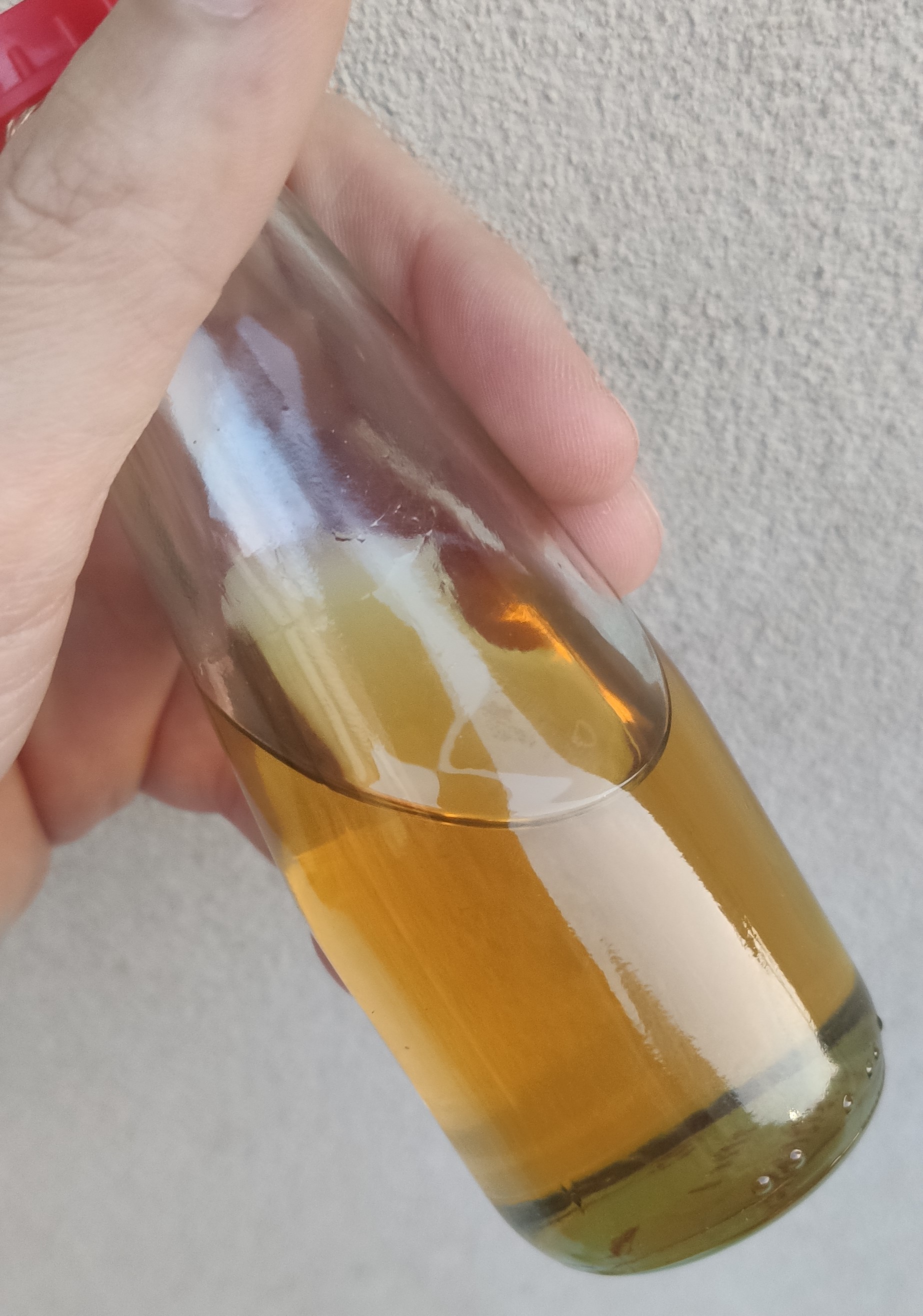

The product is opalescent, is filtered through cotton plug, then heated under stirring at 80 Celsius to remove all volatiles: product become limpid and clear.
An yield 68 g, 76 ml of yellow oily liquid is obtained.

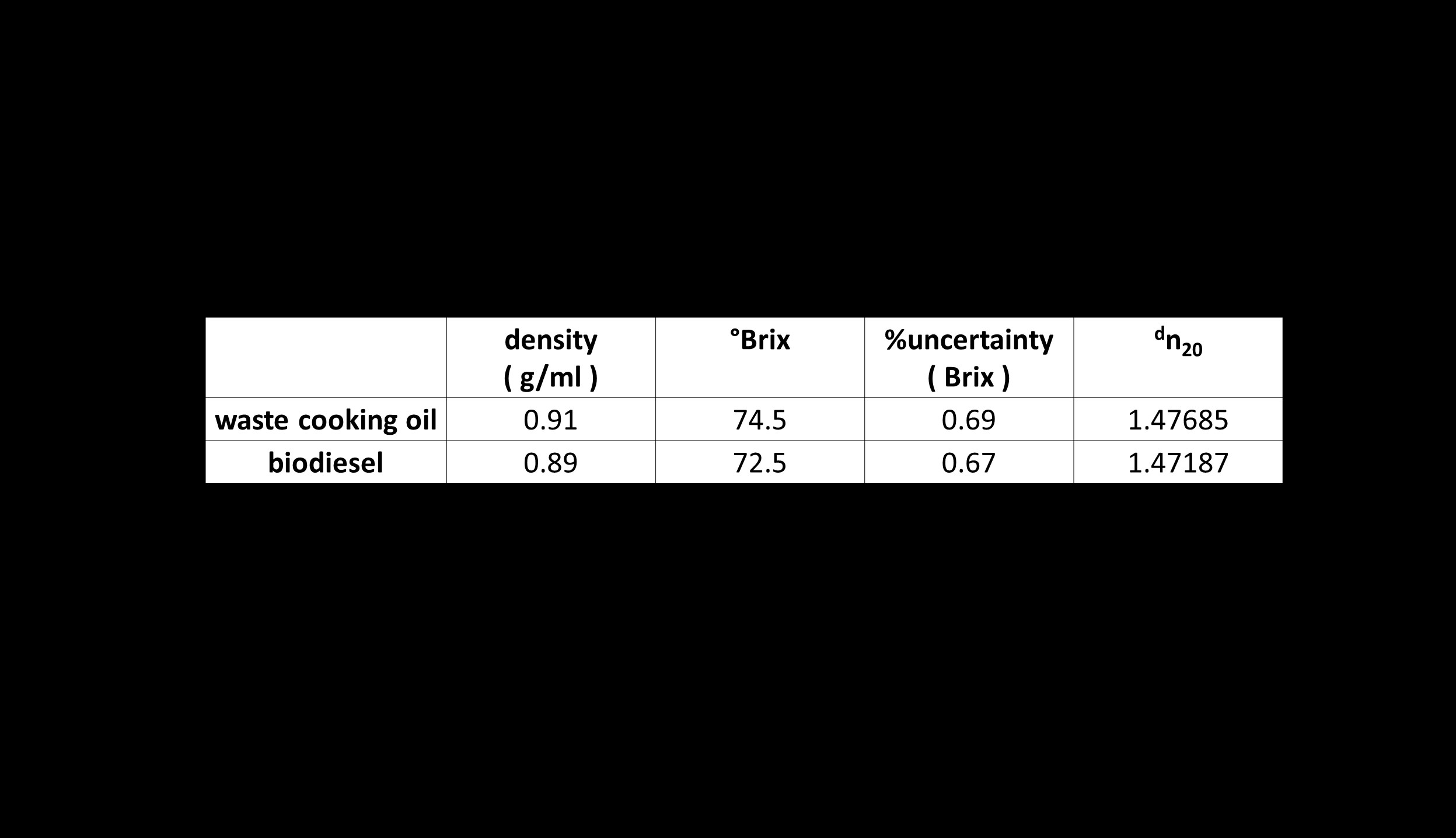

Product is characterized by density, refractometry, flame test and compared to initial waste oil. Results are the following.
table.jpg - 122kB
It is shown, product has lower density and refractive index, and this is as expected for a shorter chain molecule. The flame test is done as follow. A paper towel is impregnated with the sample, placed in a steel can and ignited. The oil is diffcult to catch on fire. Its combustion is awful. It generates acrid, toxic terribles fumes. The biodiesel instead, catch easily on fire, the combustion is smooth and stable and does not generates terrible fumes.
The behaviour of both on freezing is identical.
