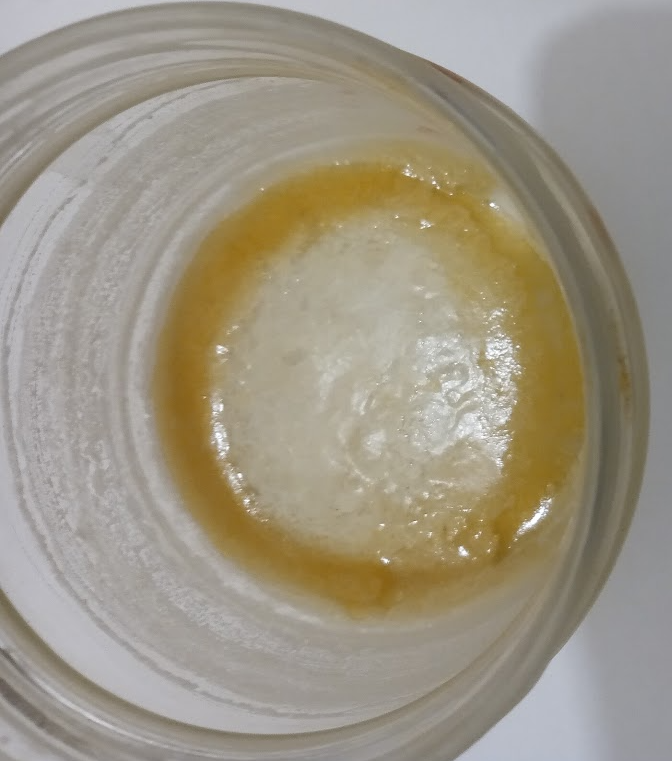

emulsion_post-basifying.png - 509kB Et2O_extract_oil.png - 701kB Et2O_extract_solid.png - 828kB
The solid was added to 750 ml boiling distilled water, followed by 1 g kieselguhr and a knife-tip of active carbon. After stirring for a few minutes, the mixture was filtrated hot[4] through 2 coffee-filters, and the slightly cream-colored filtrate was reduced to about ~100 ml volume.
During cooling this turned into a white emulsion, which on standing overnight solidified into a sparkling crystalline precipitate. This was filtrated, the crystals were air-dried for 24 hours and in a dessicator over CaCl2 overnight.
Yield : 1.95 g
tryptophol_creamy_emulsion.png - 491kB tryptophol_precipitation.png - 878kB tryptophol_wet_crystals_filter.png - 673kB
The filtrate was heated and saturated with kitchen salt, which caused it to turn turbid. The cream coloured emulsion was allowed to cool, extracted with 45 ml diethyl ether, the organic phase dried over anhydrous MgSO4, and the ether evaporated. As such an additional 0.45 g was recovered.
Total yield : 2.40 g (57%)

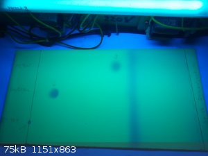

TLC (silica gel plates, detection UV 254 nm)
IMG_20240328_171330.jpg - 75kB
Solvent system used was toluene-acetone 85:15
Tryptophol (crystallised from water) was compared to indole and L-tryptophan standards, as from the indolic odor resulting after basifying the fermentation broth concentrate, it was suspected some indole or skatole was formed as side-product. Nothing was detected in the sample however, and the tryptophol gave a single spot.
Rf values found:
indole 0.54
tryptophol 0.13
L-tryptophan 0.00
These values were compared to the literature. Reference values found in:
"Thin-Layer Chromatography: A Laboratory Handbook", 2nd edition, E. Stahl, Springer-Verlag p 473-475 (table 88)
solvent system benzene-acetone 90:10
Rf values reported:
tryptophan 0.00
tryptophol 0.11
indole 0.53
skatole 0.56
These values are pretty much spot on, the toluene-acetone 85:15 solvent system has similar relative polarity as the benzene-acetone 90:10 from the reference guide.

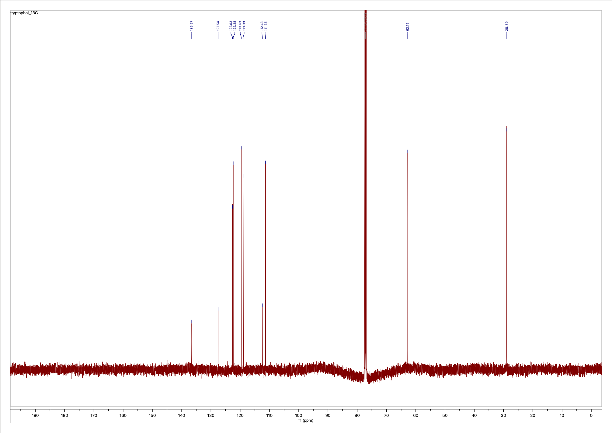

[*] posted on 23-4-2024 at 09:36
Tryptophol NMR Data
dicyanin sent me a sample of tryptophol for NMR analysis, and I now have the results. It looks beautiful!
tryptophol_1H.png - 184kB tryptophol_1H_aromatic.png - 244kB tryptophol_13C.png - 212kB
From left to right: 1H spectrum, expansion of the aromatic region in the 1H spectrum, 13C spectrum.
The spectra are consistent with the literature, and there is no significant sign of any impurities. I did notice there were some insoluble fibers present when I dissolved the sample in chloroform (likely filter paper bits) but other than that it looks great.
