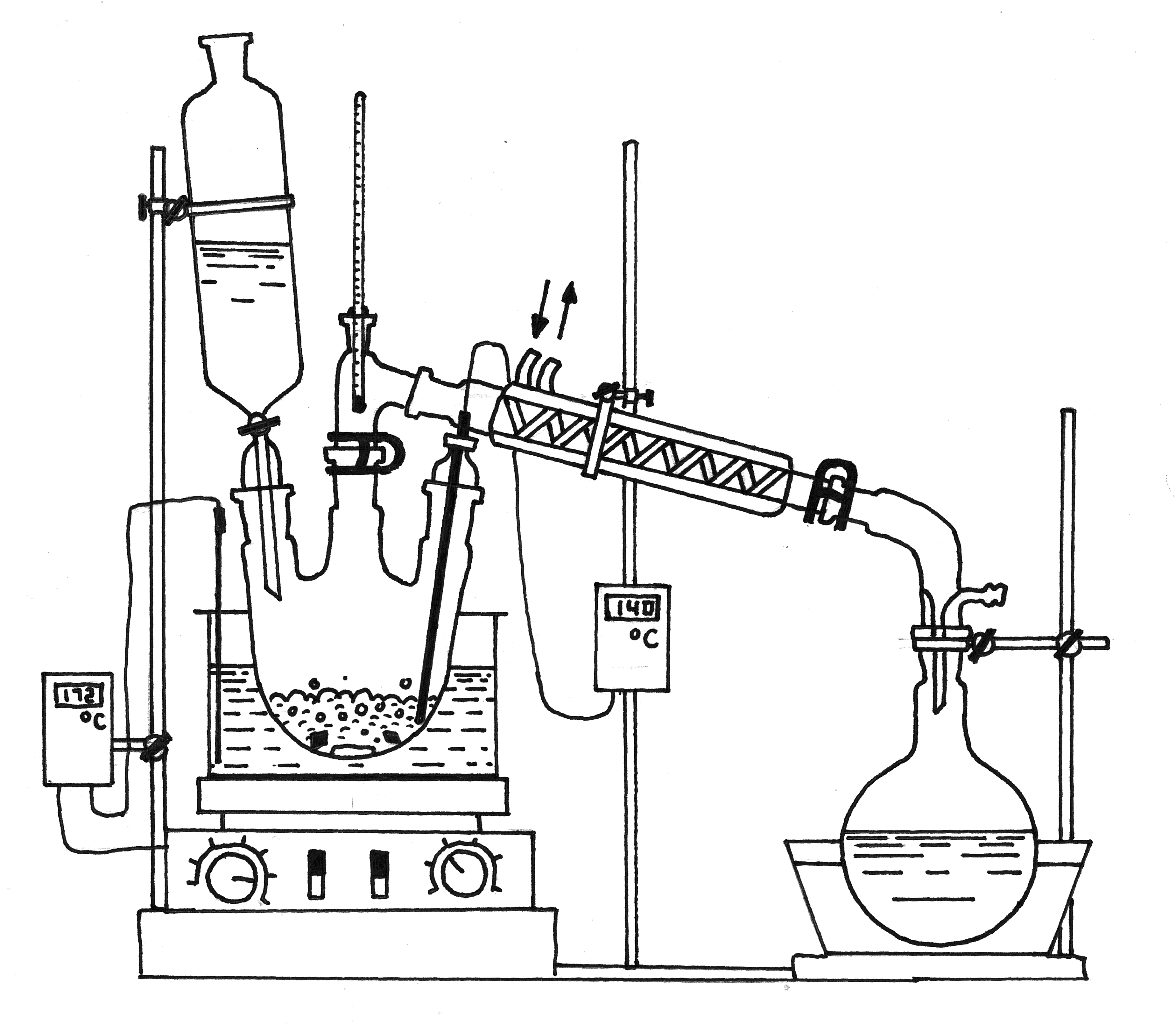

Synthesis:
Two trials were conducted. A 500 mL three-necked flask containing 40 mL 95% denaturated EtOH + 40 mL 95-98% H2SO4 (Note 1), a stir bar and two ceramic boiling stones (from a broken Büchner funnel) was used for the first trial and it was reused as is for the second trial. It was fitted with a 500 mL addition funnel (Note 2), an internal thermometer, and a simple distillation setup with vapor thermometer and a jacketed coil condenser with 2-7 °C cooling water, as well as a 1 L receiving flask in an ice bath. The synthesis was run in 8-12 h periods with about equally long interruptions for the nights. The oilbath temperature was maintained by a thermometer inside the oil that gave feedback to the hotplate. The temperature in the cooling water was maintained initially with ice, later with a recirculating water chiller.

Fig. 1: Sketch of the apparatus.
First trial: The oilbath was maintained at 150-154 °C. When the internal temperature reached 140 °C, the addition of ethanol was started, at first very slowly. In total 734 g 95% denaturated EtOH was added during 26 hours, at a rate that kept the internal temperature at around 140-145 °C (Note 3). Still head temperature rose from 67-84 °C during the reaction (Note 4). The distillate weighed 734 g, was fractionally redistilled (Note 5) and the fraction boiling at 34-40 °C was collected.

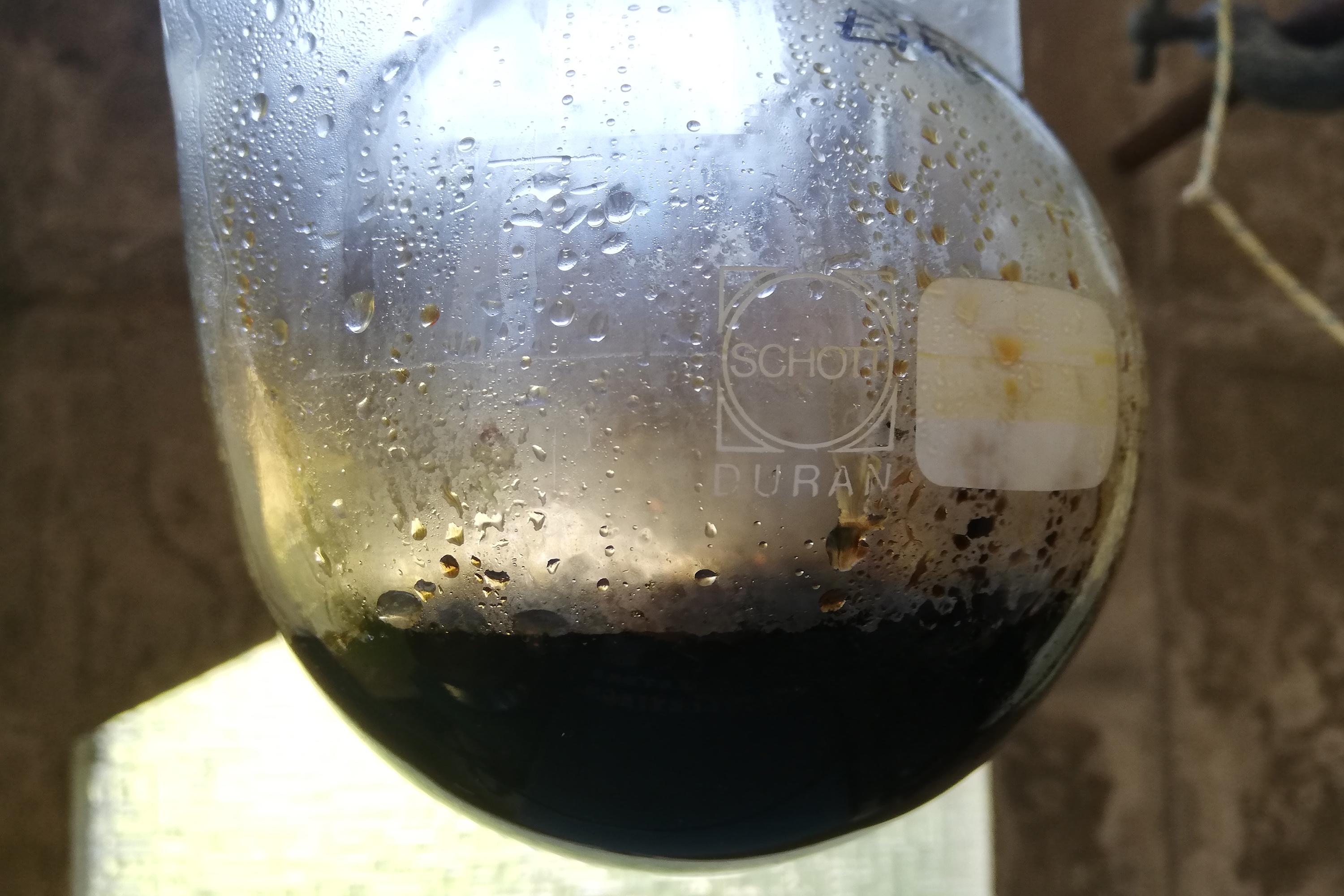

The flasks contents were black and contained a substantial amount of tar, but it didn't seem to affect anything, so it was used as is for the second preparation.

The combined distillation residue of both reactions weighed 1301 g and was then further fractionally distilled (setup as before) to recover the unconsumed ethanol. There was obtained 1015 g of ethanol boiling in the range 78-82 °C and a residue of 282 g, which was dirty water containing some insoluble oil, it had a nauseating smell and was highly acidic. Several spoons of KOH were required to neutralize it. This residue was discarded.
Overall: 40 mL (ca. 72 g) 95-98% H2SO4 and 2234 g 95% denaturated EtOH were employed, of which 1219 g were consumed, yielding 834 g (ca. 1.1 L) of ether, or a 90% yield based on consumed ethanol (that is assuming the recovered ethanol was also 95%).

1. The denaturant in the alcohol is likely 1% methyl ethyl ketone, 1% isopropanol and denatonium benzoate. The sulfuric acid was food grade.
2. Evans recommend an addition funnel with a long stem that reaches above the liquid surface, but does not deliver the ethanol onto the internal thermometer. In the experiment, an addition funnel was used that delivered the falling drops of ethanol just on the edge of the liquid in the flask opposite the thermometer.
3. It is often said to match the addition rate to the distillation rate, but in my experience, if the ethanol is added such that the internal temperature stays around 140-145 °C, the distillation rate more or less automatically adjusts to match the addition rate.
4. The temperature in the still head can be pretty much ignored, as it doesn't seem to correlate to the ether content at all.
5. The fractional distillation used a 60 cm vacuum insulated vigreux column, a relux divider still head, a jacketed coil condenser with 2-7 °C cooling water and a receiving flask in an ice bath. The distillation was done slowly over the course of 2-4 hours.
6. The amount of ether present was estimated as follows: About 3 g of CaCl2 and about 10 g of water were mixed (exothermic) and chilled in a fridge to 5-10 °C. A sample of the distillate was placed in a 10 mL measuring cylinder, some of the calcium chloride solution was added and the whole mixture carefully mixed. In this case 1.8 mL of distillate and 2 mL of the calcium chloride solution gave after shaking 0.8 mL of upper organic layer, indicating an ether content around 40-45 vol%.
Discussion:
The combination of stirring and ceramic boiling stones prevented bumping effectively, it was never an issue during the entire experiment.
It can also be seen that the dilution of water is not limiting the reaction, as it distills off alongside the ether and alcohol in more or less a stable equilibrium, if it is allowed to do so.
The effiency does not seem to substiantially drop over the course of the synthesis, going slower than in the second trial brings no real benefit, and the amount of ether produced was about 29x the volume of sulfuric acid. (It seems very likely that it can still keep making even more ether - the limit is not yet reached. It would be indicated by the flask running empty and being practially impossible to maintain at 140 °C, according to Evans and Sutton. Testing the distillate as discussed in Note 5 should also indicate completion.)
There is another thing worth mentioning. Where does the sulfuric acid actually go? According to the 1913 paper,[3] only 15-20% could be accounted as SO2, formed due to oxidation by the sulfuric acid. However, in their 1917 followup,[4] their new analysis shows the following: In the distillate and gaseous exhaust, about 2% of the sulfur in the acid leaves as sulfur dioxide and about 89% remains in the sulfate oxidation state, of which 47% was present as sulfuric acid, 8% as ethyl sulfuric acid, 34% as diethyl sulfate and about 5% as unspecified sulfonic acids and sulphonates. The remaining sulfur is found in the charred distillation residue in the flask.
Whether or not the sulfuric acid and diethyl sulfate actually slowly distill or are merely aerosolized and carried over as droplets from the bursting bubbles during the boiling in the distillation flask is unclear.
But given the toxic nature of diethyl sulfate, it is save to say that the crude distillate should be treated as dangerous not just for flammability reasons. These impurities will likely also be present in the "usual", less sulfuric acid efficient preparations!

Nice experiment and writeup, and a cute diagram (how?)

Sulaiman, thank you. The drawing was done on paper first with pencil, then with black ink, and finally scanned.
