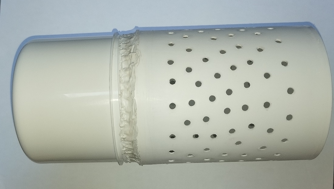

The basic manufacturing technique is as follows: Using an electric soldering iron, many holes are made in a circle in a plastic container, then the container is sanded with sandpaper to remove irregularities. Next, you wind the polypropylene fabric in several layers. After that, you make ropes from the same fabric and wrap this fabric on top with considerable force and fix it with a knot. This is very important. Without a strong fit, your diaphragm will leak.
And so you got a raw diaphragm. In this state, it is not a diaphragm but rather a filter. There are several ways to make this a diaphragm.

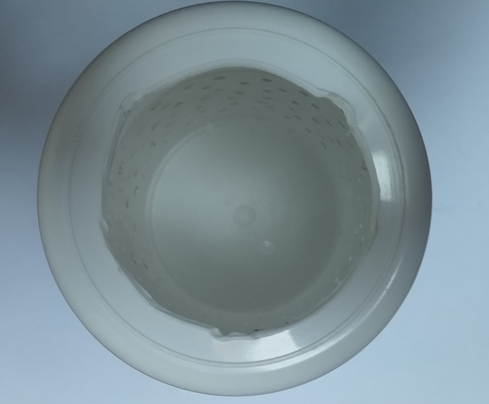

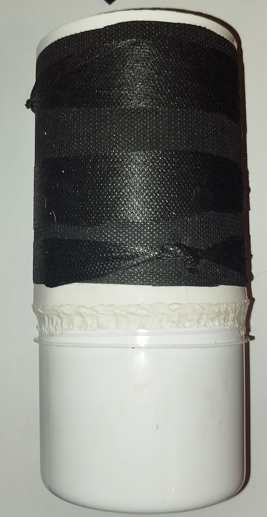

Ion exchange resins are not discussed in this article. I have not found a way to make them from readily available materials. Non-crosslinked resins will not be chemically stable and will not be suitable for organic solvents. Sulfonated polystyrene would work well in theory for inorganic syntheses such as chlor-alkali cells. The manufacturing process is the same as with polymer filler.

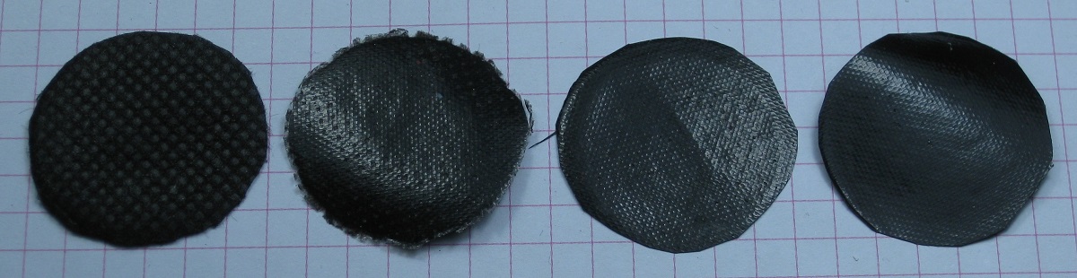

Sample of workpiece on pic
[Edited on 13-9-2024 by Hexabromobenzene]
dph.jpg - 493kBdhp2.jpg - 495kB

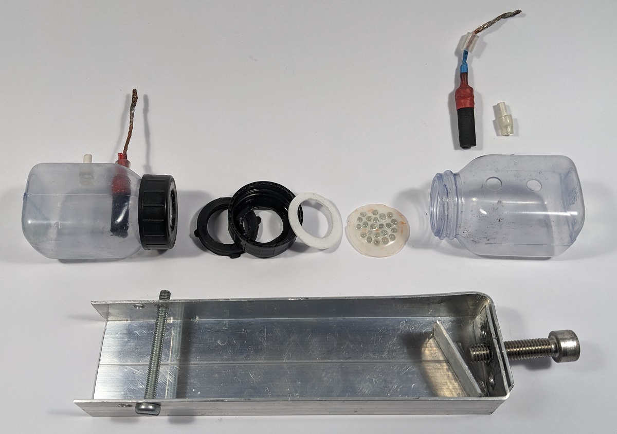

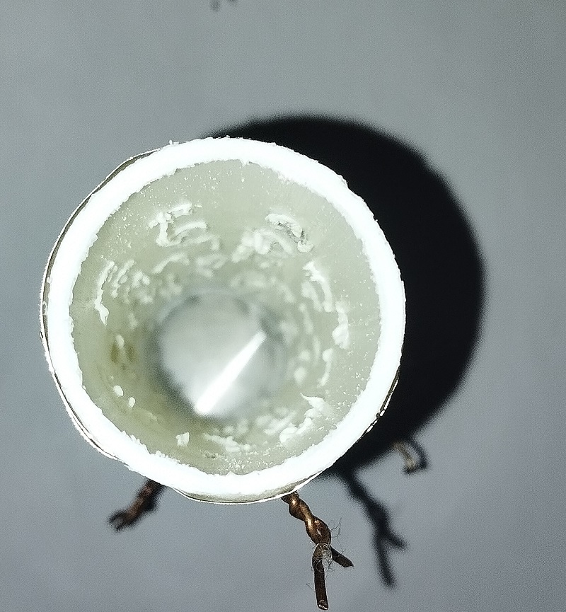

[*] posted on 27-9-2024 at 15:06
A more improved method for making porous diaphragm.
You no longer need solvents or adhesives anymore. Everything is very simple and cheap

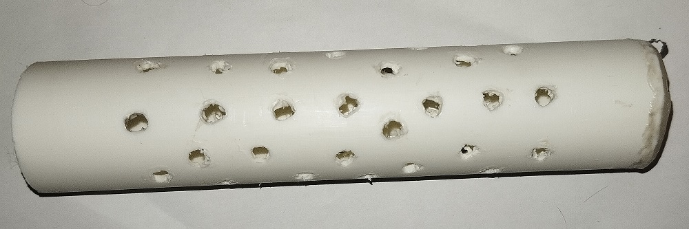

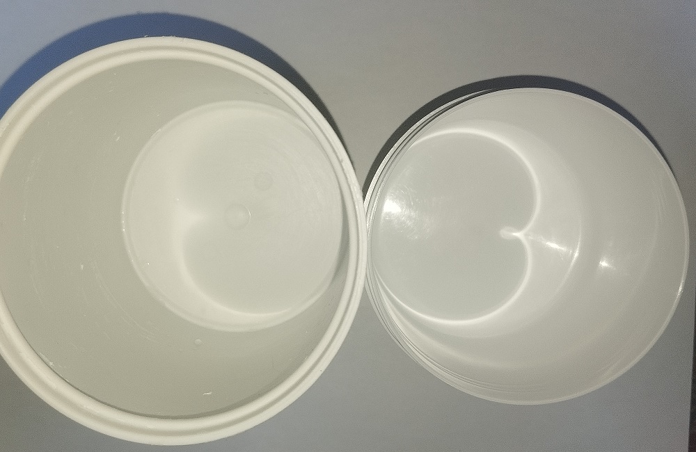

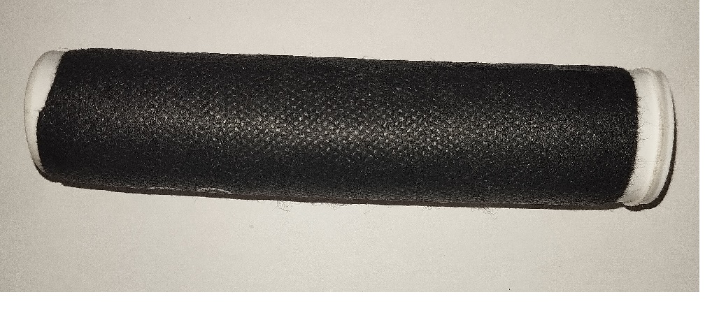

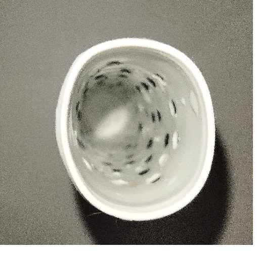

You only need a polypropylene container and a piece of fabric meltblown. You can also make a container from a polypropylene pipe from the sewer weldind bottom with an electric soldering iron
Polypropylene blank with holes is wrapped with a piece of polypropylene fabric. Thin iron sheet is wrapped on top. Blank with fabric is fixed with a metal wire and heats up in the oven at 170-180 degrees for several minutes
Due to the temperature and pressure of the iron sheet, the layer of polypropylene becomes much less porous and is more like ceramics as we need. Diaphragm is very light, chemically persistent and cheap
The porous layer of plastic gets wet, but the water does not leak significantly
1.jpg - 345kB 2.jpg - 114kB 3.jpg - 194kB

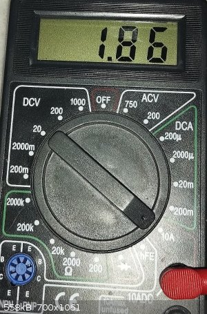

I made the second according to the same technology. The temperature was increased to 180 degrees
The leak of water through the new backed diaphragm was 1 ml in 10 minutes. First noticeably more. Probably due to incorrect compression of an iron sheet during baking.
For conducting an electrochemical test, stainless spoons were used as electrodes, a strong solution of sodium chloride and 2 batteries(3 volts) AA as a source of current. Without diaphragm, the current of 400 mA. With backed diaphragm number 2 current about 30 mA.
The current of the first diaphragm was 3 mA. Current of another diaphragm without baking, but with a separator from lithium batteries was 2 mA
The volume of the diaphragms is 90ml.
A diaphragm without baking and without a separator from a post http://www.sciencemadness.org/talk/viewthread.php?tid=160566... with a volume of 400 ml shows a current of 20 mA
Definitely a working method, but more experiments are required.
During baking, the fabric is welded to the polypropylene container and you no longer need to fix it
Polypropylene is a wonderful material. Having an electric soldering iron, oven and electric stove can be made of various reactors, rectification columns, distillators. Operating temperature of polypropylene up to 120 degrees

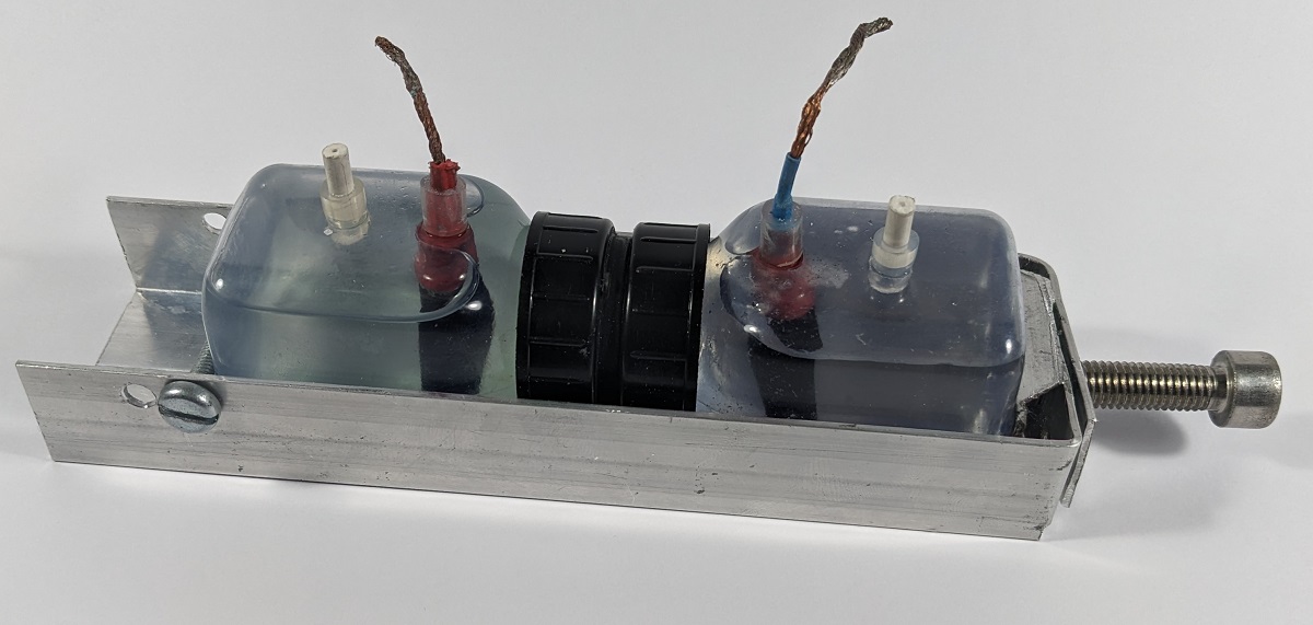

I'm curious; I found porous cups on ebay and bought one to try and fix a tin-plating problem. Background of issue, mentioned here:
How badly do membranes tend to clog in your experience?
This is the one I bought, for example:
Attachment: membrane.webp (13kB)
This file has been downloaded 271 times
It Sstarted out as white and had 2Amps of current flowing at 36Volts applied to the tin anode inside the cup with titanium dioxide, boric acid and water in the anode compartment; Citric acid, and a steel target to plate were outside the cup, making the cathode portion (the bucket).
This does work, quite well. I can electroplate copper coins with tin, and get a very shiny smooth coating that's practically a mirror.
But, over the last week of use the current carrying capacity has dropped from 2Amps down to a measly 150 milliamps.
Increasing the conductivity of the solution by adding acid has no effect.
At first there were large white blocks of ceramic visible with small grey/black lines on it; I tried grinding them off and thinning the ceramic cup wall thickness; but slowly the ceramic has turned to what's shown in the picture over a week.
I have been happy with the fact that the membrane does not leak water except very slowly. Maybe a teaspoon in a week's use. So there's no degradation of the citric acid by electrolysis. Basically, I can wipe of a sponge of it from the ceramic filter and it keeps right on plating -- organics stay OUTSIDE the cup, ions pass through the cup, and I can use high anode voltages to get ions into solution.
But, how common is it to loose 92% of your current flow in a situation like I'm describing?

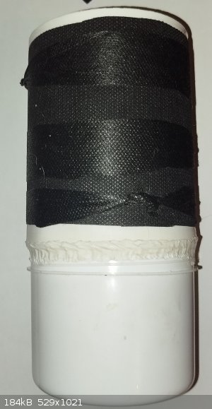

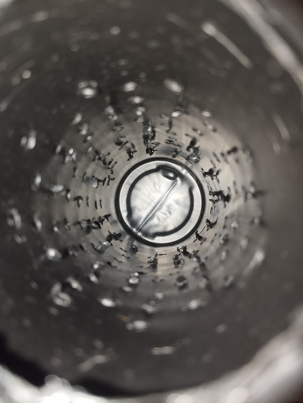

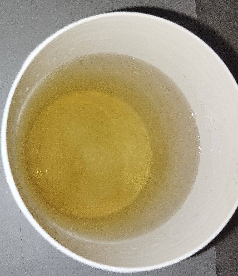

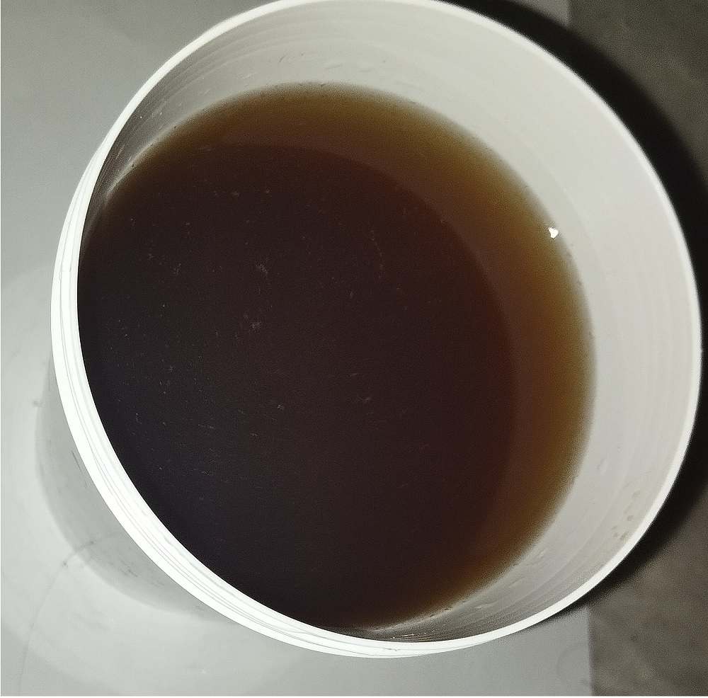

Diffusion test. A solution of melanoidin was poured into the container with the diaphragm. In the second container, pure water. In the photo, the result of diffusion after 14 hours as well as a solution after direct mixing of the contents of 2 containers
The fluid level in 1 and in the 2nd vessel was the same.
The diaphragm is made by baking method
2.jpg - 425kB3.jpg - 396kB4.jpg - 313kB

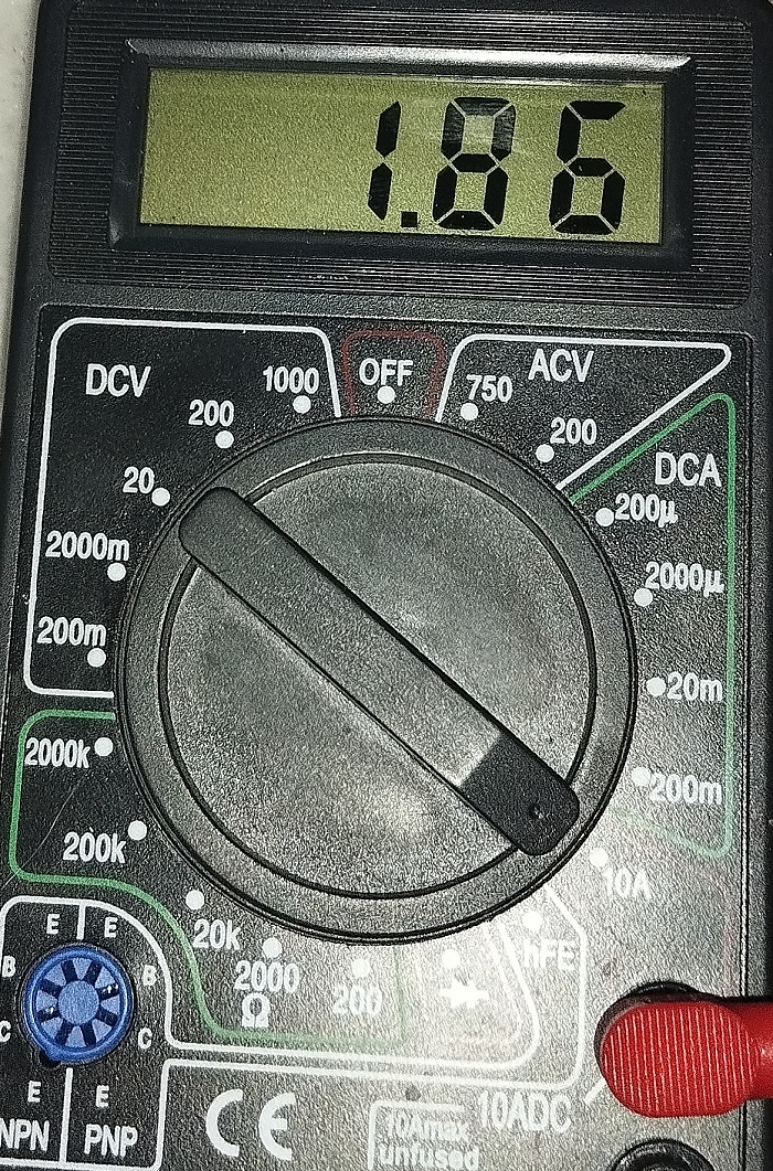

[*] posted on 27-11-2024 at 08:00
Preliminary test showed a current up to 0.7a with 12 volts in a solution of salt. Other diaphragms do not conduct electricity. Probably a plastic layer is too thick
Apparently, the diaphragm leaks at the place of contact of porous plastic with the workpiece.
The addition of ion exchange resin did not improve conductivity but increased leaks.
The size of the pores in the meltblown fabric several micrometers but probably was reduced significantly when the plastic is flattened during backing

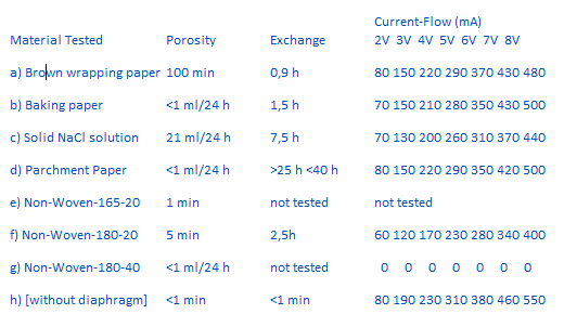

Cell for Testing diaphragm materials
Hello Hexabromobenzene,
thanks for your inspiring posts about finding the perfect DIY diaphragm.
In the past I have also searched for good materials for diaphragms and ion exchange membranes.
I made a small electrochemical cell for quick and easy testing of materials. [Photos 1 and 2]
Its made from two 50ml square wide-mouth PVC jars with 20mm diameter holes drilled in the 35mm lids.
I sealed electrodes and plugs with silicone tubing.
An aluminum U-rail serves as a holder and an M8 screw is used to press the bottles against each other.
A material to be tested as diaphragm is cut to a 30 mm diameter and clamped under the lid of a bottle. Sealing rings are used if necessary.
Three Tests are performed using this cell :
1. Porosity (aka Drip Test)
One bottle is filled with 35 ml of water and closed with the test material. The cell is placed upright, the lower bottle initially being empty. Measure how long it takes until the upper bottle is empty or how much water has dripped into the lower bottle after 24 hours.
2. Acid-Base exchange
One of the bottles is filled with 50 ml diluted sulphuric acid (H2SO4 0.3 molar) and the other with water. 1 ml sodium hydroxide solution (NaOH 10%) is added to the water. Check ph every few minutes/hours whether the content of the water+alkali bottle has become acidic.
3. Current-Flow
Bottles are filled with 50 ml H2SO4 0.3 molar each and fitted with a copper electrode. Current is measured in mA at voltages between 2 and 8 volts using an adjustable DC power source. Compared with the current flow without the diaphragm, the resistance of the diaphragm can be calculated in ohms.
I have now tested non-woven polypropylene. I hot-pressed the material at different temperatures and the results confirm yours. Below 160°C, the porosity is largely retained. At 180°, the fibers are fused into a dense film after 40 seconds. In between, you get more or less porous versions that might be suitable as a diaphragm.
Tested Materials
a) Brown wrapping paper
From an Amazon packing bag, tested in organic reduction, did not work
b) Baking paper
No-name, unbleached, silicone-coated on both sides, not to be glued, difficult to seal
c) Solid NaCl solution
Water with 10% table salt, heated, 2.5% gelatine dissolved, then left to solidify for 48 hours to a 2mm sheet.
d) Parchment paper
This material is mentioned in the literature, e.g. “Organic Electrochemistry” [Link]
It is a cellulose-based paper that's treated with sulphuric acid which makes it transparent, grease-proof and permanently wet-proof. When soaked, it tears easily, swells, wrinkles and is therefore difficult to seal.
Available as tracing paper for technical drawings, it is also used for the traditional packaging of butter or cheese.
Can be confused with other transparent materials that are also referred to as “parchment paper”. To test, genuine parchment paper:
- has a white crease
- is easy to tear (unlike synthetic paper-like wraps)
- can be wetted with water
- cannot be glued with paper glue (unlike glassine)
- can be written on with a felt-tip pen without it running off (unlike silicone-coated papers)
- is resistant to diluted acids and alkalis, even chlorine cleaner (2.47% hypochlorite) hardly attacks it
e) Non-Woven-165-20
PP non-woven cut out of a shopping bag, hot-pressed with low pressure at 165°C for 20 seconds between silicone baking foils.
f) Non-Woven-180-20
as e, but heated to 180°C
g) Non-Woven-180-40
as f, but for 40 seconds
Imho, the sintered non-woven PP performs well. It doesn't have the lowest electrical resistance, but other advantages:
The porosity can be variably controlled, it can be shaped as required, does not need any additional support structures and does not require any special storage conditions. Does not swell in electrolyte. It is also highly chemically stable. And, Oh yes, it's also cheap as spit ;-)
Many other materials were tested this way and found to be unsuitable, e.g. because they are impermeable to water and electricity [plaster (standard), concrete (standard), latex (condom)] because they decompose: [cellulose tissue, glassine, writing paper] or because they are hydrophobic [ tyvek, filter fleece].
test_cell.jpg - 172kB
Test-Cell
test_cell_disassembled.jpg - 251kB
Test-Cell disassembled
copper_electrode_stopper.jpg - 47kB
Copper Electrode 20mm long, with silicone tube sealing
pp_non-woven_diaphragm.jpg - 136kB
Hot pressed non-woven PP, F.l.t.r.: 20 sec @ 150, 20 sec @ 165°, 20 sec @ 180°, 40 sec @ 180°

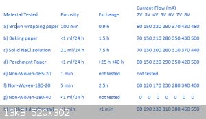

test_results.png - 13kB
Test results

Thank you for testing. As you can see, the problem with the non-woven diaphragm is leakage. I have not been able to solve this problem. Adding layers of fabric dramatically reduces conductivity to almost zero. This is probably due to the fact that polypropylene is hydrophobic. Using different types of fabric did not show any significant improvement in the result.
Wrapping the top layer of fabric helps a little. This probably fixes the fibers. Perhaps impregnation with an ion-exchange layer should help. But I have not yet found an affordable and stable material
Use the thickest fabric possible to wrap fewer layers. More porous fabric has better conductivity after baking. Maybe if you find a very thick fabric it will help you.

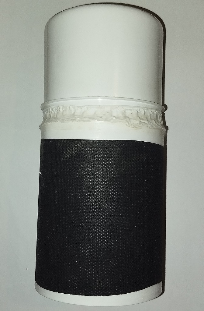

Here is a photo making diaphragm. Bottom of polypyropylene pipe is welded with a soldering iron, then wrapped in fabric, clamped with a steel sheet with wire and baked in the oven at 175 degrees.
Without a diaphragm about 5A, the current with a diaphragm is 1.9A
1.jpg - 137kB 2.jpg - 107kB 3.jpg - 235kB 4.jpg - 131kB 5.jpg - 130kB 6.jpg - 558kB

The process of making diaphragm volume about 1300 ml from polypropylene containers
Welding was carried out using an electric soldering iron. Holes were melted as well. Further grinding and backing at 175C
d1.jpg - 173kBd2.jpg - 184kBd3.jpg - 136kBd4.jpg - 121kBd5.jpg - 189kBd6.jpg - 184kB

I tested the diaphragm and the results were very good
1. Electrolysis of salt with an iron anode. A strong alkali and a bright green solution of iron chloride 2. Exact exits will be written soon in a separate article. There was a lot of iron hydroxide in the anode chamber, but this did not affect the conductivity of the diaphragm
2. Electrolysis of the mixture of potassium sulfate and gypsum gave 8% sulfuric acid, but with a poor current yield. This is probably due to the fact that a lot of potassium hydroxide has accumulated around cathode. The experience will be converted with a very diluted solution of potassium salts so that only sulfate ions are in the solution. Wait for the report on the separated topic.
Due to the leakage of the diaphragm should be very quickly extracted from the solution after electrolysis. Any change in the fluid level in the cathode and anode chamber is carried out to the leak
The most thick and dense reusable bag was also found. He allowed to bake the diaphragm in 1 layer without melting. This greatly increased conductivity
An attempt to add chopped ion exchange resin to the fabric during baking did not lead to success. This reduced its mechanical strength and was easily washed out with water
