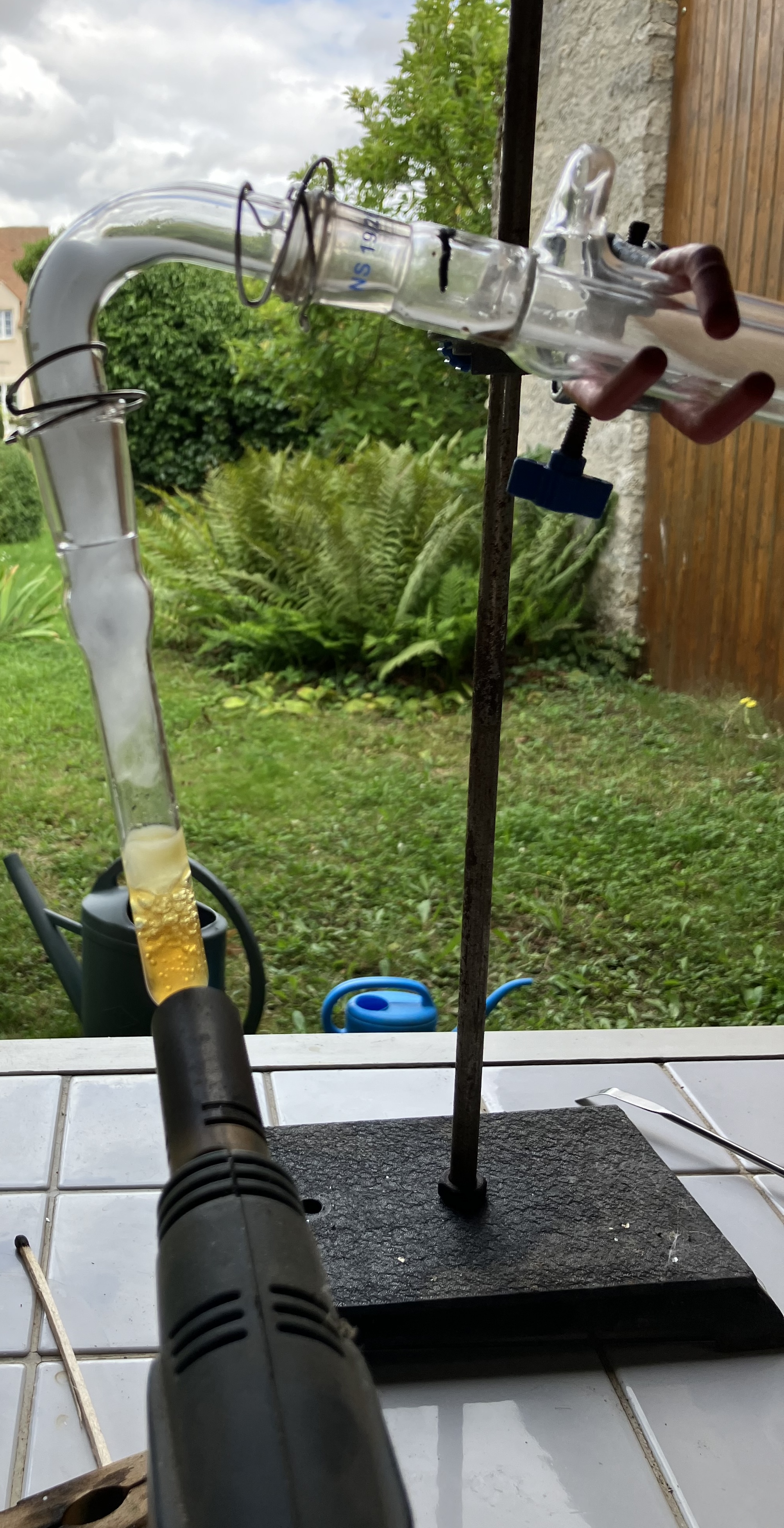

Maybe in quartz, but I do not have that. I heated until my test tube became soft, but still no SO3.
I’m surprised. A single blowtorch suffices to get plenty of sulphur trioxide fumes, as shown in the attached picture (the test tube is made of quartz).

Thanks everyone. Great picture. I'll try to get my hands on quartz glassware. Copper sulfate + oxalic acid are more than twice as expensive as NaHSO4 from what I can see. It'll take some time but I'll report back on my results if I do it.

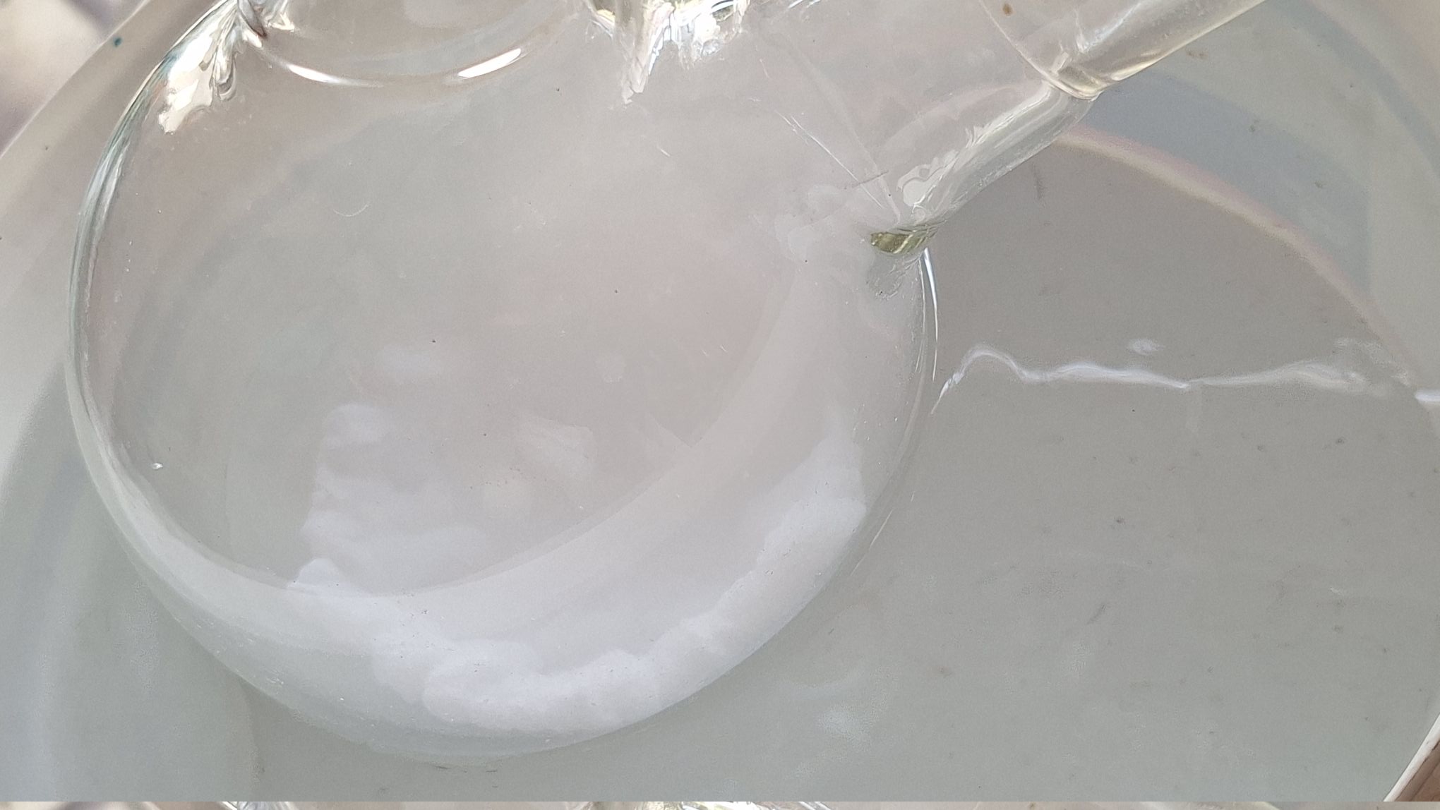

I did it again on the same butane bunsen burner, except this time I had more insulation (more bricks and a glass wool lid). The cost of the furnace setup without the quartz glassware is just below a hundred euros. I took a cut later than I did before, and though I couldn't see anything during the process due to the thick fumes produced inside the glass and thought it was going nowhere, this time I was left with quite a lot of white solid. (Sorry for the qualitative description but I'm not taking any risk handling that, see attachment, it's in a 500 mL flask).
solid.jpg - 180kB
I melted the solid with a hot water bath and managed to pour it into a glass bottle without *too much* trouble. (When pouring, I placed a fan behind my back because the air outside was very thick and I wanted to make sure the vapors would go the other way. Instead it blew a TON of smoke in my garden, which reminded me how Leonid mentionned in his own report it was once used as a smoke agent. Scary! But worth noting that I did not have any fuming when the glassware was connected.)
Now I'd rather not have to deal with such profusely fuming acid every time I need 50 mL of acid. So I thought about it and one thing that makes the CuSO4/Oxalic acid precipitation method unattractive to me is the price of the copper sulfate. If you could do it with the much cheaper aluminum sulfate, whose oxalate salt is also insoluble in water, from what I can see the cost per mol of H2SO4 would be almost identical to that of this method (but would produce a less valuable diluted acid).
With careful temp control and consistency you can certainly estimate how much SO3 is going to come over, and distill that into ~80% dilute sulfuric acid to neutralize the free SO3. This should be a much less dangerous, easier and more predictable way to obtain plain 100% sulfuric acid. This is what I'm going to try next, I'll try to make a kiln with temp control, etc. However I now have enough sulfuric acid as it is and it will probably have to wait until next year.
