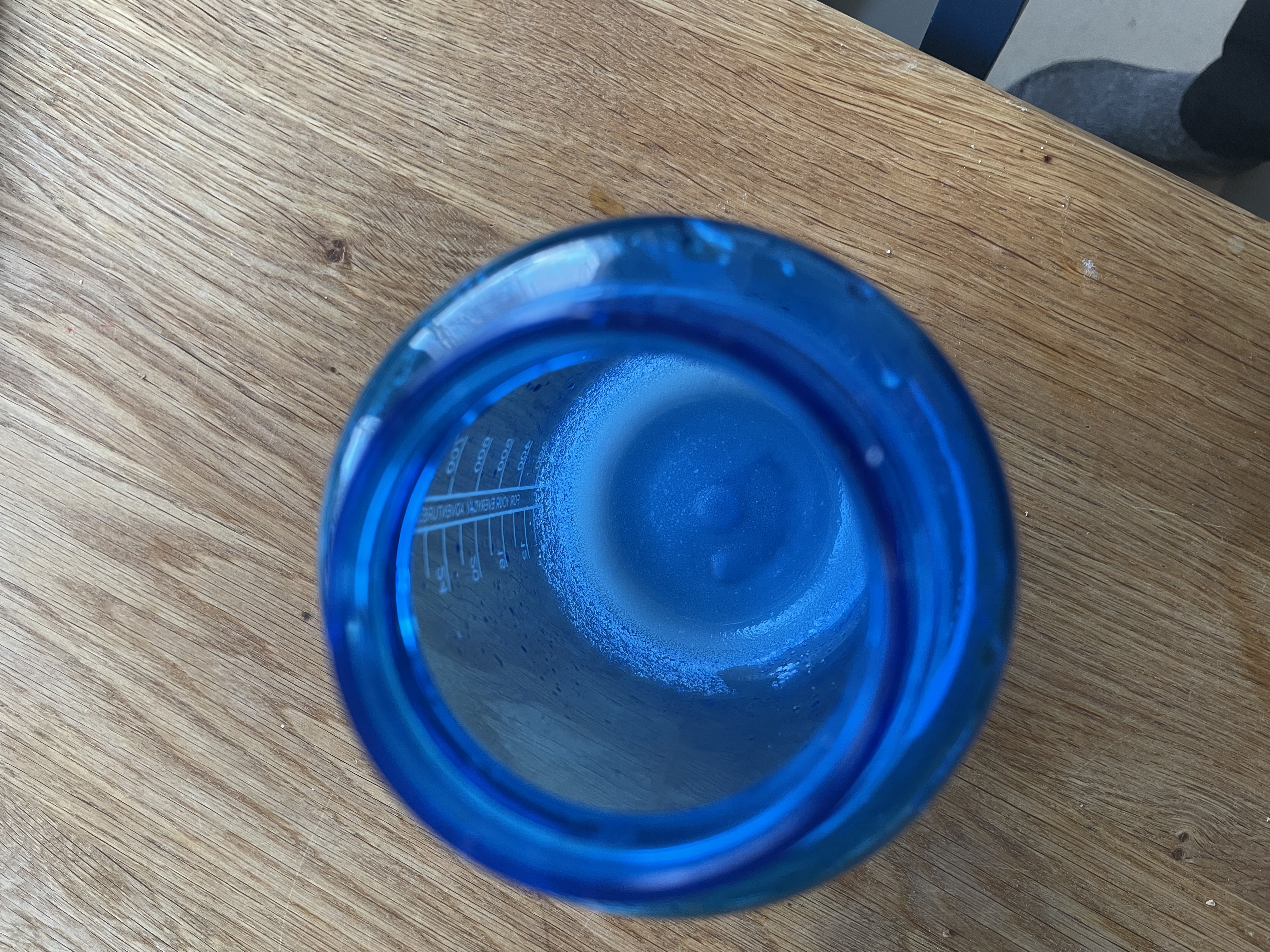

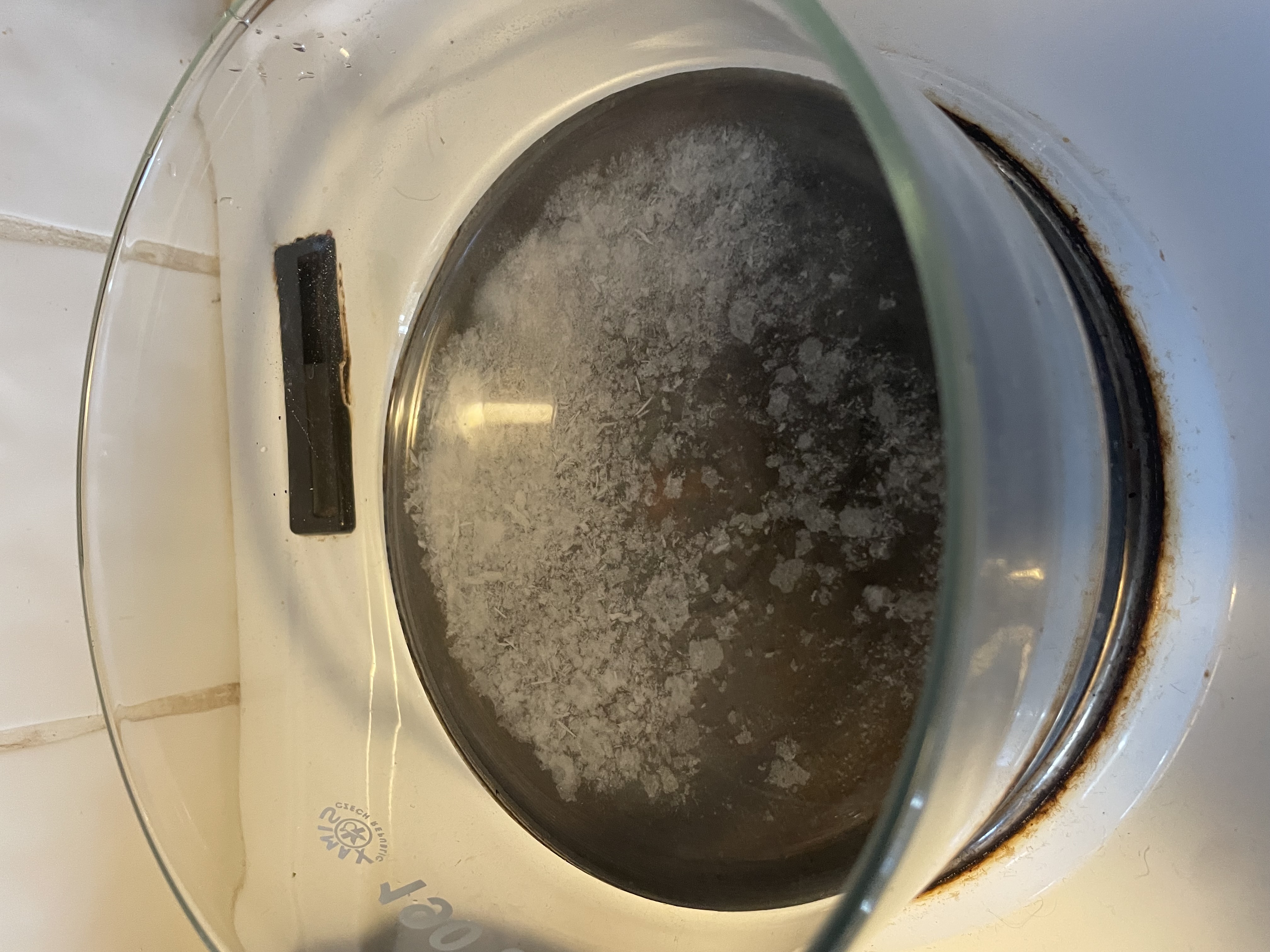

However now I have some mysterious result. I started boiling down my filtrate, approx 400 ml of solution to see how it goes. Some is still in the filter with the goop so the yield will not be fantastic but I´ll see if I can improve on that later.
I started with 1 M of CN tetrahydrate dissolved in abou 200 ml of water (almost conc solution) and 1 M of AS dissolved in about the same amount of water, quite conc solution. I mixed them, got the goop, filtered over night through a paper coffee filter lined with some synthetic fabric with seemingly fine pores.
The CN is analytical grade due to seller, the AS technical grade >98%. I used tap water for all steps, since I´m happy to get AN of reasonable pure quality. Maybe this was the mistake?
Theoretical yield should be 2M of AN, or about 160 g which at room temperature is dissolved in about 160 ml of water, and very easily dissolved in this amount of water at elevated temperature.
Nevertheless I got som crystallization when turning on the stove with clearly more than 160 ml water in the solution. This amount of water left should contain all AN as dissolved so I dont know whats going on.
I tried preparing some AS and CN solutions and dripped some of the filtrate in them without any cloud precipitate appearing. Hence there should be no Ca ions or SO4 ions in my filtrate, respectively. What possibilities are left, to me there is just NH4 or NO3 remaining.
I did add some ammonium hydroxide when mixing the CN and AS to get the pH to about 8, but that was very little. One could suspect CaOH forming, but not in this quantity.
also, the bottle with wich I collected the filtrate has some crystals in it stuck to the wall. see pic. Could this be CaSO4 which is crystallizing on the wall?
Could something else be happening? Is concentrated AS solution just SO4 ions, or can some bisulfate turn up? Could some double salts appear?
I´m puzzled, since I thought this reaction should be easy.
Now Im keeping on boiling the filtrate down, filtering out the crystals and I´m keeping them since I dont know what they are, maybe its the real AN crystals?
I guess some of you experienced people could figure out what is going on.

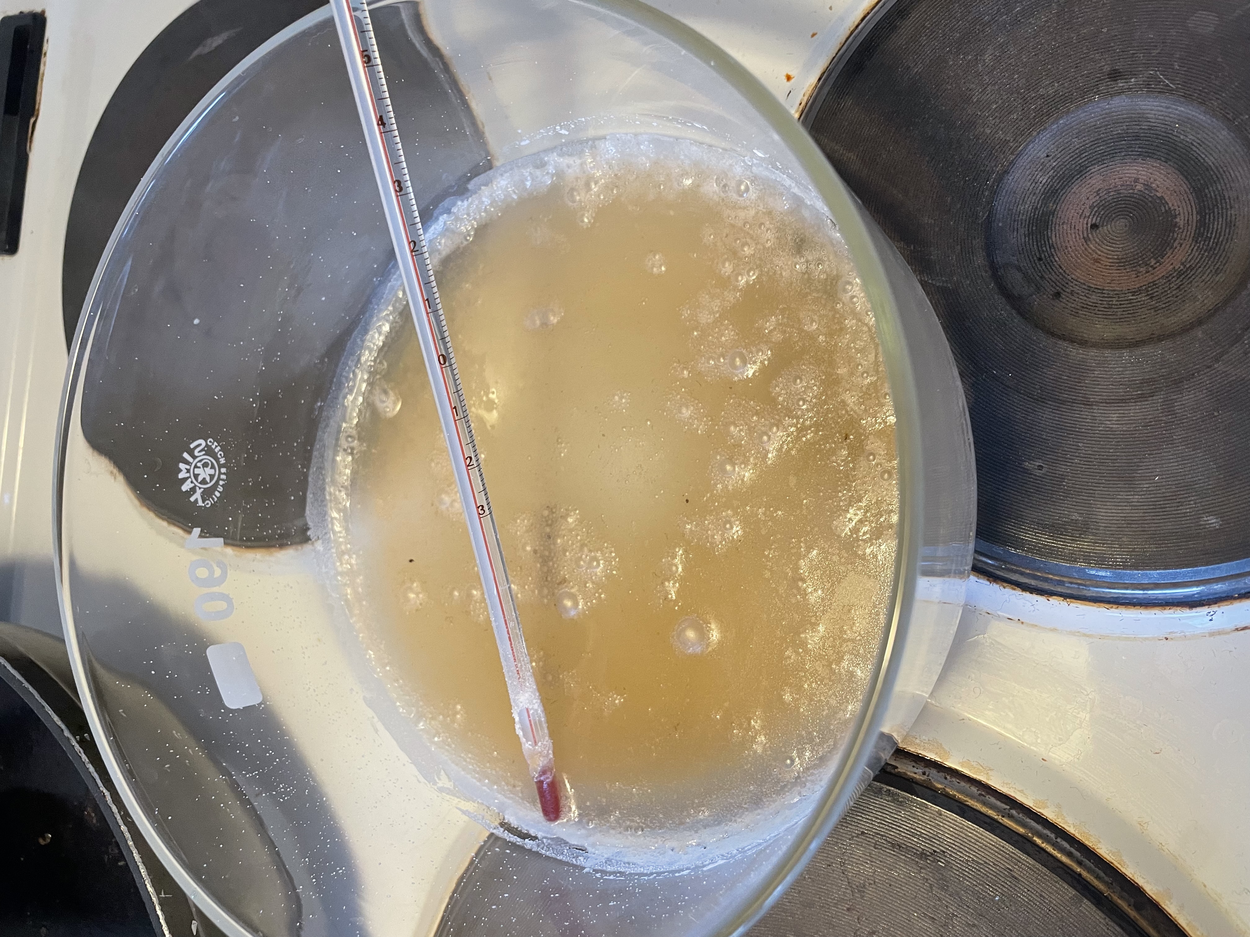

one more clue
Kept boiling down slowly. Now the filtrate is kind of brown and has some charachteristic of AN, like turning more solid as heat decreases (solubility goes down) and being a thick liquid at about 100 degC.
I wonder why it is not white anymore. Maybe my coffee filters left something in the solution. Or the tap water.
//Erik

Precipitates
Posts: 186
Registered: 4-12-2023
Location: SE Asia
Mood: Acid hungry
[*] posted on 18-11-2024 at 07:11
Calcium sulfate is slightly soluble in water (approx 2.0 g per litre).
You can dissolve the product in an alcohol e.g., methanol, for which calcium sulfate is truly insoluble, to get a purer AN product.
Brown colour likely impurities - but the AN should still be fine for most purposes. It will probably become more white as it dries out.

[*] posted on 19-11-2024 at 04:48
The brown color my come from iron hydroxides/oxides. We have problems at home with yellow-tinted calcium carbonate stones forming inside showers; water here is too heavy on calcium and iron.
Try ethanol then. 30% of ethanol should be good enough to remove most of the calcium sulfate and iron while keeping ammonium nitrate in solution (see attached paper for a similar idea involving calcium sulfate in brine).
