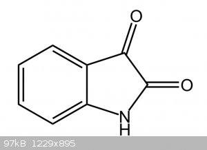

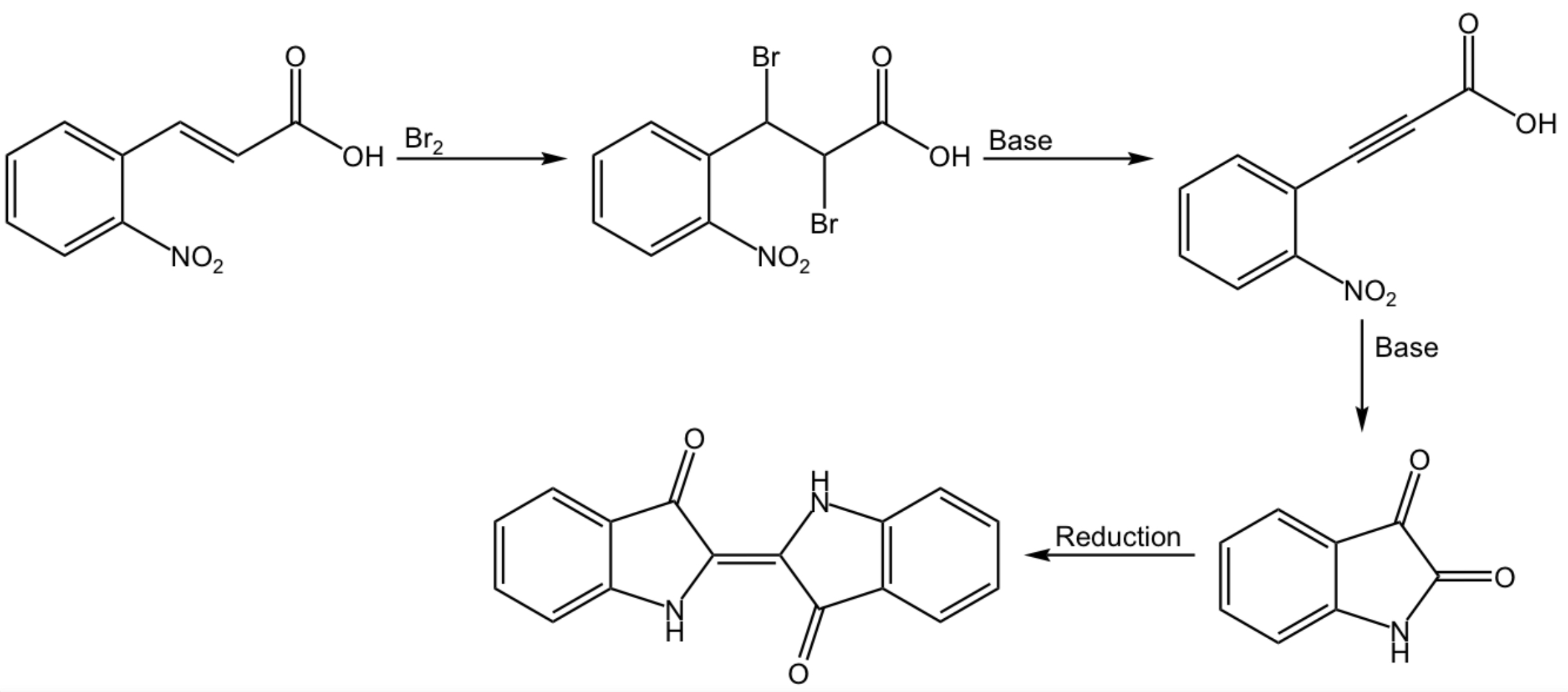

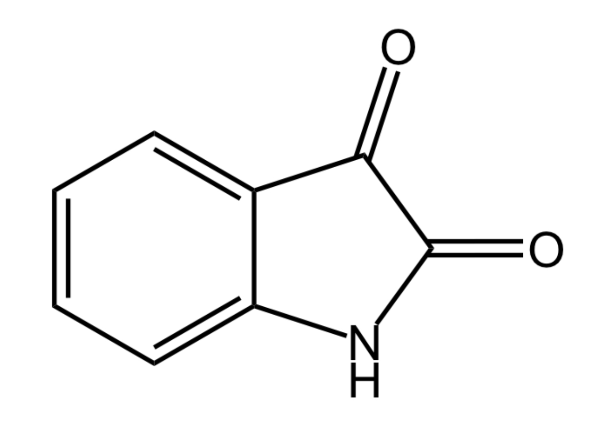

Isatin is a historically important chemical compound with it being the last chemical intermediate in the first total synthesis of indigo by Adolf-von-Beyer [1].
IMG_7807.jpeg - 97kB
Fig.1: Structure of isatin
IMG_7806.jpeg - 228kB
Fig.2: First published total synthesis of indigo

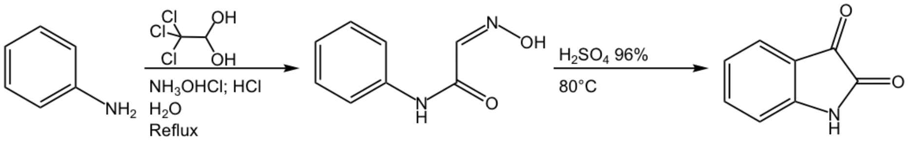

Over the years there have been some great improvements regarding the synthesis of isatin, and in 1919 Sandmeyer published a rather nifty two-step approach starting from aniline that may now be commonly referred to as Sandmeyer Isatin Synthesis. First an acid catalyzed condensation of the corresponding aryl amine with chloral hydrate and hydroxylamine hydrochloride to make an isonitrosoacetanilide is performed, which then cyclizes in concentrated sulfuric acid to form the desired isatin.
IMG_7808.jpeg - 92kB
Fig.3: The Sandmeyer Isatin Synthesis

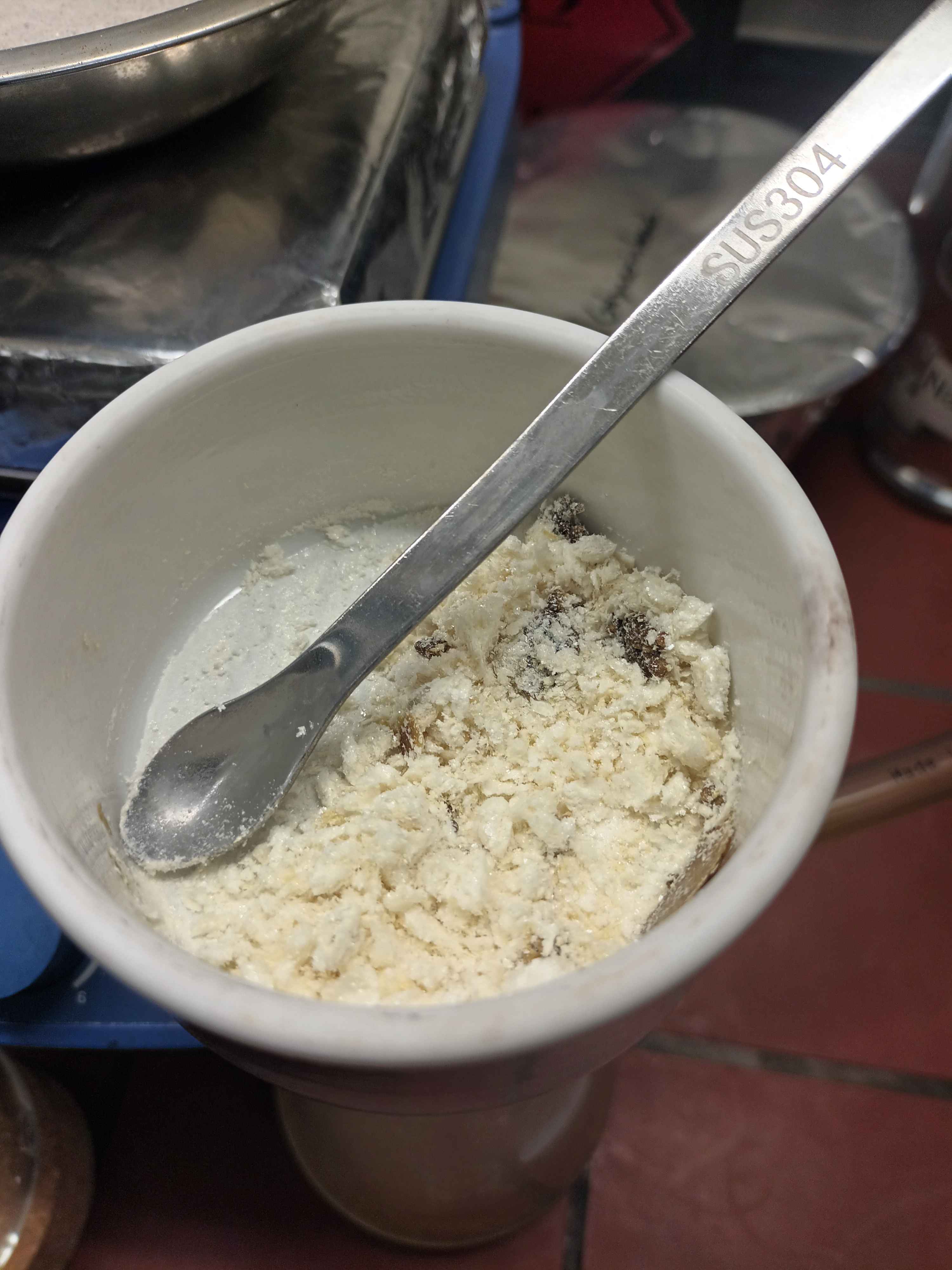

Isonitrosoacetanilide:

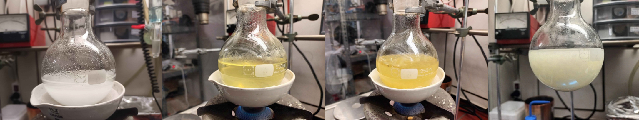

A 250 ml round-bottom-flask containing two boiling stones was charged with 4,5 g of chloral hydrate (27,2 mmol) and 60 ml dest. water were added to dissolve the crystals. Then, in sequence with intermediate stirring of the mixture, 65 g sodium sulfate decahydrate (201,75 mmol), a solution of 2,3 g aniline (24,7 mmol) in a mixture of 2 ml fuming hydrochloric acid and 15 ml dest. water, and a solution of 5,5 g hydroxylamine hydrochloride (79,2 mmol) in 25 ml dest. water were added to the clear solution, resulting in a colorless slushy of undissolved sodium sulfate. The mixture was set in a sand bad over a gas burner, rapidly heated to a vigorous reflux and kept boiling for around 10 minutes. During this time all the solids dissolved and the mixture turned increasingly more yellow, suddenly turning cloudy as soon as the desired temperature was reached with some brown oil separating. It was left to cool down to room temperature (currently 10-15°C) for two hours, during which time a good amount of white crystalline flakes precipitated and the byproduct oil solidified. All solids were removed by vacuum filtration, the crude isonitrosoacetanilide washed with a little dest. water, and dried on the pump for around a hour. The product was collected as slightly off-white flakes with some solid chunks of tar in between, and was used as such in the following step.
IMG_7818.jpeg - 806kB
Fig.4: Progress of the first step of the synthesis
20241111_163520.jpeg - 346kB
Fig.5: Crude isonitrosoacetanilide

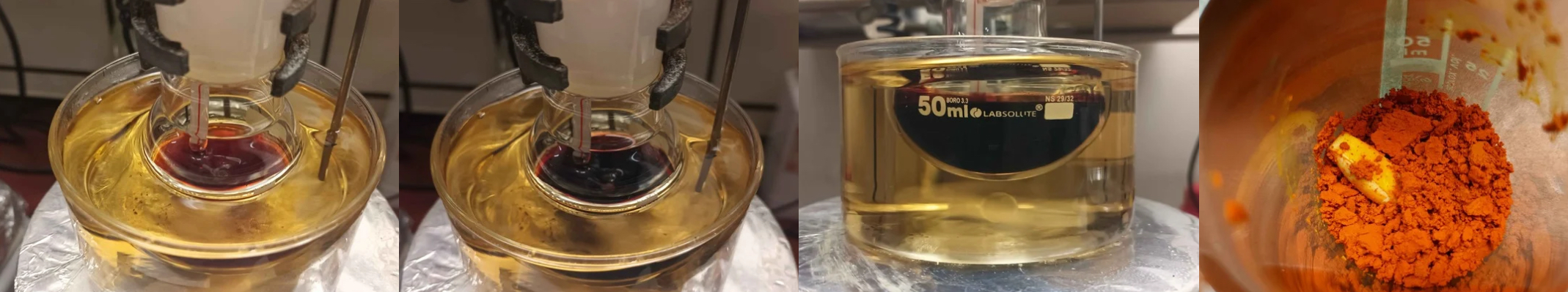

Isatin:

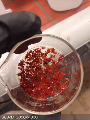

A 50 ml round-bottom-flask was charged with 30 g of 96% sulfuric acid and heated to 50°C with the help of a glycerol bath. All of the intermediate product was then slowly added in portions over the course of around 15 minutes, so that the internal temperature is kept between 60 and 70°C. On addition the mixture very quickly turned a dark red, almost black color and all the solids ended up dissolving within a couple of minutes of stirring. The flask was capped with a septum and the solution was then kept at 80°C for ten minutes, during which time the color further intensified. After cooling the reaction mixture was poured onto crushed ice, stirred for a couple of minutes, and the orangey-red precipitate of crude isatin removed by vacuum filtration. The residue was washed with a little more dest. water, dried throughly on the pump for two hours, and then kept in the vacuum desiccator over anhydrous calcium chloride over night.

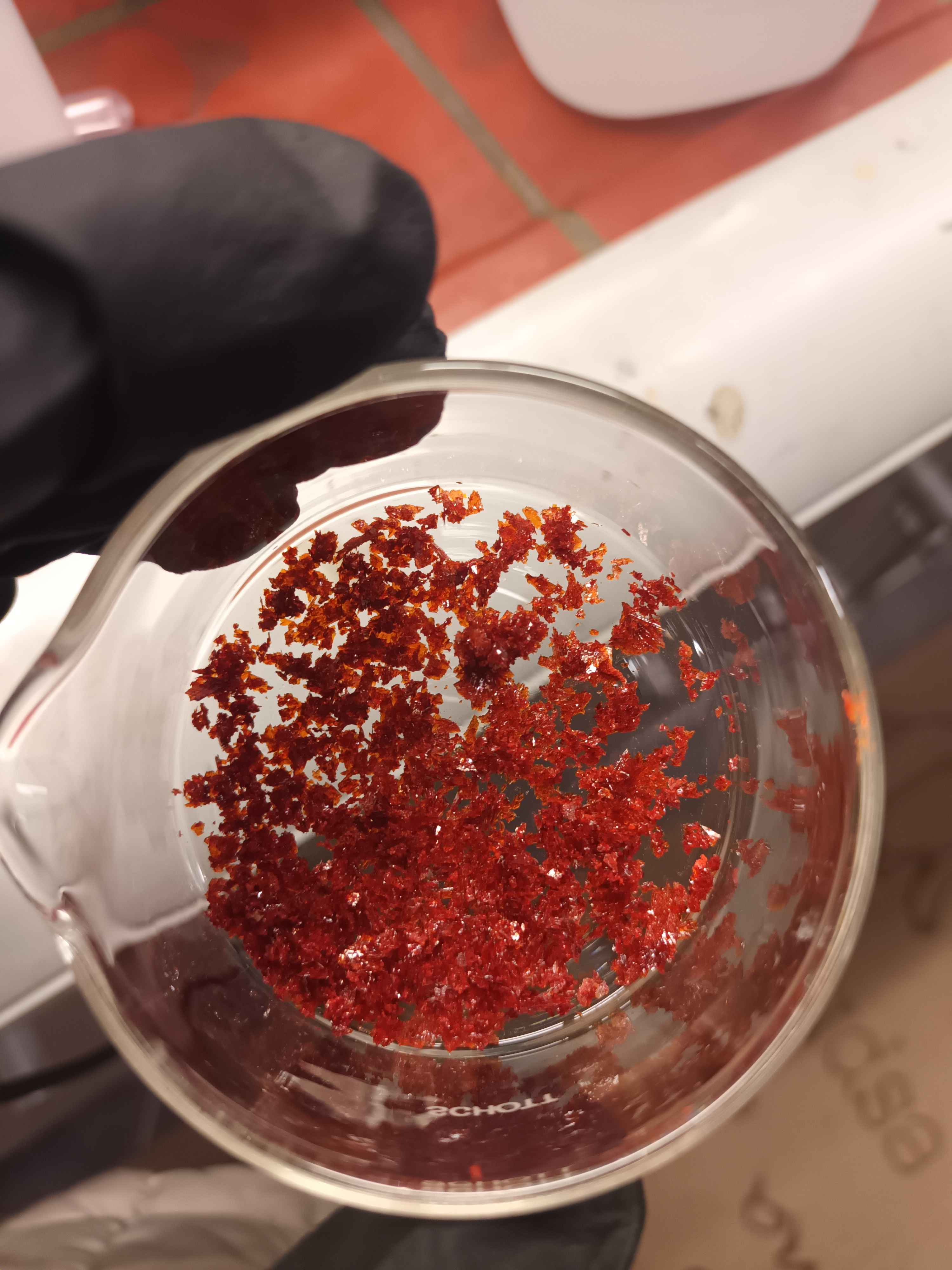

For further purification the bright orange powder was recrystallized from 7,5 g of glacial acetic acid and residual solvent removed in the vacuum desiccator over anhydrous potassium carbonate. The product was collected as garnet crystalline plates that appear dark orange under the microscope. 1,37 g, 37,7% ; 53,3% lit.
IMG_7826.jpeg - 790kB
Fig.6: Progress of the second step of the synthesis
20241112_165619.jpeg - 388kB

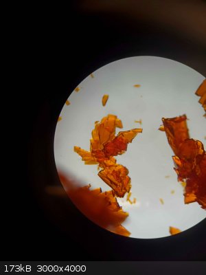

Fig.7: Recrystallized isatin

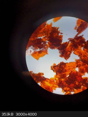

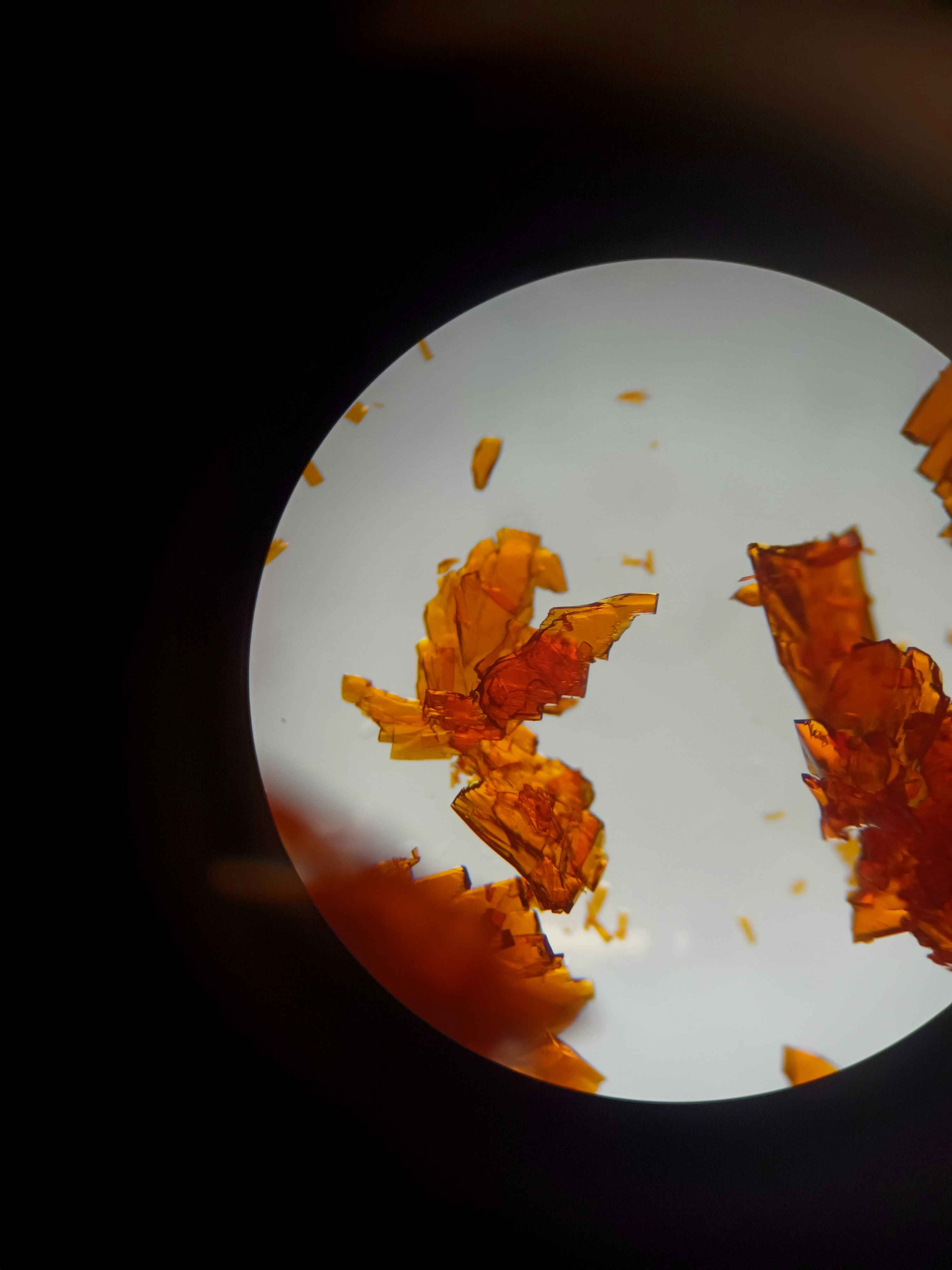

20241112_170102.jpeg - 173kB20241112_165956.jpeg - 353kB
Fig.8: Recrystallized isatin under the microscope
