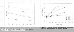

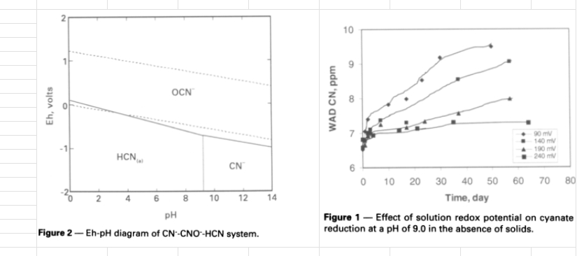

1) "Cyanate, may be reduced to cyanide in reducing environments"
The reduction rate of cyanate to cyanide increases with decreasing solution redox potential. A solution with a lower redox potential presents a more reducing environment and, hence, is more favorable for the reduction of cyanate to cyanide. This phenomenon is also depicted in the cyanide system Eh-pH diagram (attached); at lower solution redox potentials, the system favors HCN or CN-. ref. Reduction of cyanate to cyanide in cyanidation tailings under reducing environments (H.K. Lin and D.E. Walsh Professors, University of Alaska Fairbanks, Fairbanks, Alaska)

Probably FeCl2 is acidic and will lower the ph of the solution, thus "Solutions with lower pH favor the reduction rate"
