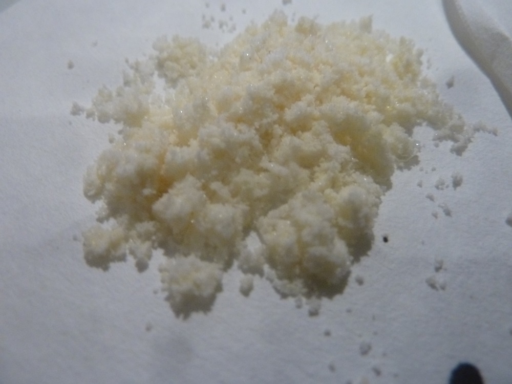

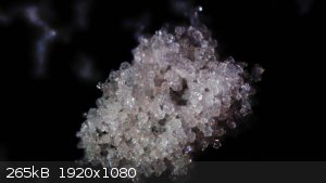

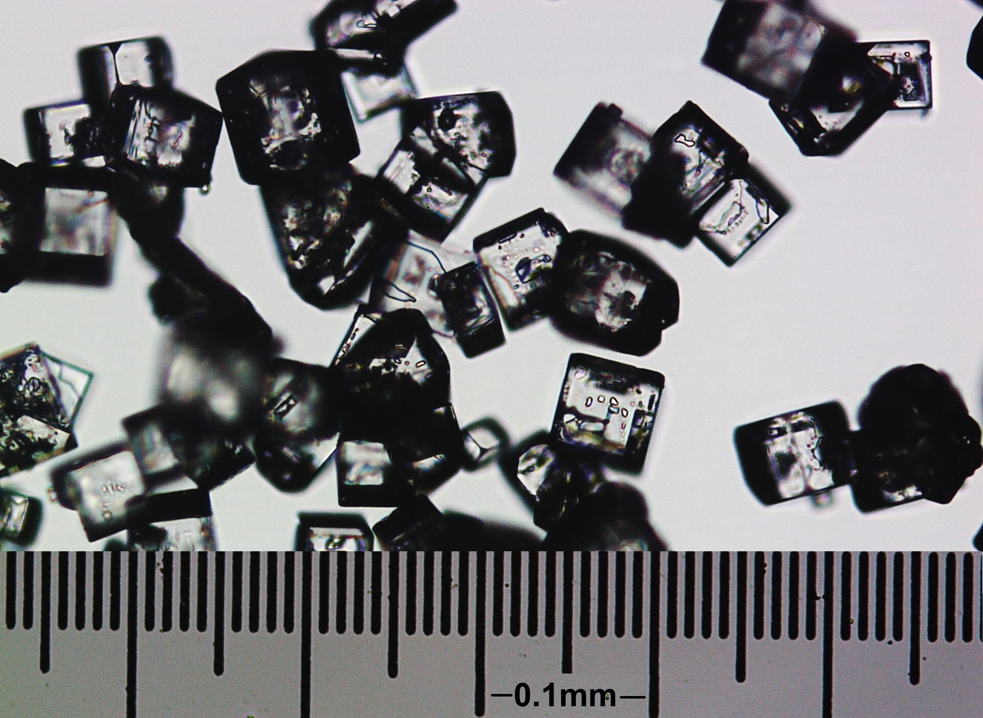

Attached is a picture of DAP-2, these precipitate immediately as small cubes. The DAP-4 and DPPE-1 look the same but smaller.

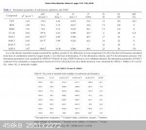

Are any of these derivatives secondary explosives with moderate or insensitive properties? Or no because of the structure?
Their listed properties are all over the place, there's a table in the attached article. The ammonium nitrate based DAN-4 has off the scale friction sensitivity (less than TNT) but even higher supposed impact sensitivity than the perchlorates with VOD 8164m/s. If the figures for DAP-4 are true, it is sensitive but not awfully so. I'm just not sure I trust it based on how impact sensitive it seems to be.

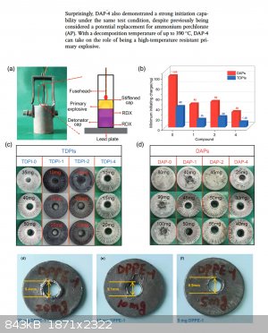

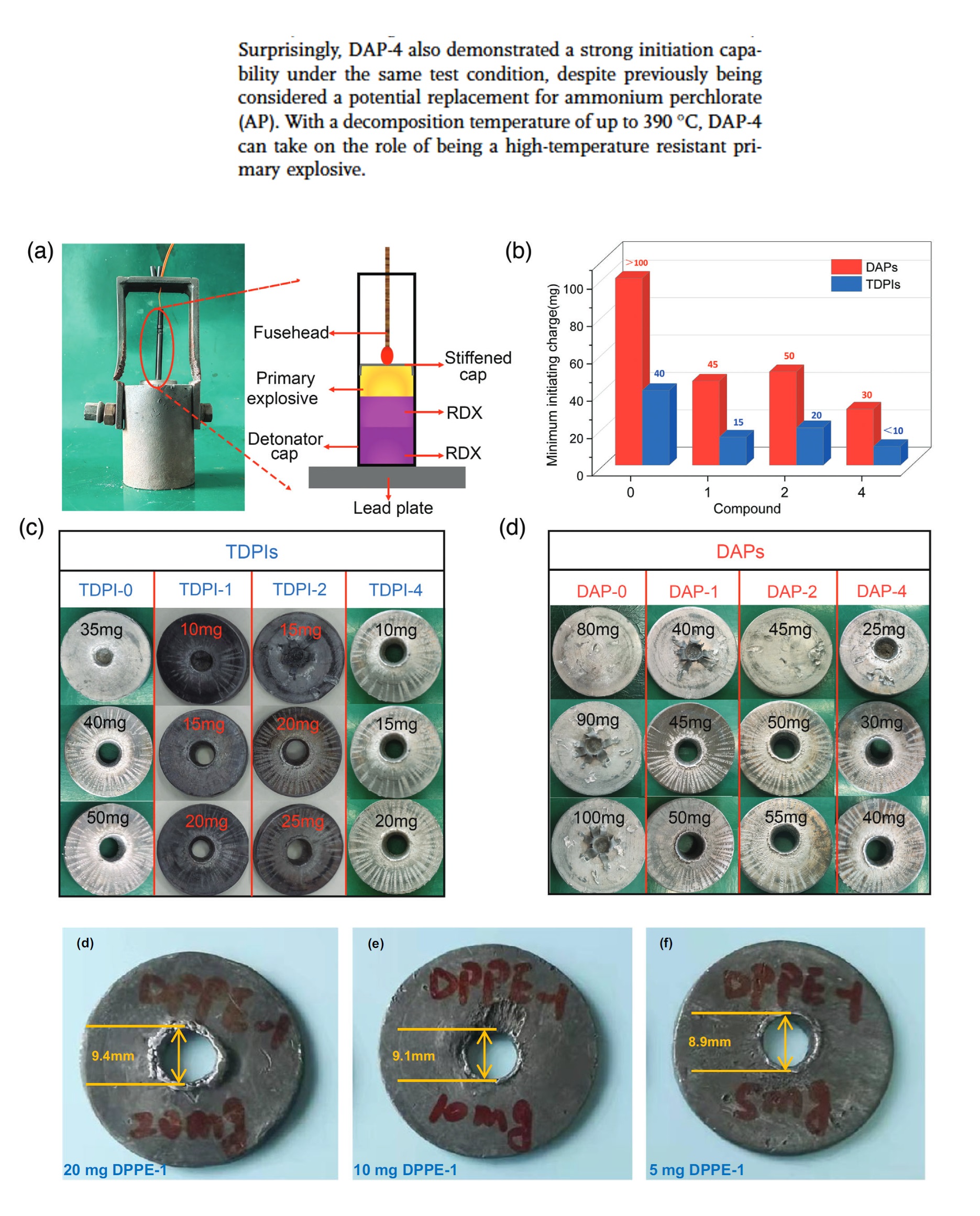

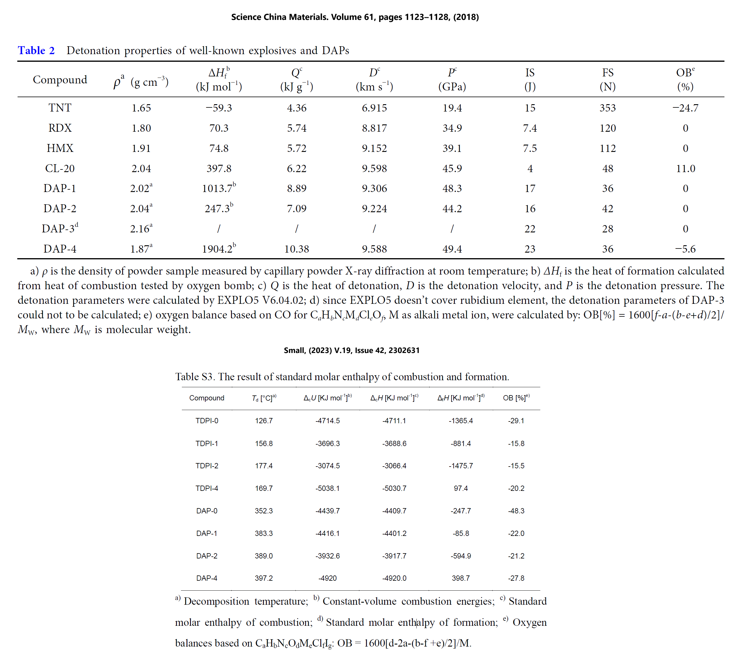

Yeh so had a look at that article mentioning initiation efficiency, here's the results they obtained. So yes DAP-4 will act as quite an efficient initiator when used over 30mg. DDPE-1 was published later the same year and is the best at sub 5mg to initiate RDX. I've shown 5mg DPPE-1 being ignited in open in first post, I'll attach a pinch of DAP-4 being ignited here as you can see DAP-4 and DAP-2 are pretty tame unconfined.
In the picture DAP-0 is dabconium diperchlorate, DAP-1 sodium dabconium triperchlorate, DAP-2 potassium dabconium triperchlorate, DAP-3 rubidium dabconium triperchlorate and DAP-4 ammonium dabconium triperchlorate. It's interesting that the ammonium salts have the highest initiation efficiencies. TDPI's are the exact periodate analogues to the perchlorates, their efficiency is also unexpectedly better than perchlorates, their VOD's are significantly lower but they reach their peak pressure quicker.

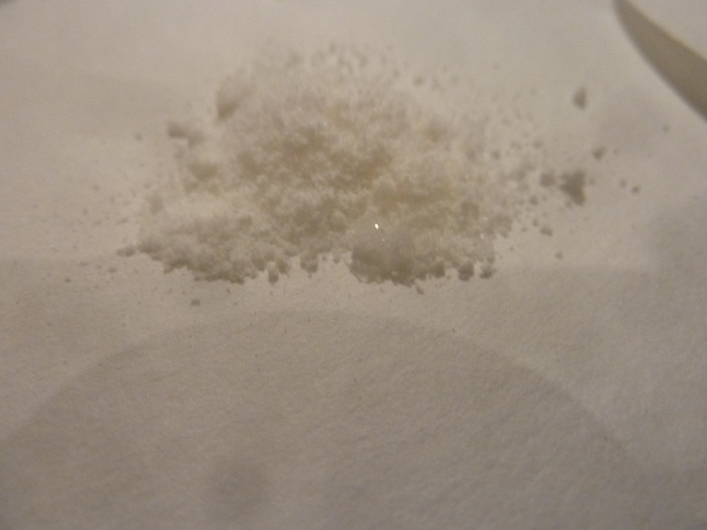

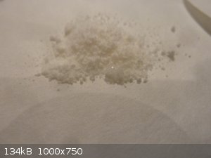

Attachment: DAP-2 and DAP-4 ignition.mpg (6.7MB)
This file has been downloaded 253 times

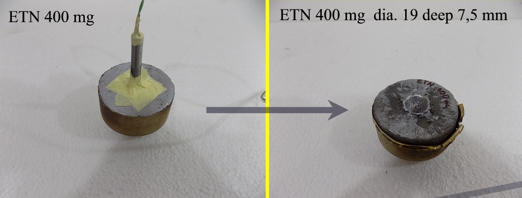

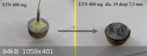

A picture is worth a thousand words. Using a lead witness plate is one of the best measurements. By making a dent or hole in the lead, it is possible to measure power with high accuracy. I consider the "plate dent" method, i.e. a dent or crater (in the lead) to be the most accurate amateur measurement. The method used in the picture is not so accurate because part of the energy disappeard through hole. As a result, part of the information is lost. Exact method here for example:
LTX 1,81.jpg - 94kB

They were only looking for the transition point from partial to full detonation, that's why there is a big difference between the first and second row but negligible difference between the second and third. At a certain point you are just measuring identical RDX base charges with a tiny difference explained by way of a heavier primary loading.
Your picture is great, but it's not testing the same thing.

Oh yes. It was only research of amount of primary weight.....:cool:

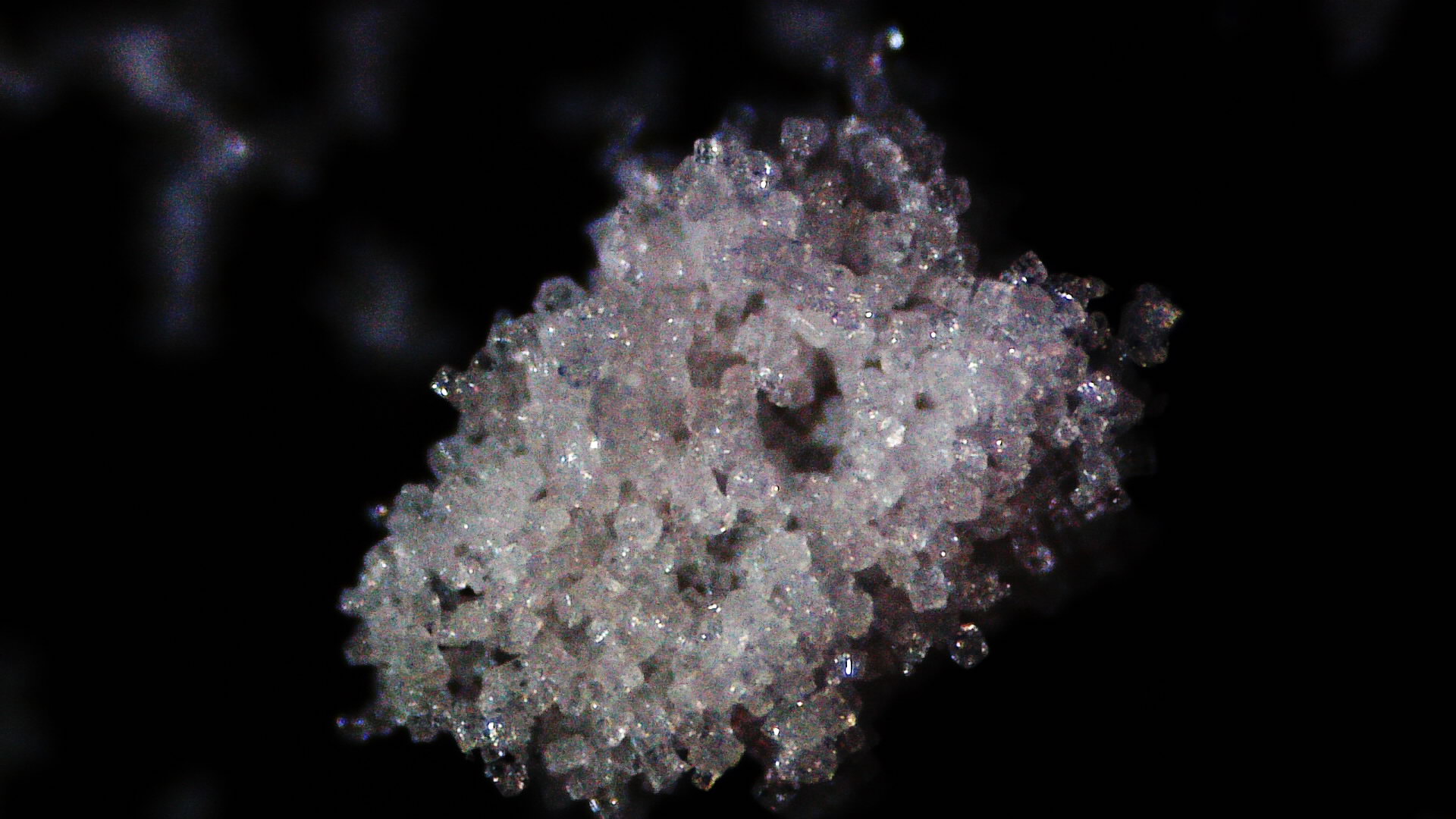

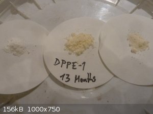

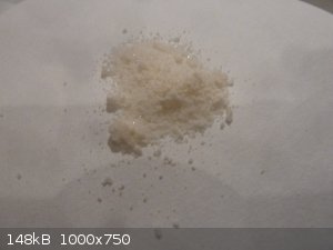

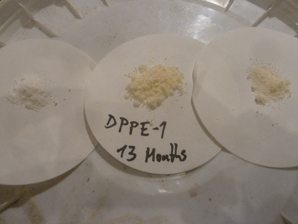

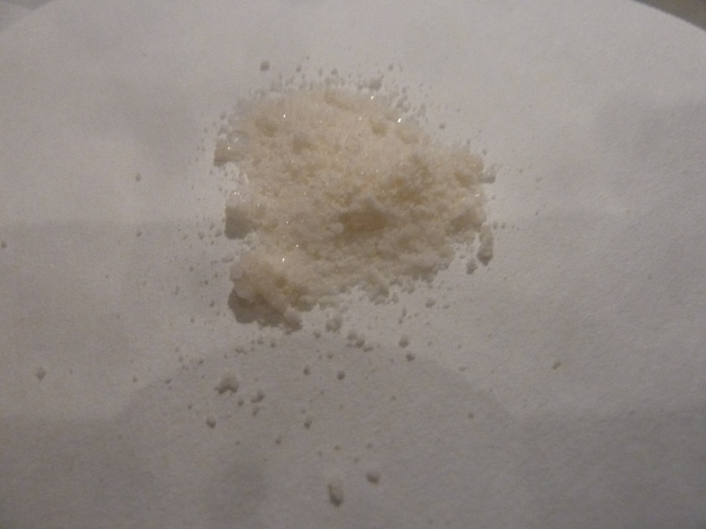

It does not feel in any way hygroscopic but does have a distinct tendency to clump and keep its shape when moulded which I was putting down to its crystal form or maybe some other attraction between crystals. I would expect pressing it into pellets would be very easy. It was hard to get an image under the microscope as they all want to bunch together a cluster of DPPE-1 is attached.
No I have never tried to confine it.
DPPE 1 lens 1.JPG - 265kB

The calculated detonation parameters in the article are highly overstated! It seems that the Chinese did not bother with the calculations at all, but continued hexogen and octogen to the density of the perovskites.

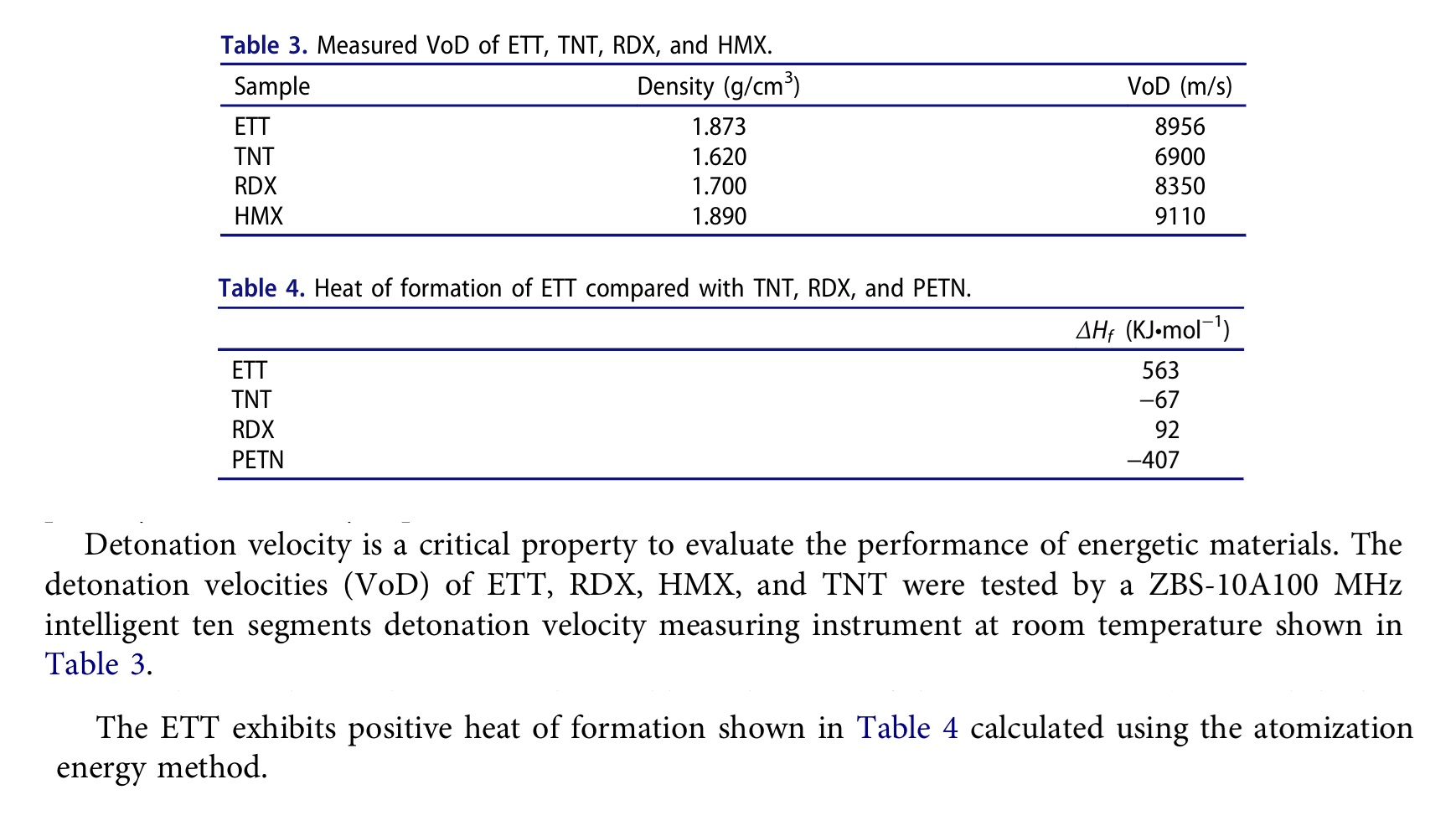

Healthy scepticism is warranted, particularly for reports coming out of China. My only criticism is the talking in absolutes. I'm personally not a fan of high reported figures of simple perchlorate salts, it just takes the fun out of it.

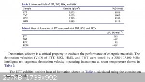

They calculated a heat of formation of +563kJ/mol for the en/DABCO tetraperchlorate which seems absurd (although not as absurd as the initial reported 1904kJ/mol for DAP-4). This wouldn't affect (supposed) measured values though. This is a topic where the amateur can provide more credible information.
ETT props.jpg - 257kB
No, I have no complaints about this value. This is believable. The heat of formation is minus Enthalpy of formation. Positive heat means negative Enthalpy:
For hexamine, Enthalpy of formation = -99,2 KJ/mol, heat of formation = +99,2 KJ/mol:
For piperazine, Enthalpy of formation = -45,6 KJ/mol, heat of formation = +45,6 KJ/mol:
For liq H2O, Enthalpy of formation = -285,8 KJ/mol, heat of formation = +285,8 KJ/mol;
For hydrazine, Enthalpy of formation = +50,5 KJ/mol, heat of formation = -50,5 KJ/mol
Guanidine perchlorate VOD is 7150m/s at 1.67
Methylamine perchlorate VOD is 7540 m/see at d 1.68
The double salt of ethylenediamine diperchlorate and triethylenediamine diperchlorate (DABCO) was measured in J. Ener. Mat. (2017) 35:4, 443, 8956m/s @ 1.873g/cm3.
Actually, there are two possible explanations. Either the new VOD measurements are too high, or the old ones are too low.

Hmm, I looked at the tables for TNT, RDX, PETN, HClO4 and Ethylenediamine. The authors used determination "Heat of formation" = “Enthalpy of formation”, but a typo really takes place for ETT.
It's not a "typo", it's reiterated in the text. A positive number is an ongoing trend for the purely amino based double salts with the first (seemingly outrageous) numbers published in 2018, but toned down by 2023. The calculations are given in the supporting information linked to in first post.
DAP-4 heat.png - 458kB
Oooh...I see
Do you have a DABCO enthalpy of formation?
We can try to evaluate the enthalpies of the formation and heats of detonation for DAP-1, DAP-2, DAP-3, DAP-4 and ETT.

13 Months ago I´ve synthesized several small batches DPPE-1 for testing. A major concern is long-term stability. So I decided not to use all for sensitivity testing, but also for storage stability testing.
Quantities between one and two gram were covered with several milliliters distilled H2O, and stored in a tool shed outside of my house. The temperature was in the winter close to zero and reached in the summer about 25 to 30 degree centigrade.
All batches were prepared from the same precursors, even same batch of precursors, but showed different behaviour. One batch remained almost unchanged, virtually no discoloration, still pourable and goes ddt in small quantities.
The next batch was considerably discolored, with crystal growth and agglomeration, not pourable. It gave small flashes in the blue bunsen burner flame, really tame, but no explosion at all.
The last (third) sample seems halfway between the former two. Slight discoloration, somewhat clumpy and a very fast burning with flash and a "whomp" but no bang.
DPPE-1 after 13 month storage.jpg - 156kB

This is the other end:
DPPE-1 bad.jpg - 146kB

I thought that similar prepared samples should behave in the same way? I still have no idea what went wrong. Maybe slight differences in the stoichometric composition? Or the precipitate not enough washed? The pale amber color looks like traces of iodine due to degradation.
Any other ideas?
